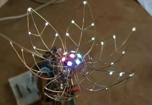

The Mechanical Flower is a globally acclaimed open-source project
, originally created by a foreigner. It uses copper wire as a framework, with LEDs soldered to it and controlled by servo motors, resulting in a mechanical flower that automatically opens and closes, changing colors in a cyberpunk style. However, it is difficult to manufacture, mass-produce, and has low reliability. This project is a derivative work based on the open-source project, utilizing modules from the LCSC PCB and SMT ecosystem to create a mechanical flower product with a copper wire framework, possessing aesthetic value.
Project Functionality:
The project incorporates a microwave radar module or touch module. When someone approaches or touches the leaves, the mechanical flower automatically "opens," with the white LEDs on the petals gradually brightening during the opening process. The flower core can be any color, and the petals display a pleasing color. After fully opening, it automatically "closes" after a short wait, with the white LEDs on the petals gradually dimming during the closing process. The green LEDs on the leaves below the mechanical flower also gradually brighten and dim during the opening and closing process. It is rechargeable; during charging, the leaves of the mechanical flower will exhibit a breathing and flashing dynamic effect. The mechanical flower has a very beautiful effect and can be used as a lobby decoration or a birthday gift. It has a certain commercial value.
Project attributes:
I have not participated in any competitions. Design
principle
: PWM control of programmable LED, PWM control of servo motor, and code design of STM8 microcontroller.
Software description:
In terms of control, there is a microcontroller version and a pure hardware version, which reflects my software and hardware design capabilities. I am a hardware engineer and my software foundation is relatively weak. In this project, the software mainly uses basic statements such as WHILE, if, etc., and uses the interrupt system to complete the display of the project effect. The code can currently achieve basic functions, but there are still some bugs, such as
(1) when the power is cut off in the non-closed state, the MCU will not remember the original position of the servo motor. After power is restored, it will quickly reset, causing the mechanical flower to accelerate very fast, affecting durability and ornamental value.
(2) The hardware has reserved a lot of peripheral power control. In fact, the code has not yet optimized power consumption and has not yet implemented sleep instructions.
(3) The problem may be due to coding ability or low MCU frequency. When controlling the servo and LED gradient, the servo appears to be jittery, and the LED gradient effect is poor
. I hope that programming experts can optimize and improve this. I apologize for my limited ability!
Physical display
of the pink mechanical flower with copper wire skeleton
The flowering effect of the white mechanical flower with copper wire skeleton

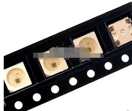

(6) Programmable LEDs: [Taobao] https://m.tb.cn/h.UuCn94G?tk=bCJudNbj6S8CZ0001 "WS2812B Full-Color High-Brightness RBG 5050 SMD Programmable LED 5V Strip Light for Brushless Racing Drones" Click the link to open directly or search on Taobao to
buy WS2812B, at least 7 LEDs required.

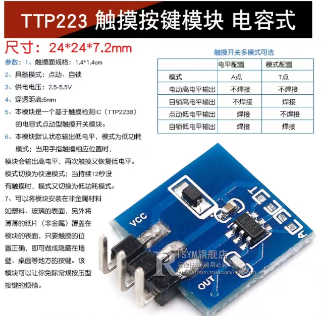

(9) Touch Module (choose one from Microwave Module): [Taobao] https://m.tb.cn/h.UGjp05q?tk=KUrNdNbo4x3 CZ0001 "TTP223 224 226 Touch Sensor Touch Button Sensing Module Capacitive Jog Type Proximity Switch" Click the link to open directly or search on Taobao to open directly.
Buy the one shown in the picture below. The wiring is VDD, VOUT, GND. Connect the touch pad lead to a copper wire leaf. Note that this copper leaf network needs to be independent and suspended.

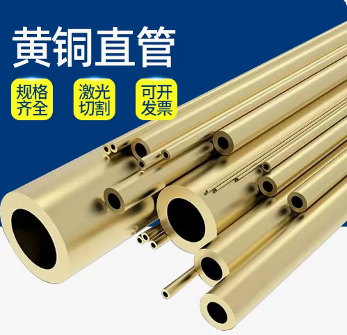

(13) Copper Pipes: [Taobao] https://m.tb.cn/h.UFFvwbm?tk=69bfdNbewLw CZ0001 "H62 Brass Straight Capillary Copper Tube Rigid Environmentally Friendly Hollow Round Tube 2/3/4/5/6/7/8/9/10mm" Click the link to open directly or search on Taobao to open directly.
Body: Buy 4*0.3*half meter (outer diameter 4mm, inner diameter 4-0.2*2=3.6mm)
Body interior: Buy 2.2*0.2*half meter (outer diameter 2.2mm, inner diameter 2.2-0.2*2=1.8mm), internal wiring space = 3.6-1.8mm=1.8mm
Body internal transmission rod: Buy 1.6*0.2*half meter (outer diameter 1.6mm, inner diameter 1.6-0.2*2=1.2mm), which also serves as the sleeve for the petal movable joint, and needs to be cut to the required length yourself.

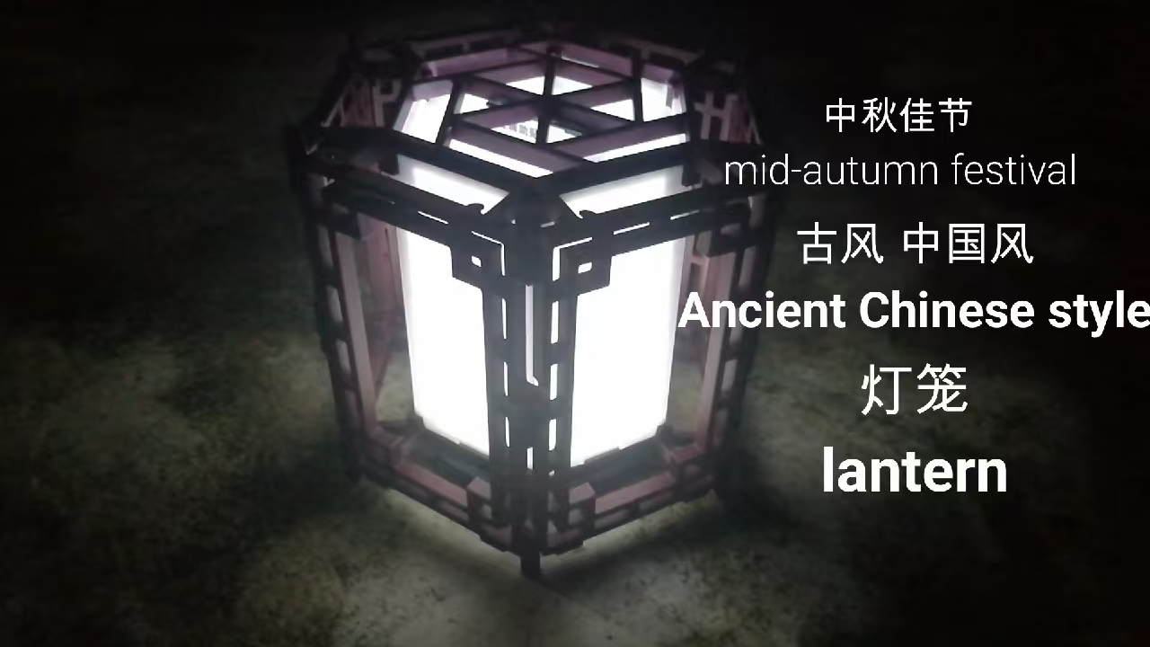

[Open Source] Solar-Powered Traditional Chinese Lantern
This is a traditional Chinese-style lantern designed using a 3D printer. It features a one-piece molded structure, making assembly simple. The single circuit uses an extremely simple solar energy storage circuit, which collects sunlight during the day and automatically lights up at night.
Video Link:
[Homemade Lantern, Chinese Style, Ancient Style, One-Piece Molding, Simple Assembly, Can Be Solar-Powered as a Courtyard Light - Bilibili] https://b23.tv/BT1sKX4
Project Introduction:
This is an ancient style (Chinese style) lantern designed using a 3D printer. It features a one-piece molding structure, simple assembly, and a single-circuit solar energy storage circuit that collects sunlight during the day and automatically lights up at night.
Project Function:
Courtyard or balcony decoration, or a small gift .

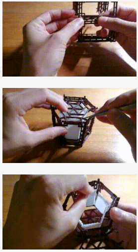

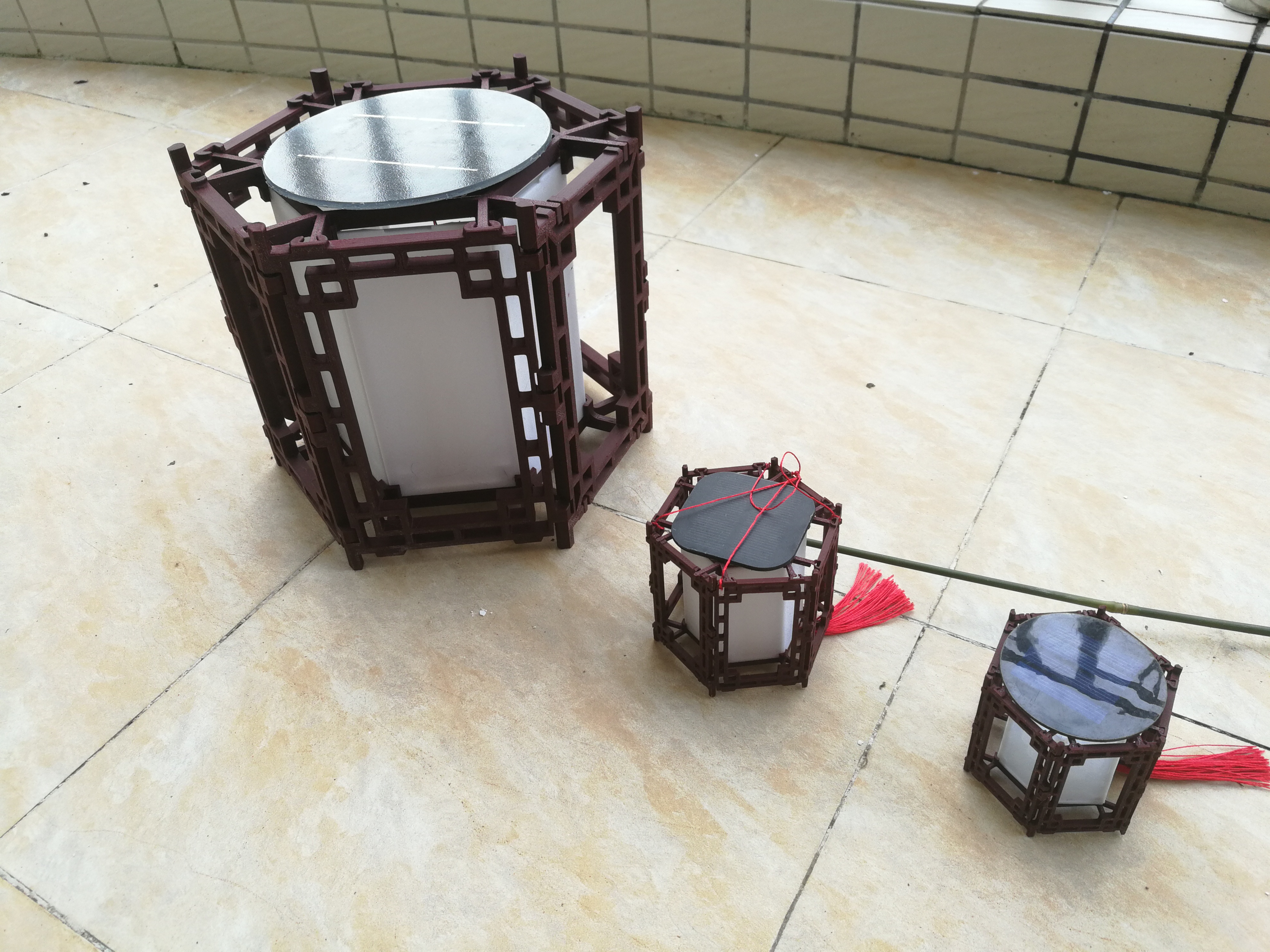

1. Interlock the ends to form the initial structure.
2. Insert the partition to form the inner cage.
3. Snap the top and bottom together to complete the assembly.

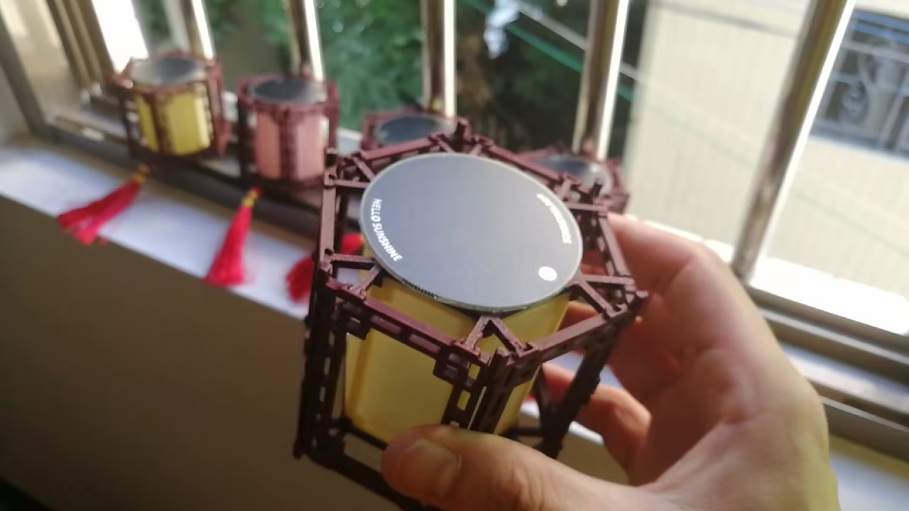

(Image of the actual product)

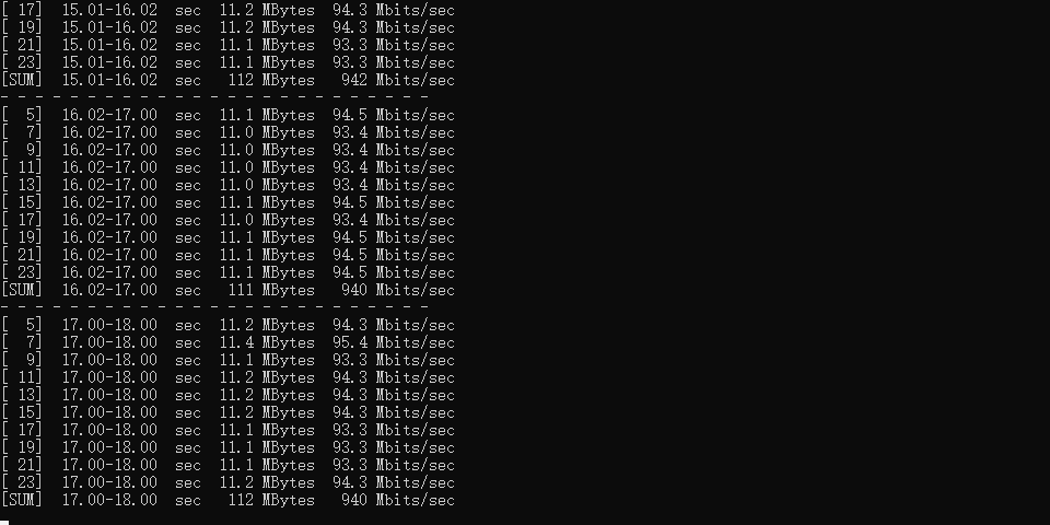

SoftXSW-RTL8367S 4-Electrical-1-Optical Switch
The RTL8367S-based 4-electric + 1-optical switch is compact in size and supports seamless switching between primary and backup power supplies.
I. Introduction
This design was inspired by: https://oshwhub.com/kirito/rtl8367-4ge-2sfp_copy
To minimize the board size, this design uses a large number of 0402 resistors and capacitors. If you are not confident in your soldering skills, it is recommended to use a stencil for soldering. It is suggested to find a vendor on Taobao; a small stencil can be obtained for around 20 RMB.
For ease of soldering, all components are placed on the front side of the board – very thoughtful, isn't it?
A: Yes.

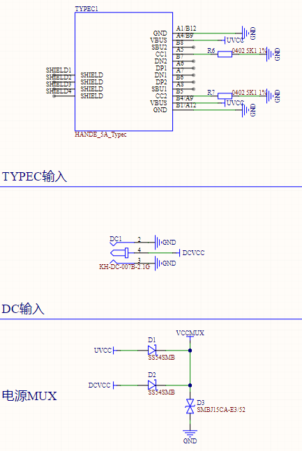

II. Power Supply Section
Based on the above design, the power supply section has been modified:
1. A dual-input interface of TYPEC and DC007 has been designed, supporting main and backup power supply. Two SMB-packaged SS54 microcontrollers are used as a MUX to supply power to the subsequent DC-DC circuit. (TYPEC interface: 0.5 RMB; SS54: 0.07 RMB; both are available on Taobao).
2. The power supply section of the original design was optimized. Due to distrust of the RTL8367S's on-chip DC-DC converter, the required 3V3 and 1V1 voltages are all supplied externally (I love drawing power supplies, and I also love spicy food). The DC-DC power chip was replaced with the inexpensive (0.24 RMB) TPS563201 synchronous Buck controller. This controller supports 4.5-17V input, has a switching frequency of 580kHz, a VFB reference of 0.768V, and a maximum output current of 3A, which is sufficient for this design. To facilitate capacitor parameter adjustment, the input and output filter capacitors in this design use 0805 packages, while the feedback resistors and bootstrap capacitors are 0603 packages. The feedback resistor values ​​are typical values ​​(10K, 33.2K, 4.42K), which can be purchased in most stores. The specific capacitance values ​​of the input and output capacitors are based on TI's webench and personal experience; theoretically, this capacitance is sufficient to support a 3A load.
Due to space limitations, the power supply layout in this design is not optimal. I have tried my best to optimize the power supply layout. If you have a better layout recommendation, you can modify this design accordingly.
