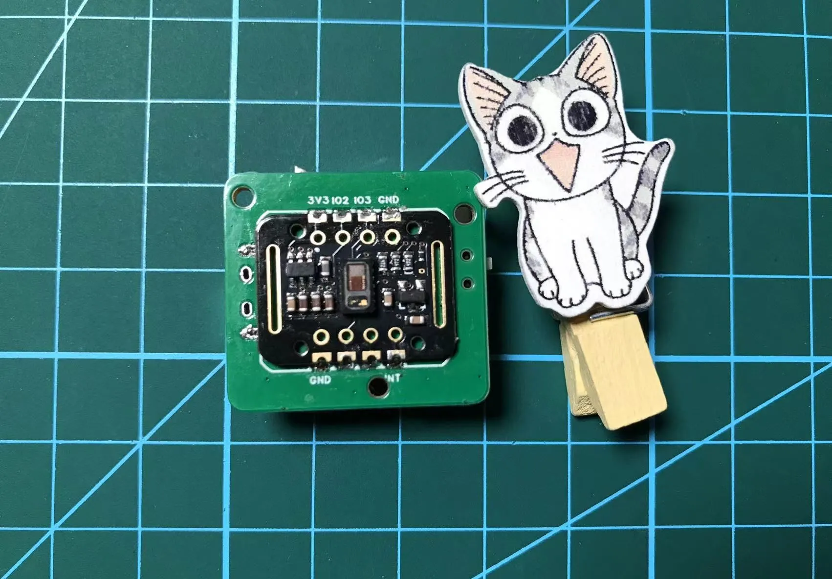

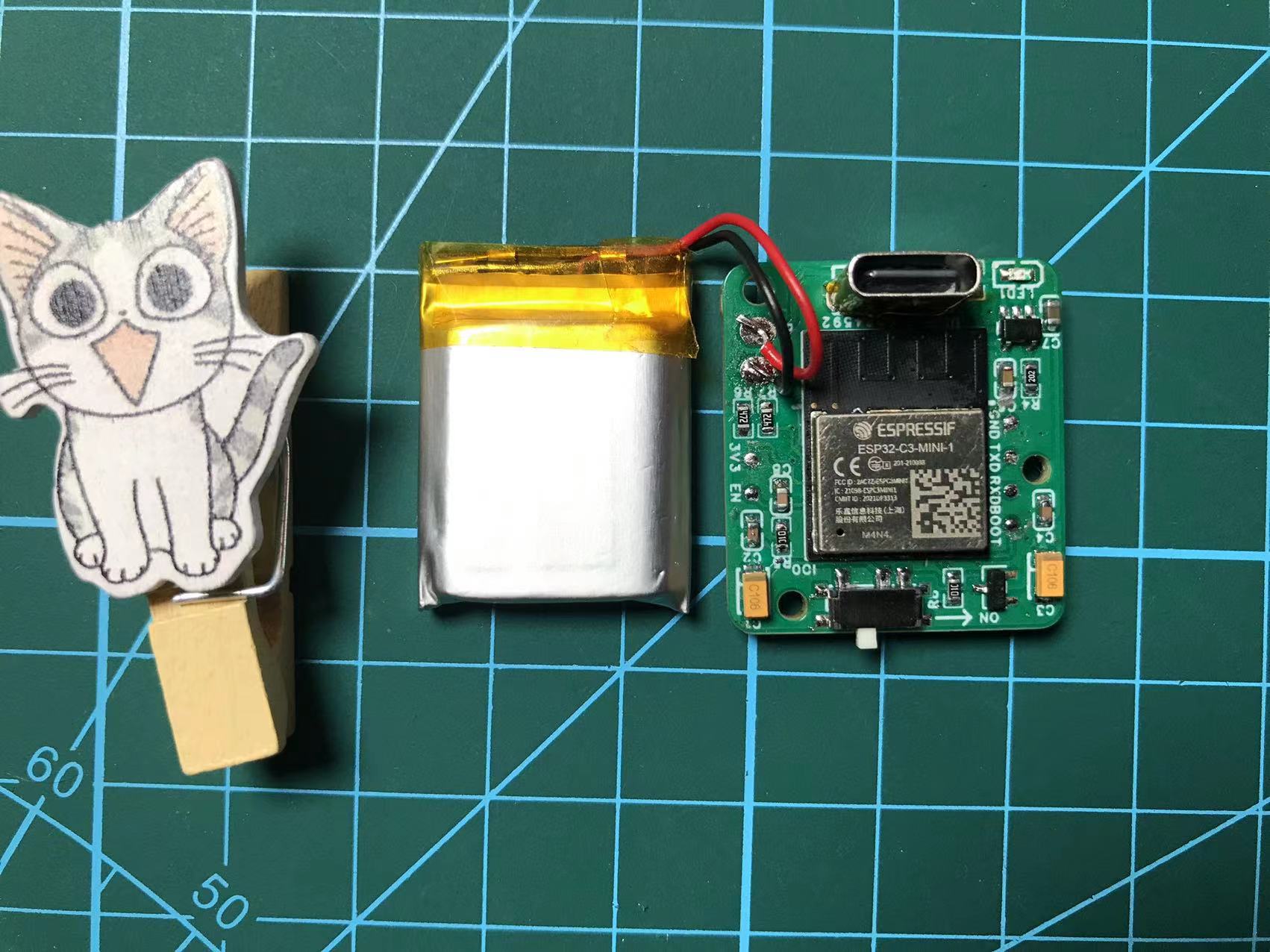

The MCU uses the ESP32C3MINI module, and the sensor uses the MAX30102 module. Structural size and wiring optimization were considered during the design process. The ESP32C3MINI has bottom pins; note that soldering requires a soldering station.
The power supply interface uses a 2-pin Type-C connector from Litai. Note that this device comes in two versions with different pin configurations; please test before use.
The charging section uses a WST4054 chip, which is quite simple and has no additional functions: an LED illuminates during charging and turns off when finished. Since the lithium battery has its own protection board, the protection circuitry is omitted.
No automatic download circuit is designed on the board; for size considerations, only download contacts are provided. (Advertisement: Welcome to use my ESP automatic download board for downloading, https://oshwhub.com/891101a/esp-shao-lu-qi).

The software design references https://oshwhub.com/createskyblue/esp32-web-oximeter
. Note that SCL and SDA must be modified to 2 and 3, respectively, as I am using IO2 and IO3.
Other parts can be modified as needed; they are not mandatory.
The program is not included in the attachments; please refer to the original author's code for modification.

1. Since the ESP32C3MINI has no exposed solder pads, please use a soldering station to solder first.
2. The transistors are relatively small, so you may need to use a soldering iron .
IX. Postscript:
        This ESP32 project was my first time working with it. The difference between what I imagined and the problems I encountered was quite large. First, I drew the wrong diagram and the components overlapped. Then, during the second board fabrication, I found that the programming port was incorrect, so I scrapped it. On the third board fabrication, I found that I hadn't drawn the automatic download circuit, so I started making an automatic programming board (this board is open source and works quite well). When the board finally came back, I could program it, but then I encountered a program problem. After debugging, I found that the battery power would restart, seemingly due to insufficient current. During this time, I also encountered the problem of the 2-pin Type-C USB and the package pins being reversed. One pitfall after another, one problem after another, the road to practice is full of challenges.
