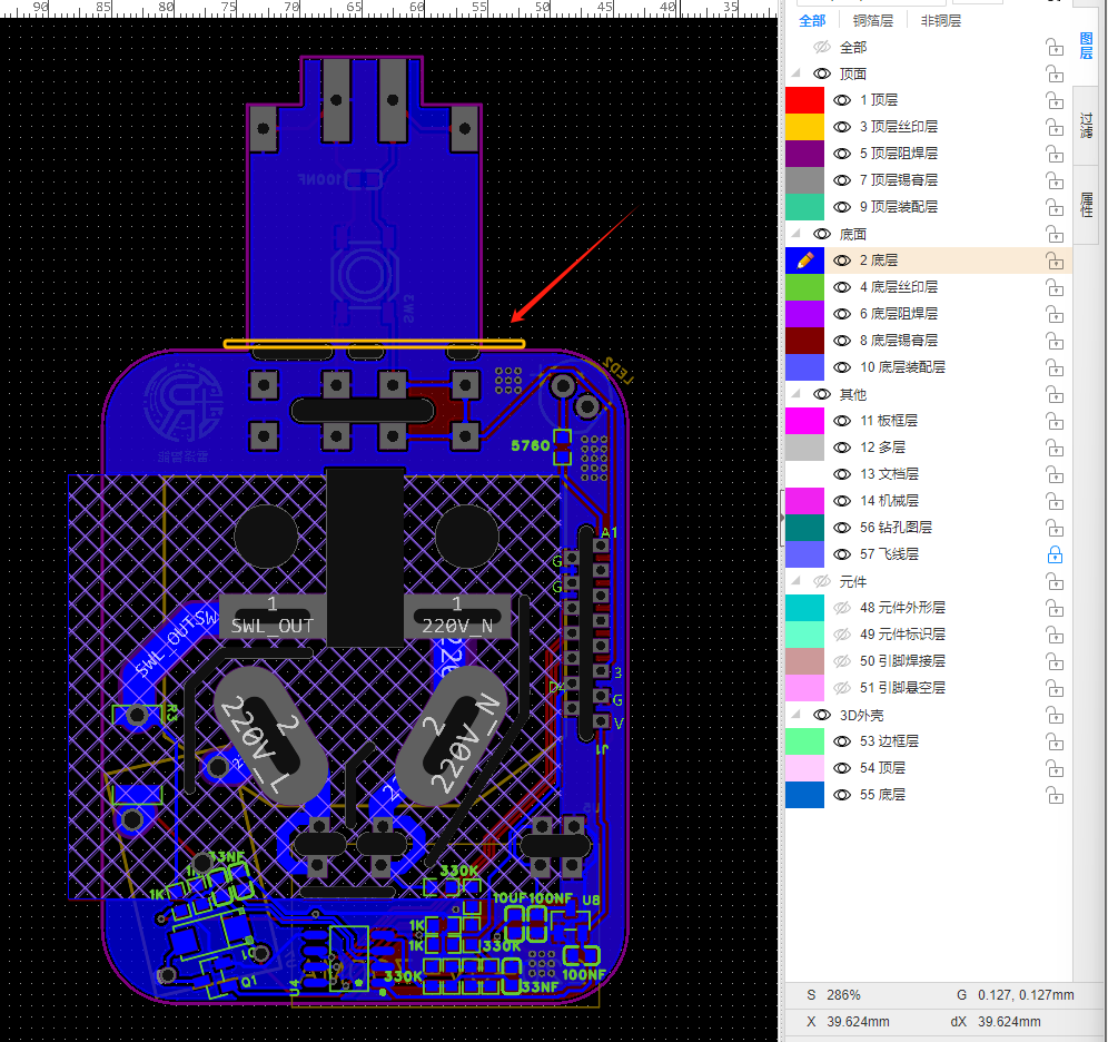

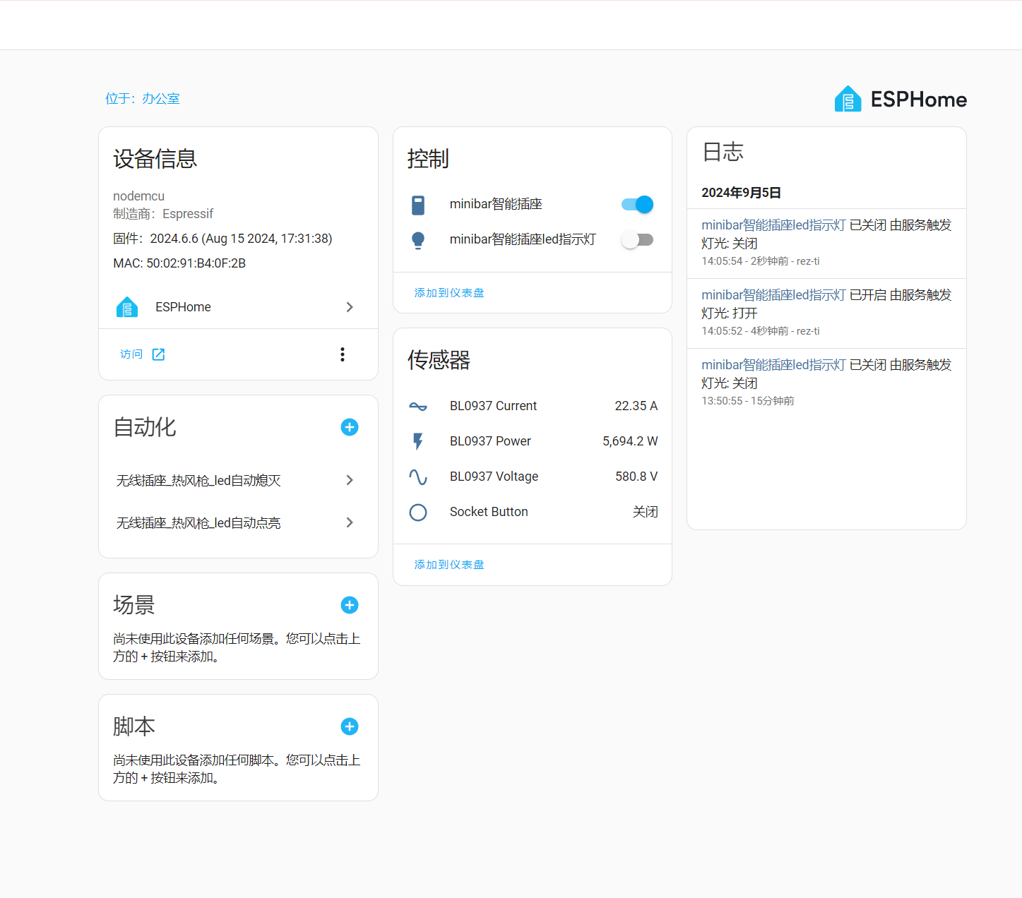

Last week, based on the BL0937 documentation, I updated the power supply and metering chip routing. After testing today, both voltage and current are displayed stably; and the YAML file and calibration values ​​have been updated.

Special note: The metering function is not calibrated. Other functions are normal and usable. However, adjusting the metering function may affect the circuit design. If you don't mind, you can try replicating it. I'm posting it now, hoping some experts can help guide me!

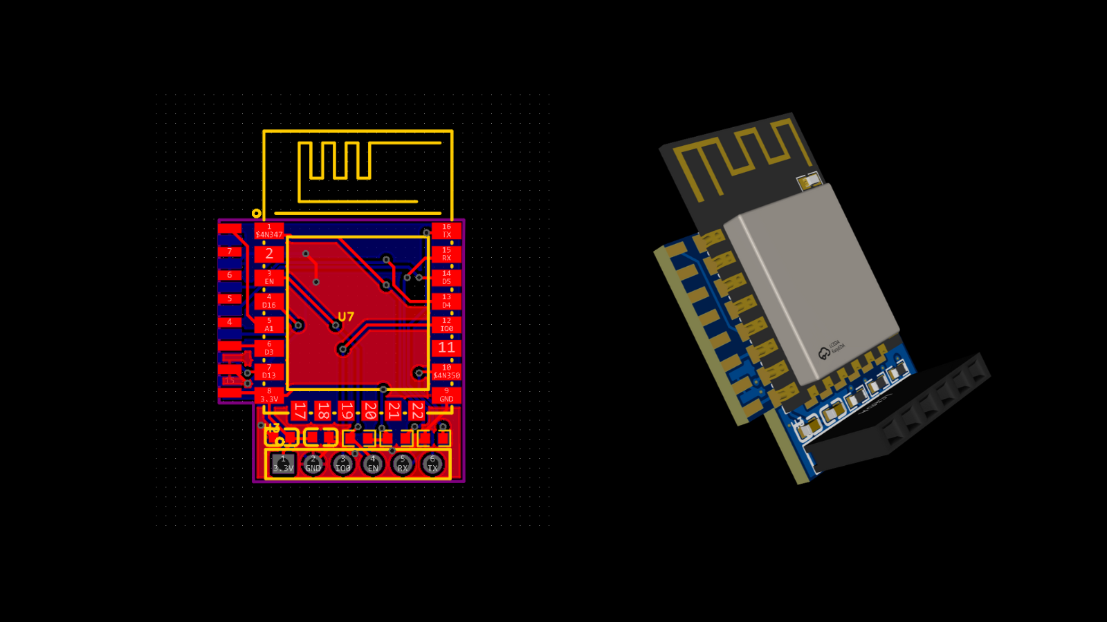

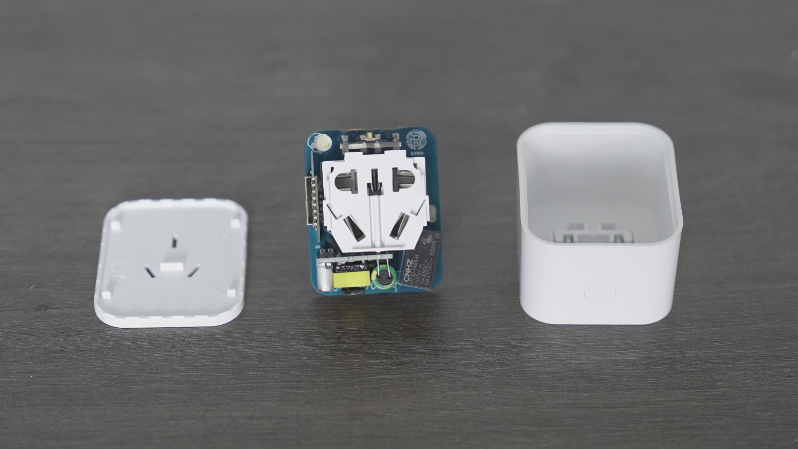

I wanted to replicate a metering socket, but coincidentally, two classmates used two different shell molds on the market. After using 520world's PCB design, converting it to a metering version requires using oldfox's metering circuitry. I had to assemble it manually.
Fortunately, after half a year of learning and exploration, and wasting countless PCBs, I've finally grasped the basic principles of PCB design. After two mistakes, I finally succeeded in replicating the metering circuitry onto the original circuitry in terms of hardware. I also modified the 8266 chip layout and power supply location (I had indeed blown one up before). The first version of

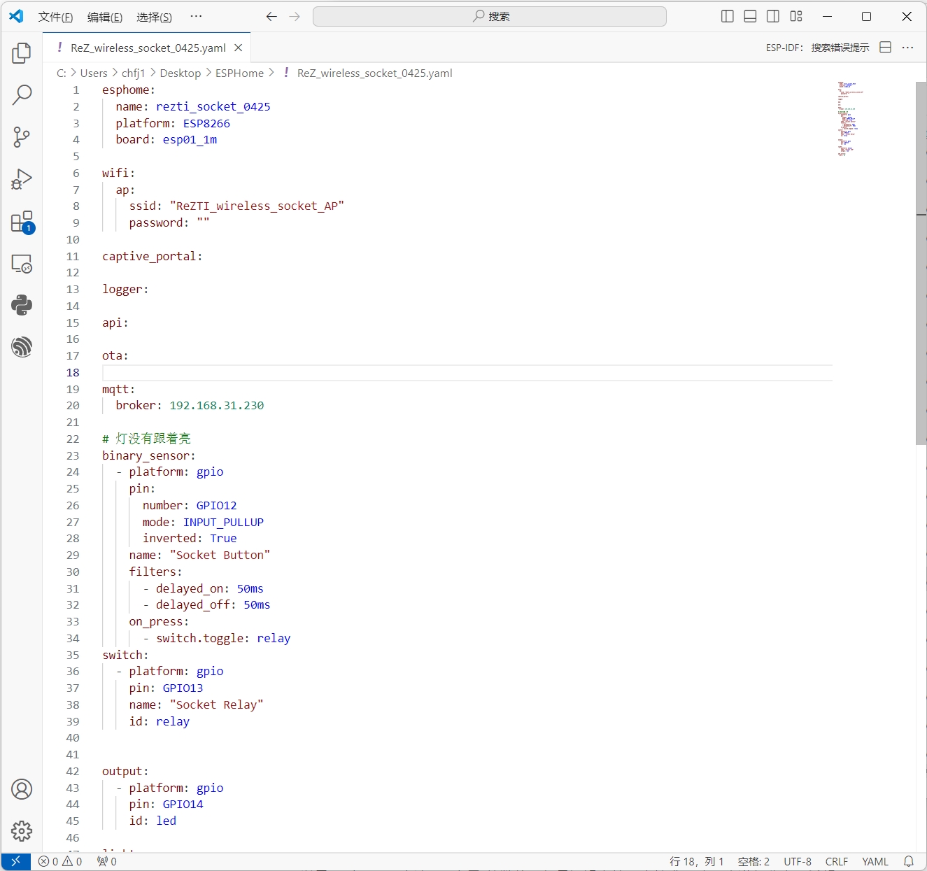

For software, I used ESPHOME, which is better than Tasmota because it makes it easier for beginners to learn the code.

and I'm currently learning about metering calibration, as I haven't yet grasped the underlying principles. Any
guidance from experts would be greatly appreciated.

2024.8.30 V0.2.0: Completed the hardware replication of the metering socket and optimized the circuit design; the updated ESPHome code can display "voltage," "current," and "power" values, but the calibration process is still not fully understood. I'm sharing this now in the hopes of receiving guidance from experts.

ESPHome's code (more accurately, the YAML configuration file) is very suitable for beginners. I'm sharing my source code and bin file with everyone;
the source code is for beginners to understand ESPHome's configuration logic
, and the bin file can be used directly for flashing. After flashing, refer to the usage tutorial.
Note that
the metering is currently uncalibrated; I'm still exploring it. However, it works fine as a normal smart switch. I'll update the bin file and provide it to everyone after I figure out how to calibrate it. OTA upgrades are available.
