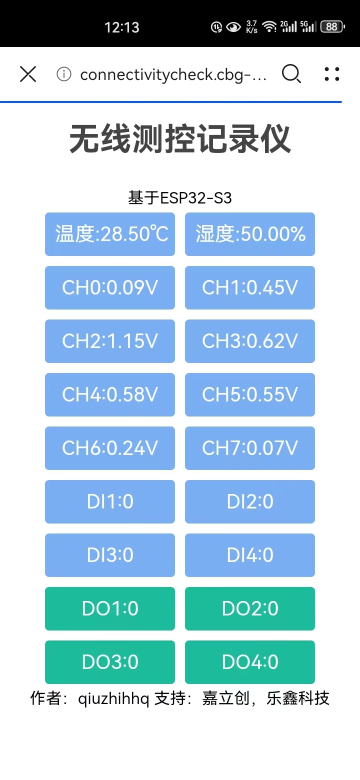

Screenshots of real-time ADC, DI, DO, and temperature and humidity data from the wireless monitoring recorder accessed via wireless network are shown below:
This design establishes an AP hotspot using ESP32-S3, then forces a portal jump to the monitoring interface. After connecting to the wireless monitoring recorder, it automatically jumps to the real-time data monitoring webpage. Alternatively, after connecting to the hotspot wireless network emitted by ESP32, the data monitoring webpage interface can be accessed manually by entering 192.168.4.1 in the browser.

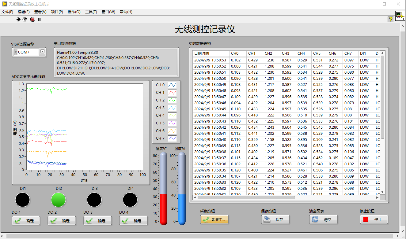

In addition, the author also developed a LabVIEW data monitoring system software to support the wireless measurement and control recorder. Screenshots of the software operation are shown below:

* This design is accompanied by a LabVIEW host computer that can collect complete monitoring data in real time and save the data to the computer;

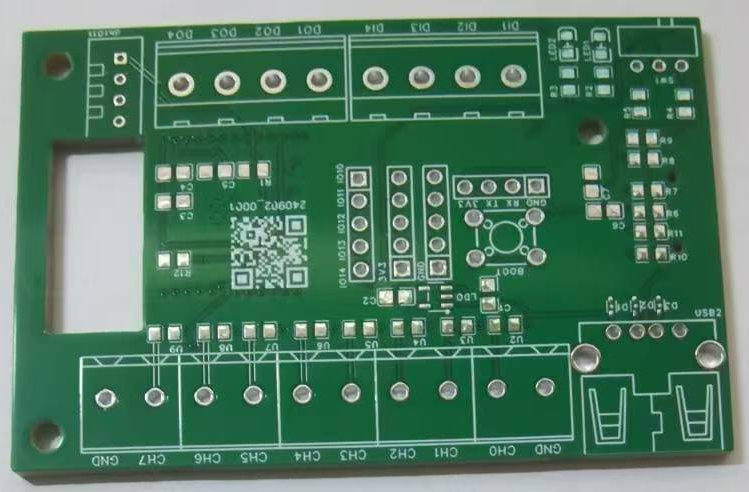

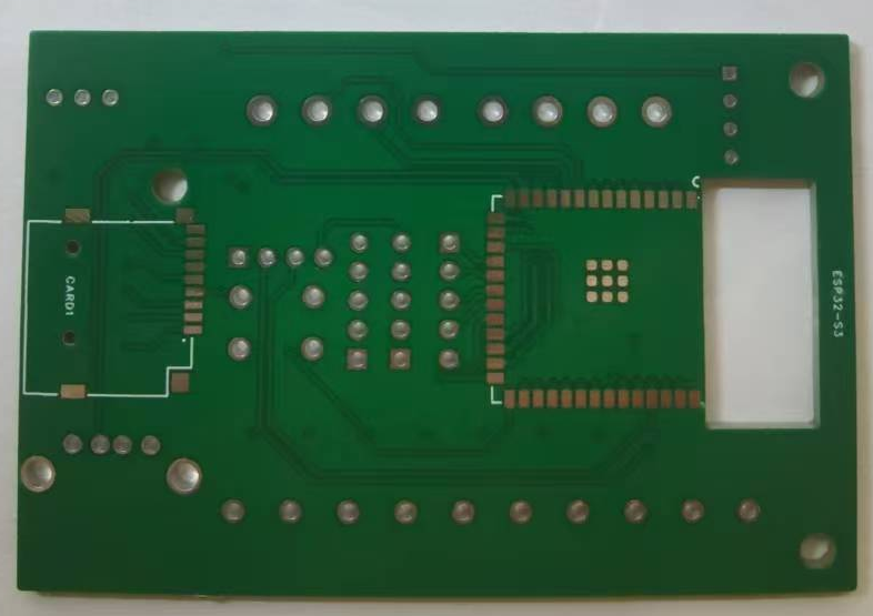

2. PCB LAYOUT Design:
The layout uses a four-layer board design. After the design is completed, check that the DRC is error-free and then directly place a free sample at JLCSC. The actual PCB design is shown below:
Front:
Back:
(The PCB can be directly ordered from JLCSC PCB through LCSC EDA.)

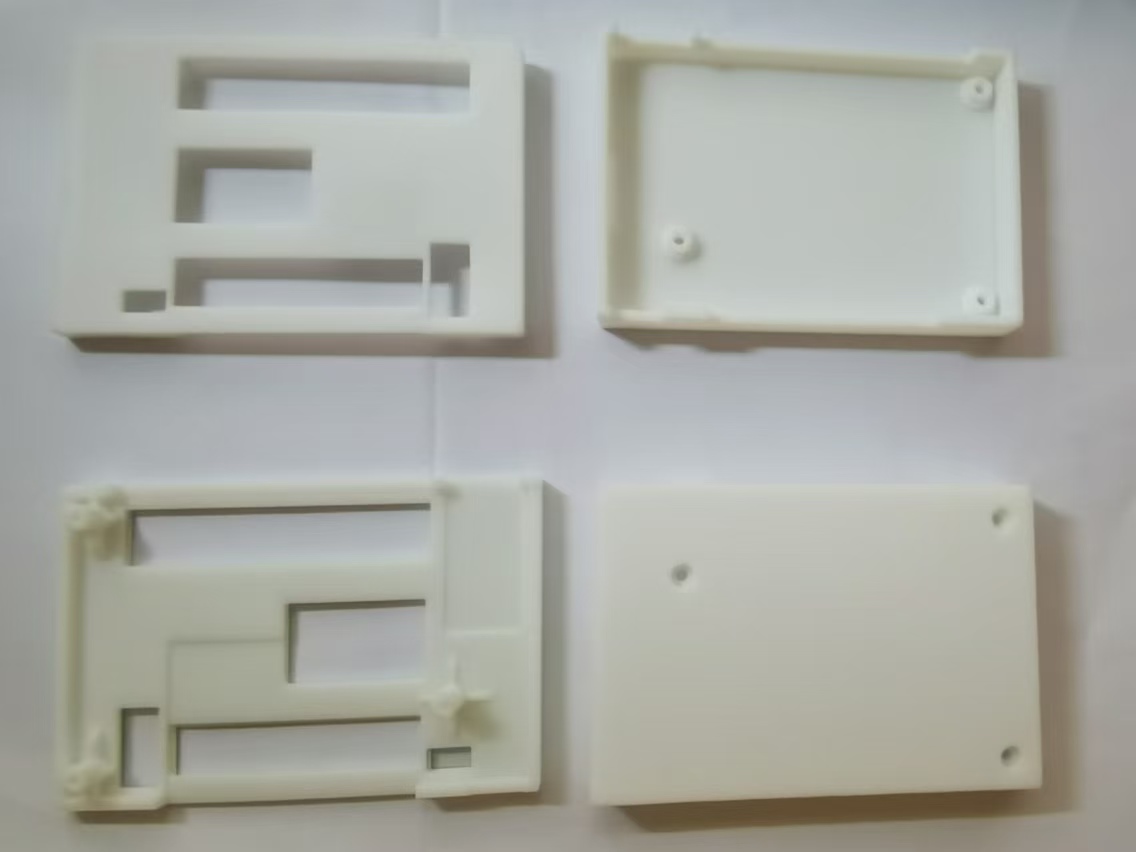

3. 3D Shell Design:
After the PCB layout is completed, the 3D shell can be designed on this basis. The 3D model can be previewed in real time on LCSC EDA and can be directly 3D printed at JLCSC. The actual product is shown below:
(The 3D shell can be directly ordered from JLCSC 3D Printing through LCSC EDA.)

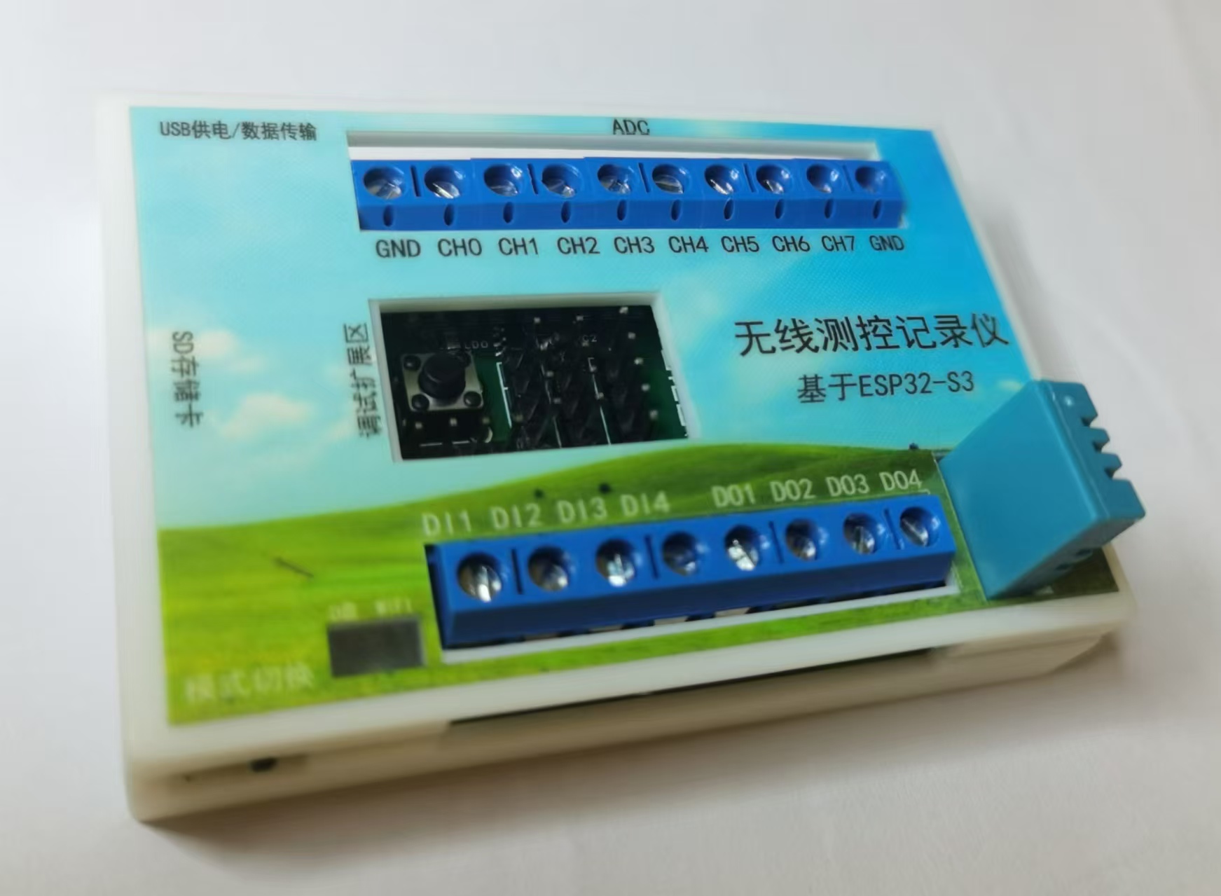

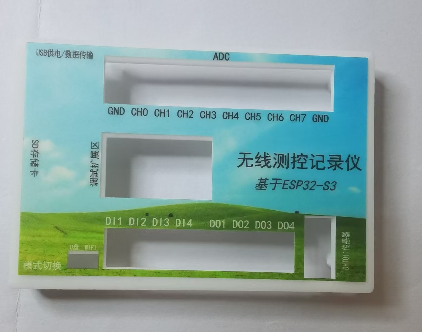

4. Panel Design:
LCSC EDA can also be used to design panel stickers for instruments and meters. The original panel design is available in Design Drawing - Panel_1 - Panel. The actual product image is shown below (3D shell surface sticker):
(The panel can be ordered directly from LCSC EDA to the LCSC online store, and components can be linked for shipping to save on shipping costs.)

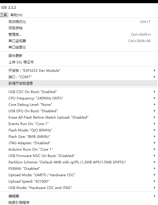

it is important to note the Arduino settings for the development board. Only by correctly configuring and enabling USB CDC can the ESP32 S3's built-in USB port be used for programming and data communication. The following screenshots are provided for reference: Notes:

During Arduino programming, the serial port may be recognized, but programming may fail with a "cannot connect to serial port" message. In this case, open the computer's Device Manager, right-click and uninstall the corresponding hardware serial port, then re-plug and re-plug the USB.
LabVIEW host computer recognition of serial port data requires the NI-VISA module to be installed beforehand. Additionally, version 2018 or later is required to open vi files correctly;
If the computer cannot recognize the USB, resulting in programming failure, try pressing the BOOT button and then re-plugging the USB. This will allow the computer to recognize port COM7 again;

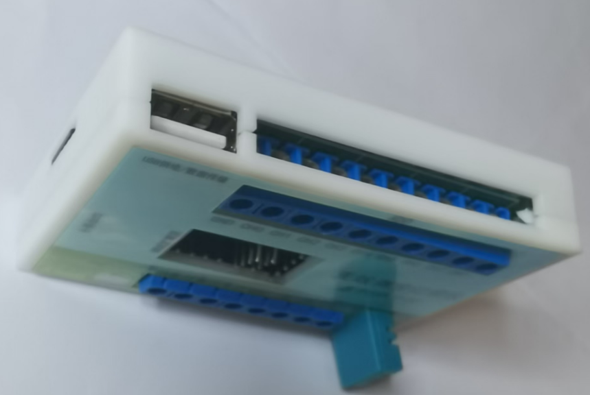

Assembly Process:
1. First, solder the surface-mount resistors on the front, then solder the pin headers and terminals, and finally solder the SD card slot and ESP32-S3 module on the back.

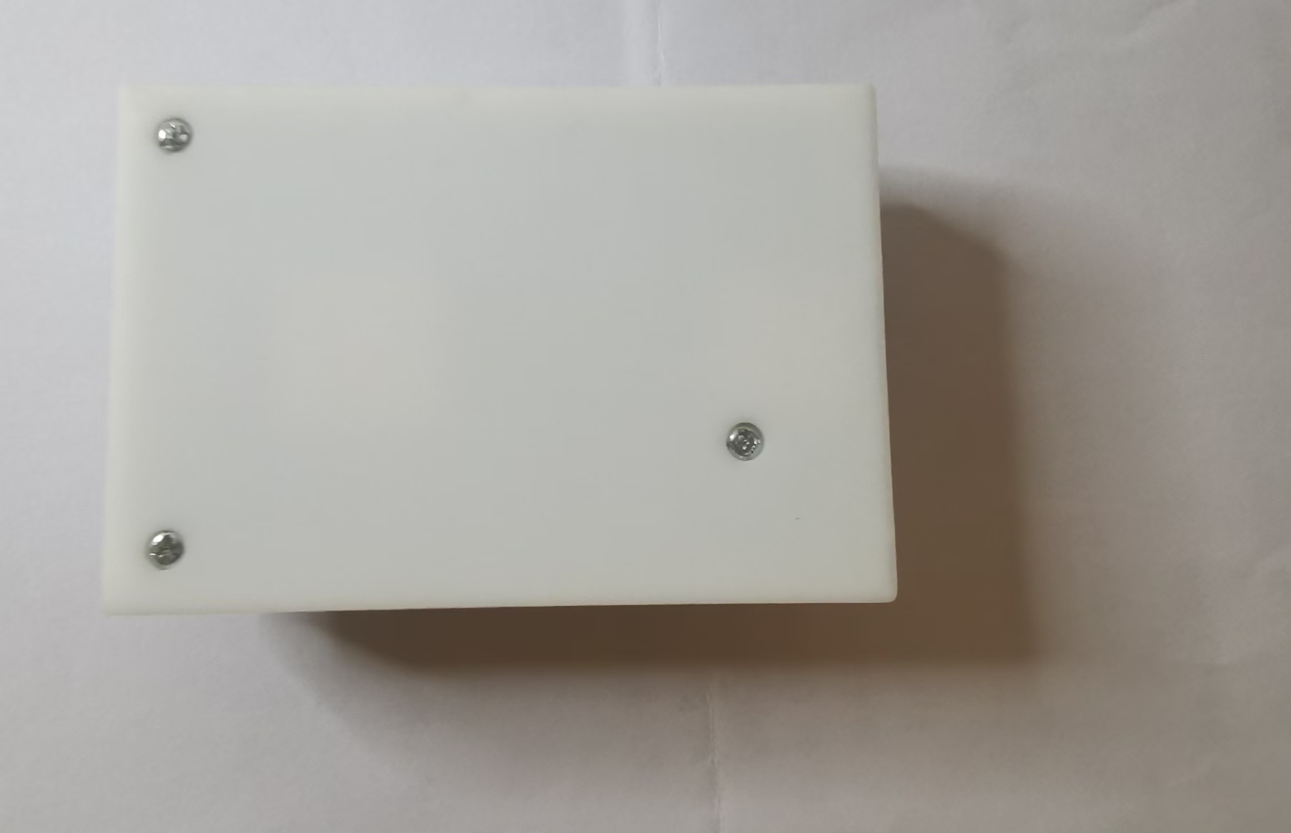

2. After soldering, place the module into the bottom 3D housing. Note that the 3D housing has a small margin around the edges, so you need to insert it slowly and completely.
3. The screw posts on the top 3D housing are too long; you can shorten them with needle-nose pliers. Then, apply the panel sticker to the top 3D housing. Pass the DHT011 sensor and ADC, DI, and DO terminals through the panel.
4. After the top and bottom housings are in place, flip the module over and tighten the three bottom screws in sequence. Complete assembly photos:

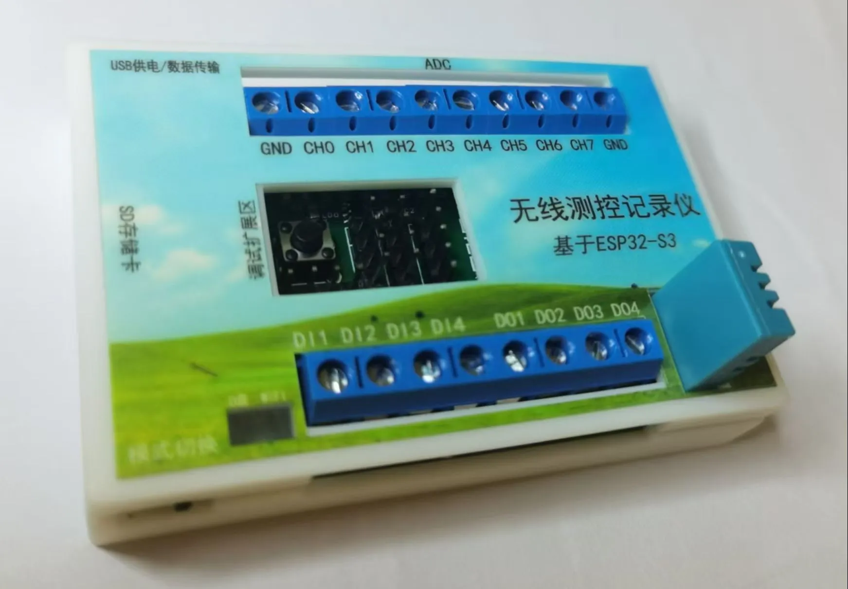

Front view: Side view: Back view:
