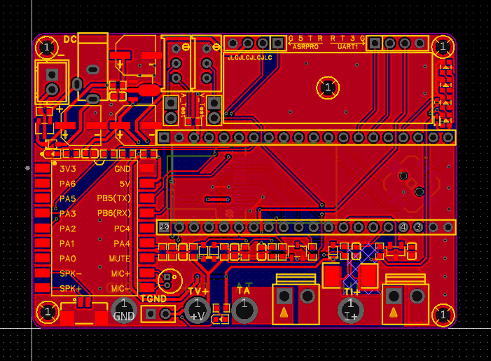

Optimize layout and wiring, so that the PCB area is controlled within 50mm*72mm, making it more portable. Use 3D printing to customize the shell, making the work more practical.

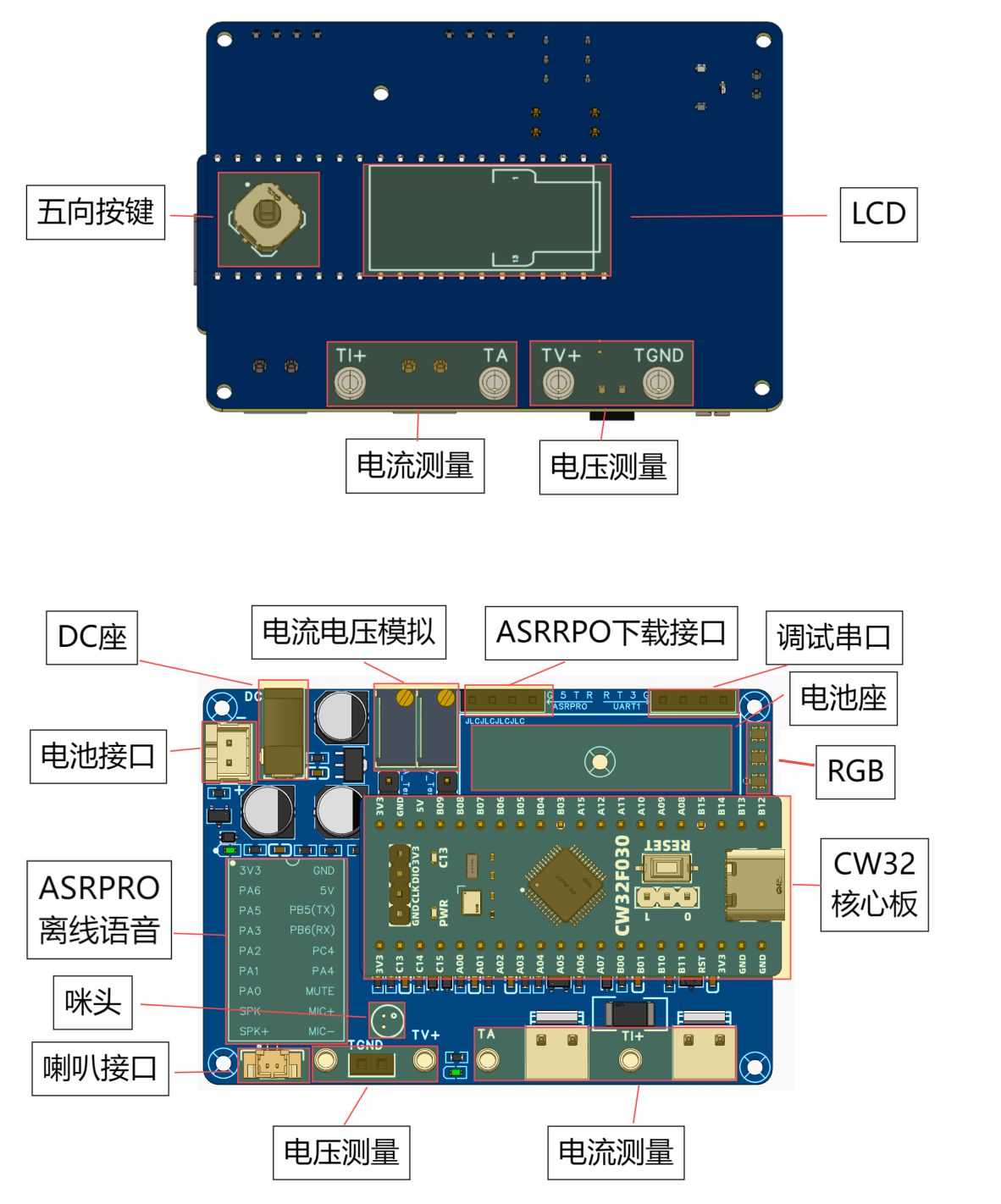

IV. Hardware Design
The main body is designed based on the reference case. Please refer to the case for specific principles. The following is an introduction to my circuit.

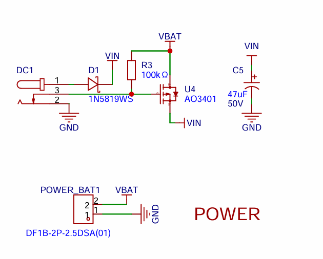

4.1.1 Power Input
The project supports both DC power and 12V battery power input. Compared to the example circuit, this one adds a MOSFET as a switch. When both DC power and a VBAT battery are connected simultaneously, the MOSFET is off, and the system uses DC as the power source.

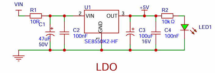

4.1.2 The LDO circuit
is the same as the example. Here, the capacitors are changed to surface-mount capacitors. An LDO is used as the power source. Considering that most voltmeter products are used in industrial scenarios with 24V or 36V power supplies, this project chose the SE8550K2 with a maximum input voltage of up to 40V. The main reason for not using a DC-DC step-down circuit to handle large voltage differences is to avoid introducing DC-DC ripple interference during the design process; a secondary reason is to reduce project costs.

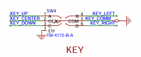

4.2 Five-way button

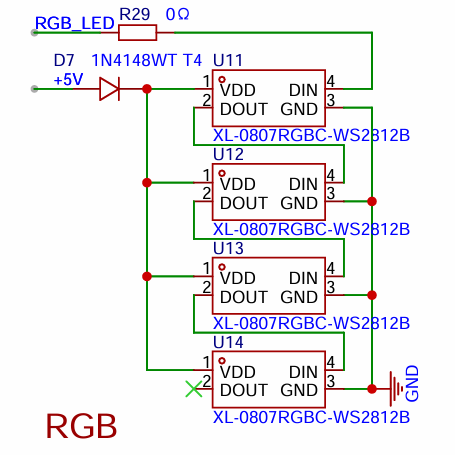

4.3 The RGB
WS2812 is a digital LED that uses single-wire serial communication. Each LED contains red, green, and blue light-emitting diodes and has a built-in control chip. Control signals are transmitted through a single data line, and the data is encoded using pulse width modulation (PWM) to determine the LED's color and brightness. Signals are passed from one LED to the next, forming a cascading effect. Four LEDs are cascaded here, powered by 5V. Actual debugging revealed that diodes improve data stability. DIN is directly connected to the microcontroller's I/O output.

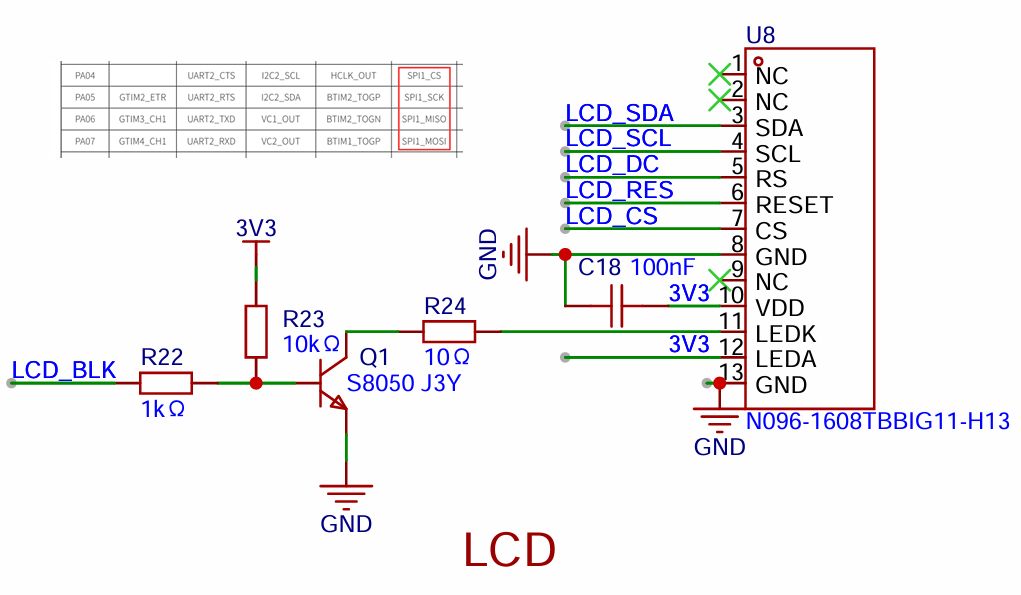

4.4 The LCD circuit
references the manufacturer's application circuit design. Hardware SPI1 is used for driving.

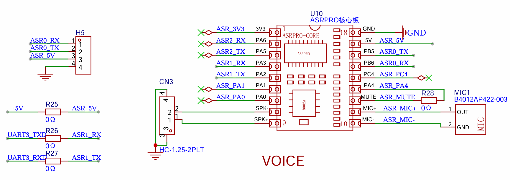

4.4 The offline voice circuit
uses ASRPRO, which is powerful and costs around 9.9 (mainly because it's cheap...).
Serial port 0 on the core board is used for program download and debugging, and serial port 1 of ASR1 is connected to the microcontroller for communication control .

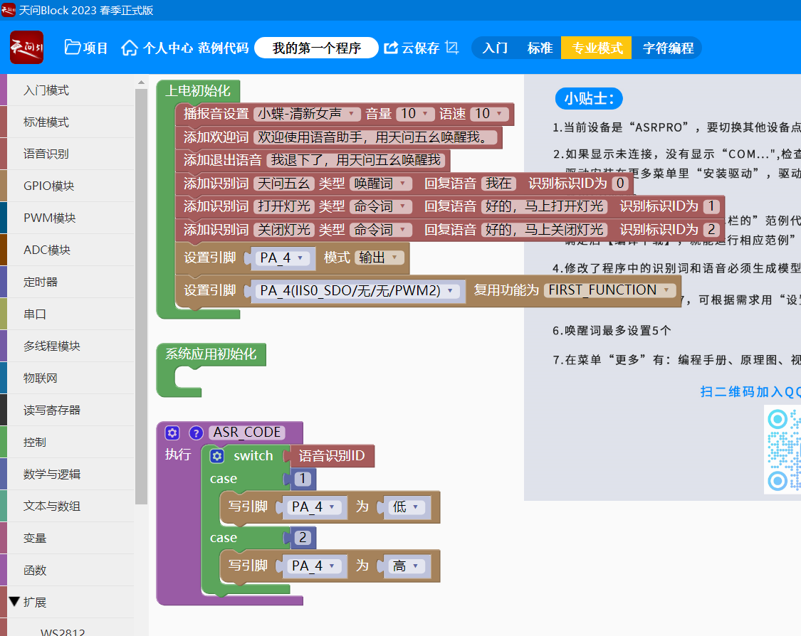

5.2. ASRPRO Program
The ASRPRO program is developed using the accompanying Tianwen Block, and the software includes user documentation. It supports graphical programming and is easy to learn.
Drag and drop is not as fast as typing, so I'll use character-based programming here. The code is already integrated with FreeRTOS, so you can use it directly.
Create a thread to process the data received from the serial port. Note that to play audio, you need to wake up `enter_wakeup();` first.
The main code is as follows.

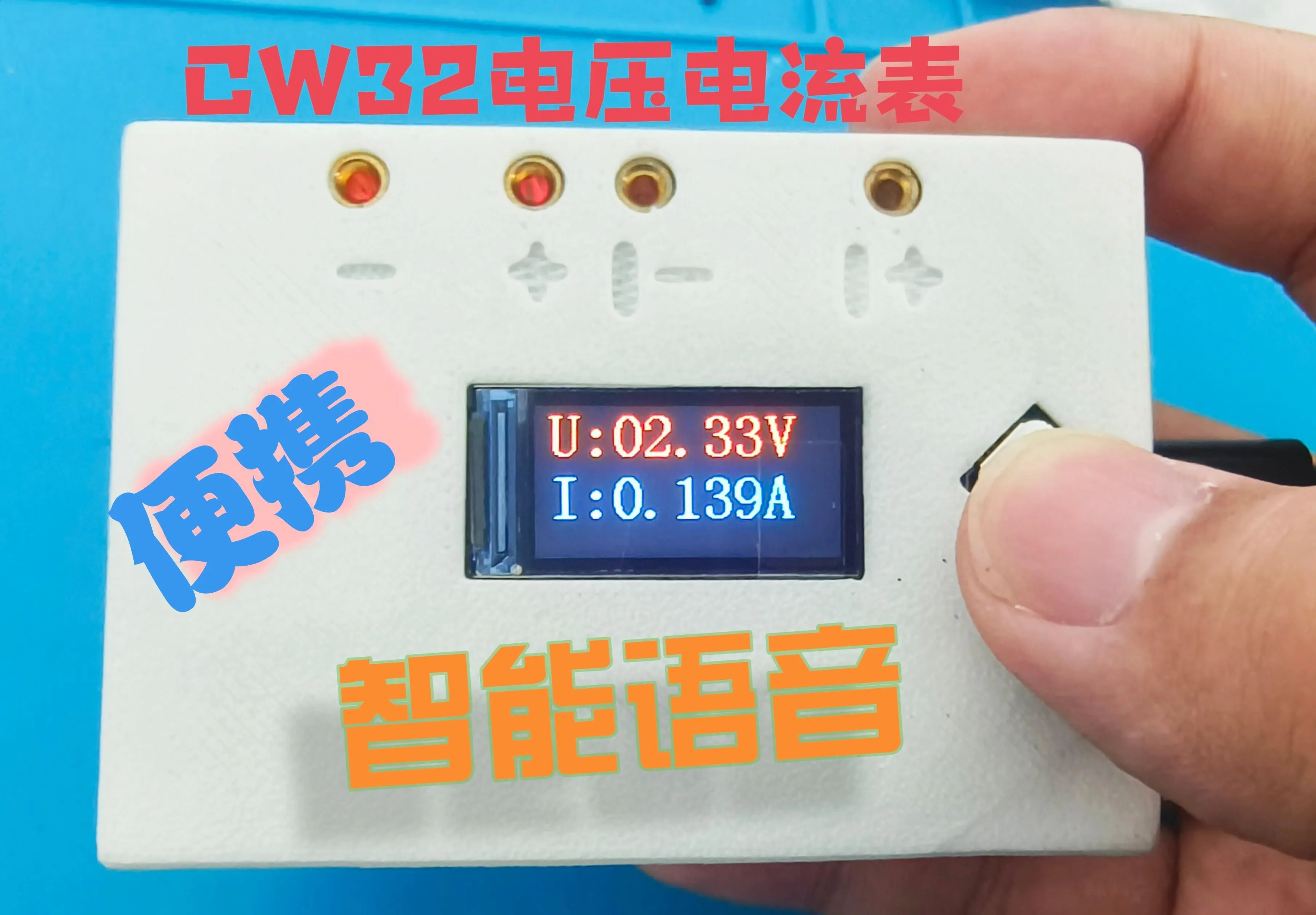

VI. Demonstrating
the PCB layout

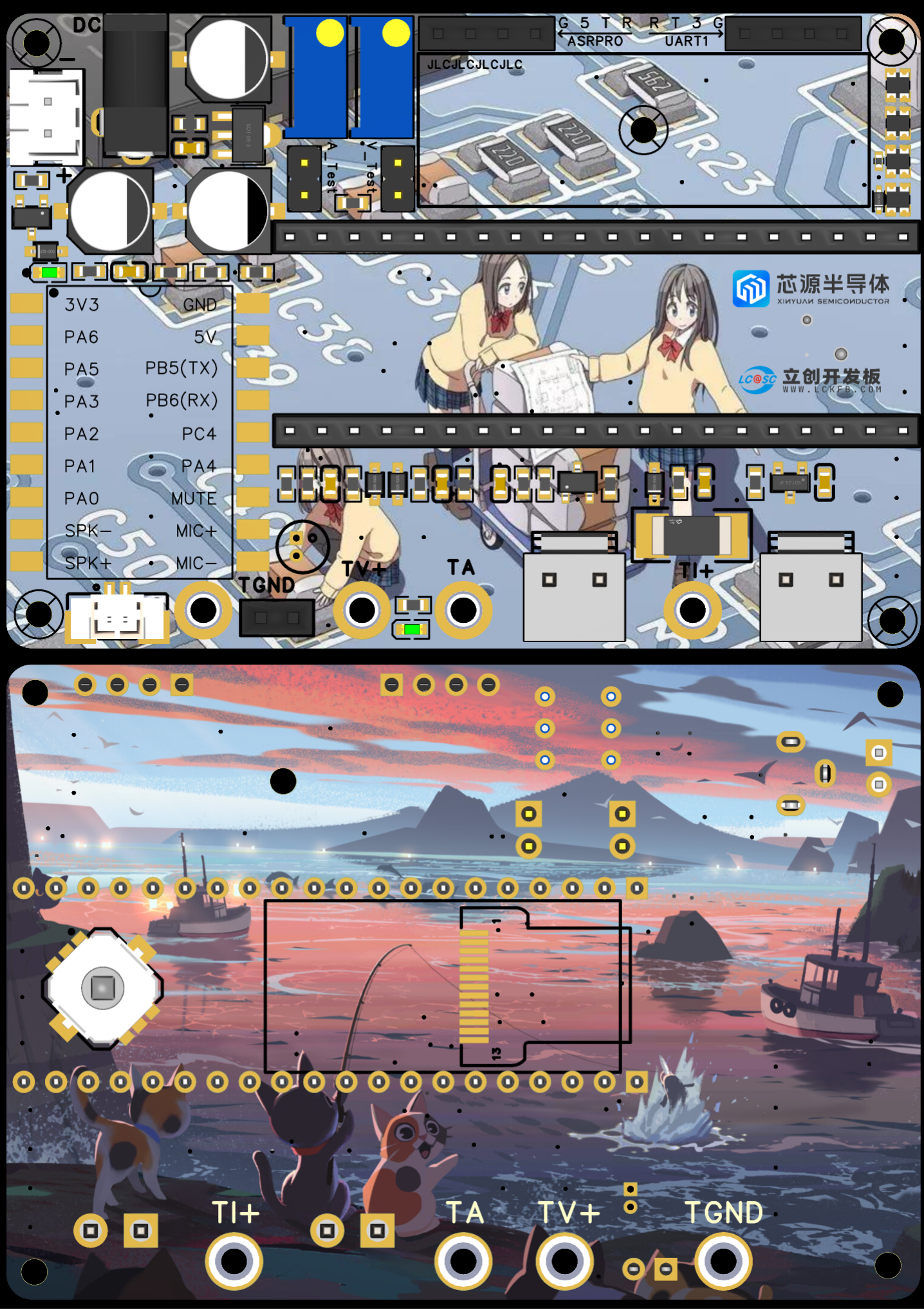

rendering:
The color silkscreen is really sweet and beautiful.

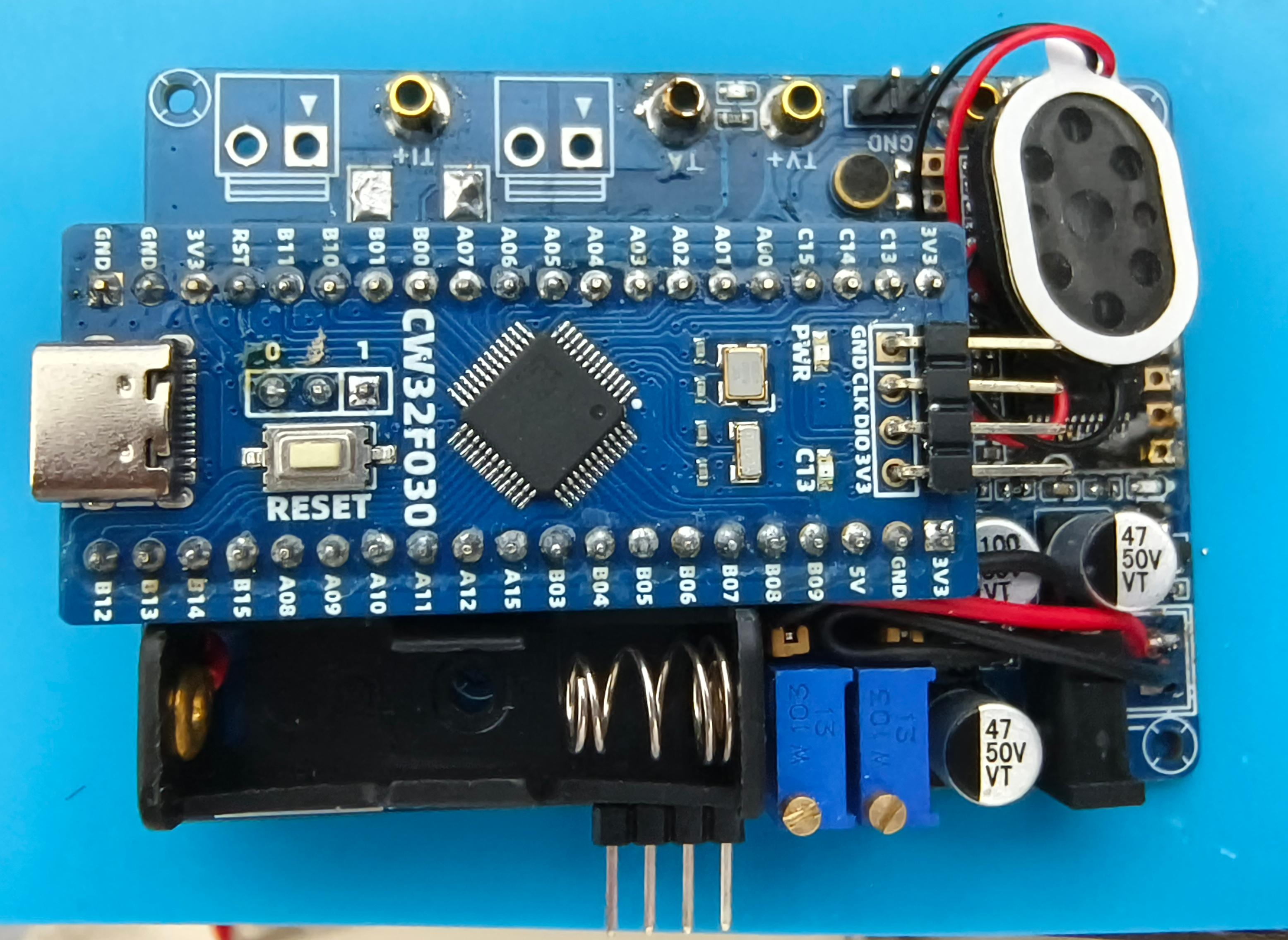

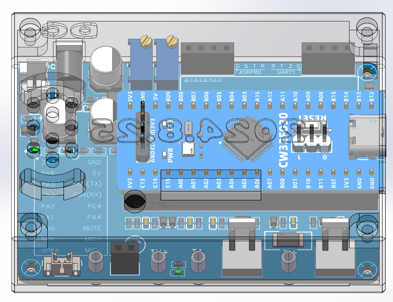

In order to achieve the coordination and unity of the small blue board, the blue board was soldered first.
The blue board was debugged first, and then the color silkscreen was soldered after it was determined. Sigh~

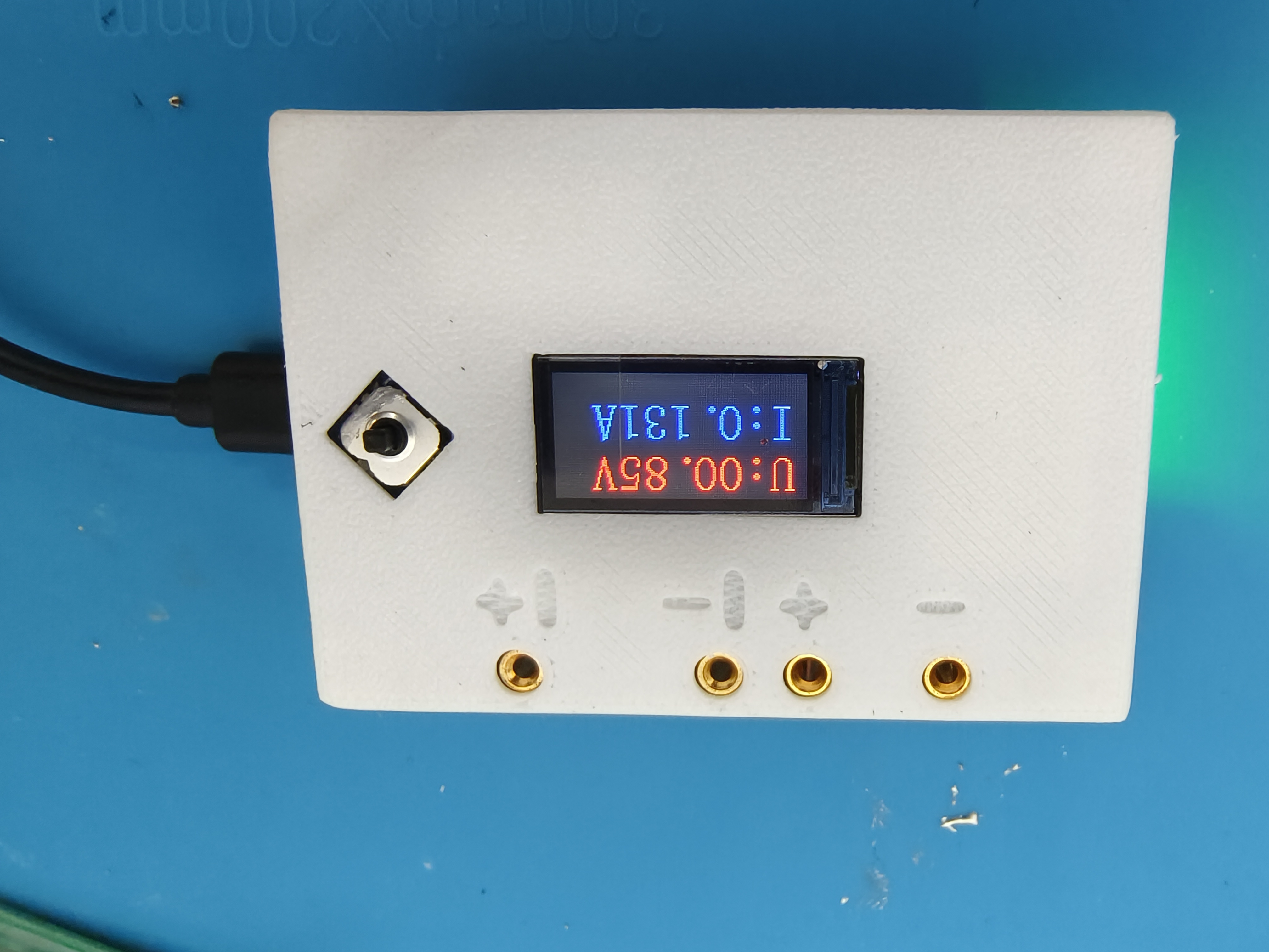

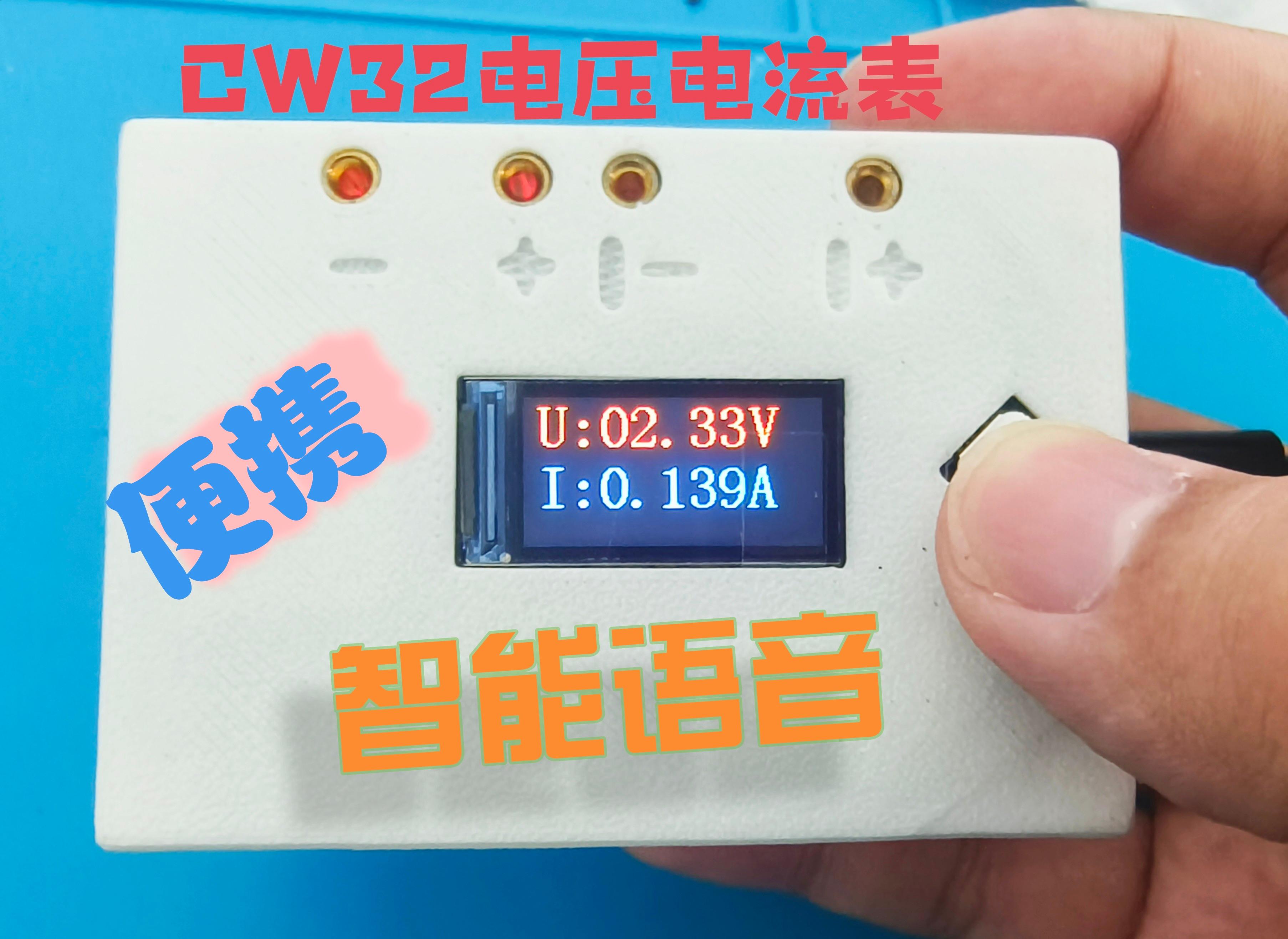

The shell model rendering and
physical display

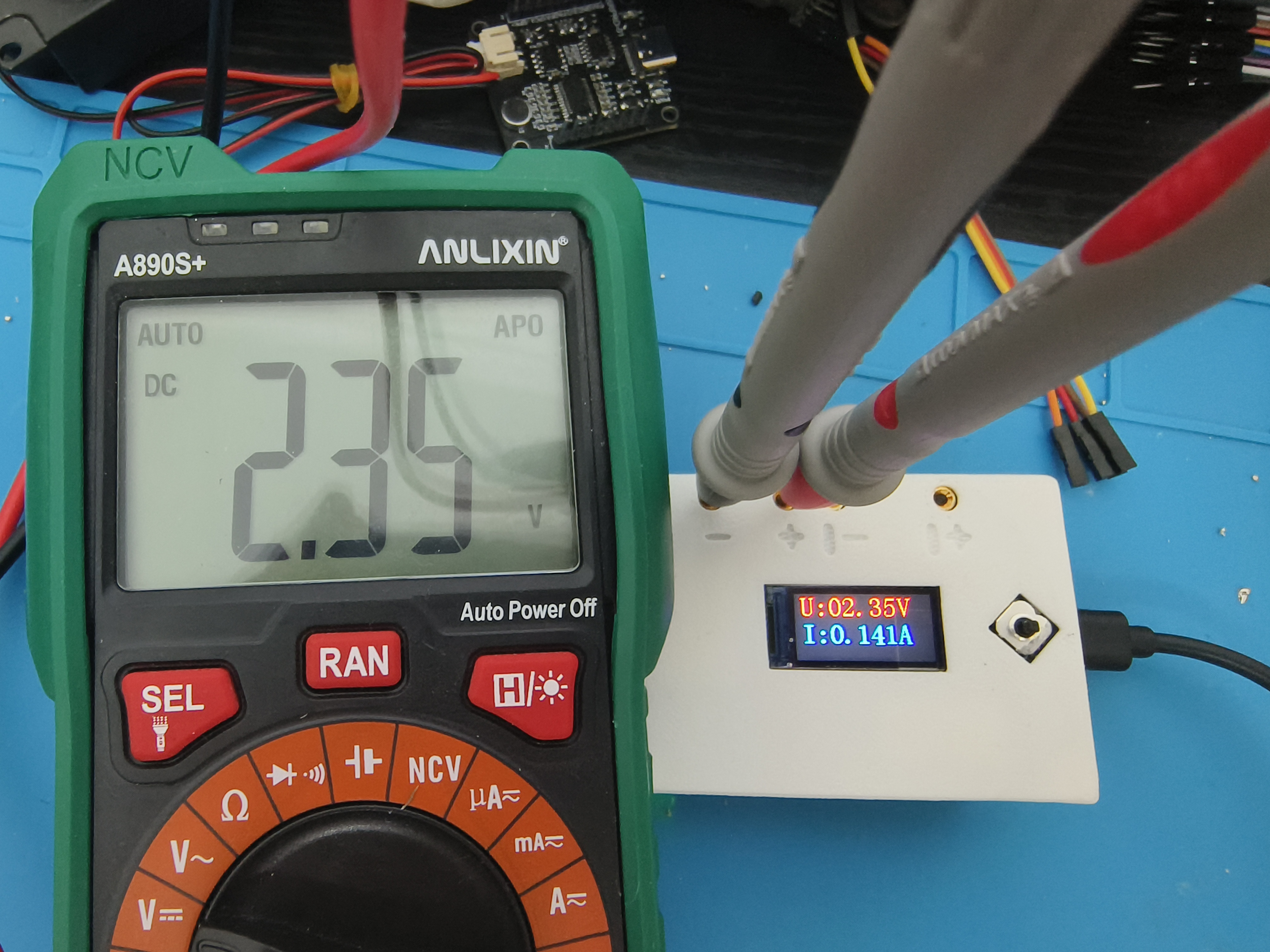

are compared with my own multimeter. This ADC is pretty awesome.
