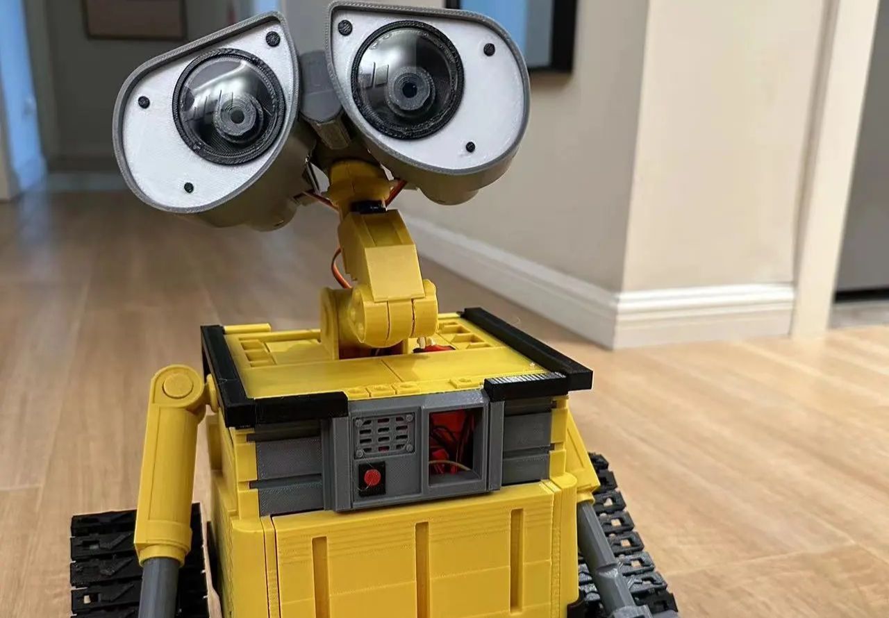

WALLE Circuit Board
Core Components: ESP32 Microcontroller: As the brain of the circuit board, the ESP32 provides powerful processing capabilities and wireless communication functions. It supports Wi-Fi and Bluetooth connectivity, enabling the circuit board to easily connect to the internet for remote control and data transmission. Arduino Compatibility: The circuit board is designed to be compatible with the Arduino development environment, meaning users can leverage the rich Arduino library and community resources to quickly develop and deploy various applications.
Features:
Precise Control: The circuit board can precisely control the robot's movement, including speed, direction, and posture, ensuring accuracy and stability when the robot performs tasks.
Multi-Sensor Support: The circuit board has reserved multiple GPIO interfaces, supporting the connection of various sensors, such as temperature sensors, for environmental perception and data collection.
Wireless Communication: Through built-in Wi-Fi and Bluetooth modules, the circuit board can achieve wireless connectivity with smartphones, tablets, or other devices, facilitating remote operation and monitoring.
Expandability: The circuit board design considers future expansion needs, providing additional interfaces and space so users can add more functional modules according to project requirements.
Those who watched the movie "WALL-E" in their childhood must have dreamed of owning their own WALL-E. This tutorial will guide you through building your own WALL-E robot, starting with the materials and control program you need. I think no boy can resist this little robot toy that integrates sound, light, electricity, and movement. Make one with your child during winter break, and the neighbor's kid will be green with envy!
