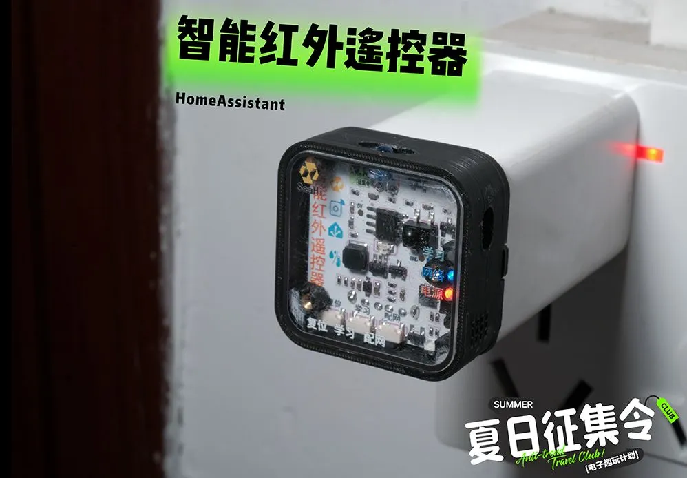

Project Description:
HomeAssistant is currently the most playable open-source smart home platform, offering highly flexible and intelligent automation configuration. The smart infrared remote control connects to the HomeAssistant platform as a WiFi smart device, allowing remote control of home air conditioners, fans, lights, and other infrared smart devices.

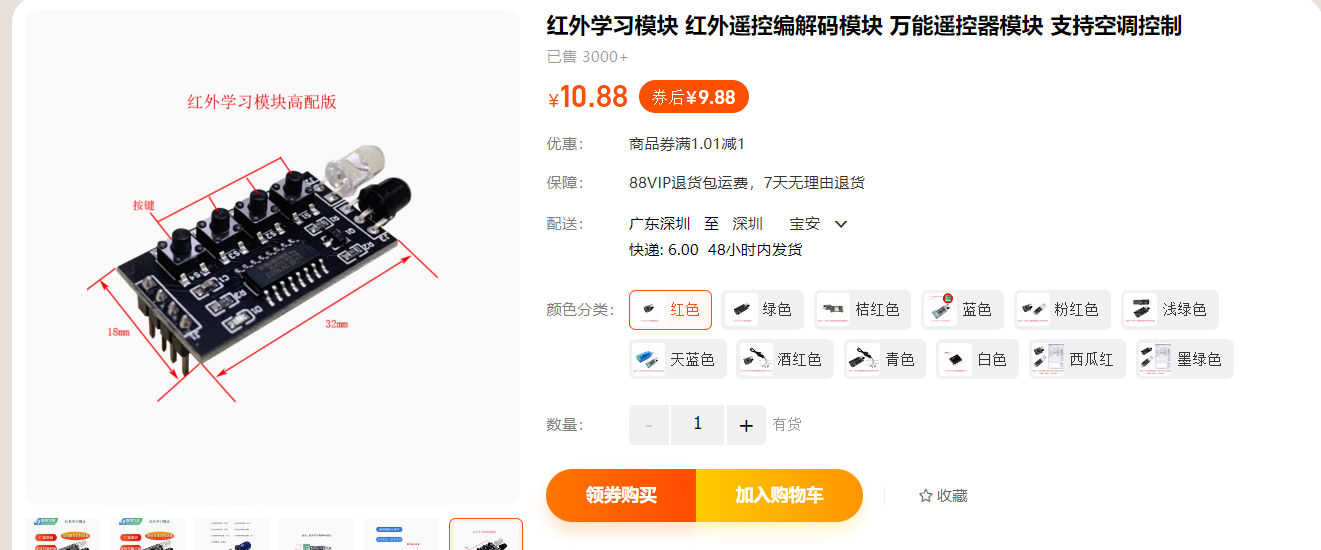

During the 618 shopping festival, I stumbled upon a module on Taobao. The more I looked at the details, the more excited I became. I received it late on May 27th and couldn't wait to try it out. Following the seller's tutorial, I learned about infrared technology, then sent infrared signals, and finally, the air conditioner was successfully controlled. So
, I immediately ordered the chip and drew the schematic.

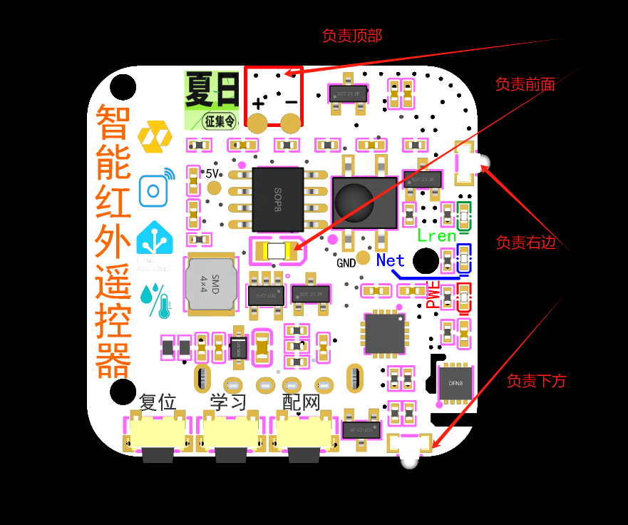

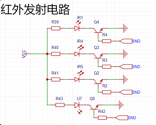

The infrared transmitting circuit
I bought was pre-programmed by the seller; I just needed to follow the provided module schematic to draw the infrared schematic. Considering the need to use components from LCSC (LCSC Electronics Mall), I selected components from the mall as much as possible. Because the remote control needs to control in all directions, I used four 940nm infrared LEDs to control each of the four directions.

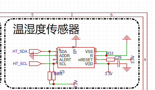

Temperature and humidity sensor (not soldered on the basic version):
I added an SHT30 temperature and humidity sensor because I planned to implement automatic control scenarios later (but the module heats up, affecting the temperature and humidity data, so I didn't include it). PCB structure:

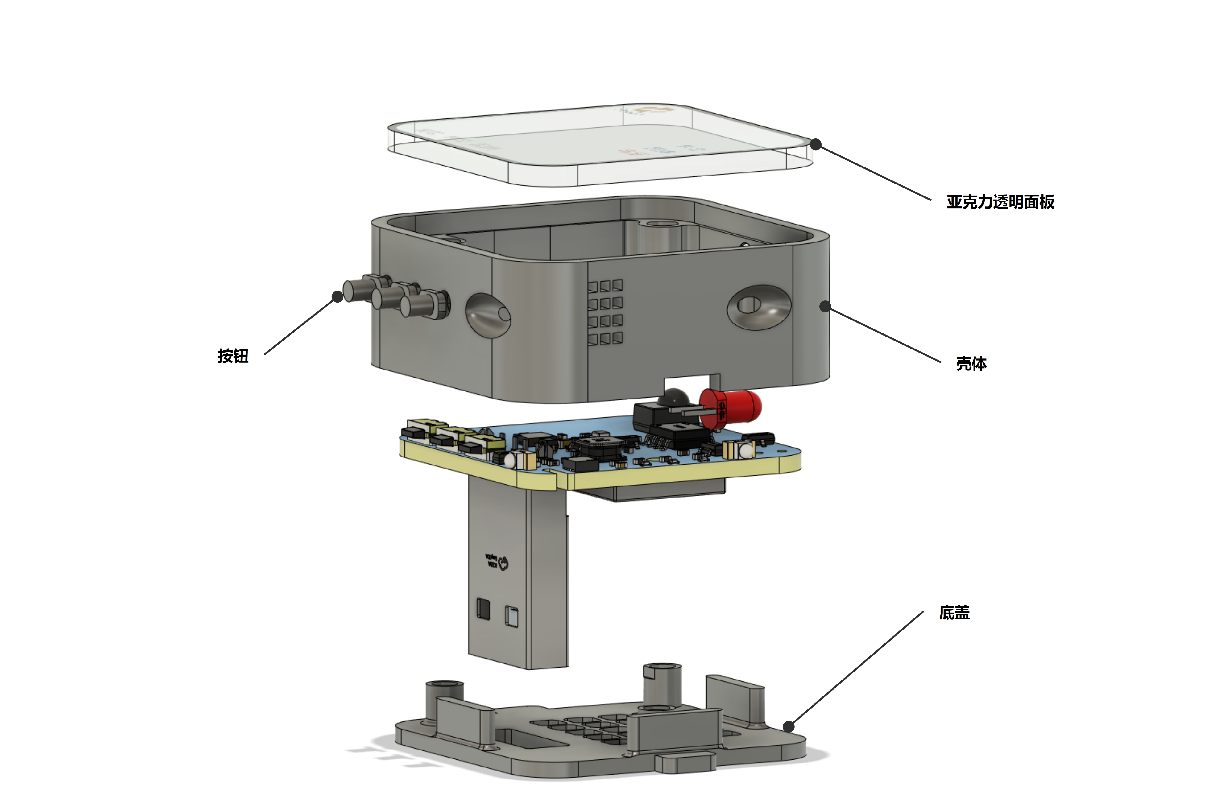

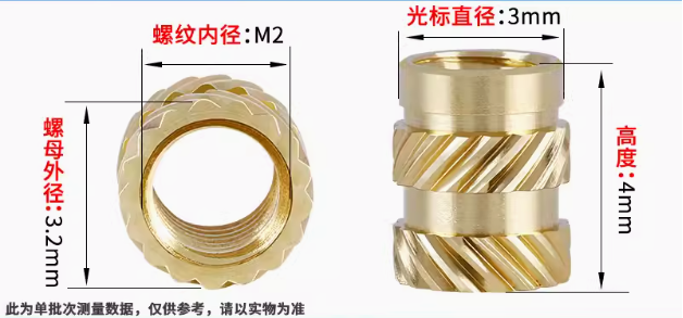

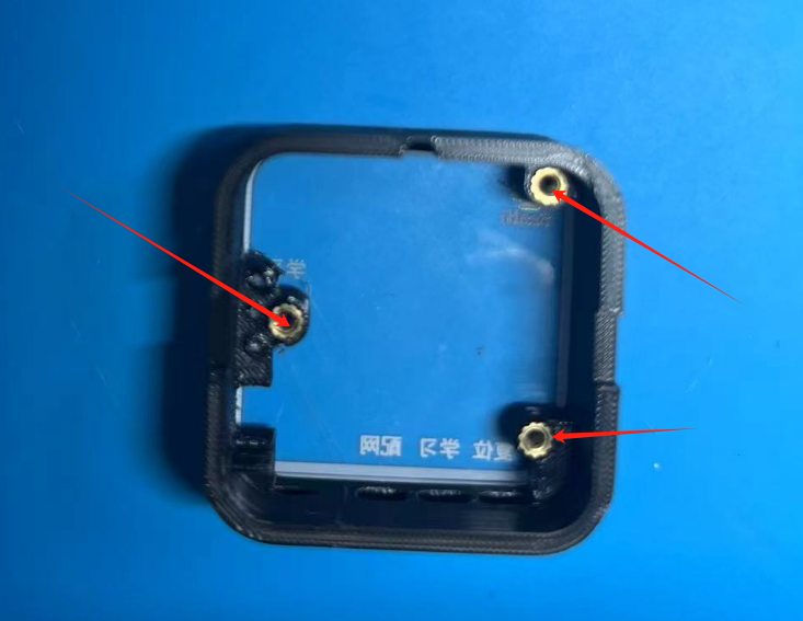

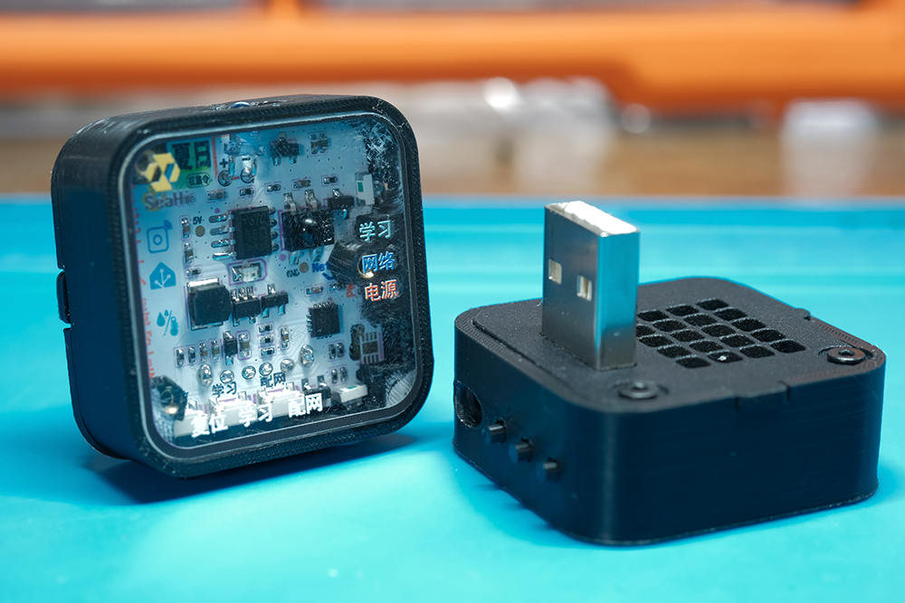

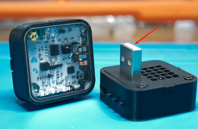

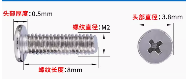

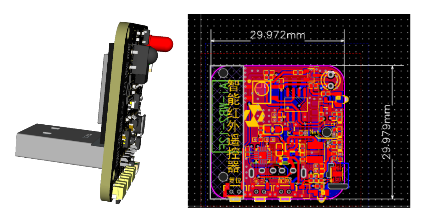

Since I planned to use a USB power adapter for power, I used a USB-A male connector. This reminds me of the charger Apple designed earlier, small and round, so I directly designed the PCBA to be 30*30mm in size. The entire shell structure is mainly composed of three parts: shell + top panel + bottom + cover plate: the panel can be glued with 502 glue. For 3D printing , I recommend using 3Dmonkey, because some structures require high precision to print perfectly. If you really want to print it yourself, I recommend using a 0.2 print head, otherwise the printing will fail. Mine is a Tuozhu Mini 0.2 print head. The bottom shell and shell are connected with M2 screws, and the shell is fitted with knurled nuts. Use these 8mm screws: Instructions for Use (Basic Version) 1. AT Command Instructions (Baud Rate: 115200) Connect the USB interface to the computer and it will be recognized. Configure WiFi connection: AT+WIFIJAP=,,[,,] For example: AT+WIFIJAP=ssid123,12345678 Other notes: Parameters within square brackets are not required; configuration only once will allow automatic connection upon power-on. Configure MQTT server : AT+HAMQTTCFG=host,port,[clientID],[username],[password] For example: AT+HAMQTTCFG=192.168.2.1,1883 Other notes: Parameters within square brackets are not required; configuration only once will allow automatic connection upon power-on. After configuration, please restart Home Assistant. Device name and manufacturer name: AT+HADEVICEMSGCFG=name,manufacturer For example: AT+HADEVICEMSGCFG=IRAirHAIntegrate,Seahi. Seahi configuration allows for automatic connection upon power-on. Please restart after configuration. Currently, this is the basic version (so the learning function and button network configuration function are not yet implemented). Only these configurations are required; subsequent functions will be configured through the Home Assistant platform. Other usage instructions: Smart Infrared Remote Control Bilibili video introduction. Source code and files: All source code and 3D files are available in the remote repository. You can download them if needed: Github: https://github.com/SeaHi-Mo/IRAirHAIntegrate Gitee: https://gitee.com/seahi007/IRAirHAIntegrate
