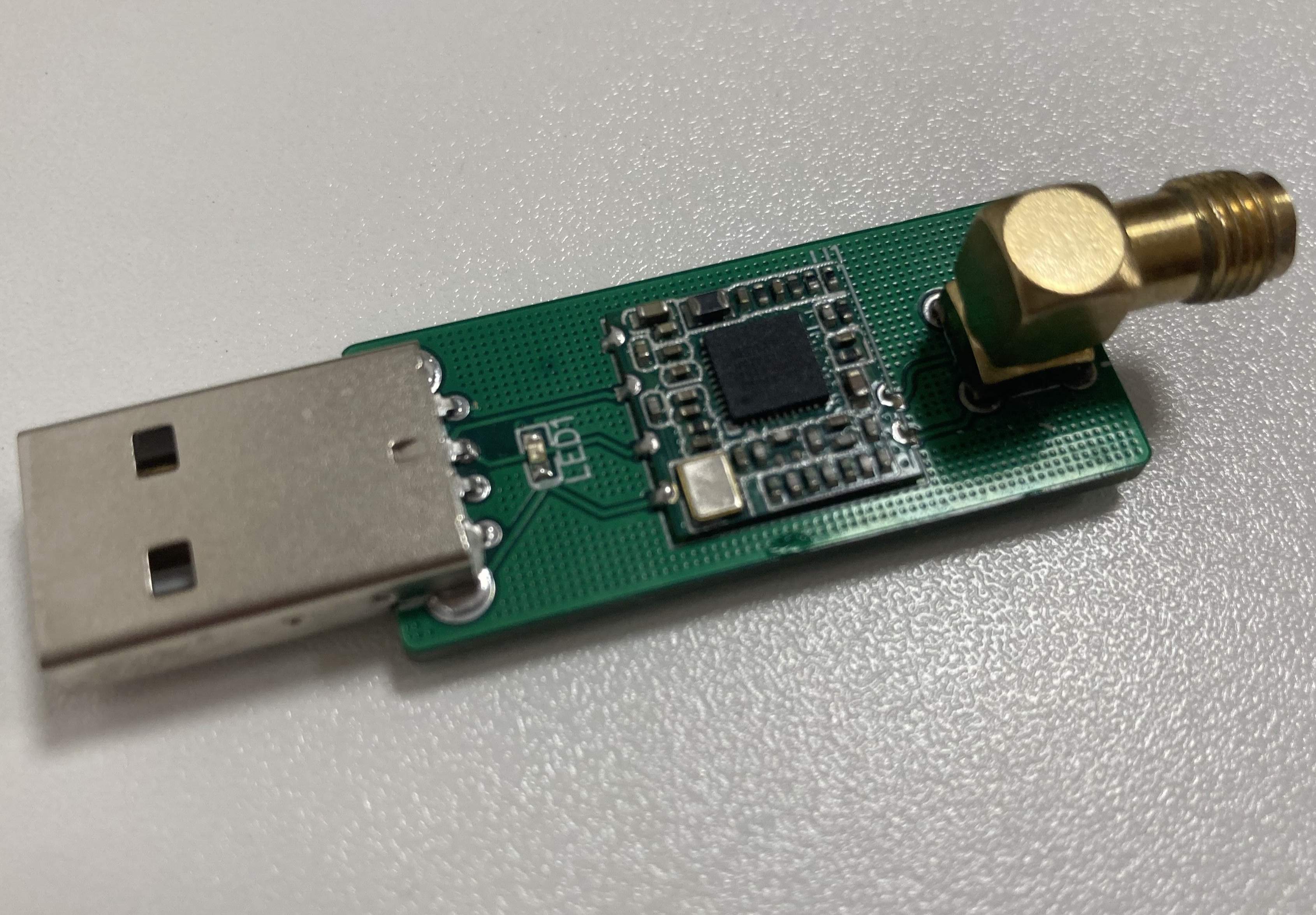

Why! ! ! USB WiFi network card! ! ! You can’t connect the antenna yourself! ! ! Woo woo woo
The one with its own antenna is so ugly and costs more than 30 yuan! !
The poor children are crying, save the children QAQ
For a WiFi network card that can be connected to an antenna , you only need to solder a USB WiFi module, a USB male connector, and an SMA socket to connect the antenna as you wish!
Tested
  • MT7601UN
  • RTL8188EUS
The two-in-one Bluetooth BT+WIFI module is not supported.
1.1 Verification completed
After deleting the LDO, it's completely normal. The RF signal lines have been standardized.
1.0 Verification has BUG
I don’t know what happened and I drew a 3v3 LDO hhhhhhhh
(((But it can be used(((
