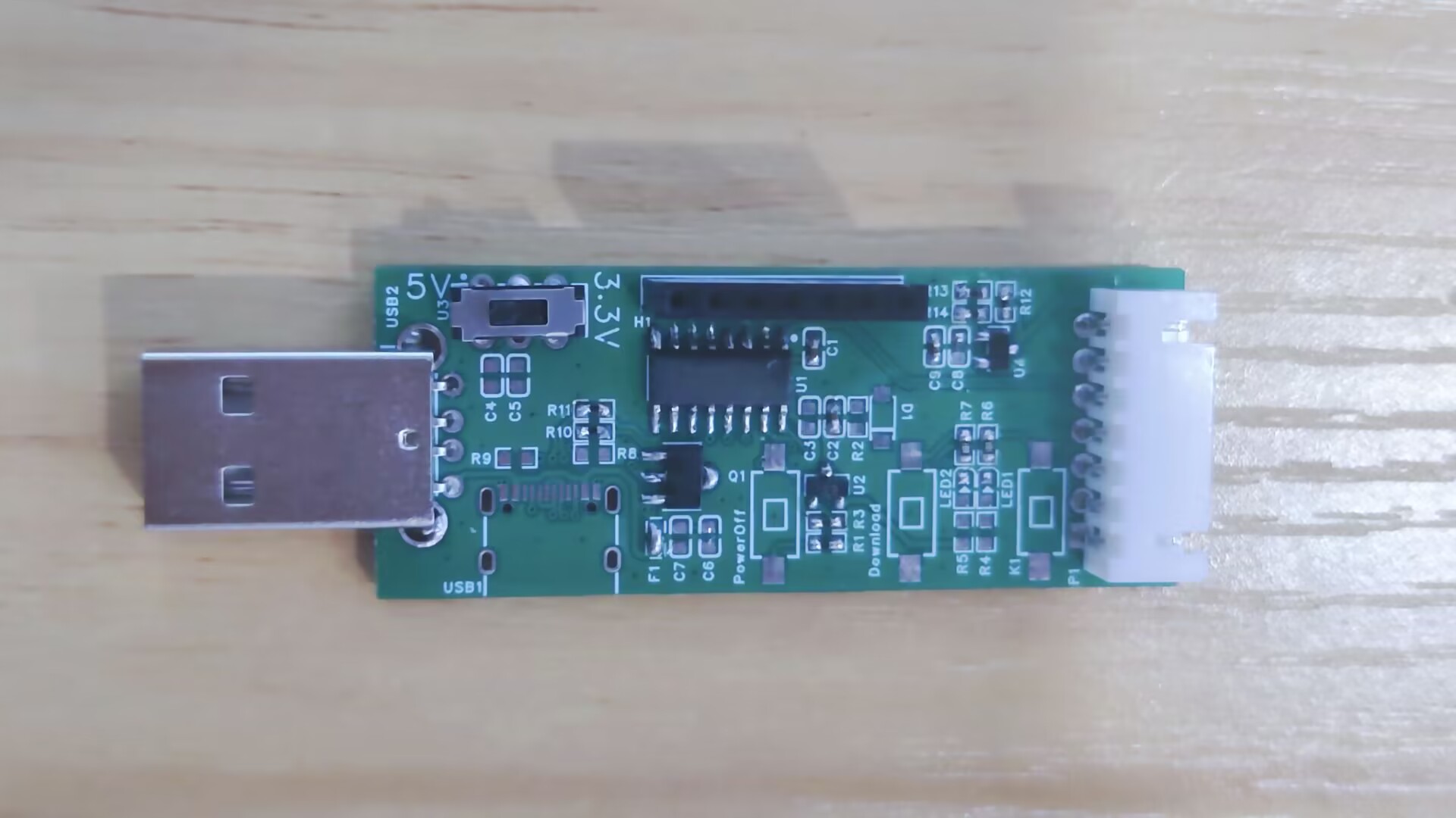

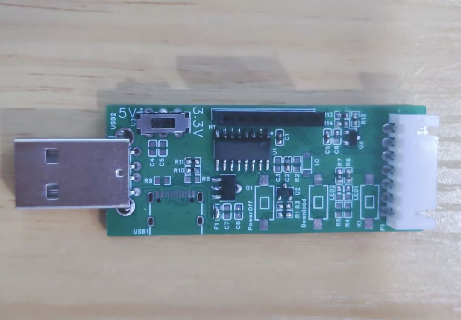

STC's simplest USB to dual serial port adapter
This is the simplest USB to dual serial port
STC adapter, a very basic tool that can be used as a programmer for other STC microcontrollers. It comes in
an SOP16 package, is easy to solder
, and offers selectable 3.3V/5V output power. It supports manual control via a K1 button
and can be used as a USB development board. It is compatible with official STC source code examples
and includes an OLED display interface, supporting both 4-wire I2C and 7-wire SPI interfaces.
It also features a program update/download button, allowing program updates without disconnecting the USB cable.

for the USB to dual serial port learning board/A1, USB CDC to dual serial port open source program - for automatic power-off and power-on programmer] The program obtains the burning file stc_usb_2ser.hex.
Using STC-ISP, download the program to the chip.
Insert the small board into the computer's USB port, press and hold the [Download] button, then press and quickly release the [PowerOff] button, and then release the [Download] button again. Open the ISP software; it will recognize a HID device. Select the chip model: stc8h2k08u, internal 24MHz frequency. Open the stc_usb_2ser.hex program and click the [Download] button to download the program.
Verification:
Remove the small board from the USB port and insert it into the computer's USB port. You should see two serial ports appear on the computer, indicating normal operation.

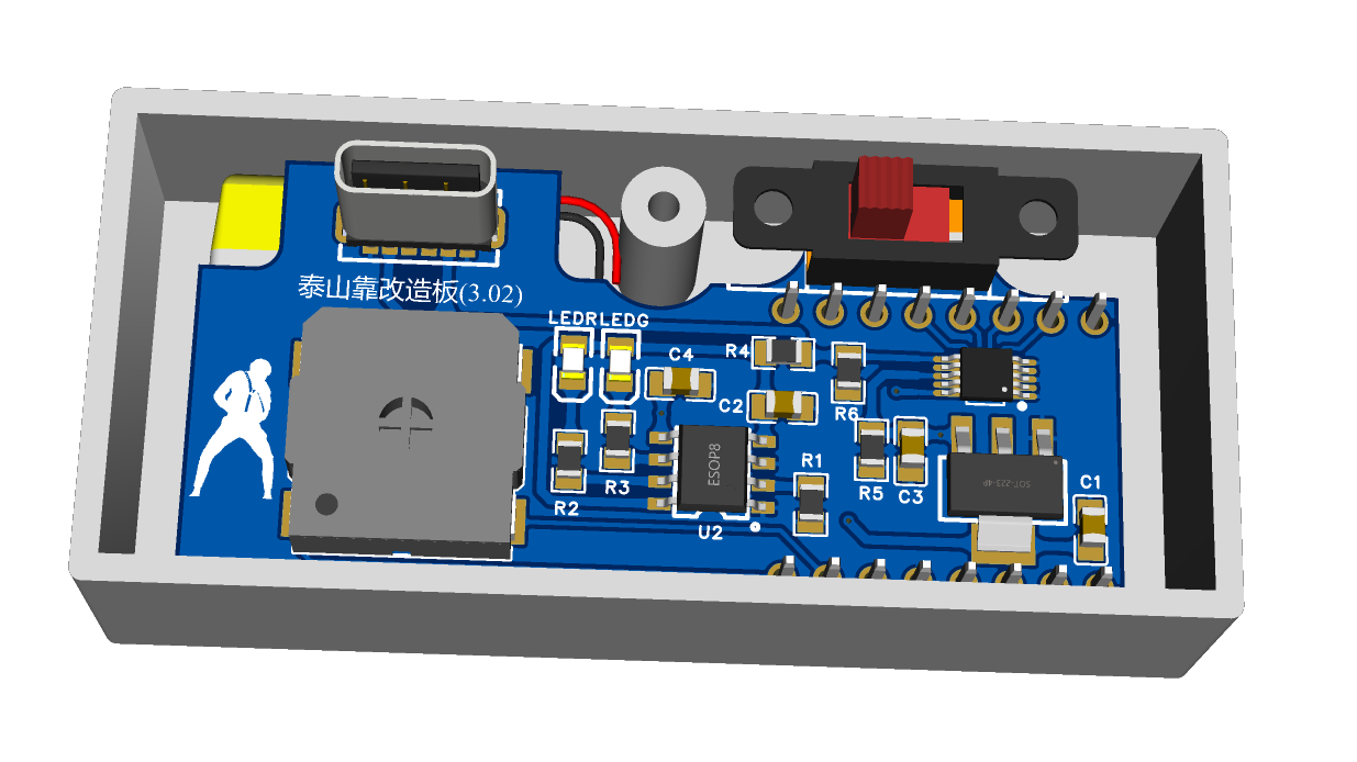

Taishan relies on BGM audio system modification board
This project involves using PCB design to modify a Tarzan-style toy, adding background music (BGM) speakers. It emits different "chicken sounds" on four different occasions: power on, power off, plugged in, and unplugged, giving the Tarzan-style chicken character the ability to sing, dance, rap, and play basketball.
"Taishan Kao" Electric Toy Audio Modification
: I. Basic Information
"Taishan Kao" is a popular toy among many fans, but unfortunately, it lacks its own background music (BGM). I previously modified it to play Chicken Bro's exclusive BGM during movement. A modification video was posted on Bilibili: Modifying "Taishan Kao"—Giving an Electric Toy its Own BGM.
This modification differs from previous ones, using a circuit board. Inspired by netizens, I added corresponding "Chicken Sounds" for different operating states, totaling four states:
1. Plug in charger—"Wow, it really is you!"
2. Unplug charger or turn off switch—"Isn't your Kun Bro awesome?"
3. Turn on switch—Initiation theme song, and the toy starts moving.
4. Turn on switch while charging—"What are you doing~ Ouch~" (Reminding you not to start while charging)
The above four states are controlled by the RS2255XN analog switch control chip.

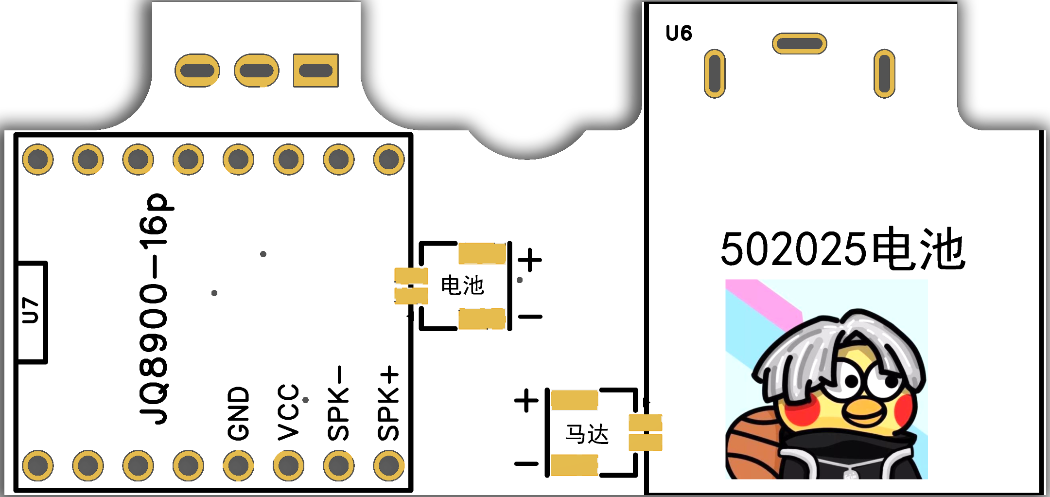

III. PCB Design
The design follows these principles:
1. Utilize existing space and components as much as possible, and minimize destructive modifications;
2. Save money and make soldering easier (use 0805 capacitors, resistors, etc.);
3. Must include GEIGIE elements ; 4. 0.8mm thick FPC board is recommended, as thicker boards will affect installation.
Front and
back

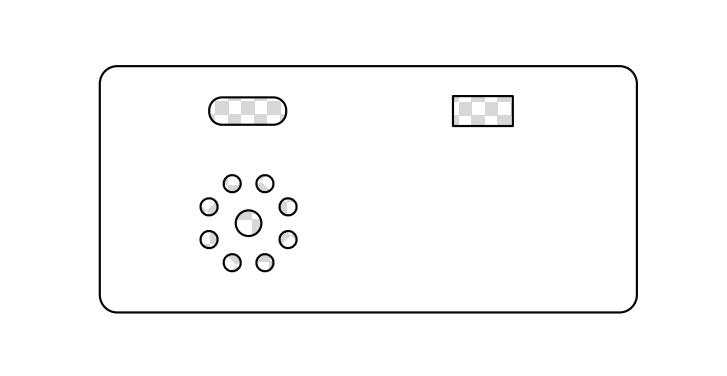

IV. Shell Design
Since the Taishan Kao (a type of cardboard box) already has a shell, you need to drill holes in the back cover yourself. Therefore, two options are provided here.
(I) Do it yourself. Drilling holes in the existing back cover requires strong hands-on skills, but the advantage is that it saves money. Here I provide a drilling positioning file, which can be printed out and pasted onto the back cover for easy drilling positioning. See Attachment 1.
(II) 3D printing. If you have plenty of money, or your hands-on skills are too poor, or you have a 3D printing voucher, you can choose 3D printing. You only need to print the back cover.
Note: Because JLCPCB's 3D design software has certain limitations compared to professional CAD software, I re-drew a 3D model of the back cover using UG, see Attachment 2. (You can also use the 3D model in JLCPCB EDA without much problem.)

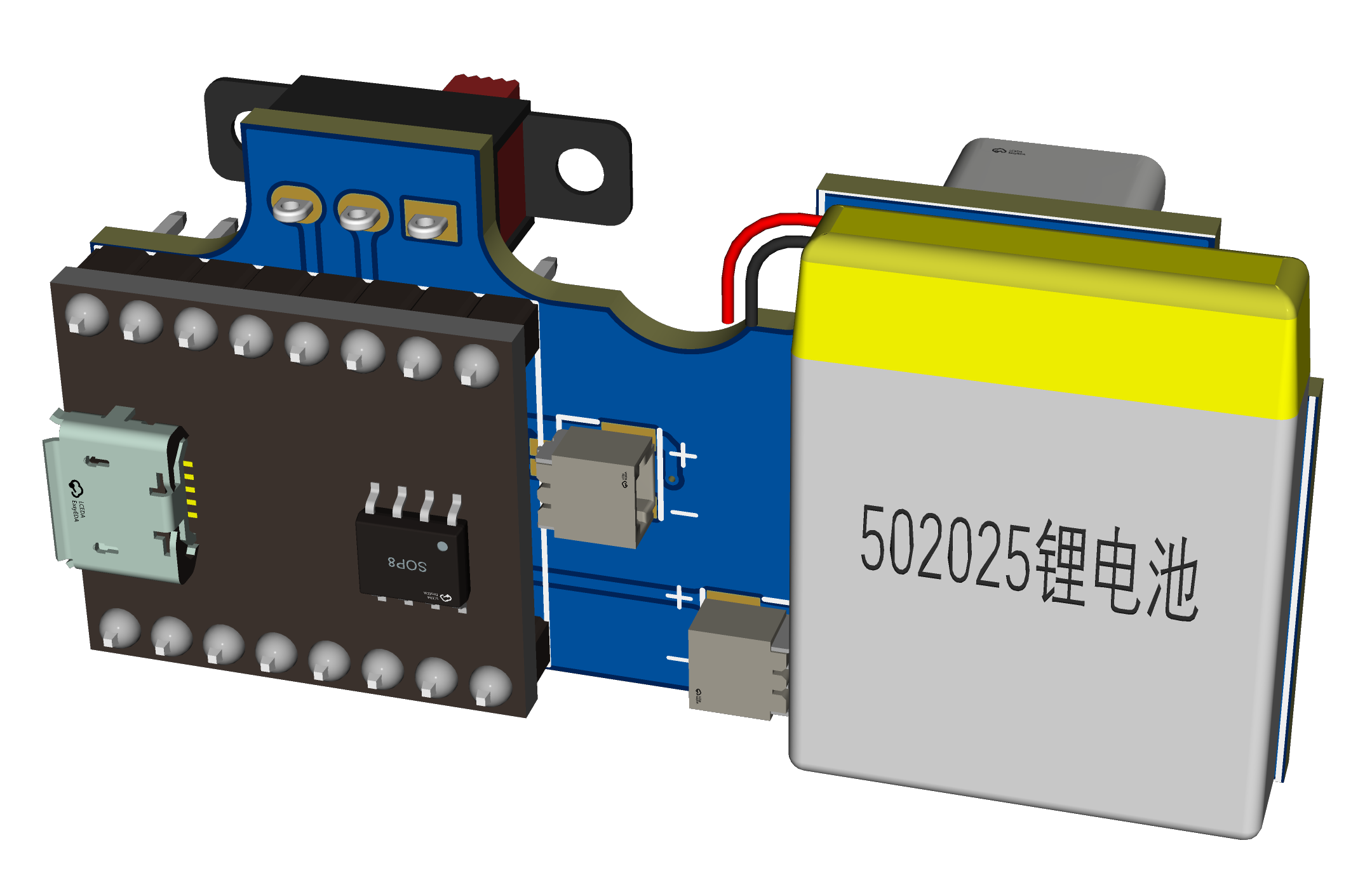

VI. Bill of Materials and Other Notes
1. Most materials can be purchased from the LCPCB online store. For ease of soldering components, I mainly use 0805. Of course, if you want to use 0603 or others, just replace them with the same value, and you will need to modify the schematic diagram yourself.
2. For voice, I directly used the readily available JQ8900-16P voice module, which can be purchased on Taobao. The relevant configuration files are in Attachment 3 (just put the 4 decompressed files in the root directory). Of course, you can also modify the voice later (explore Attachment 4 yourself).
3. The motor and battery terminals are optional; you can solder the corresponding wire ends onto the large solder pads. I designed this to facilitate installation and battery replacement.
4. The slide switch is also optional; it is exactly the same as the original.
5. Ideally, a 702025 battery should be used, as its thickness fits perfectly (however, LCSC is out of stock, so a 502025 battery can be used as a substitute, requiring the bottom of the battery to be raised by 1-2mm).
VII. Assembly :
Assemble and solder as shown in the diagram, then install it into the original casing. Don't forget the motor wires; make sure to connect the corresponding wires. The simulation diagram is slightly incomplete.
