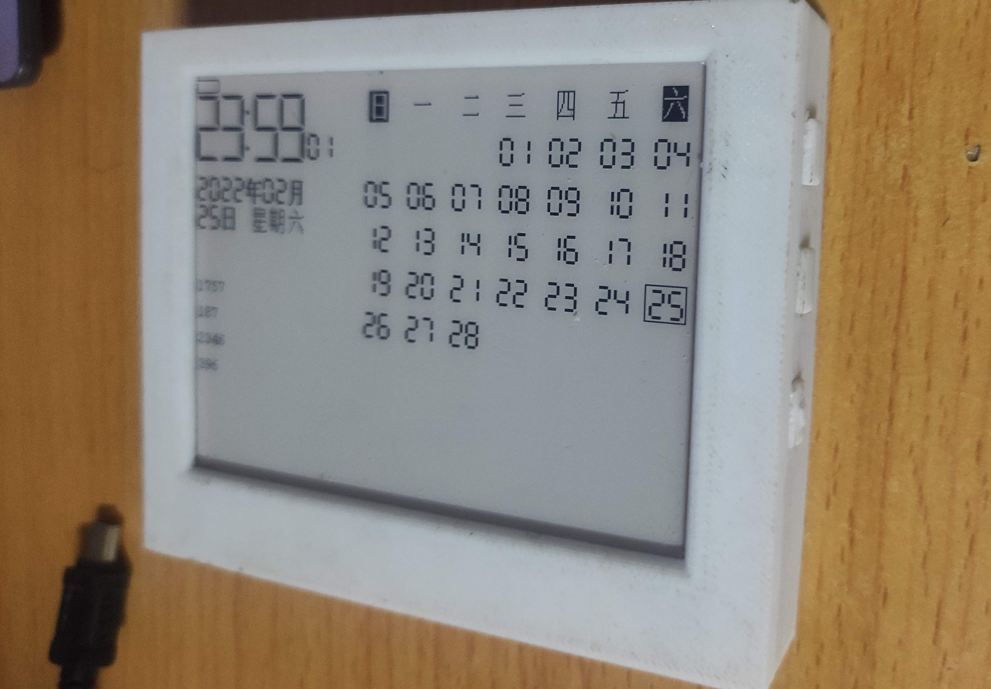

A dozen of 4.2-inch ink screens on a certain fish were developed into a desktop calendar (a three-color ink screen, which can be refreshed using the Weixue black and white program).
At present, both ese 4.2-inch price and Weixue 4.2-inch black and white can be driven (using Weixue screen requires changing the seating position).
The ink screen calendar is developed based on esp32 and is currently in the development stage (the program will be open sourced after the third stage is completed).
The first stage is to realize the functions: display time, date, draw calendar, etc.
Functions to be added later: adding temperature and humidity, online time adjustment, lunar calendar and other functions.
Demo video 1: https://www.bilibili.com/video/BV1DL4y1V7Vp?share_source=copy_web
Demo video 2: https://b23.tv/DjPg7gT
(R23 is the spi selection interface and does not need to be soldered. This end is grounded by default. If you want to solder eap32, you can remove the pin header part and the R3-R8 resistors do not need to be soldered. If you want to wire the driver, just connect the wiring part inside the white silk screen. Just solder the original parts. The R3-R8 resistors are series resistors that can also be used by 5v microcontrollers. You can choose whether to solder them according to your needs. By default, no soldering is required.)
My programming level is limited, and the source code of the third stage will be opened after the third stage is debugged.
*2022/5/9/4.3v1.0
This version is the first beta version
*2022/5/4/9/4.2v1.3
 * Note: This version is the second version test version
 * Version description:
 * Improve the full brush settings and time brush settings, and save them when power is turned off
 * There is no network time adjustment available in the current version
 * Temperature detection is not available
 * Battery voltage detection is not available
 * Night settings are not available
 * Network settings are not available
 * There may be other bugs in the program

It is not recommended to print the board at the moment. I will add new hardware and new functions in the future and print a casing for this ink screen calendar.
In the next pcb version, I will add rtc clock, temperature and humidity module, photoresistor, etc.
The following is the first version, button problems, charging interface packaging, LED position, etc. to be corrected.
front
Follow-up design of new UI interface↓↓
The reverse side and the battery (I don’t have a ch340c so I didn’t solder it. You can also use the interface on the side of the esp32 to burn)
The battery is attached to the back of the board
behind the board
My first version of the test board had constant problems, including button problems and charging interface problems. This version will be corrected.
