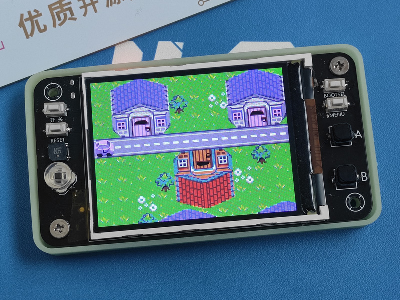

MakeCode Arcade open-source game console development board with RP2040 main controller and 2.8-inch screen.
Microsoft's open-source game console, MakeCode Arcade, allows users to create their own games using graphical programming! It uses a Pico RP2040 main controller and a 2.8-inch ili9341 screen.
Besides serving as a development board for the MakeCode game console, it can also be used as a development board for CircuitPython and MicroPython!

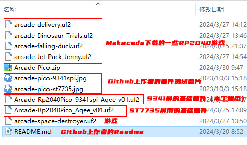

2. Unzip the attached file Arcade-Pico.zip. You will get the following files:
3. Copy the basic firmware for the 9341 screen to the RPI-RP2 USB drive.
The console will automatically restart. 4. Press and hold the BOOTSEL button again, then press the RESET button. The RPI-RP2 USB drive will reappear. Copy any game's .uf2 file from the compressed file to the RPI-RP2 USB drive. The console will automatically restart again, and you can start playing!

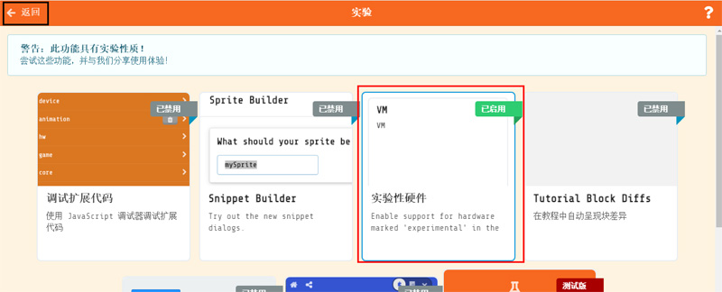

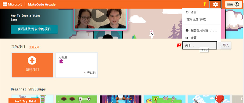

   Click 1. Settings, 2. About,

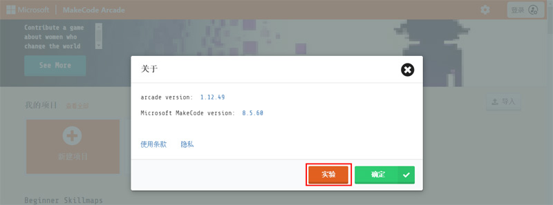

3. Click Experiment (highlighted in red)
, 4. Select Enable Experimental Hardware, then click Back.

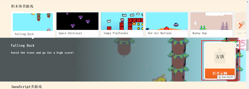

4. After returning to the homepage, scroll down and select a game,

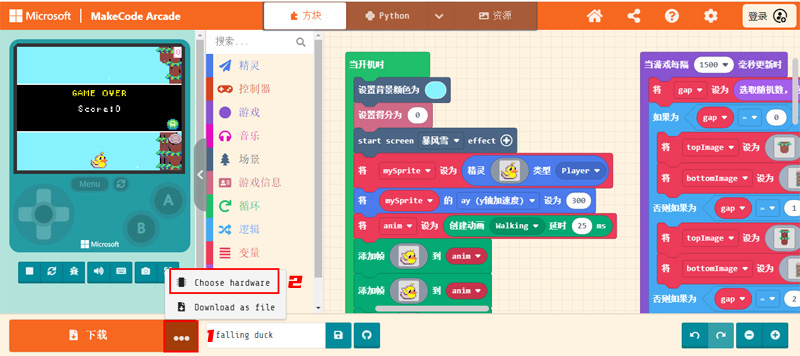

then click Open Sample. 5. The game interface will look like this; you can modify the game as needed. After modifying, click 1...2. Select Hardware,

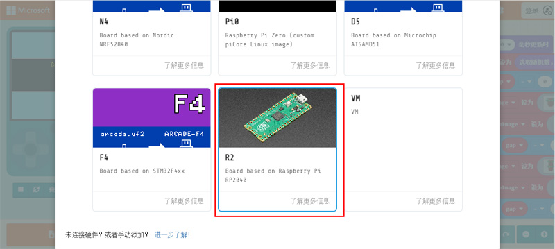

6. Scroll down and select R2.

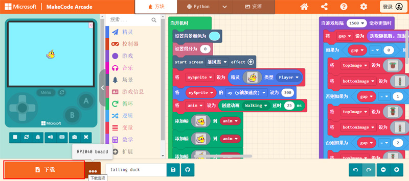

7. Click Download. This will download a game .uf2 file for RP2040!
8. Connect the game console to your computer, press and hold BOOTSEL to power it on, then drag the downloaded .uf2 file into the RPI-RP2 USB drive. The game console will automatically restart, and you can play again!

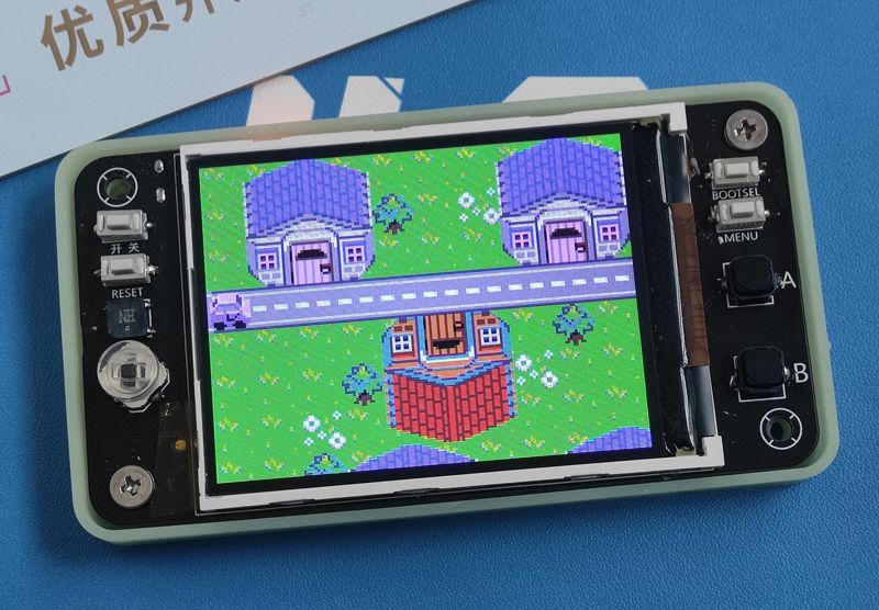

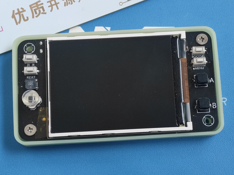

Finished product image:
Don't ask why there's no top cover; I drew a panel, but it was too small, and it didn't fit after the return, so I won't release the file!
