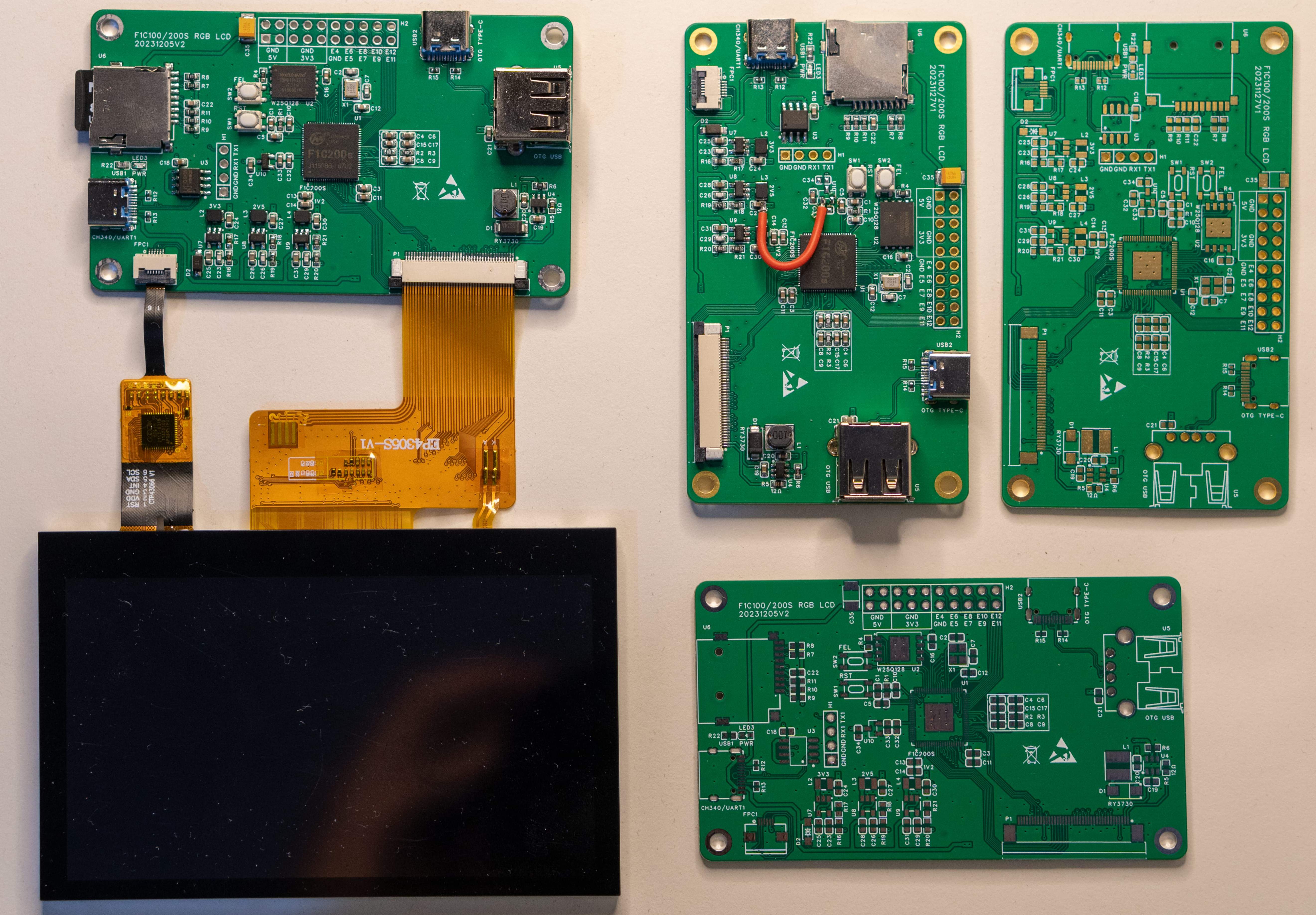

Project Introduction:
The F1C200S Screen Development Board is an open-source hardware project based on the Allwinner F1C200S ARM926EJ-S core processor. The goal of this development board is to provide a low-cost, ultra-miniature platform suitable for Linux development, especially with support for screen interfaces.
Update Log
2023-12-25 Updated testing zImage, DTS, rootfs
2023-12-19 First release of
open-source software

features 16MB of onboard NOR flash memory and uses the F1C200S main control chip with 64MB of built-in DRAM. It also includes a USB Host interface, a USB Type-C port, and a CH340 serial-to-USB chip for development and debugging. A 2D preview of the development board is shown in

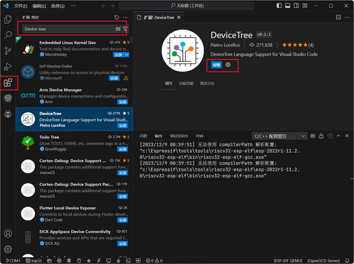

VSCode configuration (optional).
Using the DeviceTree plugin for VSCode, we can achieve code highlighting for device tree files. We can also use VSCode when editing C language code, so configuring VSCode is essential.
Since VSCode installation is relatively simple, this manual only provides the download address; users can install it themselves before reading further.
VSCode download address: https://code.visualstudio.com/
After installing VSCode, we will start installing the DeviceTree plugin. Search for the DeviceTree plugin in the store and click install:
Figure 3.x. The installation of the DeviceTree plugin
is similar. It is recommended that readers also install the Chinese language pack. Search for CN and refer to the following figure for installation. After installation, restart VSCode as required.

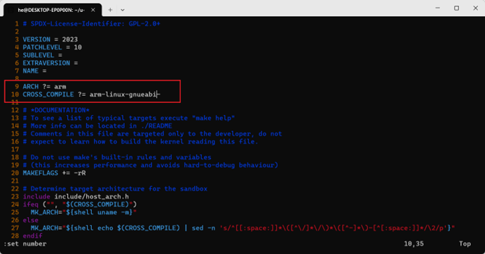

U-Boot Compilation
Introduction to U-Boot and F1C200S Boot Process
U-Boot, short for Universal Boot Loader, is an open-source boot loader widely used in the boot process of embedded devices. As a powerful and widely used boot tool, it supports multiple processor architectures and embedded platforms.
During the system startup phase, U-Boot is responsible for initializing various hardware components, including but not limited to core hardware units such as the CPU, memory controller, interrupt controller, and timers. In addition, it is also responsible for loading the operating system kernel and root file system. To facilitate user configuration, debugging, and maintenance, U-Boot provides an interactive command-line interface.
Typically, U-Boot is used as the first-stage bootloader, its primary responsibility being to load and execute the operating system from various storage media (such as flash memory, SD card, or network). This characteristic makes U-Boot a crucial player in the embedded device boot process.

Configuring the U-Boot Cross-Compilation Environment:
In the previous chapter, we configured the cross-compiler arm-linux-gnueabi. We only need to modify the U-Boot Makefile and add the following content to configure the cross-compilation environment:
`ARCH ?= arm
CROSS_COMPILE ?= arm-linux-gnueabi-
` `ARCH CROSS_COMPILE` specifies the architecture and compiler used in the compilation. The `?=` indicates that if the variable has already been specified, the variable provided here will not be used. See the screenshot below for the modified file:
Figure 4.x U-Boot Compiler Settings
