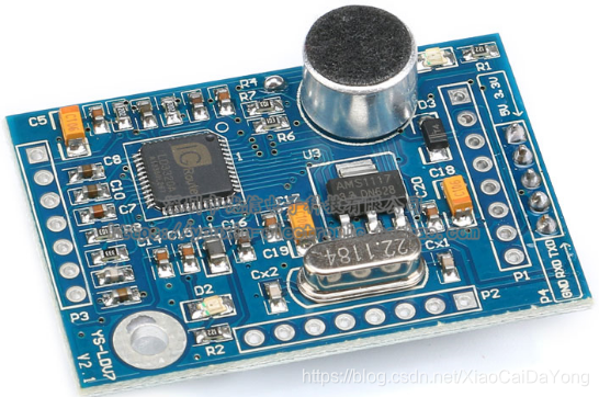

Figure 1 – Voice Recognition:
The LD3320 integrates a high-performance voice recognition module, which can accurately recognize the user's voice commands, realizing contactless door lock control. It operates on 5V power and communicates via interrupts (9600 baud rate) through PA2 and PA3.

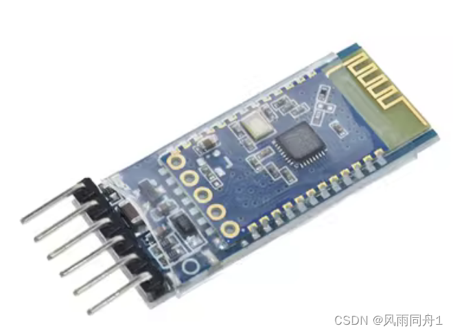

Figure 2 – Bluetooth HC-05 Module:
The Bluetooth HC-05 module is responsible for wireless communication with the user's smart device (such as a smartphone). The user sends a door opening command via Bluetooth through a smart device (such as a smartphone). After receiving the command, the Bluetooth module controls the servo motor to execute the door opening action. It operates on 5V power and communicates via interrupts (115200 baud rate) through PA9 and PA10.

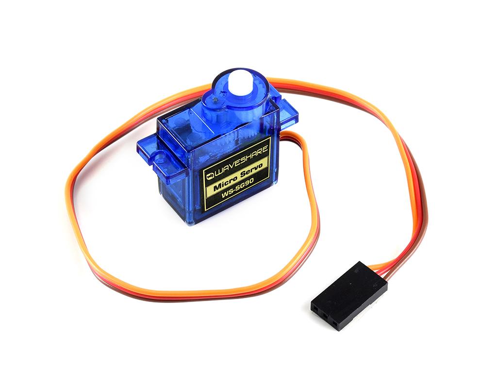

Figure 3 – SG90 Servo Module:
The SG90 servo module receives PWM signals from the microcontroller and adjusts the servo's rotation angle according to the PWM duty cycle to open and close the door lock. The PWM signal is output through CH1 (PA0) of TIM2 to control the servo's rotation angle.

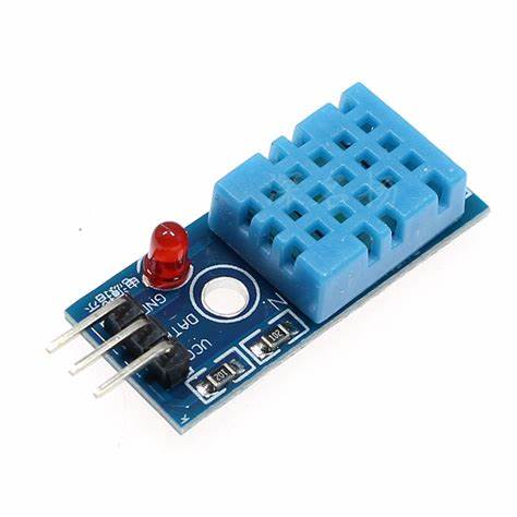

Figure 4 – DHT11 Module:
The DHT11 sensor monitors the ambient temperature and humidity and transmits the data to the STM32 via PB11. After processing the data, the STM32 sends it to the OLED display via the IIC interface.

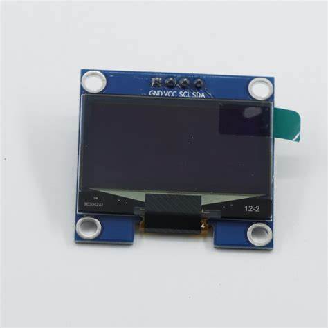

Figure 5 – OLED Module:
The OLED display shows the system's real-time operating status, including operating mode, servo angle, and ambient temperature and humidity.
The display communicates with the STM32 via the IIC interfaces (PB8, PB9) to receive and display data sent by the microcontroller.

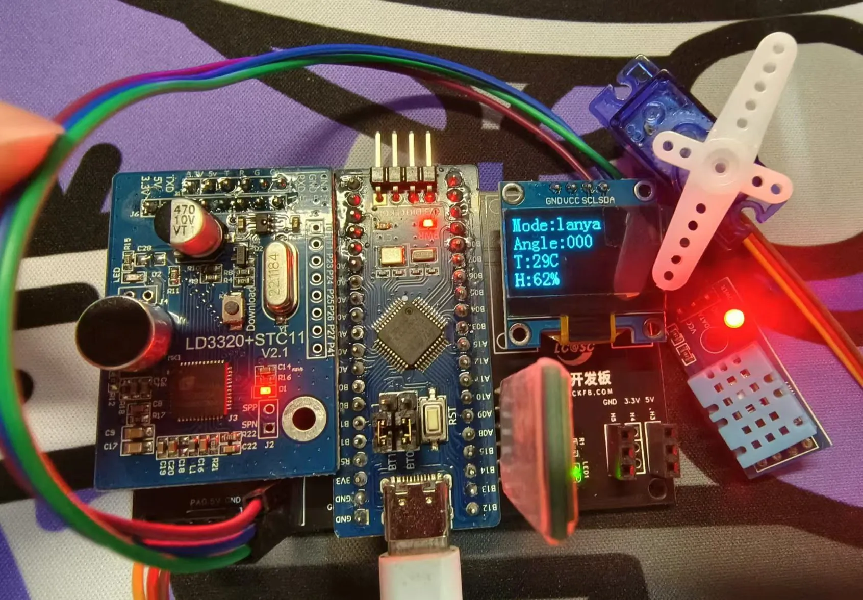

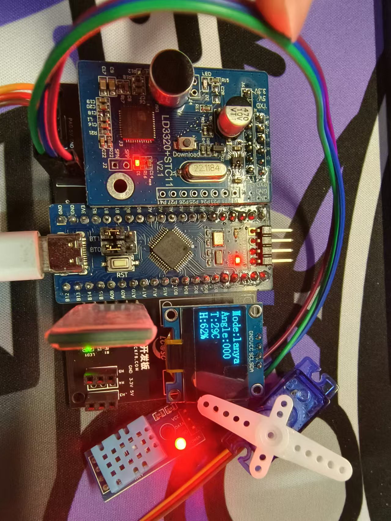

** Connect the corresponding modules; do not connect them backwards. Figure 6: Actual product
