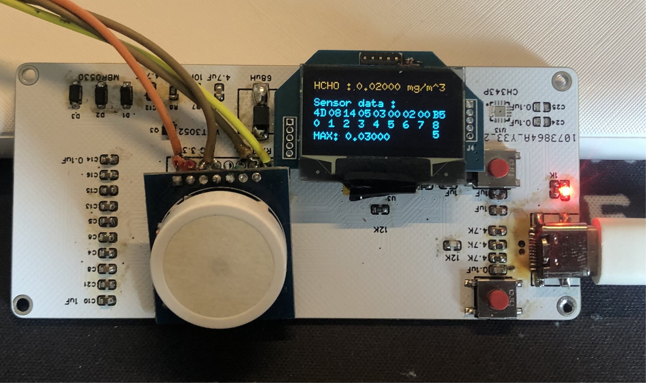

1. Overall Appearance:
From right to left on the front, the components are: USB-Type-C port, download/reset button, OLED display, and HCHO sensor.
2. Function Introduction
: The device starts working immediately upon plugging in the USB-Type-C port and powering on. The OLED display shows the formaldehyde content value output by the HCHO sensor on the first line. The second, third, and fourth lines show the serial data received by the processor, allowing for easy monitoring of serial communication with the HCHO sensor.
The fifth line displays the maximum measured formaldehyde content value. The reset button clears this information.

4. Effect Test:
During the test, a lighter is used to spray gas at the sensor, and the numerical changes can be observed. The maximum value is recorded on the screen.
