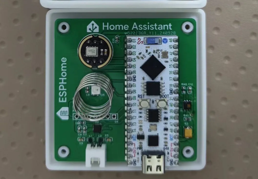

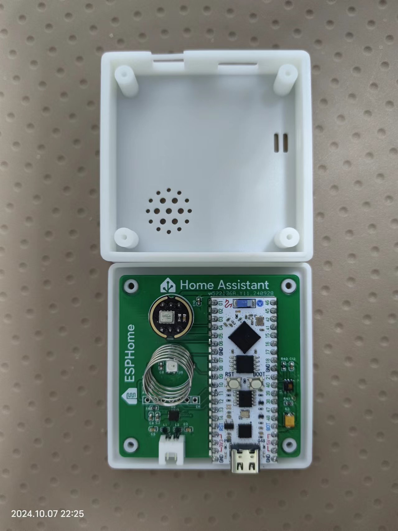

Based on JLCPCB ESP32 Development Board This project is based on the JLCPCB ESP32S3 development board and implements a HomeAssistant AI voice assistant that integrates wake word, TTS, STT, environmental detection, and AI large-scale model control for smart home devices. Project Functions This design is based on the JLCPCB ESP32 development board and features a HomeAssistant AI voice assistant with one microphone supporting wake word activation and conversation end detection; one speaker for voice playback; one RGB light to display offline, online/idle, wake-up, voice acquisition, thinking, and voice reply status; one touch button to toggle microphone mute (the touch spring is disabled after adding a casing); and an ambient temperature and humidity detector. Project parameters: This design allows for customizable Chinese wake-up words; this design allows for customizable sentence responses and execution of related commands; this design can mute the microphone to avoid accidental wake-up at night; it uses the HDC1080 fully digital temperature and humidity sensor, which has a wide temperature measurement range and can meet general needs; the software code is based on ESPhome programming, making it easy to get started quickly. Project code: https://github.com/JochenZhou/esphome-packages Thanks to the following project authors: Original ESPhome code : https://github.com/tronikos/esphome-packages/tree/main Speech recognition repository: https://github.com/yaming116/sherpa-onnx-asr Integration: https://github.com/yaming116/home-assistant-fun-asr Add-ons: https://github.com/knoop7/hassio-addons Chinese wake-up words Add-ons: https://github.com/rhasspy/hassio-addons. For specific integration methods, please refer to the documentation at the links above. Notes: ESPhome compilation and installation requires a GitHub connection and a VPN. The wake word may sometimes malfunction under a VPN, so it is recommended to disable the VPN after installation. Whether or not you need to disable it is up to you to test. Touch spring malfunction after adding a case. Figure 1: Actual product image .

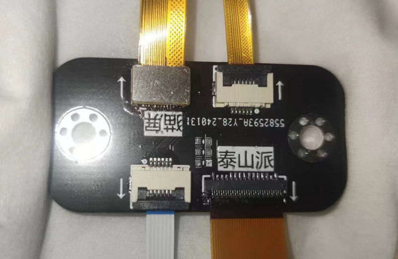

The adapter board for the Taishanpai 6-inch cat screen
has been modified with a redesigned package for easier manual soldering.
The board area has been reduced, and
the connector positions correspond to both the screen and Taishanpai orientations. For connecting to the Taishanpai, you can choose between a 31-pin 0.3mm pitch ribbon cable or a 6-pin 0.5mm pitch ribbon cable.

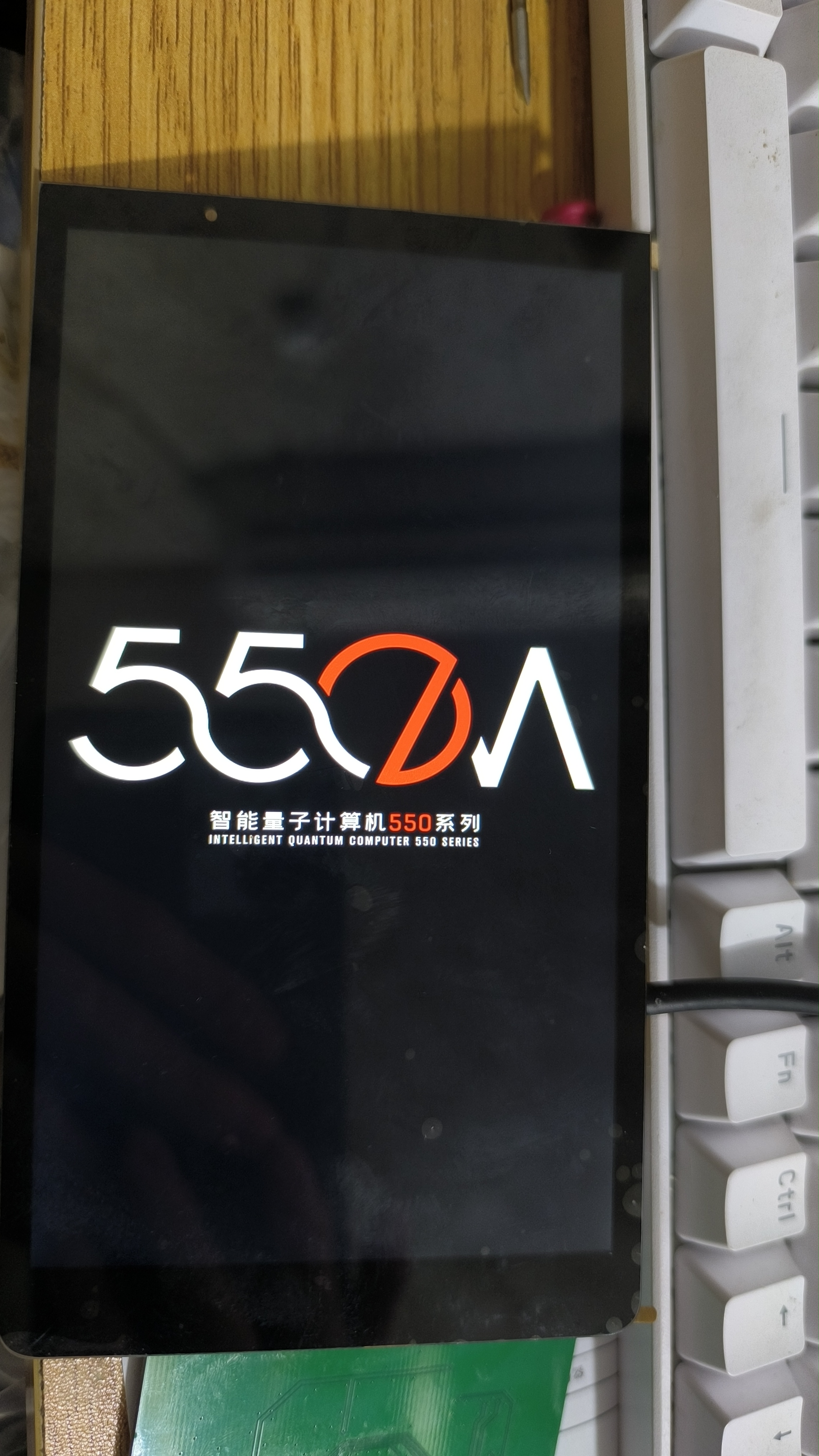

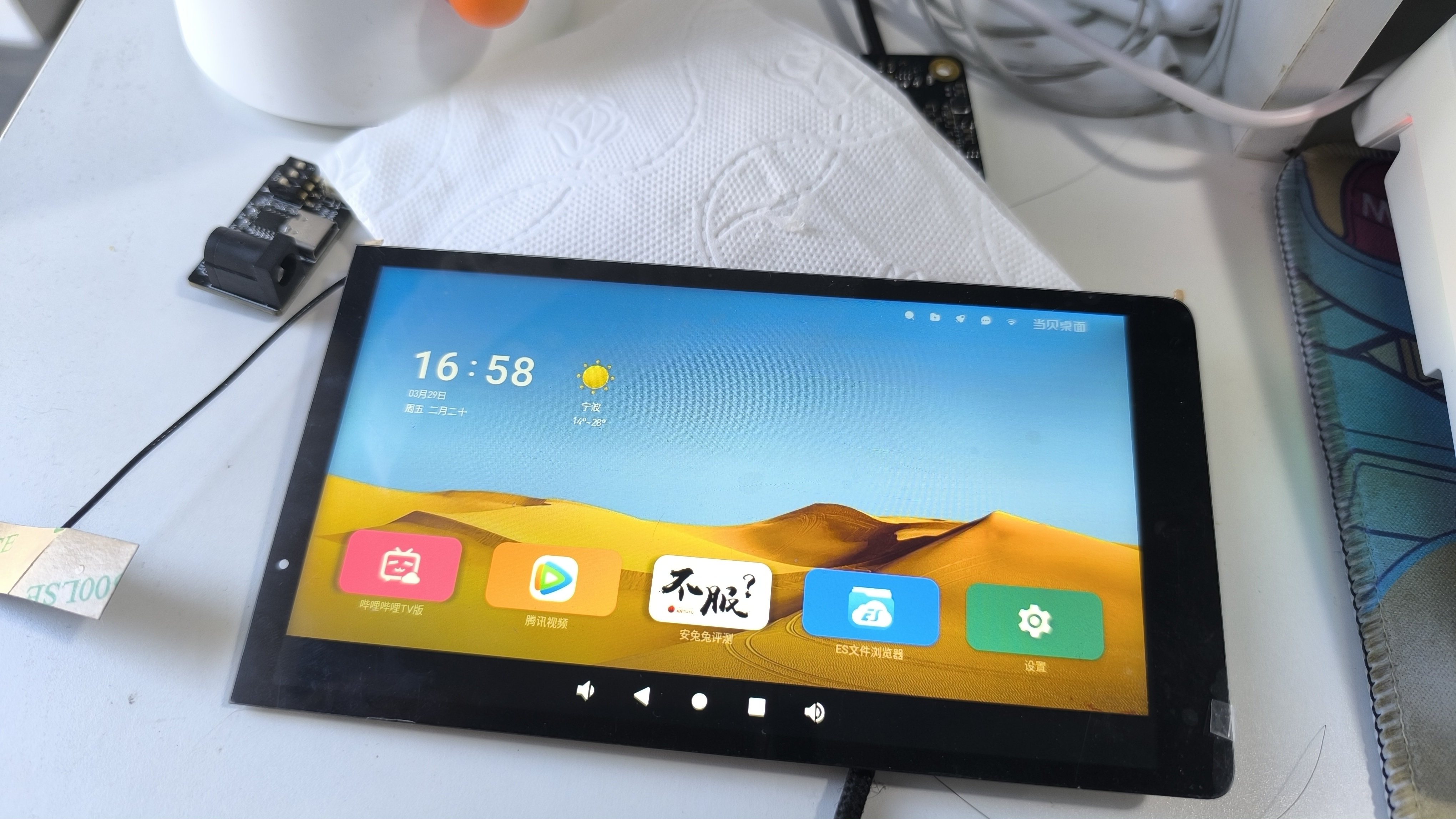

6-inch 720*1280 resolution, with touch, 0-1-2-clk, 49.9 RMB including shipping. (Actual prices may vary; please refer to the actual order.) The screen display and touch functionality are now successfully driver-driven. You can directly replace the files according to the documentation.

Then recompile the kernel separately and flash boot.img separately. After a few minutes of system initialization, the screen can be used.
Without modification, the touch screen can still be used, but the displacement will be inaccurate.
The Taishanpai comes with an Android system. For screen testing, you can directly flash the factory-installed system into the attached boot.img. A Linux version is also provided; both share the same boot.img.
The boot.img and complete firmware can be downloaded from Baidu Cloud or Quark.

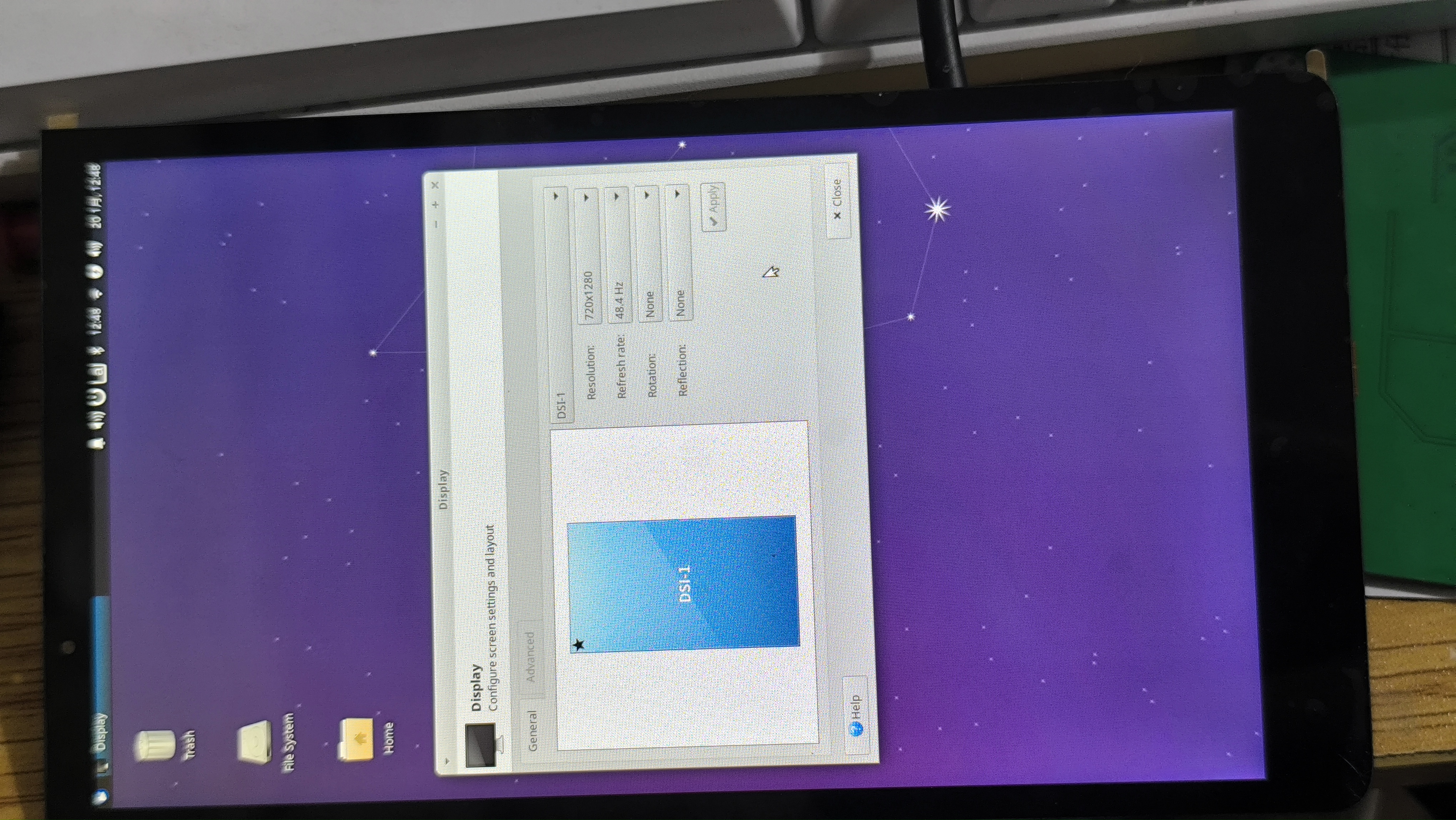

To rotate the screen by 90 degrees:
In the file `/tspi_android_sdk/device/rockchip/common/BoardConfig.mk`, modify the following:
    `#rotate screen to 0, 90, 180, 270 #0: ROTATION_NONE ORIENTATION_0 : 0 #90: ROTATION_RIGHT ORIENTATION_90 : 90 #180: ROTATION_DOWN ORIENTATION_180: 180 #270: ROTATION_LEFT ORIENTATION_270: 270 # For Recovery Rotation TARGET_RECOVERY_DEFAULT_ROTATION := ROTATION_RIGHT //Screen rotation 90 degrees
    # For Surface` Flinger Rotation SF_PRIMARY_DISPLAY_ORIENTATION := 90 // Rotate the screen by 90 degrees.
Note: The highlighted part needs to be changed to :=, otherwise, if it's still !=, the rotation won't work.
Next, you need to modify the touch screen so that it also rotates 90 degrees. Otherwise, the screen orientation will change, but the touch screen won't work correctly.
