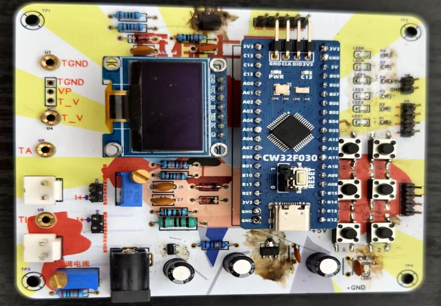

This project is a current and voltage meter based on the CW32 microcontroller.
Project Functions
This design is a current and voltage meter based on the CW32 microcontroller for detection; it uses a 0.96-inch OLED screen to display the detected current and voltage; it uses a voltage divider circuit to expand the detected voltage and current range; it has a button to switch modes; and it uses LED technology to indicate the status.
Project Parameters
This design uses the CW32 main control chip with an internal reference, ensuring accurate ADC acquisition;
it uses a 0.96-inch OLED display to refresh the displayed current and voltage in real time;
it uses a voltage divider circuit to expand the measurement range;
Principle Analysis (Hardware Description)
This project consists of the following parts: power supply section, LED indicator, main control section, ADC acquisition, and OLED display section. This project mainly acquires data through the ADC, processes it, and displays it on the OLED screen.
1--Main Control Circuit:
Uses a CW32 chip with a serial port for easy debugging.
2--Power Supply Circuit:
Uses a TYPE-C-16P interface as the power supply interface, with reverse connection protection.
3--OLED Display Circuit:
Uses a 0.96-inch OLED display screen; there are many tutorials available, making display porting convenient.
4--The ADC acquisition circuit
uses a voltage divider circuit to expand the range.
5--The reference circuit
provides a reference, making the measurement more accurate.
6--The calibration circuit
is used because the measurement circuit has errors; calibration can be performed later.

Function Description
1. The current measurement range displayed on the main interface is 0~3A, the voltage range is 0~3V, and the VMAX range is 0~30V, which is one-to-one with the measurement range of the hardware circuit;
2. Button instructions:
(1) K1 Main interface switch;
(2) K2 Click the interface to display calibration mode and enter calibration;
(3) K3 Current/voltage calibration, click to switch;
(4) K4 Click for the first time to enter the first calibration point, click again to record the calibration value and end;
(5) K4 Click for the first time to enter the second calibration point, click again to record the calibration value and end;
(6) After calibrating two points, click K6 to calculate the K value and end the calibration;
(7) Each button corresponds to an indicator light.
Physical demonstration
: 5V voltage is measured, 3V circuit displays 3V, full scale, 30V range displays an error of 5.1V.
