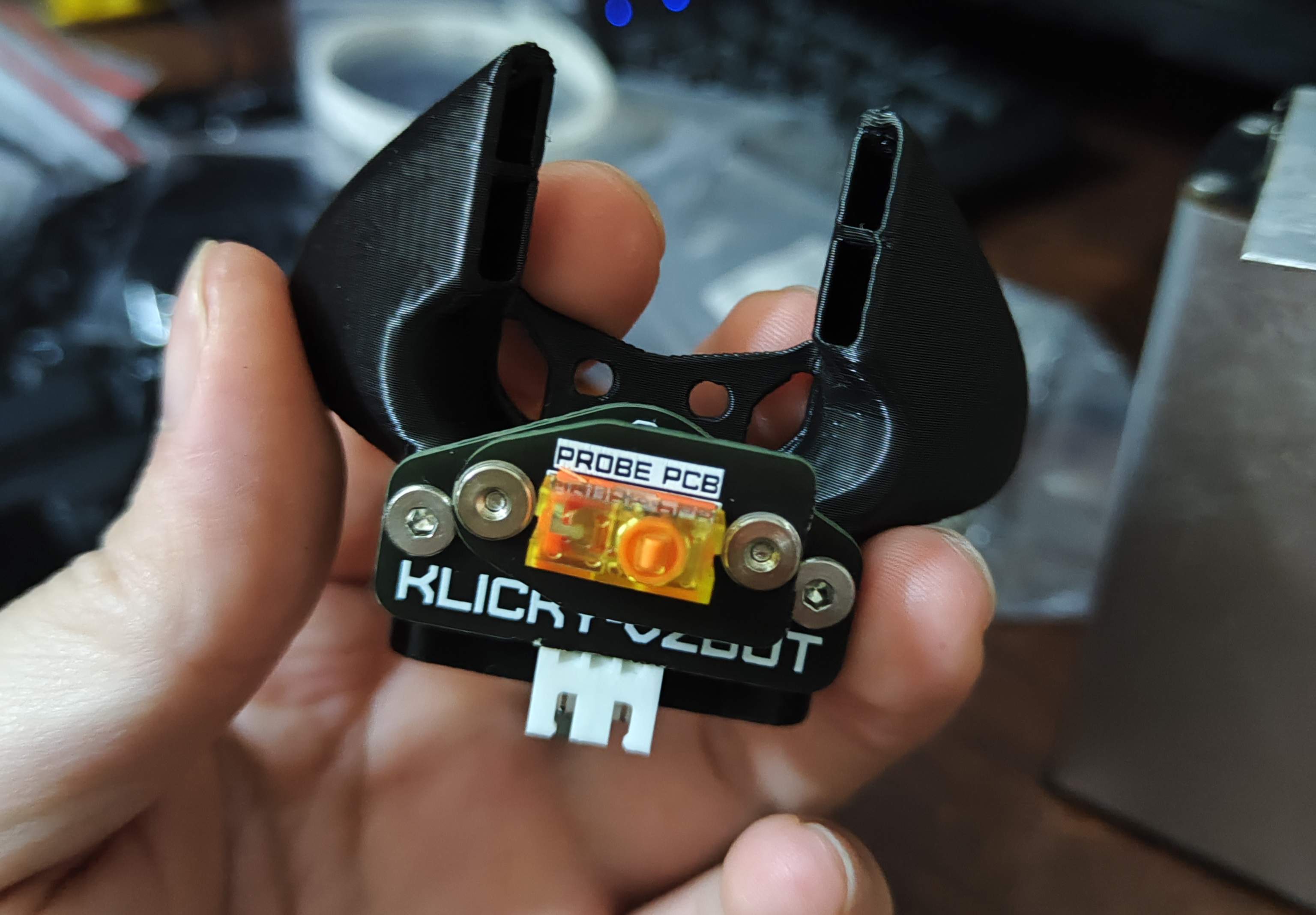

vzbot klicky beacon version
Awesome! Stable!! VZ...Boom!!!
Mom no longer has to worry about my VZbot not being leveled!

*Plate thickness 1.6mm
Material
quantity
requirements and uses
Outer diameter 6*thickness 2-hole M2 countersunk strong magnet
countersunk adsorption, for upper plate
https://m.tb.cn/h.5xdFq6ItlSIPAE6?tk=HRJCWMmJ1By
Outer diameter 6*thickness 3-hole M2 countersunk strong magnet
countersunk adsorption, for lower plate
https://m.tb.cn/h.5Chli0fY73ATZeI?tk=xMZ5WMmJ1eD
M2X₵5.5X1+₵3.6X1.5 SMD nut
Countersunk hexagon M2*5 Suitable for 1.27mm wrench
Flat
head hexagon M3x4
XH2.5 4 Port straight pin 3P
Attached air duct printout
This air duct has been modified to better fit Klicky
micro switch
0805 resistor 1K
0805 LED
The upper
plate uses a 6mm outer diameter, 2mm thick M2 countersunk magnet;
the lower plate uses a 6mm outer diameter, 3mm thick M2 countersunk magnet.
Assembly effect:
docking dock.
