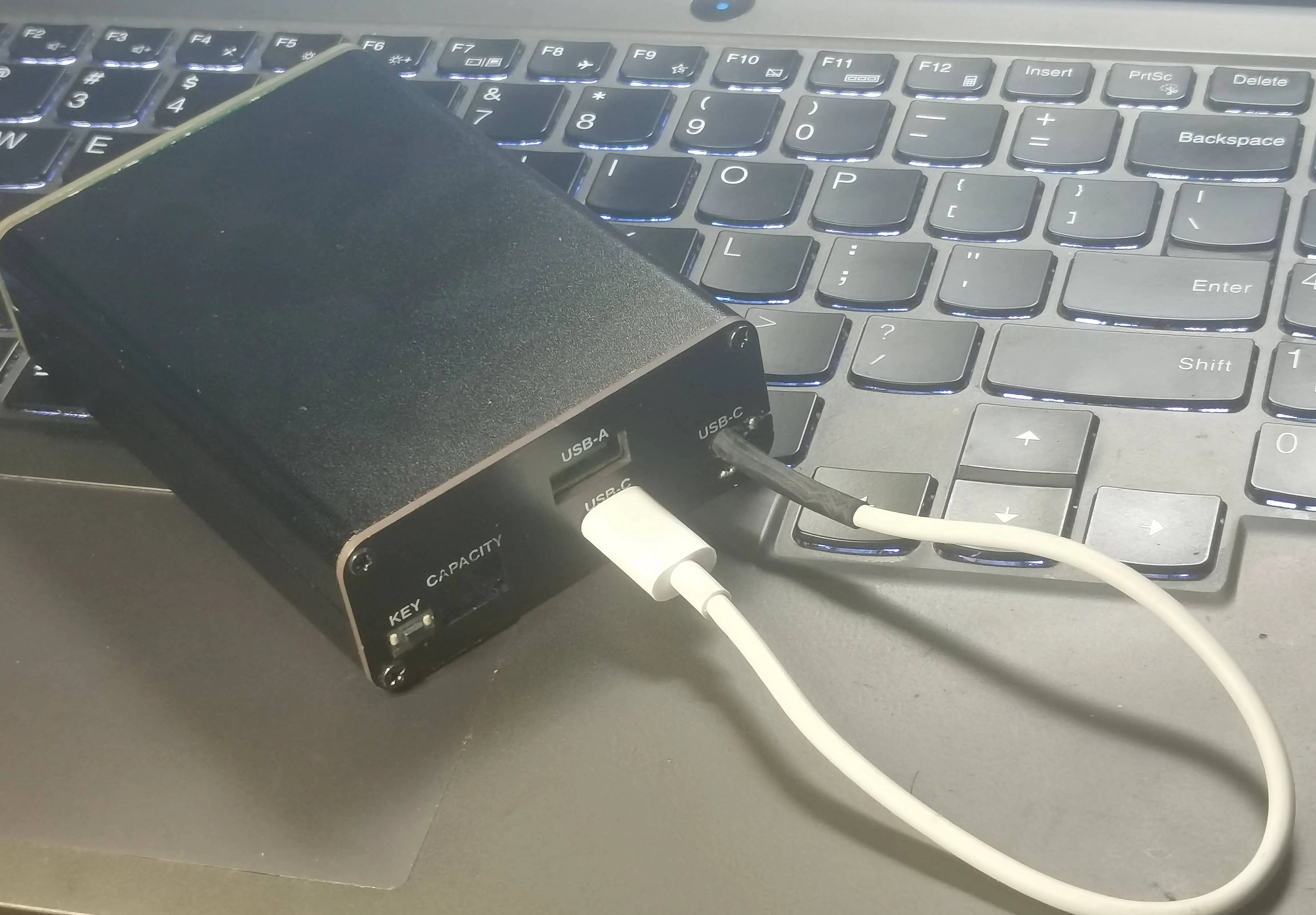

3S1P 21700 multi-protocol fast charging power bank based on SW6306
Supports SVOOC, high voltage SCP (40W), UFCS (105W) protocols, etc.
Program code is included (see attachment). Some program notes are in the readme.md file.
Parameters:

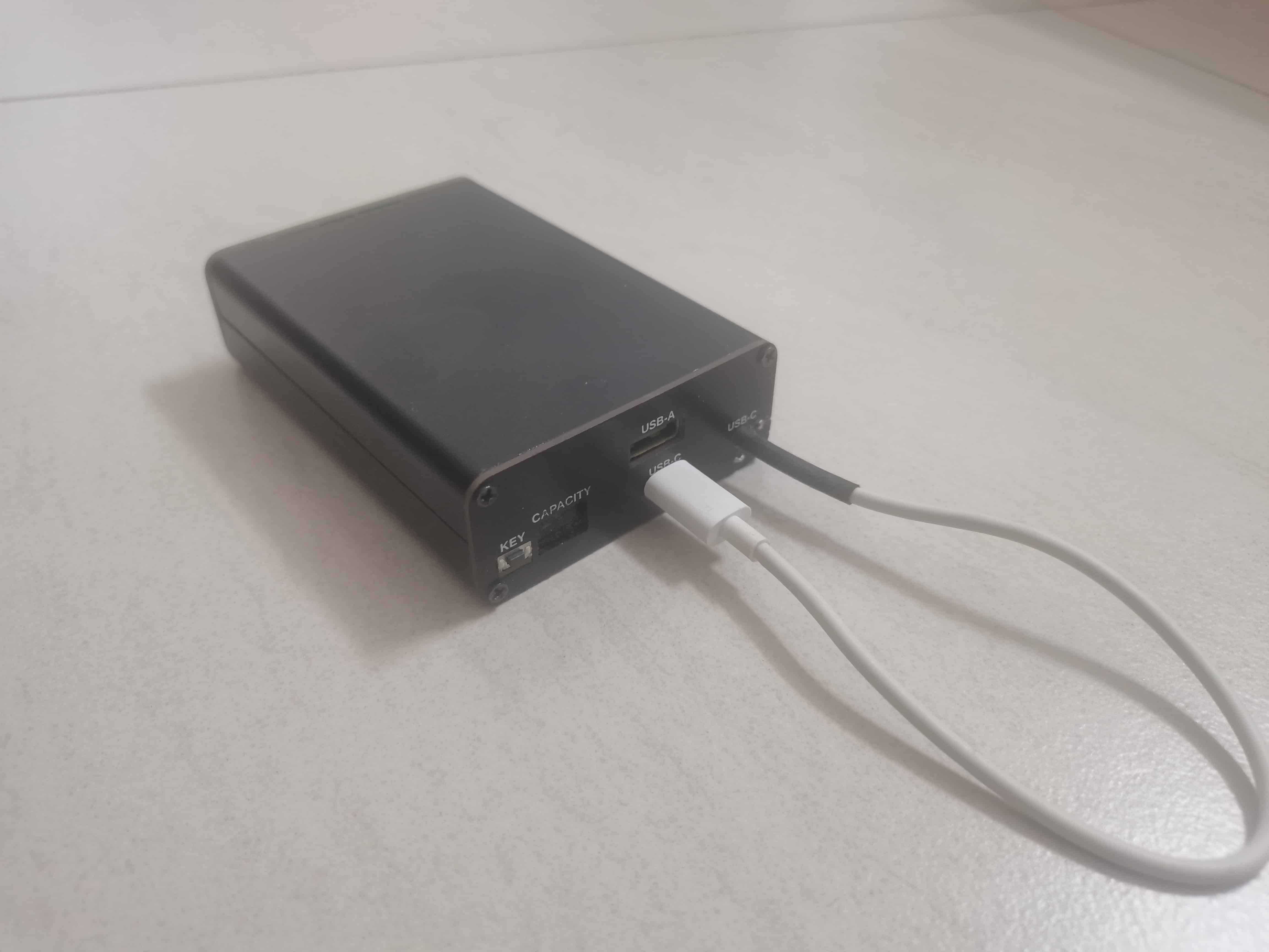

Dimensions: Length * Width * Height = 105 * 71 * 28mm (excluding included cable)
; Weight: 366.3 g;
Display: 0.25-inch 188-digit digital tube with percentage and fast charging indicator;
Interfaces: USB-C * 2, USB * A;
Input Power: 60W max, 20V max, 3A max;
Output Power: 90W max, 20V max, 5A max;
LED Power: 1~18W;
Input Supported Protocols: PD3.0 / FCP / SCP / AFC / DCP / VOOC / UFCS, etc.;
Output Supported Protocols: PD3.0 / QC2.0~QC5 / FCP / SCP / AFC / PE / DCP / SVOOC / UFCS, etc.;

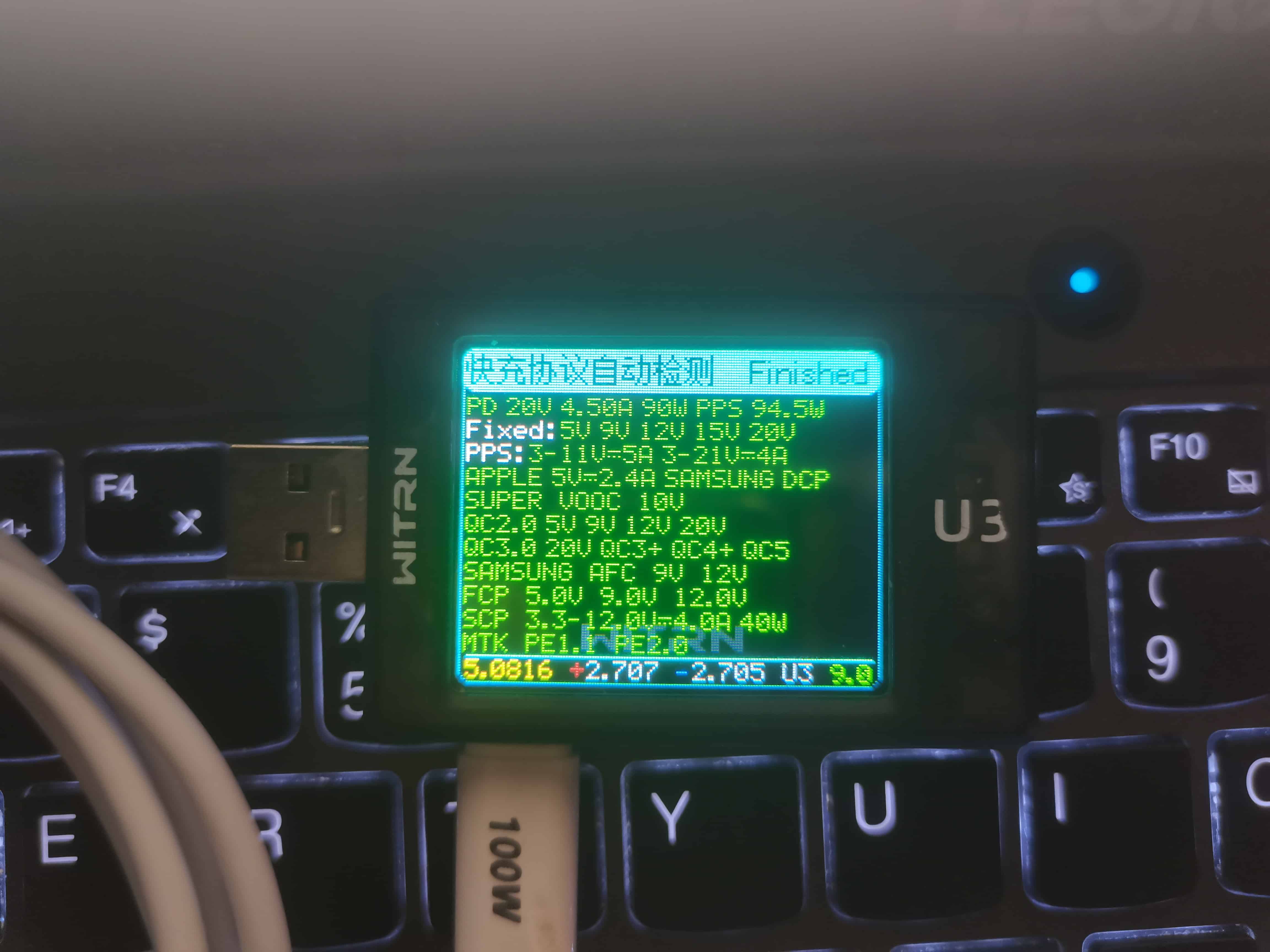

Testing:
Instrument:
Oscilloscope: SIGLENT/鼎阳SDS1102X-C
Multimeter: ZOYI/众仪 ZT219
USB Multimeter: WITRN/维简 U3

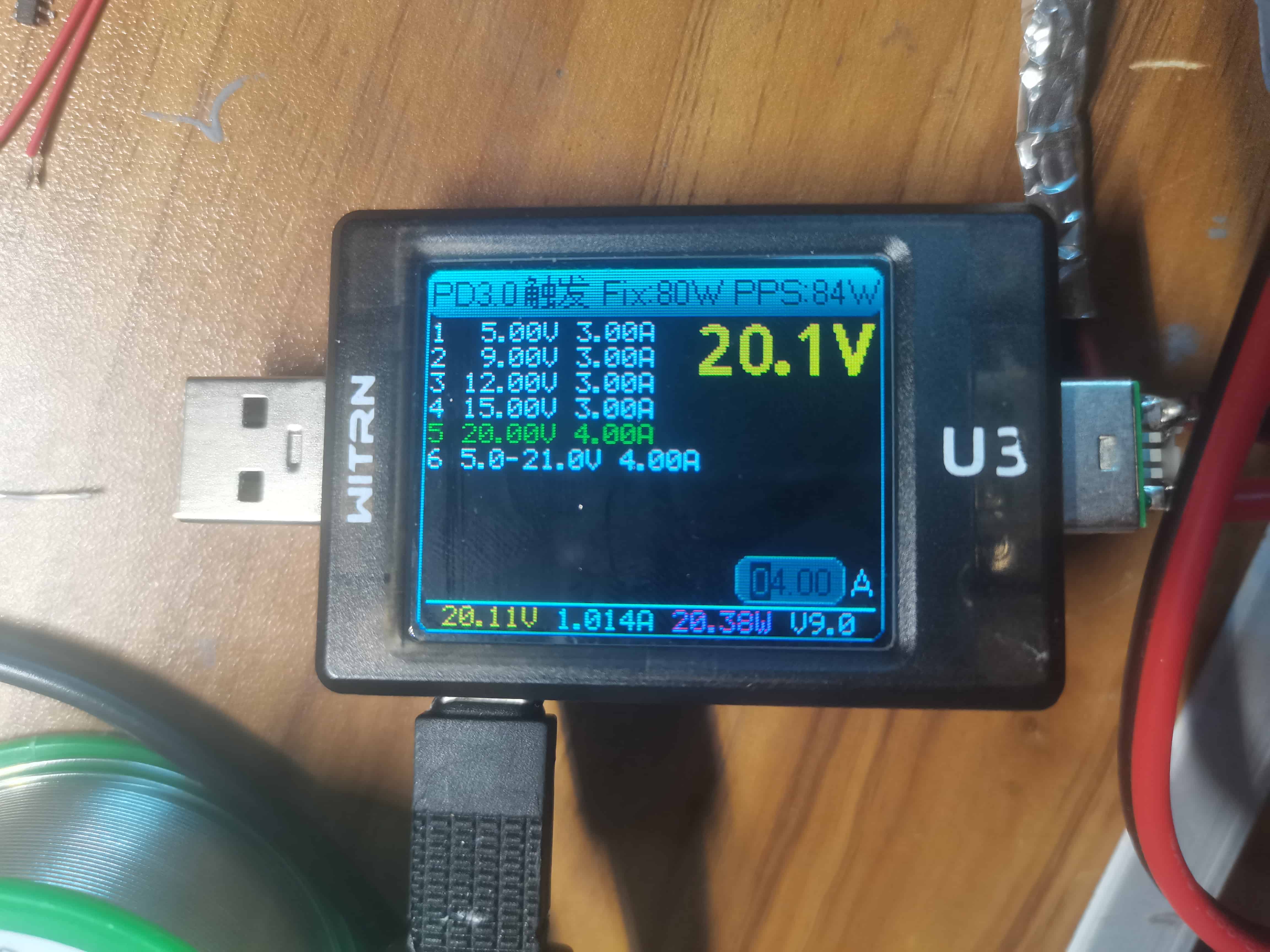

Protocol Test:

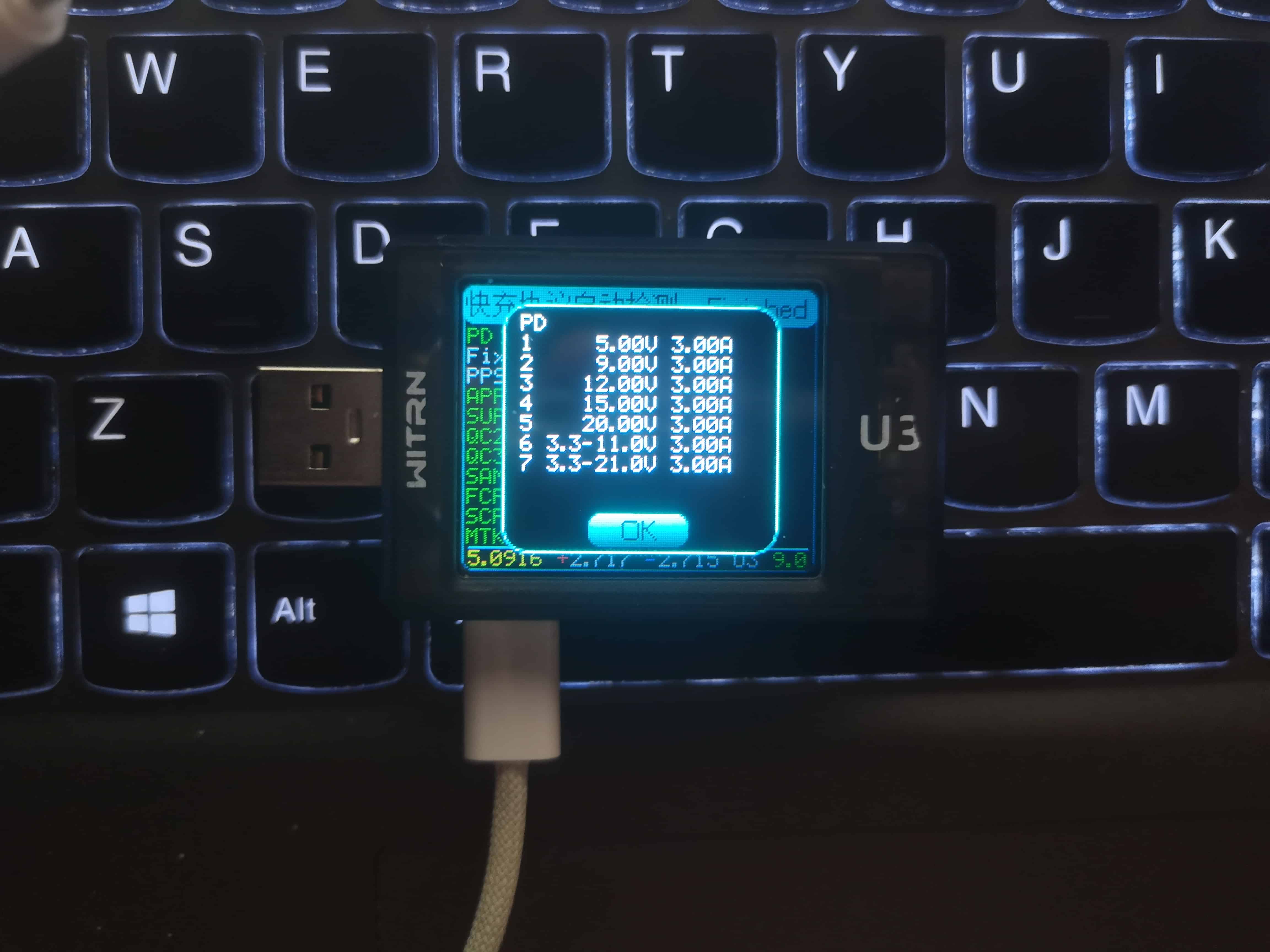

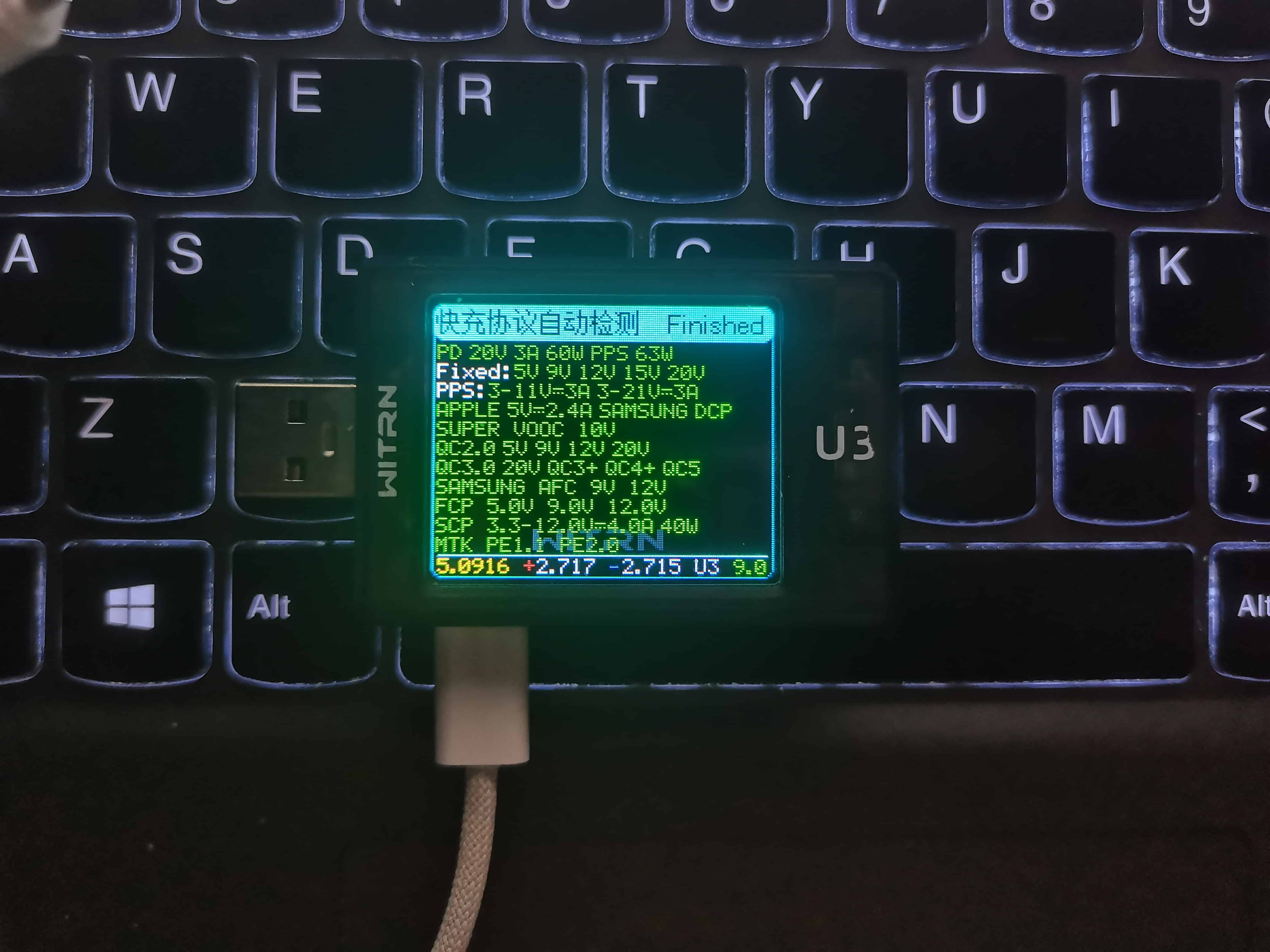

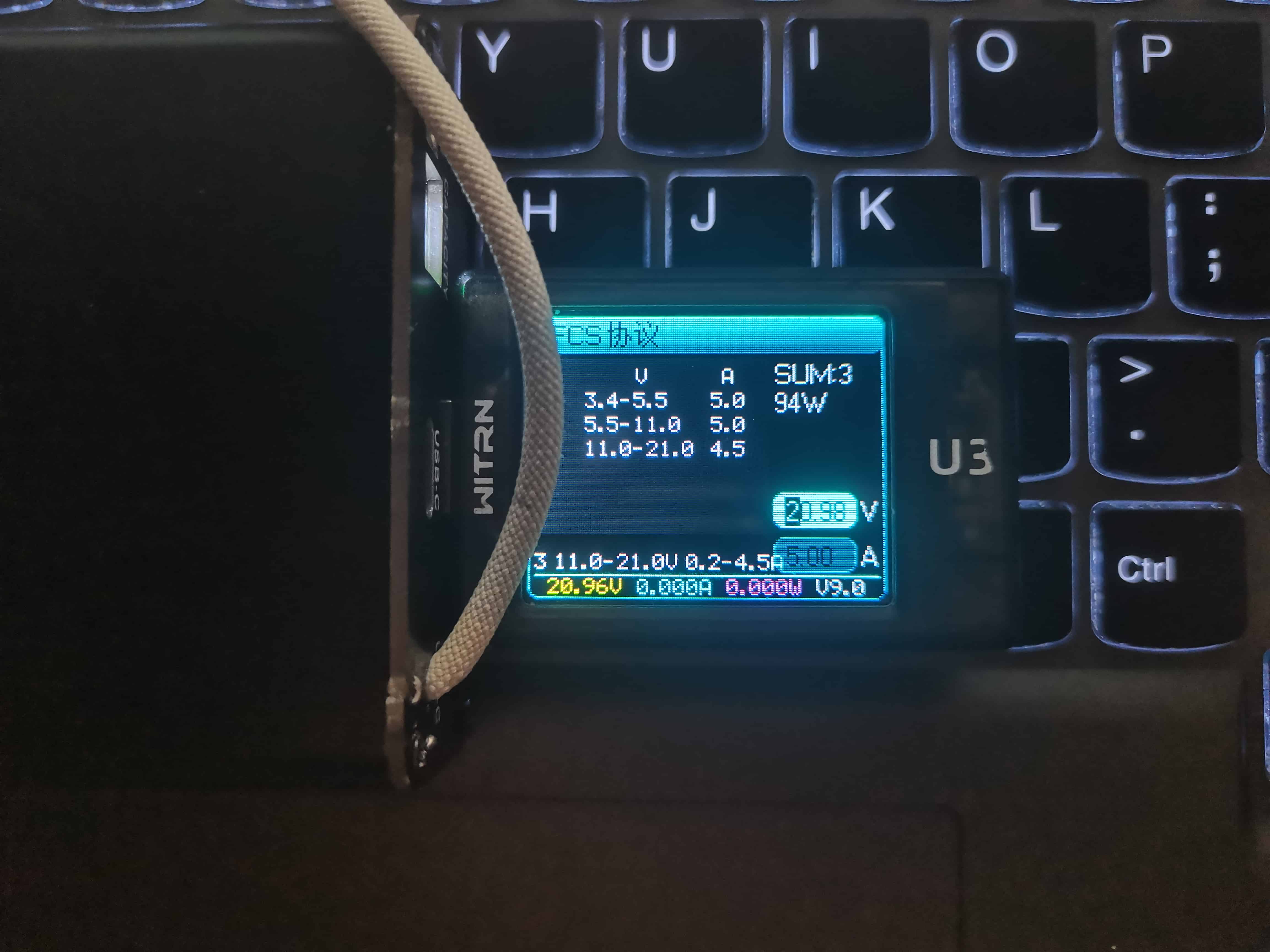

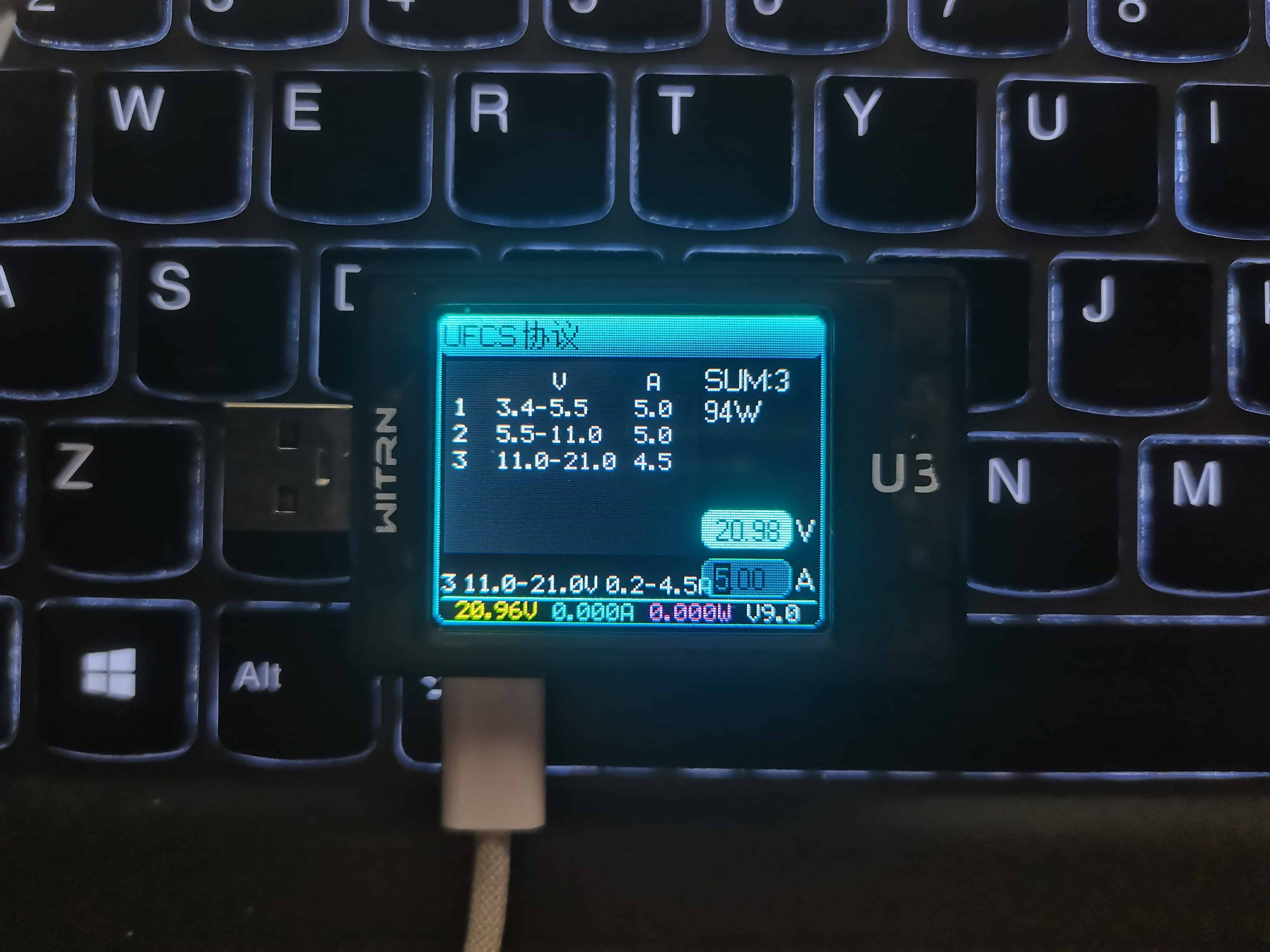

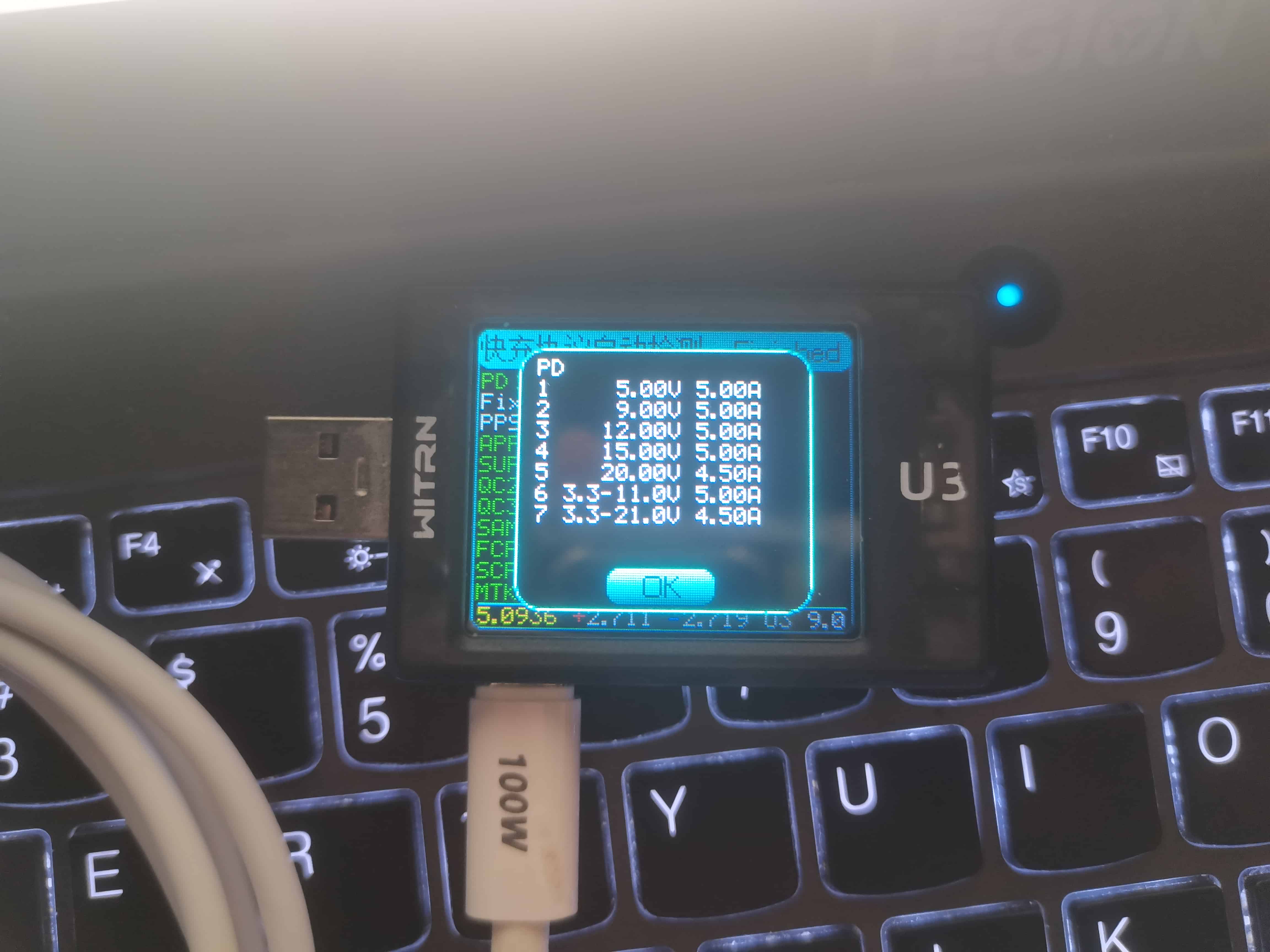

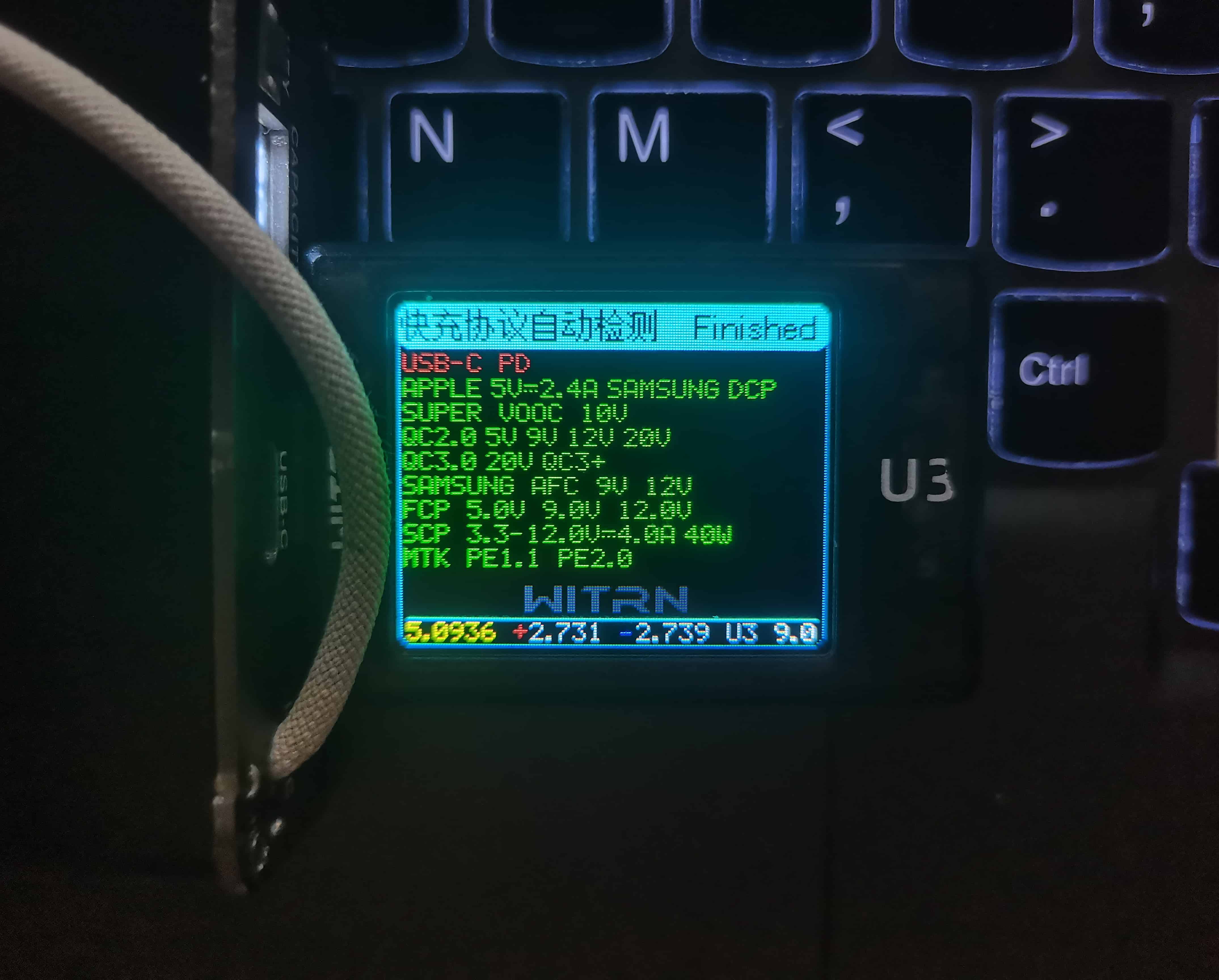

Port C1 (with included cable): Port C1 PDO: Port C2 (using EMARKER cable): Port C2 PDO: Port C UFCS (both ports are the same): Port A Fast Charging Protocol: Port A UFCS: Charging/Discharging Energy and Casing Temperature Rise Test:

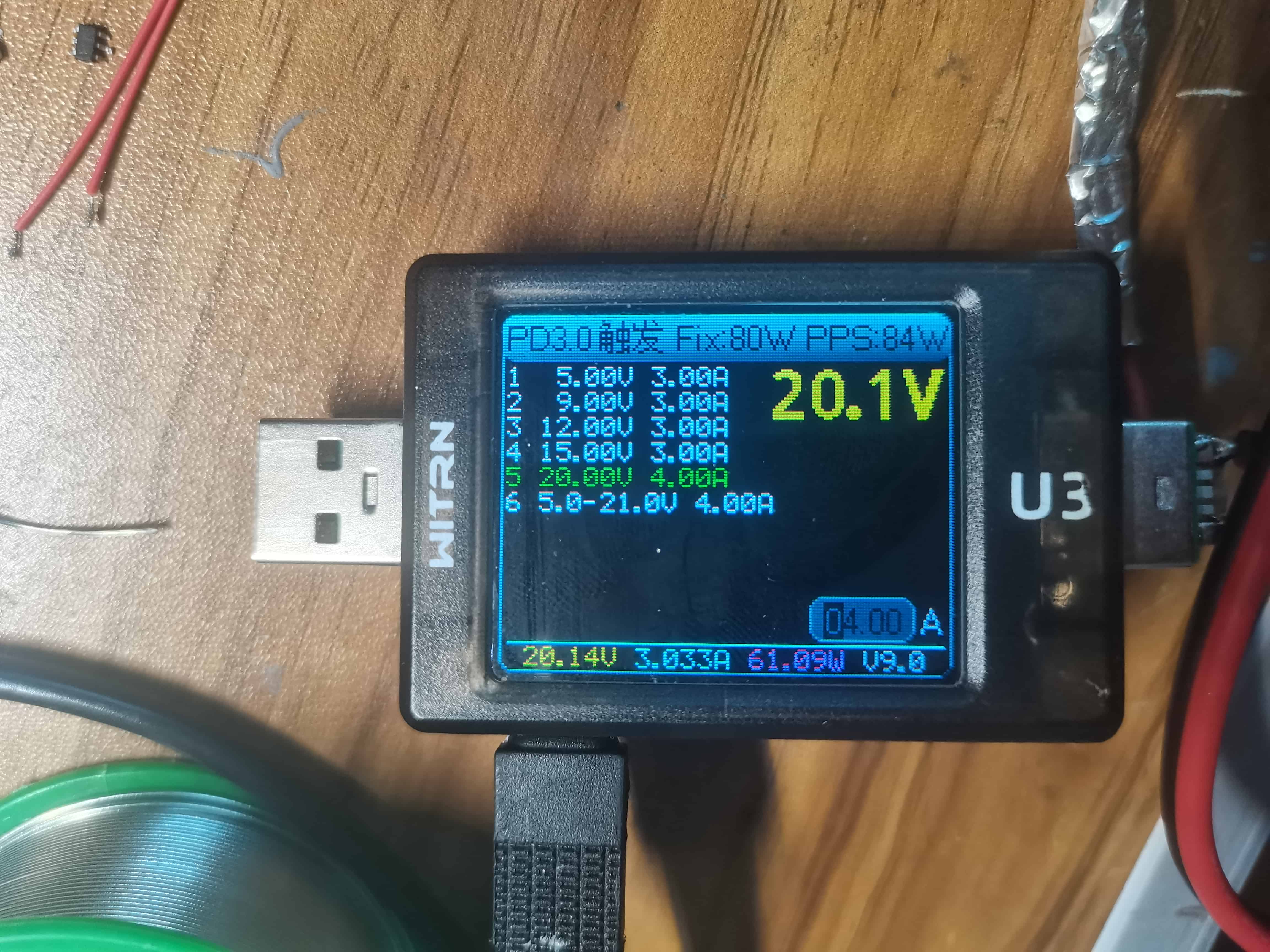

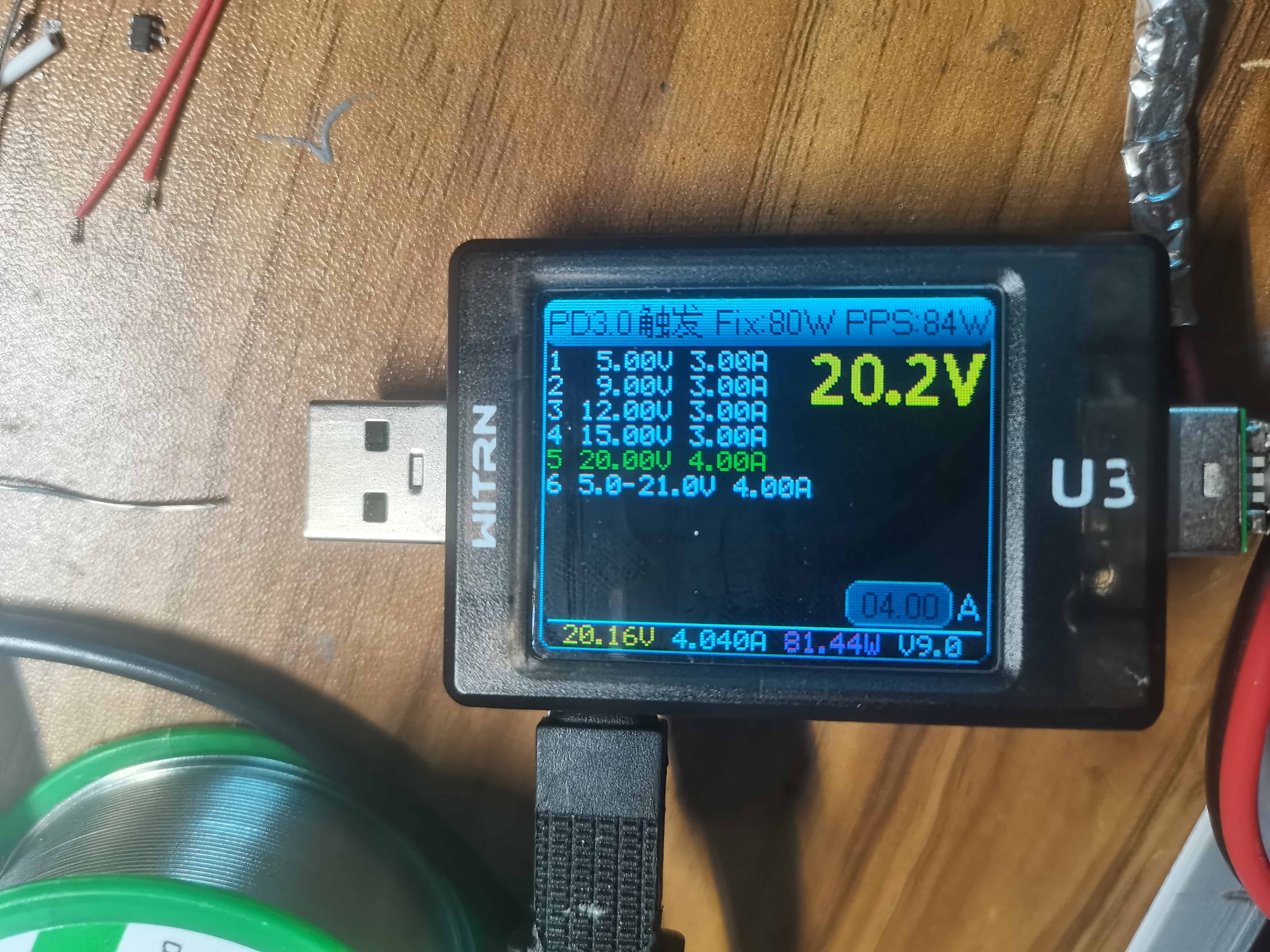

80W Discharging: 43.75Wh 32.8°C -> 55.8°C (maximum temperature)
60W discharge: 44.99Wh 31.6°C -> 51.7°C (maximum temperature)
20W discharge: 47.38Wh 32.6°C -> 34.2°C (maximum temperature)

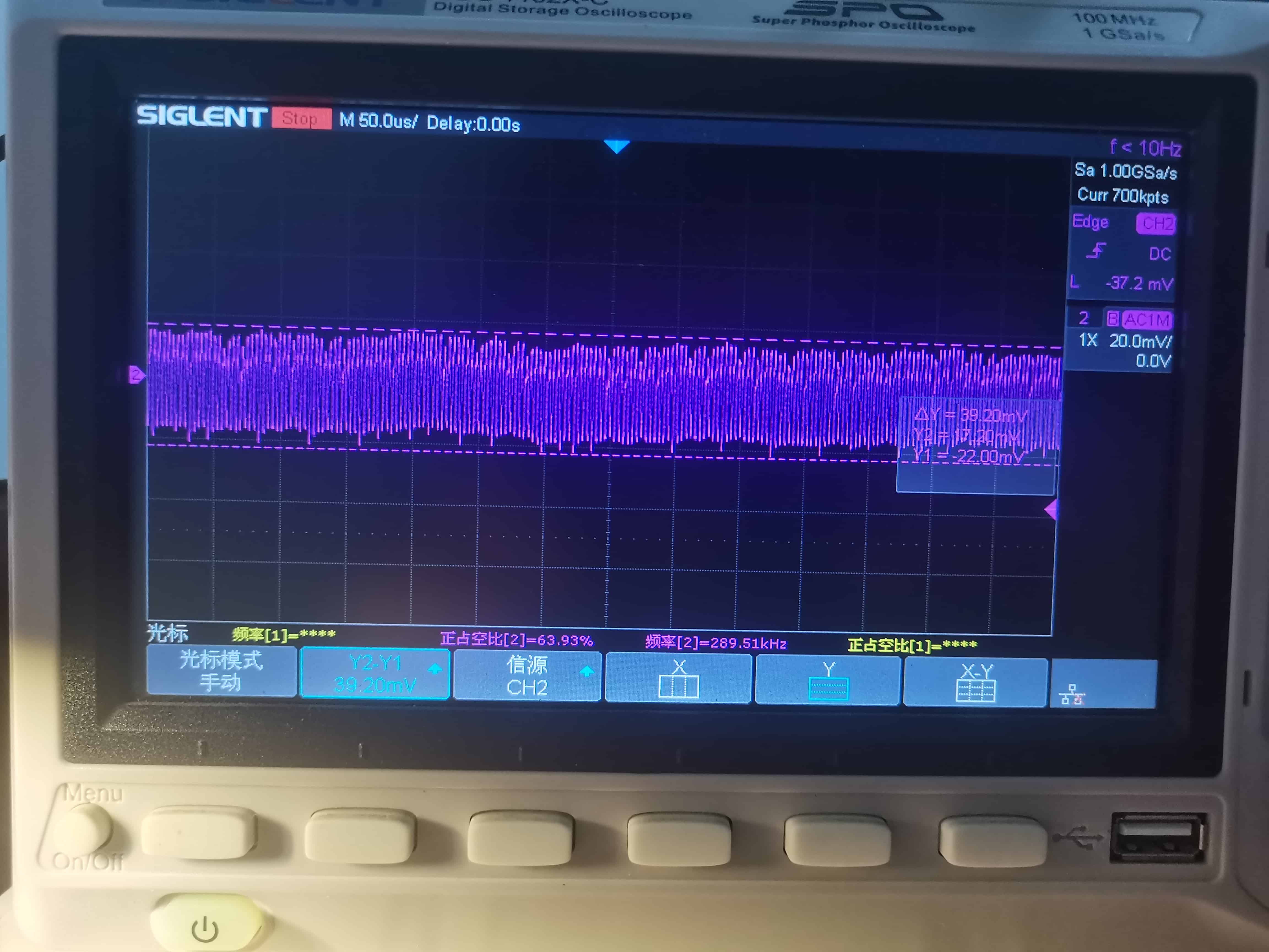

Output ripple test:
No load 40mV:
20W 45mV:
60W 90mV:
80W 118mV:

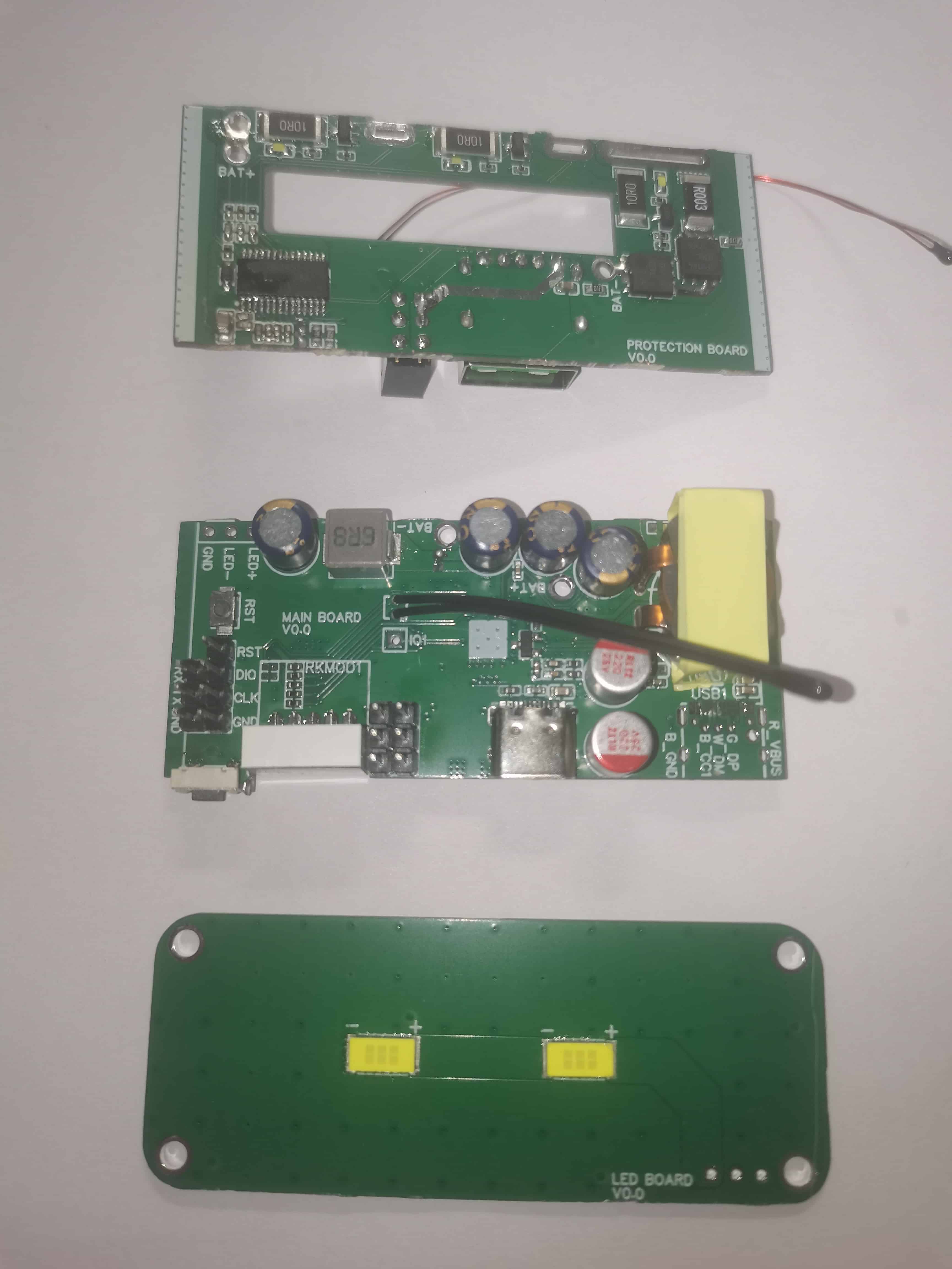

Three options:
In this design, the microcontroller main control, LED lighting, and built-in wiring are three optional circuits.
For how to modify the schematic and select the PCB when choosing between them, please refer to the last page of the schematic (microcontroller section).

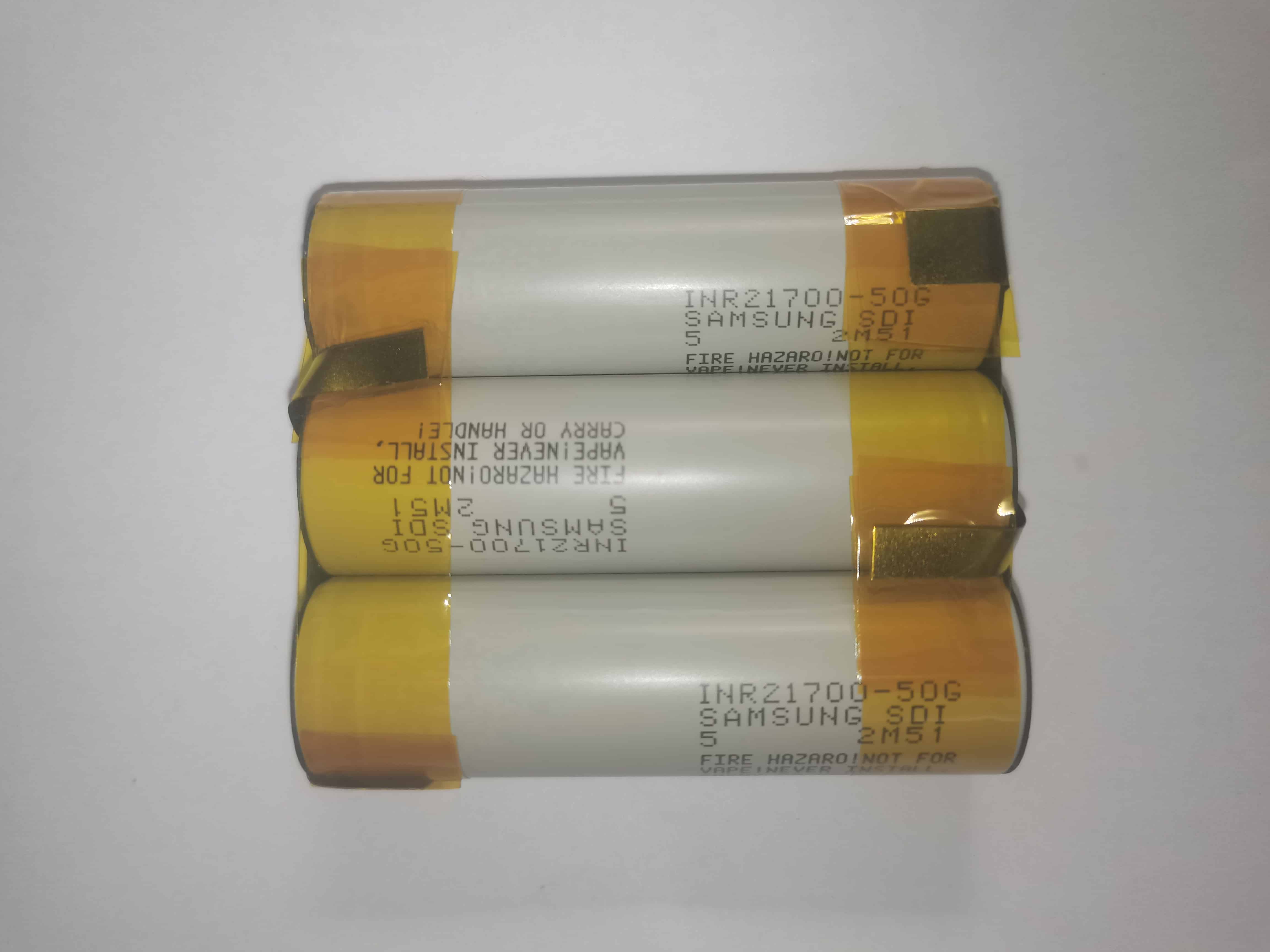

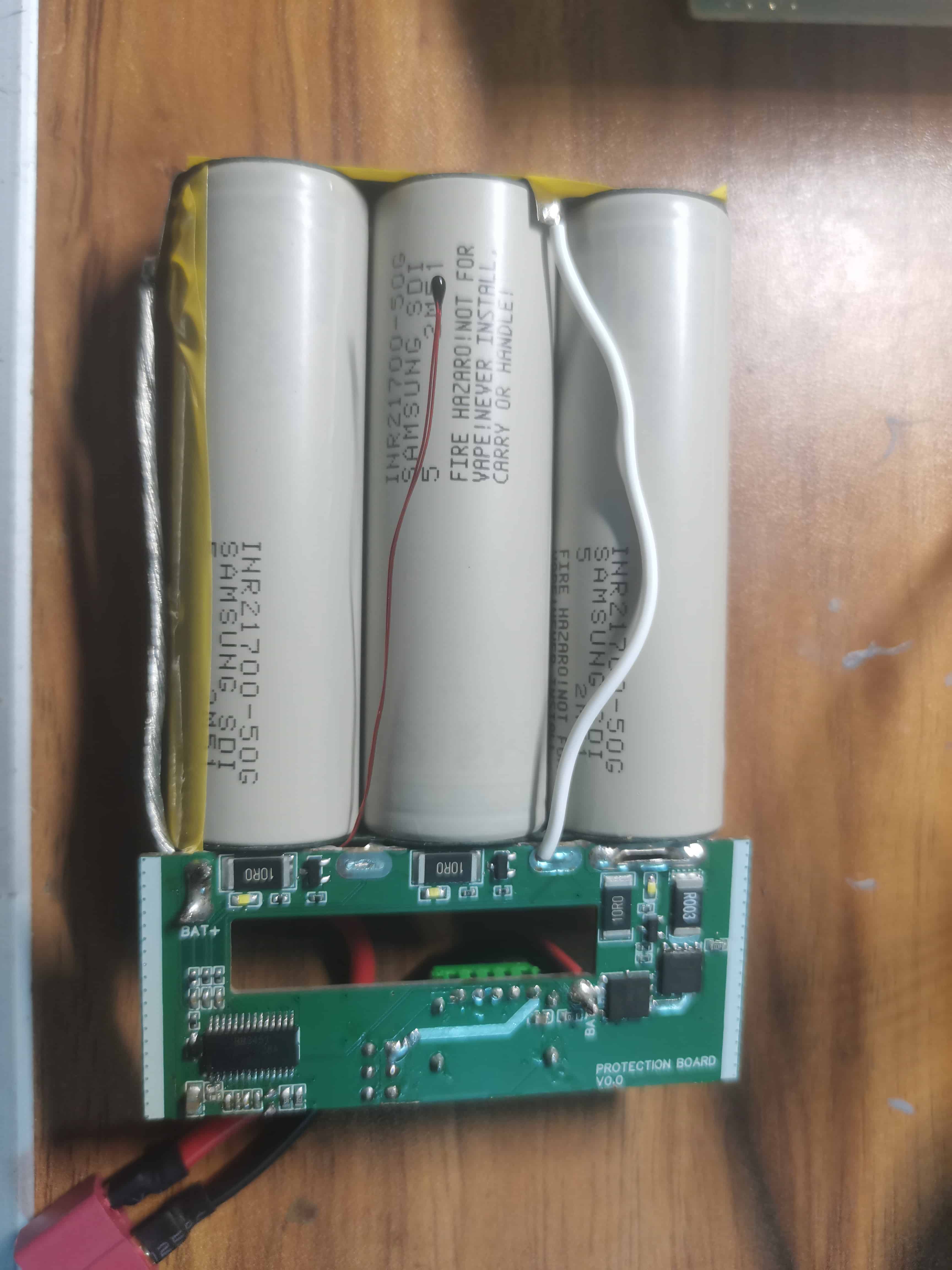

Battery: 3 21700 batteries, spot-welded into 3 series according to the method on page 3 of the schematic (protection board section).
I chose 3 salvaged batteries. Samsung 50G, moderately priced, purchase link: Disassembled Samsung INR21700-50E lithium battery 3.6V suitable for high-power flashlights and electric vehicles 21700 cells - Taobao (taobao.com).
Other batteries such as Samsung 50S, 50E, and Lishen LA can also be used. Modify the battery configuration resistor or the power limit in the sw63066.h file according to the battery's charge and discharge capacity.
Casing: 71*27 split aluminum casing, choose your favorite color, length 100mm, see attached size diagram. Purchase Links:
Aluminum Alloy Shell, Aluminum Profile Shell, Instrument Shell, Battery Box, Metal Shell, Controller Aluminum Shell, Aluminum Box 71
*27 - Taobao (taobao.com) Aluminum Alloy Box, Aluminum Profile Shell, Split Aluminum Shell, Custom Battery Box Shell, Circuit Board Shell, Opening 71*27 - Taobao (taobao.com)

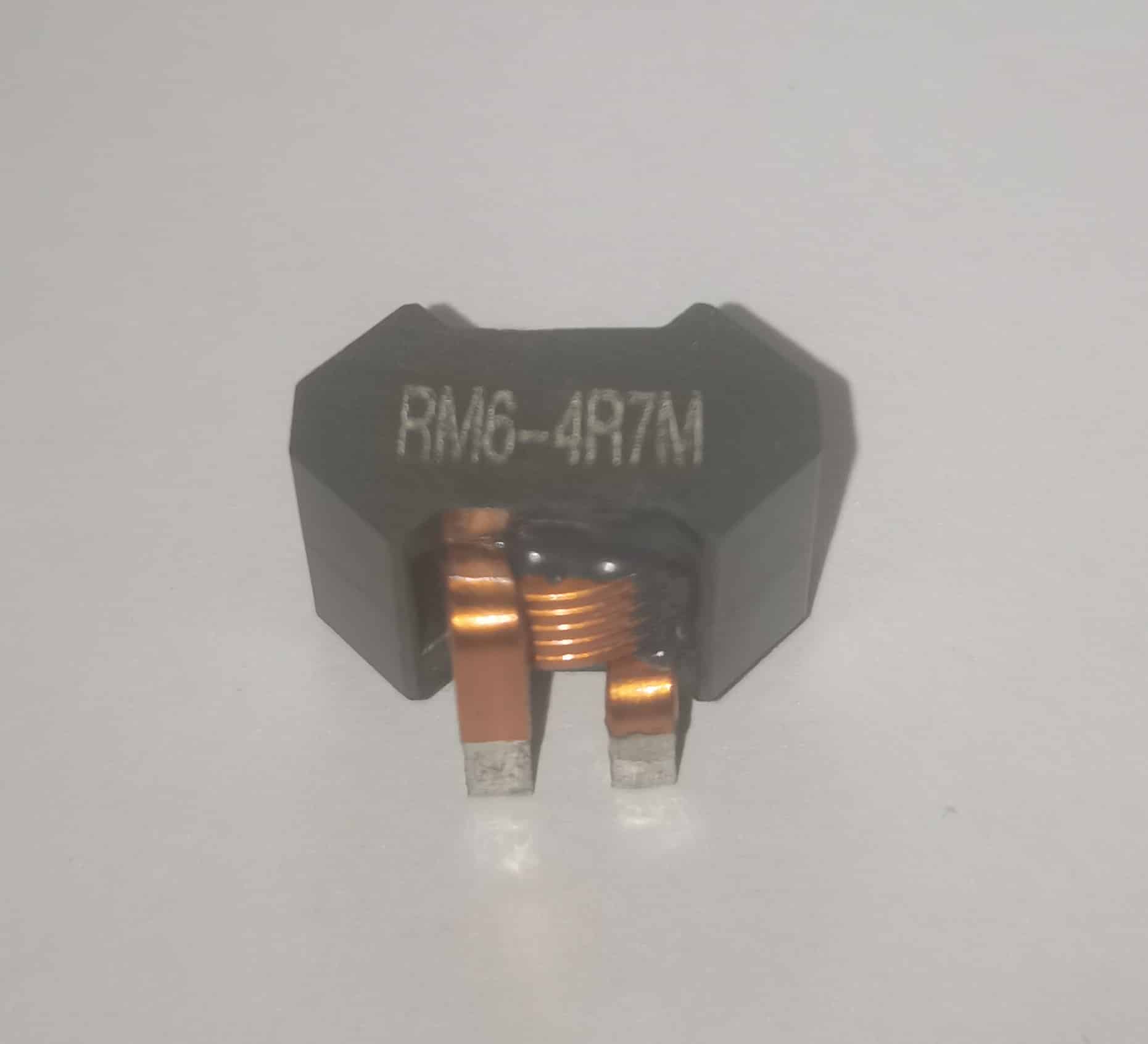

Inductor: RM Flat Copper Wire Inductor (as shown), inductance value selected 4.7uH.
Purchase Links: High Current Flat Copper Wire Inductor 100A RMPQ Filtering Energy Storage Direct-Through Magnetic Core Wound Power Inductor Coil - Taobao (taobao.com)
LED Boost Inductor Selection 6.8uH 0650 (5mm height), choosing 0630 may have saturation risk

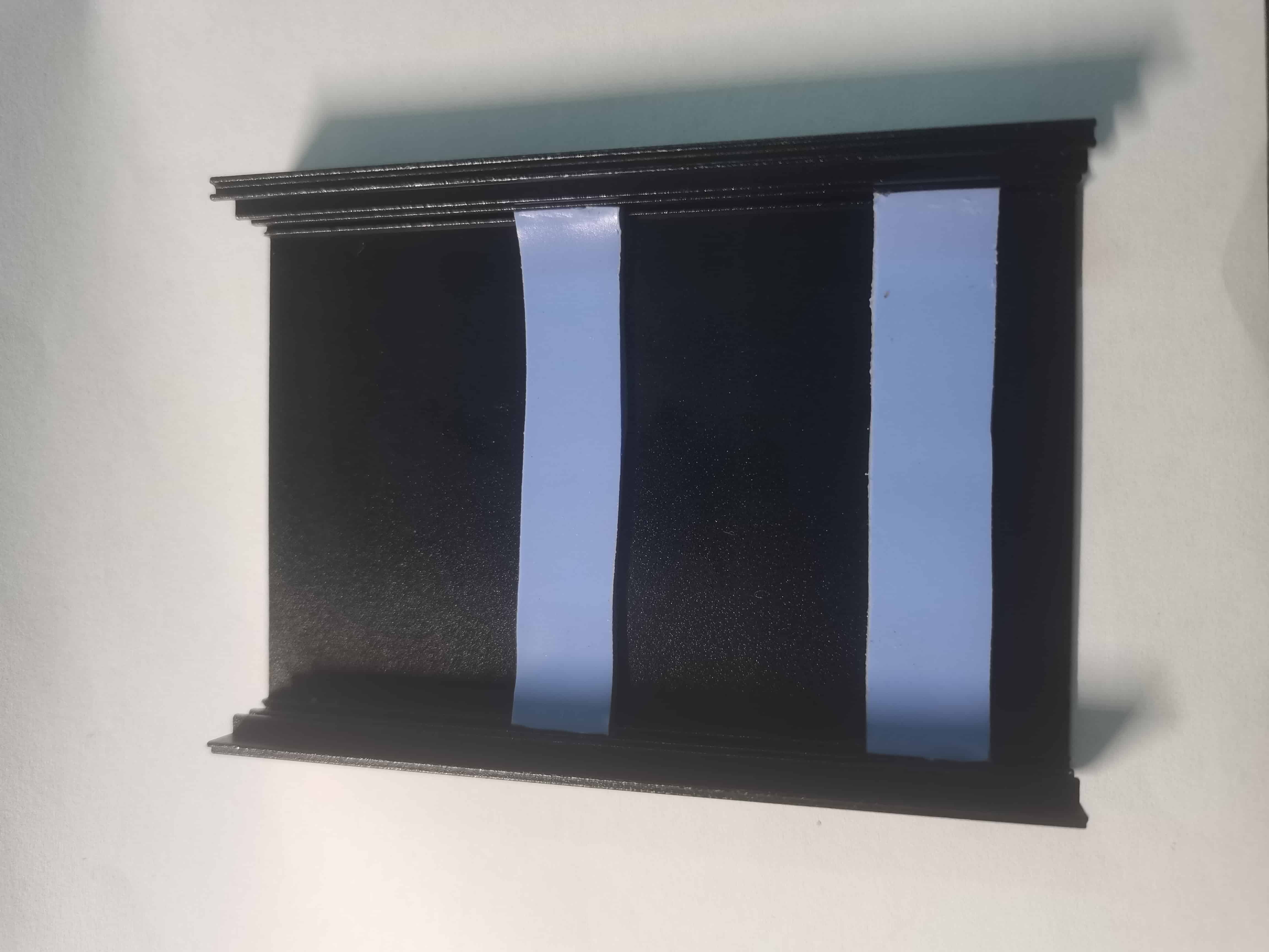

Thermal Pads: Purchase 2mm thick silicone thermal pads and cut them yourself.
Purchase link: Thermally Conductive Soft Silicone Sheets, CPU Heatsinks, LED Power Heatsinks, PCB Circuit Board Thermal Insulation - Taobao (taobao.com)
Production:
Determine which functions you need and which components do not need to be soldered. See the last page of the schematic diagram for details
. Clone the project and modify the files as needed.
According to the schematic diagram and BOM, refer to the component selection section to purchase components.

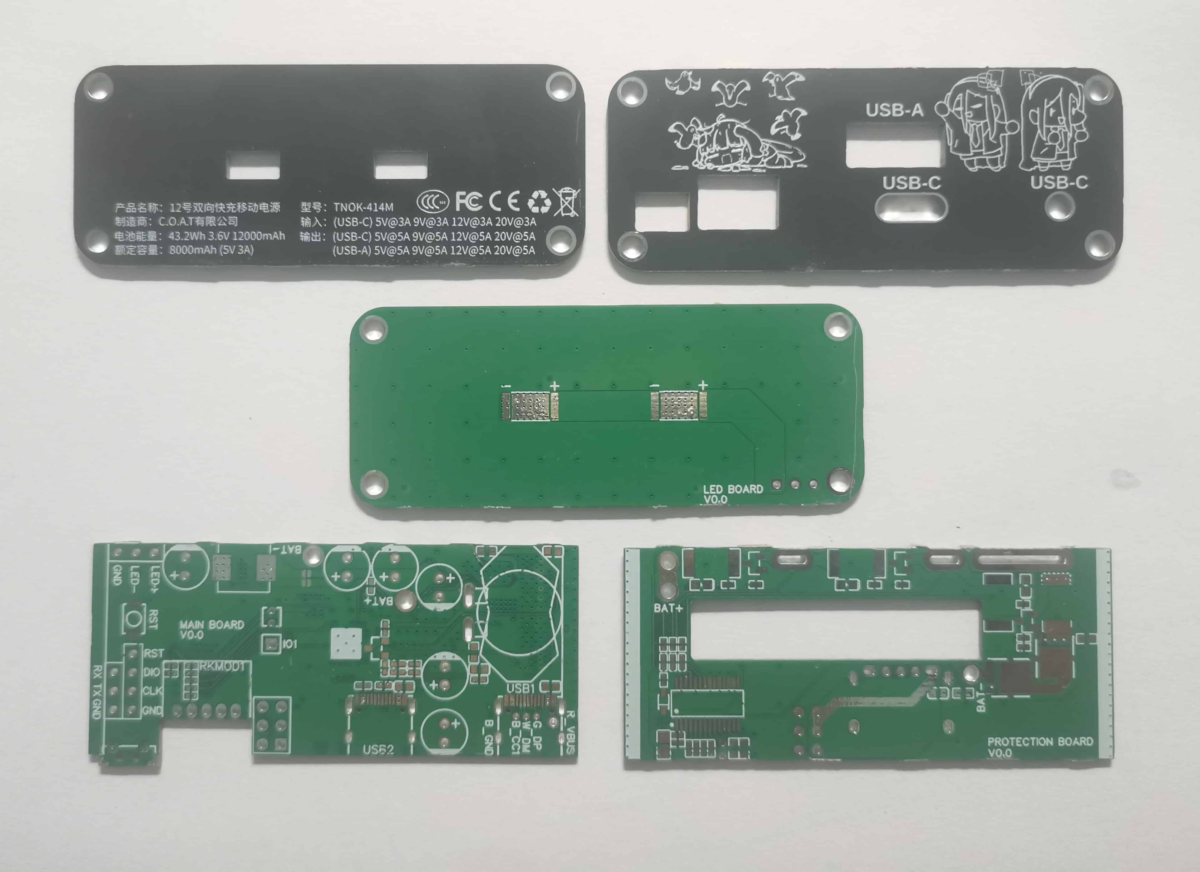

Open the PCB in the editor, select the required board, and assemble or separately prototype

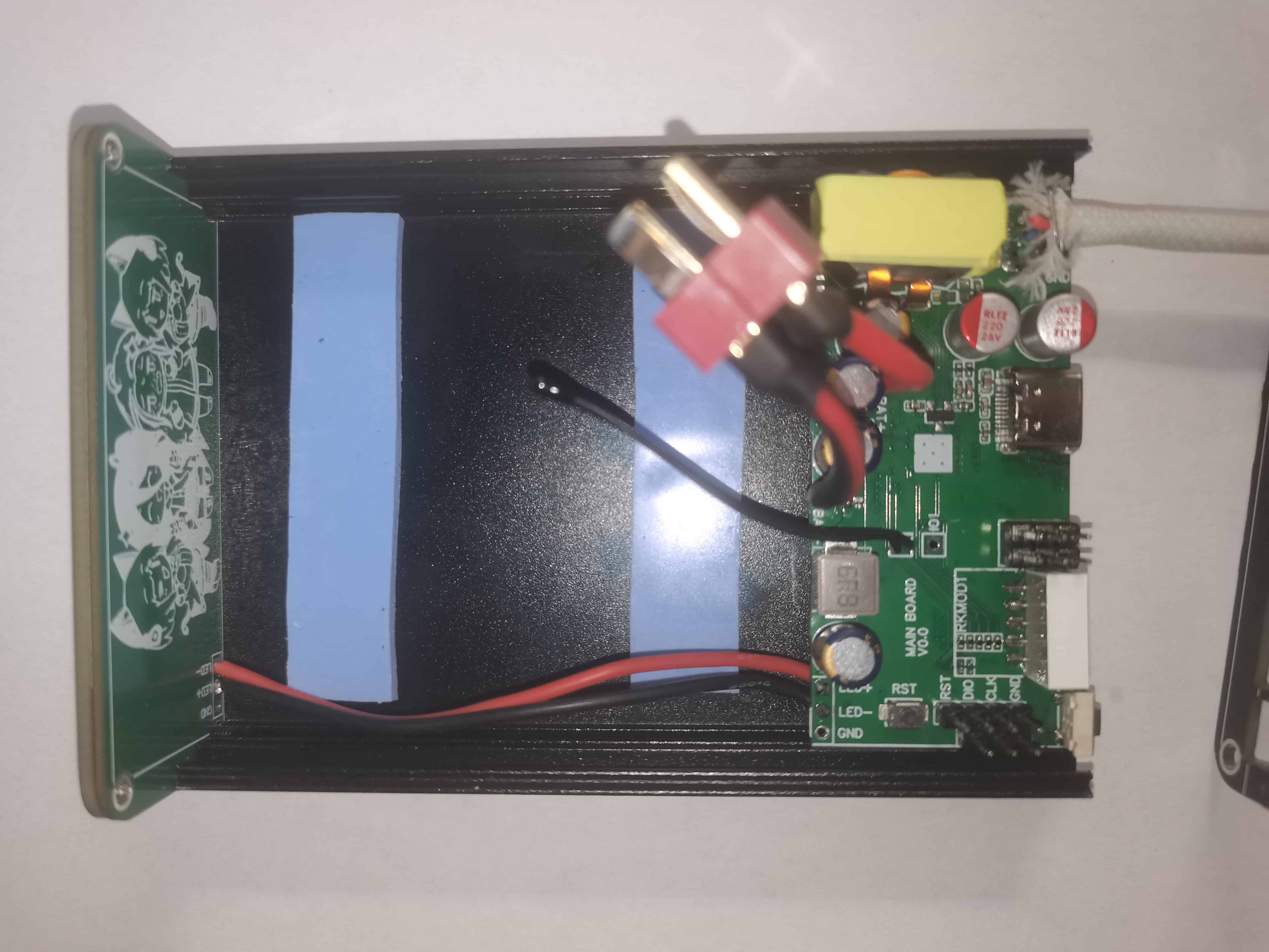

to obtain the PCB: Solder the main board, paying attention to the LED polarity. The digital tube needs to be bent 90 degrees. Soldering: Wrap 3 turns of high-temperature tape around both ends of the battery to prevent short circuits with the casing; Cut the thermal pads as shown (to support the battery). Both sides of the casing need them: Insert the protection board into the aluminum casing groove and solder it to the battery in order of voltage from low to high. Connect: Position the thermistor so that it is between the two batteries when the cover is closed.
Solder a wire of sufficient diameter and a suitable plug (for easy disassembly and assembly; the picture shows a T-plug) to the battery interface of the main board and protection board.
Assemble the lower half: Insert the main board into the slot, fix the LED board to the back with screws, and connect the main board and LED board with a wire of less than 20AWG. Use two layers of 2mm thermal pads under the inductor to conduct heat to the outer casing. Use a multimeter to test whether the protection board has voltage output and whether the main board battery terminal and interface terminal are short-circuited.
Connect the main board and protection board and see if the digital tube lights up
(included wire). Take a suitable length (15~30cm), cut the wire, and put it into a 10mm long, 6mm diameter heat shrink tubing, but do not heat shrink it. Thread the wire into the pre-drilled hole on the panel with the C end facing out
(included wire). Cut the wire end and find VBUS. Solder the five wires (GND, CC1, DP, DM) to the board according to the PCB silkscreen. After soldering, slide heat shrink tubing over the wire ends and heat shrink. Ensure the heat shrink tubing is inside the panel hole
before sliding the included wires. If there is a shielding mesh, it is recommended to solder half to the motherboard's C-port outer pad and half to the edge of the panel hole to increase mechanical strength
(microcontroller). Prepare DAPLINK. Install KEIL and DAPLINK drivers on your computer. Connect DAPLINK to the motherboard header according to the readme.md in the software folder. Open the uvproj file, compile and download
(microcontroller). If a connection failure is displayed, check the connection cable. Use a short connection cable or simply hold the connection cable to prevent external signal interference.
After downloading (microcontroller), press the RST button to open the serial port assistant and observe the output (baud rate 115200).
Test the charging and discharging power and protocol to ensure they are normal. Test the digital tube power display and fast charging display to ensure they are normal.
Test the LED lighting function to ensure it is normal.
For final assembly, the plug and socket connecting the motherboard and the protection board can be inserted into the slot on the protection board. When closing the aluminum shell, align the 2*3pin socket on the protection board with the plug on the motherboard
and tighten the screws.
