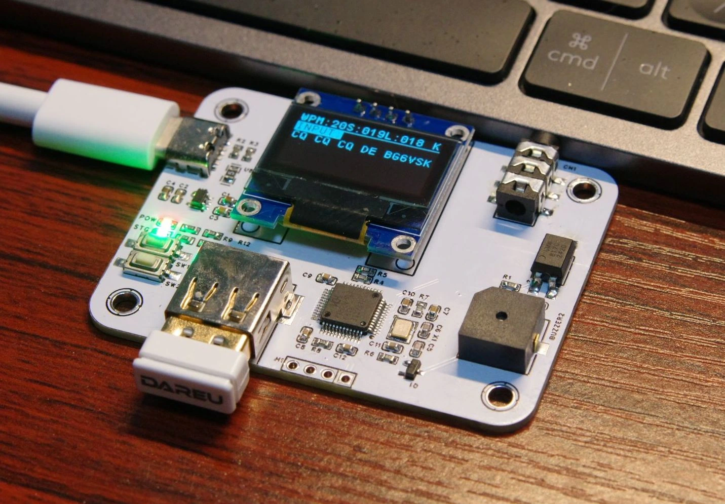

In the process of using various CW auxiliary software for sending and receiving CW signals, many software programs support inputting data from the keyboard and converting it into CW audio or keyed signals, which are then transmitted via radio. Some radios also support keyboard input. However, considering that some radio models do not support the above operations, or that connecting to host computer software is cumbersome, I designed and produced this CW electronic keyboard. Dimensions: 65mm*50mm. Test video: https://www.bilibili.com/video/BV19sppeeEKR/ Functionally, considering the special nature of keyboard input, an OLED screen was added for inputting content, facilitating the review and modification of output.
On the screen display: WPM: Indicates the current rate; S: Indicates the current CW output position; L: Indicates the current total input length; B: Indicates the buzzer on/off; K: Indicates the keyboard insertion status. A brief description of the functions is as follows:
WPM is adjusted using the keyboard arrow keys. The up and down arrow keys (↑) and (↓) represent adding or subtracting 1 from WPM, respectively, and the left and right arrow keys (←) and (→) represent subtracting or adding 5 from WPM, respectively.
Button 1 is used to switch the buzzer. When the status bar displays (B), the buzzer sounds simultaneously during CW transmission; otherwise, the buzzer does not sound.
Button 2 is used to switch the transmission mode. In mode A, pressing the key immediately initiates CW transmission until the current input queue is completely sent. In mode B, the input content is buffered and sent only after pressing Enter.
Modes A and B can be distinguished by the display status, as shown in the figure below:
In mode B, the left side is the input buffer, and the right side displays the content currently being sent.
