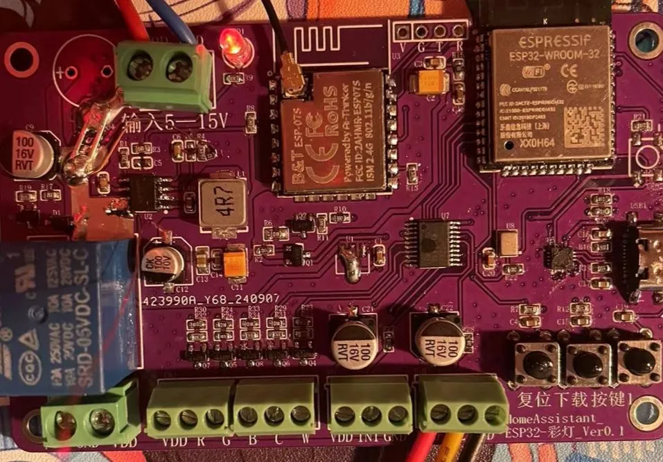

ESP32 Homeassistant - Colorful Lights
Project Introduction
: This section provides a basic description of the project. Example:
This project is a HomeAssistant remote LED light system based on the ESP32 module. It features remote network access, remote control, and audio rhythm display.
Project Functions
: 1. ESP8266 Functions: Remotely control the external power supply, control the ESP32 module's on/off state, and determine whether it enters working mode;
2. Uses the ESP32 as the main control module to control the LED strip's operating status, including audio acquisition. The ESP32 controls different colors such as RGB;
3. The ESP8266 uses the ESPHome function to connect to HomeAssistant.
Project Parameters
: DC-DC Power Supply Chip: SY8205FCC
Chip; Input Voltage: 4.5-30V;
Output Voltage: 5A continuous, 6A peak load current capability;
Reference Voltage FB: 1.5% 0.6V; Reference
Principle Analysis (Hardware Description)
: This section can be used to fill in the project's design principles, breaking down and analyzing the design principles. Example:
This project consists of the following parts: power supply section, USB download circuit, ESP8266 main control section, ESP32 main control section, RGB output interface section, and audio acquisition section. This project is mainly based on Home Assistant remote control to achieve flashing of home ambient lights.
Example Figure 1 -- Power Supply Circuit:
1. Using a DC-DC power supply chip to achieve a high current load, it can achieve the lighting effect of hundreds of LED beads in the application.
2. When there are too many LED beads in the subsequent stage, remember to open the PCB and perform tin plating to ensure that the PCB copper can meet the current required by the colored lights.
1. Check the SW4 toggle switch; its application in the ESP32 module enables USB serial port data download. 1. When no external power is connected, the switch is in the "up" position. The USB provides power to the DC-DC chip, enabling the CH343P to be correctly powered and download firmware (the ESP8266 needs to be programmed first, ensuring the ESP32_EN pin is high and the ESP32 module is powered on).
2. After the ESP32 module firmware download is complete, slide SW4 down to ensure the ESP32 module operates normally
. 3. For this quick demonstration, the ESP8266 module program is written using Arduino and runs normally.
Precautions:
1. First, program the ESP8266: Press the download button, and during programming, press and release the reset button to start the download.
2. When downloading the ESP32 firmware, some browsers may display "Initialization failed." Please download and update the CH343 driver firmware from the Qinheng official website, or use a different browser such as 360 Browser or Firefox.
3. After successfully downloading the firmware, if clicking "Next" has no effect or the page refreshes, check if the toggle switch is in the "off" position to ensure the CH343P is no longer working. Otherwise, the ESP32-IO0 pin will be low and will not work;
4. This sample requires some prior knowledge of Home Assistant;
[Image of the actual product]
