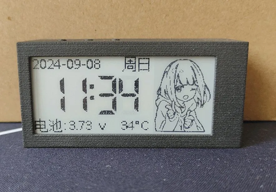

Project Overview:
This project uses the ESP32C3 chip and is developed based on Arduino. It features a clock and night light functions. The front of
the screen
is a 2.9-inch e-ink clock displaying year, month, day, weekday, time, battery voltage, internal temperature, and a custom image.
The back is a light board with eight 0.2W LEDs in series and two in parallel, providing a maximum power of 3.2W.
The three buttons on the back, from left to right, are: LED brightness adjustment, manual NTP time update, and software restart. The dimming function has three fixed levels: 20%, 50%, and 100%. The other two buttons are for preventing accidental touches; they require a quick double press to activate.
The Type-C port on the left is for charging and communication. Charging is 5V 1A by default, and the ESP32C3 can be debugged through this interface.

Appearance:
Version
V1.0.0 has not yet implemented low-power processing; a 2600mAh battery will last approximately one week.
