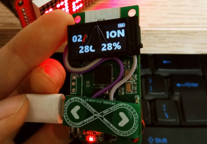

Device selection:
Microcontroller: stm32F411ccu6 (100Mhz)
Power management chip: TP4056
3.3V power supply dcdc chip: TPS62740DSSR
Lithium battery: 3.7V/200mAh, thickness 5mm, width 20, length 30
Display: ips 0.96 inch TFT
Gyroscope: LSM6DSM
Touch button chip: TTP232-CA6
Buzzer: SMD buzzer 5020
Environmental parameter sensor: BME280
Bluetooth module: Tuya BT7L
Use LVGL to write display interface
The ST official library of LSM6DSM has been transplanted, which can read three-axis acceleration and angular acceleration. There are many examples in the library, such as realizing direction detection, wrist raising detection, free fall detection, etc..., this noob did not use it because he is lazy. Extra added functionality
Project code: https://github.com/mxyxbb/LVGL_STM32F411_HAL_HandheldWeatherStation
Current features :
  • RTC time and date display
  • Temperature and humidity display
  • Bluetooth connects to Tuya Smart APP on mobile phone to report temperature and humidity data
  • Serial port sends LSM6DSM accelerometer data at 115200 baud rate
