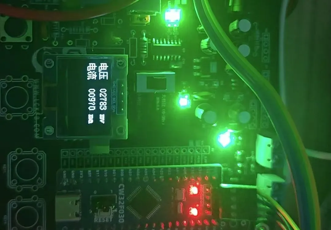

1. Hardware Section 1.1 The power supply circuit
adds D5, a parallel reverse diode, to prevent short circuits in the subsequent stages from damaging the SE8550K2.
1.2 Serial Communication
An onboard CH340 chip is added for serial communication.
1.3 INA226 Test Circuit

3. Difficulties encountered and solutions during debugging:
1. Poor soldering skills + inadequate soldering tools resulted in the soldering of some important and usable components.
2. The LDO overheated upon power-up, and the power indicator light did not illuminate. Initially, it was thought to be a short circuit, and even a resoldering of the LDO was performed before it was discovered that the parallel reverse diode of the LDO was soldered backwards.
3. During ADC sampling, the sampled value is full value, and adjusting the potentiometer has no effect. A multimeter shows the voltage at the ADC sampling point is consistently 4.1V, but the voltage input from the potentiometer is lower than 4.1V. Inspection revealed that the voltage is clamped.
