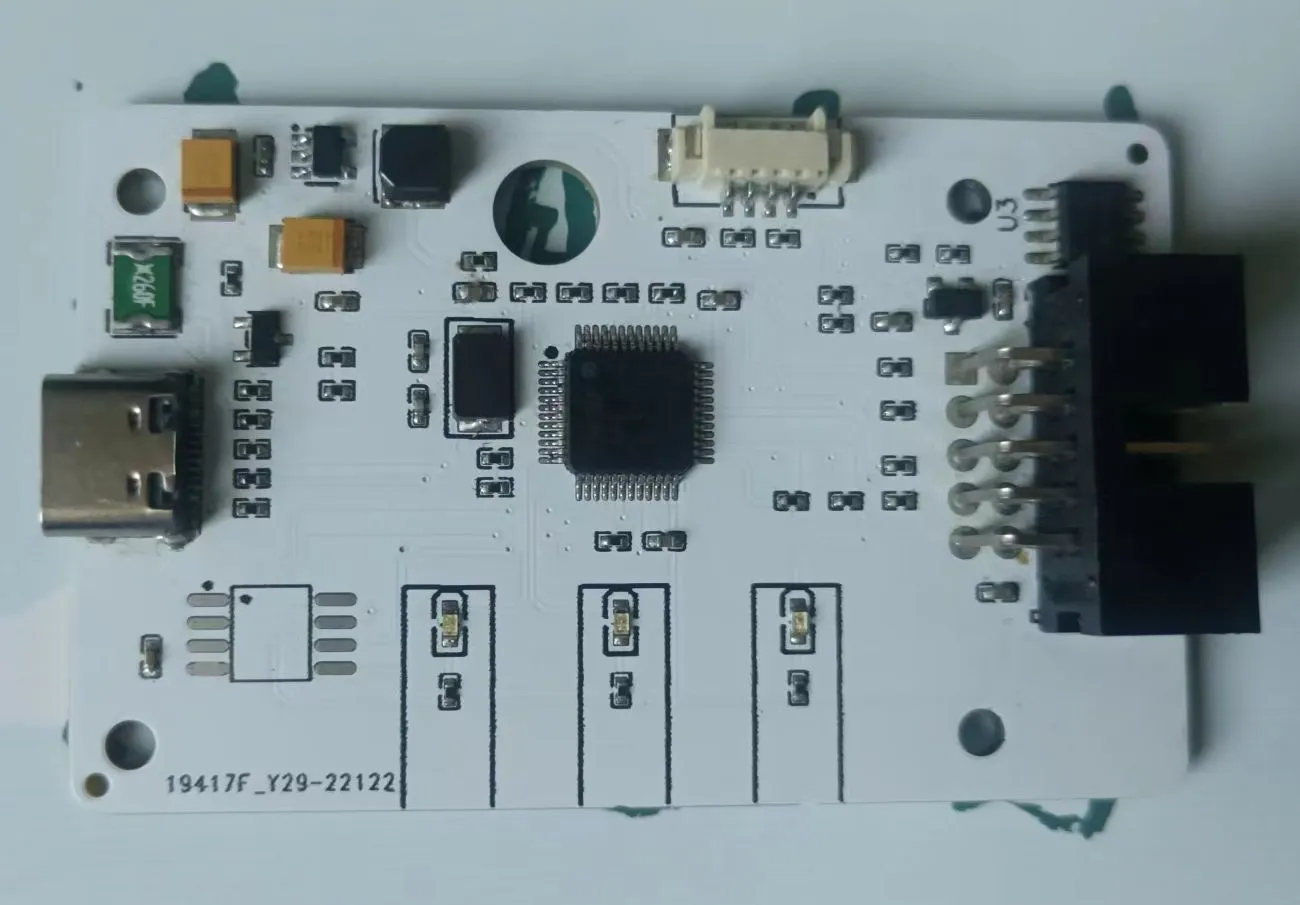

This is a universal ST-LINK adapter. The circuit board is designed using a universal housing design and the circuit interface uses TYPE-C. The circuit is simple and easy to replicate. (W25Q128 and M24C64) are for extended functionality. The following firmware does not need to be mounted.

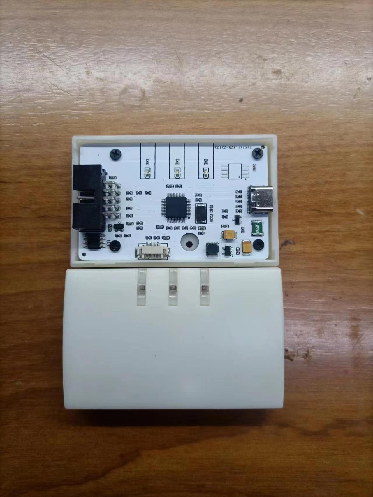

Below are pictures of the casing and the installed device:

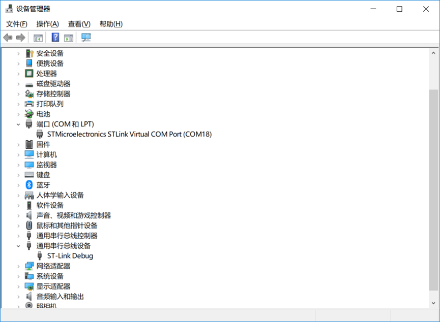

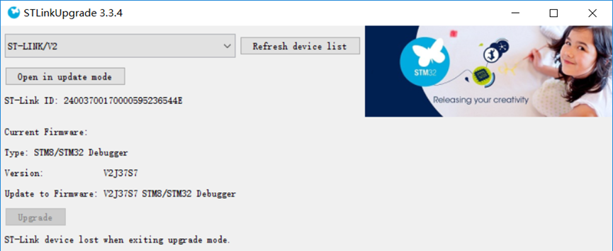

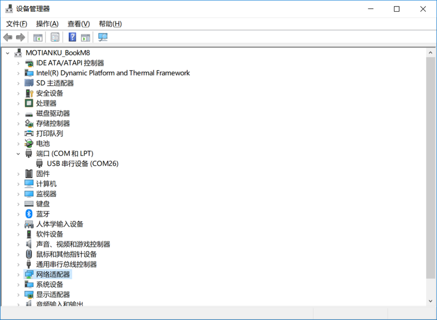

1. ST-Link v2.1 requires STM32F103CBT6; after writing the firmware, insert it into the computer hardware as shown in the picture below: ![
image.png]

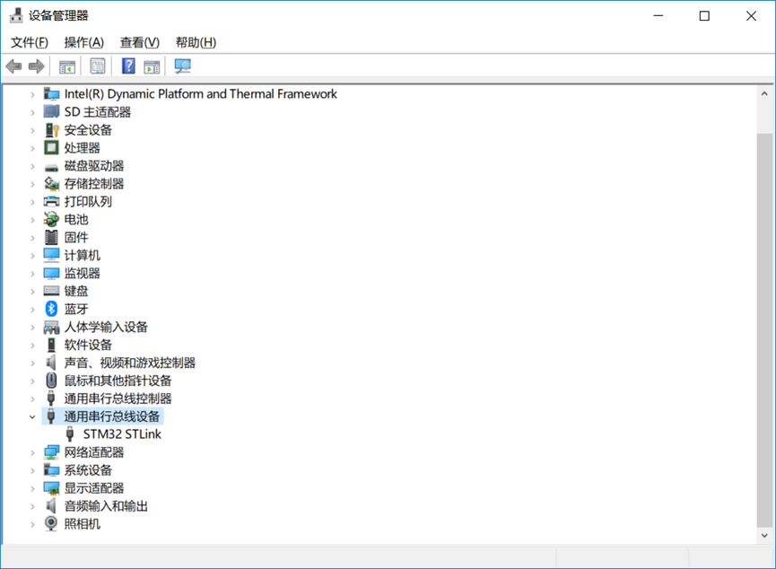

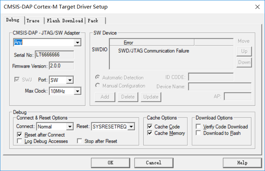

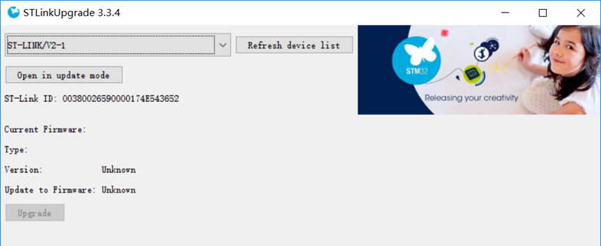

The serial port can be used independently; the image of STM32CubeProgrammer updating the firmware is shown below: ![image.png] 2. ST-Link v2 cannot use the serial port; after writing the firmware, insert it into the computer hardware as shown in the picture below: ![image.png] The image of STM32CubeProgrammer updating the firmware is shown below: ![image.png] 3. DAP-Link firmware; after writing the firmware, insert it into the computer hardware as shown in the picture below: ![image.png] Keil's recognition information is as follows: ![image.png]
