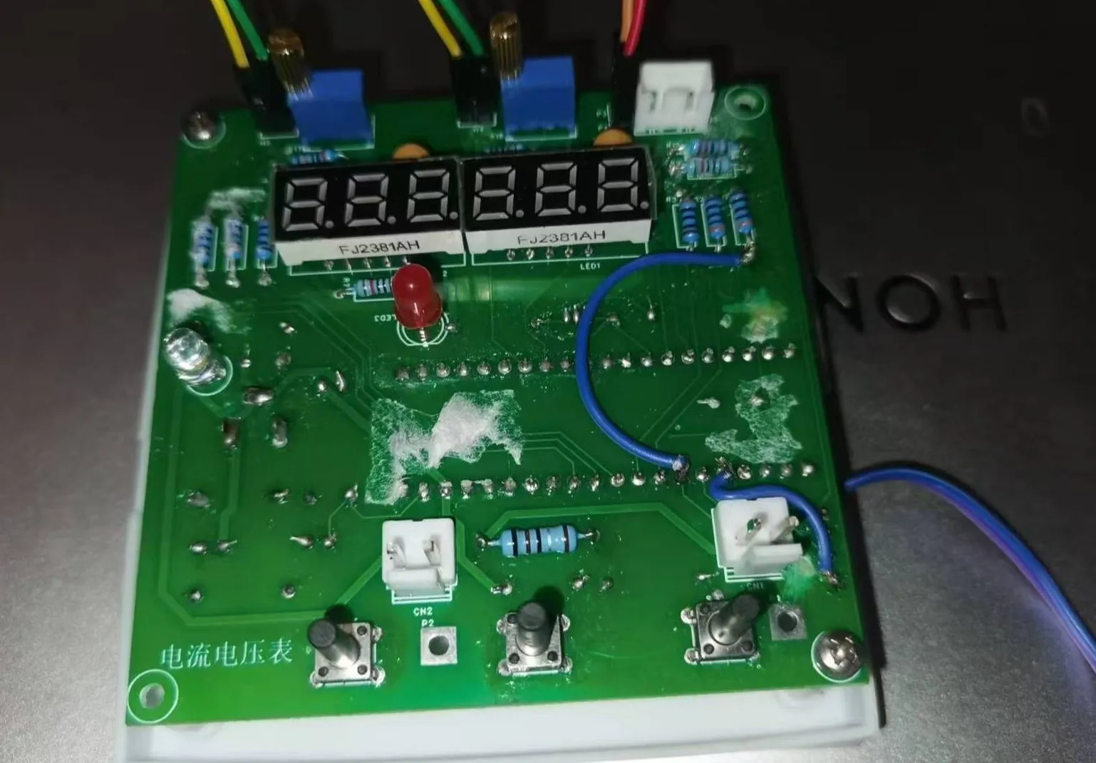

This project utilizes the LCSC CW32F030C8T6 development board and expansion boards for power supply and current/voltage simulation circuits to design and build a voltage and current meter. Mr. Li from VeriSilicon Semiconductor provided detailed instruction. The project used LCSC EDA software for schematic, PCB, and enclosure design.

Voltage sampling circuit:
This project uses a voltage divider circuit to achieve high voltage acquisition, designed to acquire voltages up to 100V, currently configured to acquire voltages of 0-30V.
This project requires a combination of hardware and software to achieve this function. When we first use the ADC_IN11 channel mentioned earlier to measure voltages up to 30V, if the measured voltage is within 0~3V, then use the ADC_IN9 channel for measurement. At this time, due to the reduced voltage division ratio, the measurement accuracy is greatly improved. When learning the corresponding circuit measurement principle, considering that users may not be able to easily build external circuits for testing and debugging, and adhering to the principle of ease of development of the development board, a circuit is specifically set up to simulate voltage measurement, measurement calibration, and measurement calibration auxiliary circuits. No external voltage is required. Use a multi-turn adjustable potentiometer (R18) to divide the development board's power supply voltage and connect it to the +V network through the development board's internal circuitry. Note that H4 needs to be shorted at this time; a jumper cap is sufficient, and a long-handled jumper cap is recommended. Do not short H4 if this function is not used.
This project uses a low-side current sampling circuit for current detection. The low side of the sampling circuit shares a common ground with the development board's meter interface
to simulate current measurement, measurement calibration, and measurement calibration auxiliary circuits.
When using this function, do not solder the R0 sampling resistor. If this function is not used, please disconnect JP2.
Current sampling essentially involves acquiring the voltage drop across the sampling resistor when current flows through it, i.e., acquiring the voltage value. This circuit uses R17 to provide a voltage value in the range of 0~0.238V (5V ÷ 210K * 10K), which is connected to the chip's current sampling pin via the I+ network.
In actual use, the voltage at I+ simulates the voltage drop across the unsoldered 100mΩ sampling resistor. At this time, the simulated measured current value Imeasured = this voltage value Vi+ ÷ 100mΩ, which is also exactly equal to the measured voltage value multiplied by 10. That is, it provides a simulated current measurement of 0~2.38A.
Set a multimeter or high-precision benchtop digital multimeter to the voltage measurement port, with a range within 3V. Insert the black negative probe into the T_GND interface next to the voltage measurement terminal, and the red positive probe into the TI+ port for current measurement to measure the actual voltage value of I+. Therefore, this circuit can not only complete the above design tasks, but also allow for a direct test to demonstrate the accuracy of the MCU's ADC peripheral. Users can write their own programs to verify this.
This project uses digital tubes as the display unit.
Two 0.28-inch three-digit common-cathode digital tubes are used as display devices. Compared to displays, digital tubes have better visibility in complex environments. The brightness of the digital tubes can be increased by using smaller current-limiting resistors depending on the actual usage environment. Furthermore, digital tubes have better mechanical properties and are not as easily damaged by external forces as displays. They are widely used in industrial applications requiring stability and reliability. From a development board learning perspective, this makes it easier to learn electronic measurement principles and related development in a targeted manner.
In this project, after actual testing, the current-limiting resistors (R1~R6) of the digital tubes were configured to 300Ω. The corresponding brightness, whether for red or blue digital tubes, showed good visibility and was soft and not glaring.
This project adds an extra TL431 circuit to provide a 2.5V reference voltage, which can be used to provide an external voltage reference for the chip to calibrate the AD converter. From a product design perspective, due to the inherent ADC performance advantages of the CW32, this circuit is not necessary. This circuit was designed on the development board to learn the relevant application principles.
