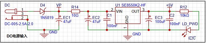

DC Power Input:
A DC-0052 interface is used as the power supply interface; 5-12V DC power supply is recommended.
This project uses an LDO (Low Dropout Linear Regulator) as the power supply. Considering that most voltmeter products are used in industrial scenarios with 24V or 36V power supplies, the SE8550K2 with a maximum input voltage of 40V was chosen. The main reason for not using a DC-DC step-down circuit to handle the large voltage drop is to avoid introducing ripple interference from the DC-DC converter during the design process; a secondary reason is to reduce project costs.

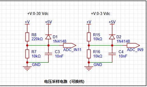

The voltage divider resistors in this project are 220K+10K, resulting in a voltage division ratio of 22:1 (ADC_IN11). Range
switching
: An additional voltage sampling circuit was added to this project. Multimeters often have multiple range settings for more accurate measurements. By adjusting different ranges, the optimal measurement accuracy of the measured point within the corresponding range can be obtained.
This project requires a combination of hardware and software to achieve this function. When we first use the ADC_IN11 channel mentioned earlier to measure voltages below 30V, if the measured voltage is within 0~3V, then use the ADC_IN9 channel for measurement. At this time, due to the reduced voltage division ratio, the measurement accuracy is greatly improved. Current

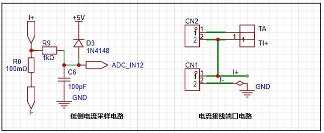

This project uses a low-side current sampling circuit for current detection. The low-side of the sampling circuit shares a common ground with the development board's meter interface.

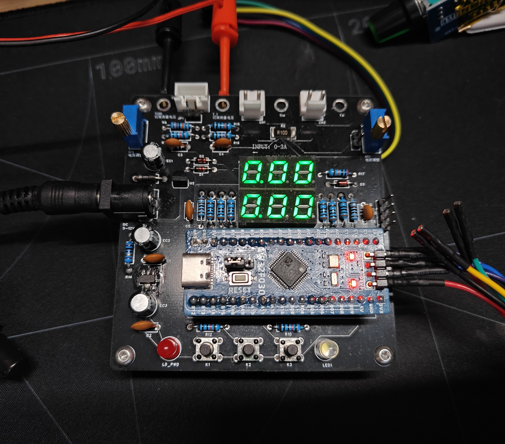

Do not solder R0 before the project is completed!!!
The sampling current designed for this project is 3A, and the selected sampling resistor (R0) is 100mΩ.
The selection of the sampling resistor mainly needs to consider the following aspects:
the maximum value of the pre-designed measurement current;
the voltage difference caused by the 3A current sensing resistor in this project; generally, it is not recommended to exceed 0.5V;
the power consumption of the current sensing resistor; a suitable package should be selected based on this parameter. Considering the power consumption (temperature) problem under high current, a 1W packaged metal wire-wound resistor was selected in this project;
the voltage amplification factor of the current sensing resistor: No operational amplifier is used to build the amplification circuit in this project, so the factor is 1.
Then, the current sensing resistor value can be calculated using the above parameters.
Since this project does not use an amplifier circuit, a larger sampling resistor is needed to obtain a higher measured voltage for measurement.
Considering that a larger resistor will result in a larger voltage drop and higher power consumption, a larger resistor cannot be chosen indiscriminately.
This project uses a 1W package resistor, corresponding to a power consumption of 1W.
Based on the above data, a 100mΩ current sensing resistor was selected. According to the formula, *3A100mΩ=300mV, 900mW. **
To cope with different usage environments, especially high current scenarios, the R0 resistor can be replaced with constantan wire or a shunt. The replacement can be chosen according to the actual usage scenario. For safety and educational purposes, this project will not discuss measurements exceeding 3A, but the principle is the same.

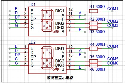

This project uses two 0.28-inch three-digit common cathode digital tubes as display devices. Compared with a display screen, digital tubes have better recognition in complex environments. Depending on the actual usage environment, a smaller current-limiting resistor can be used to achieve higher brightness of the digital tubes. On the other hand, digital tubes have better mechanical properties and are not as easily damaged by external forces as display screens. In industrial and other applications requiring stability and reliability, this technology is widely used. From a development perspective, it facilitates more targeted learning of electronic measurement principles and related development.
In this project, after actual testing, the current-limiting resistors (R1~R6) for the digital tube were configured to 300Ω, and the green digital tube I used also showed good readability.
Strictly speaking, the current-limiting resistors should be added to the segments; adding them to the digits would affect the display effect. In our actual design, we added them to the digits to save a few resistors, but the impact on the display was not significant. Therefore, we added them to the digits for convenience.

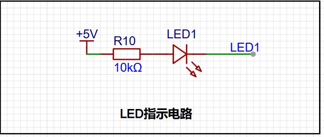

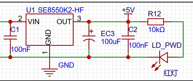

LD_PWD is the power operation indicator (very dim).
Since chip I/O often has a greater current sinking capability than a current pulling capability, LED1 is designed to be active low (bright).
To reduce the current consumption of the LED, some LED brightness was sacrificed, and the number of device parameters was reduced. The LED current-limiting resistor was chosen to be 10K.

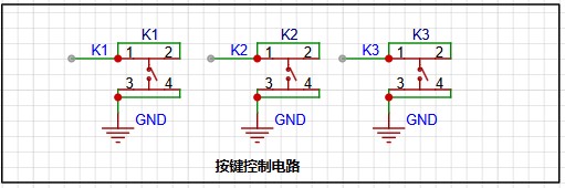

There are various design methods for the button control circuit. Thanks to the CW32's internal I/O ports which can be configured with pull-up and pull-down resistors, the button control circuit on the outside of the chip does not need to be configured. One end of the button is connected to the MCU's I/O, and the other end is grounded. When the button is pressed, the I/O is pulled low.

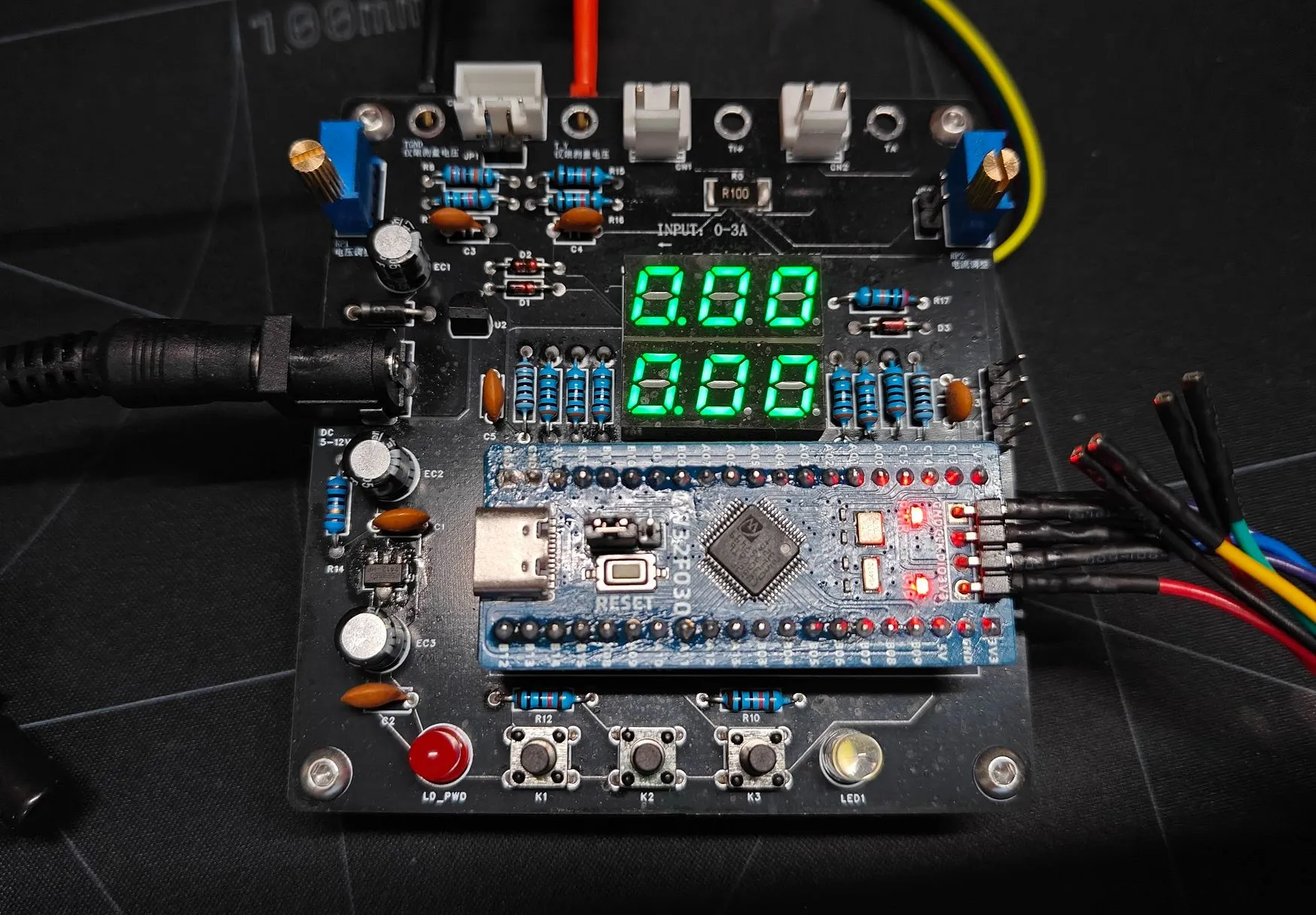

Physical Images :

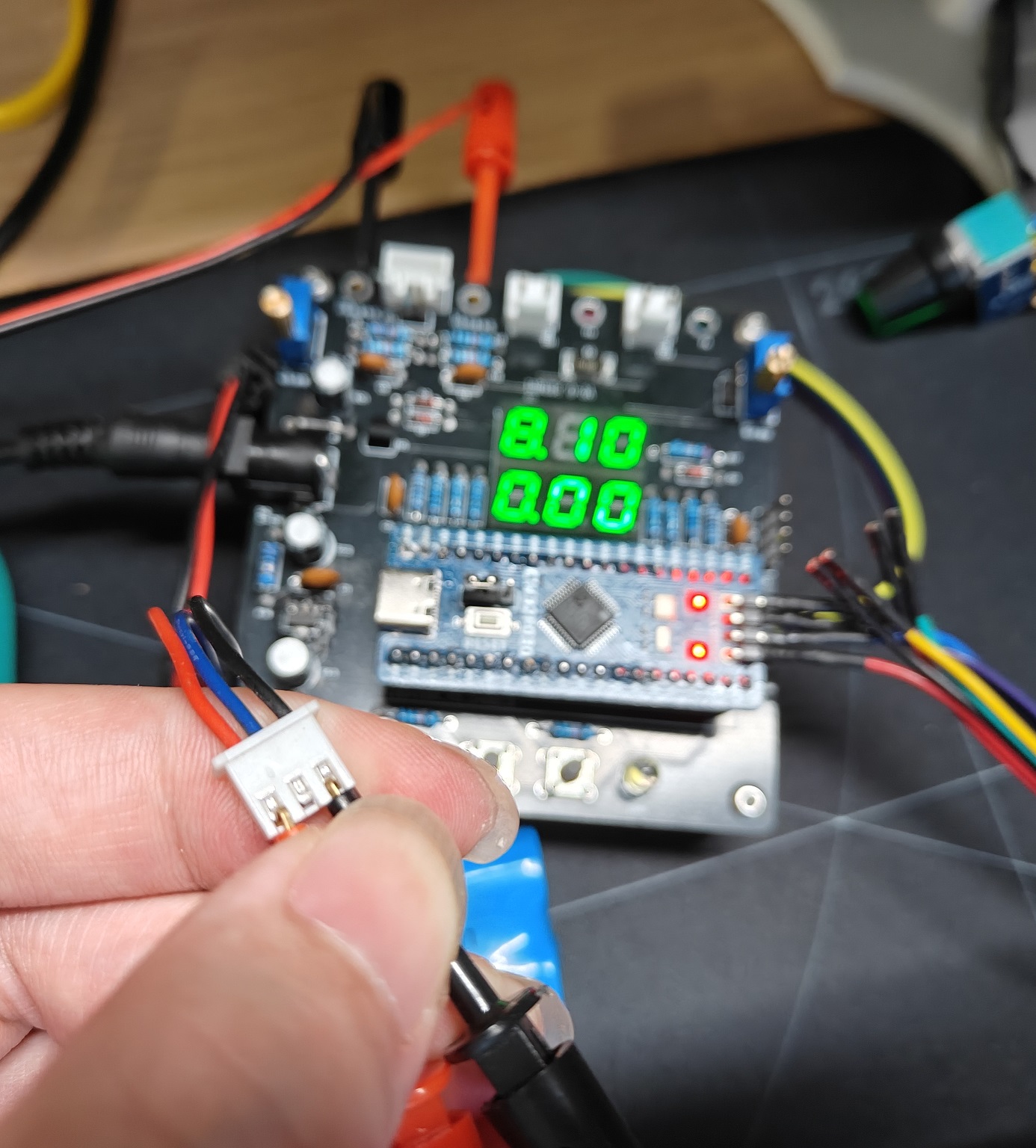

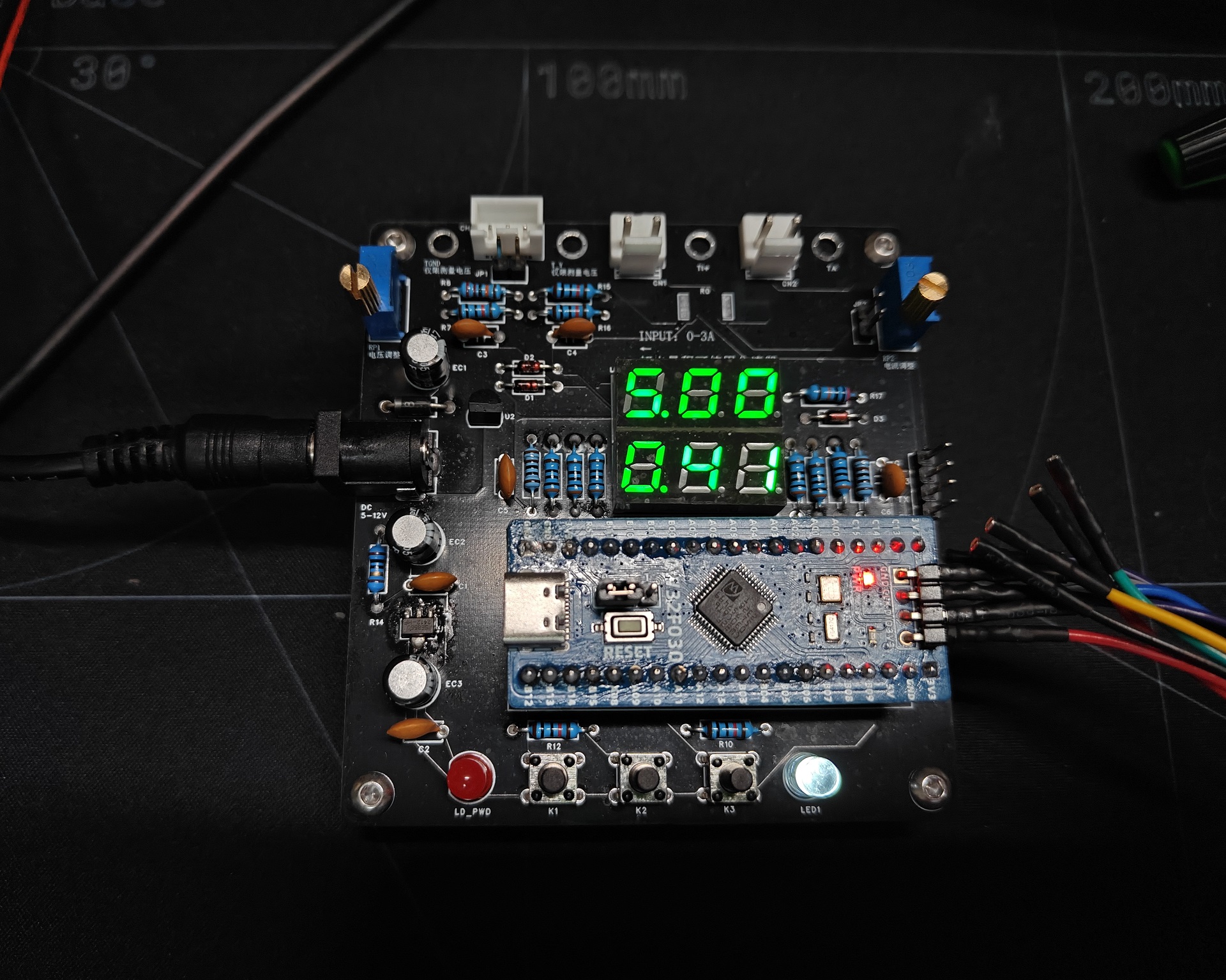

Figure 1: Physical Image;

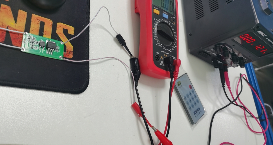

Figure 2: Debugging, without R0 resistor;

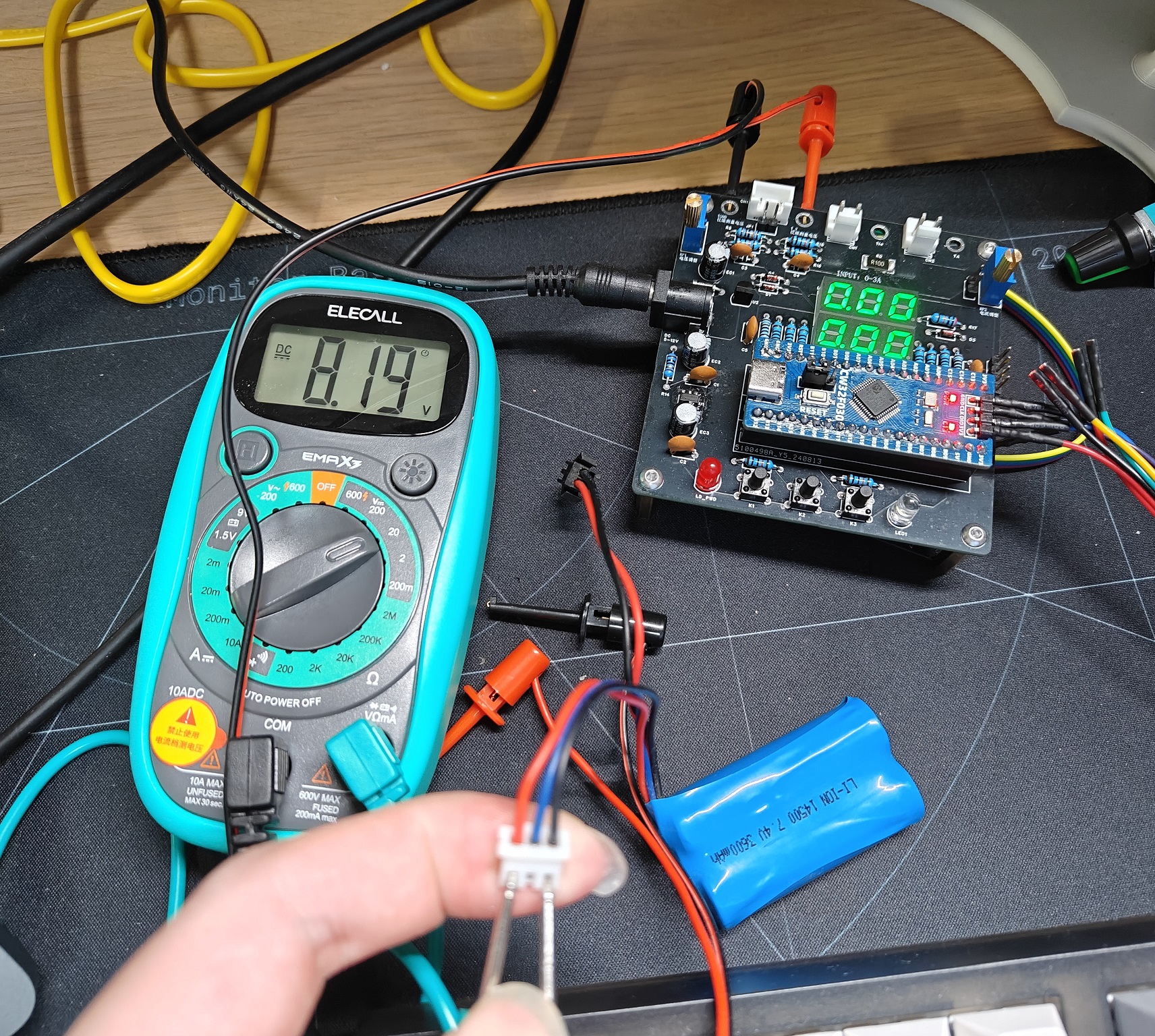

Figure 3: Verifying lithium battery voltage with a multimeter;
Figure 4: Lithium battery voltage test in this project.

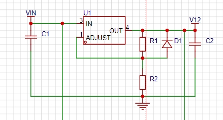

Power Supply Step-Down Circuit:
A modular design is used, with the LM317 as the main step-down chip to achieve 12.5V voltage regulation.

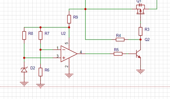

Voltage Follower Circuit:
A single-channel comparator is used. The output voltage value is detected by U2. When the input voltage is higher than 12.5V, the MOSFET is turned off; when the input voltage is lower than 12.5V, the MOSFET is turned on.
