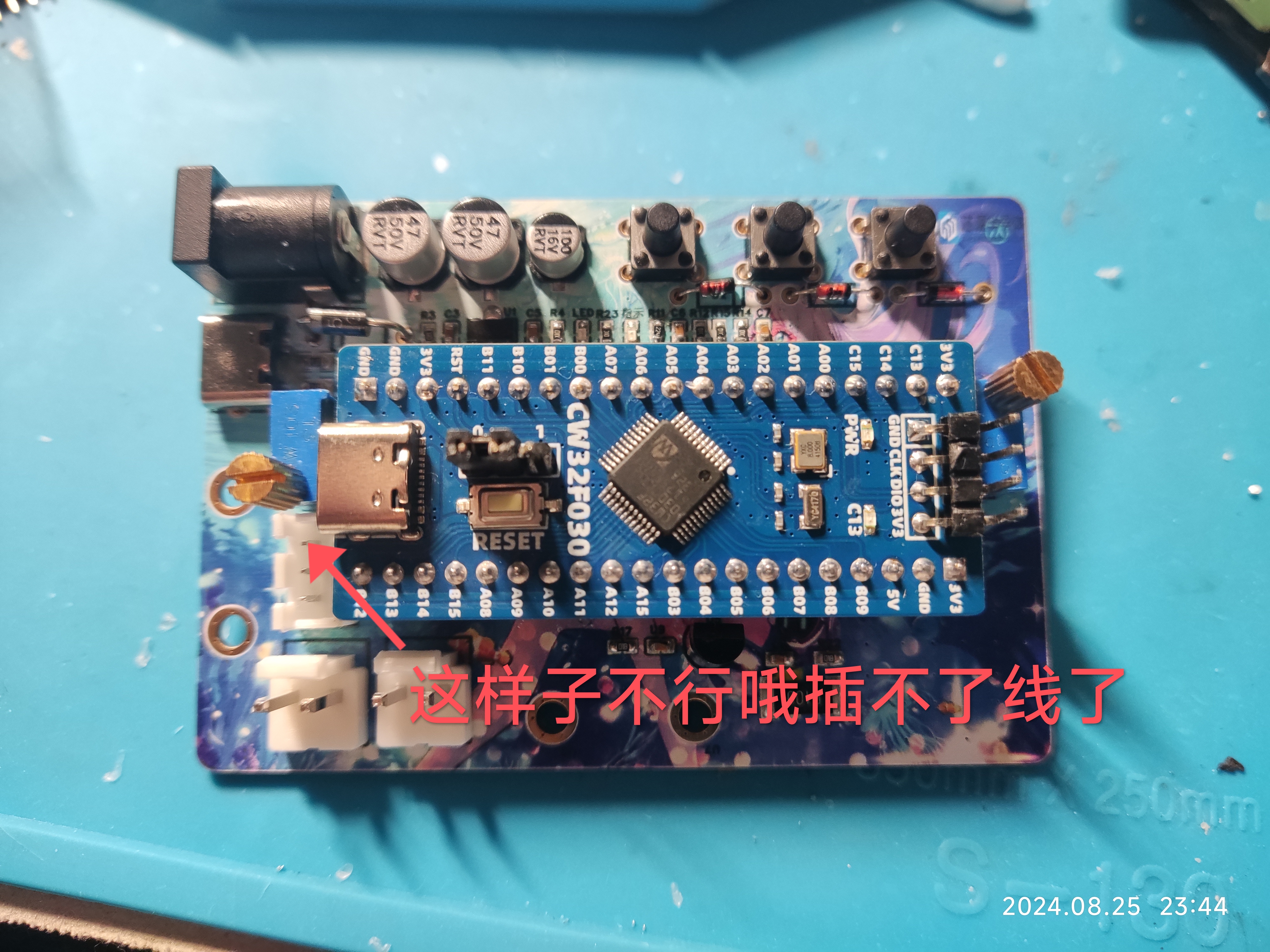

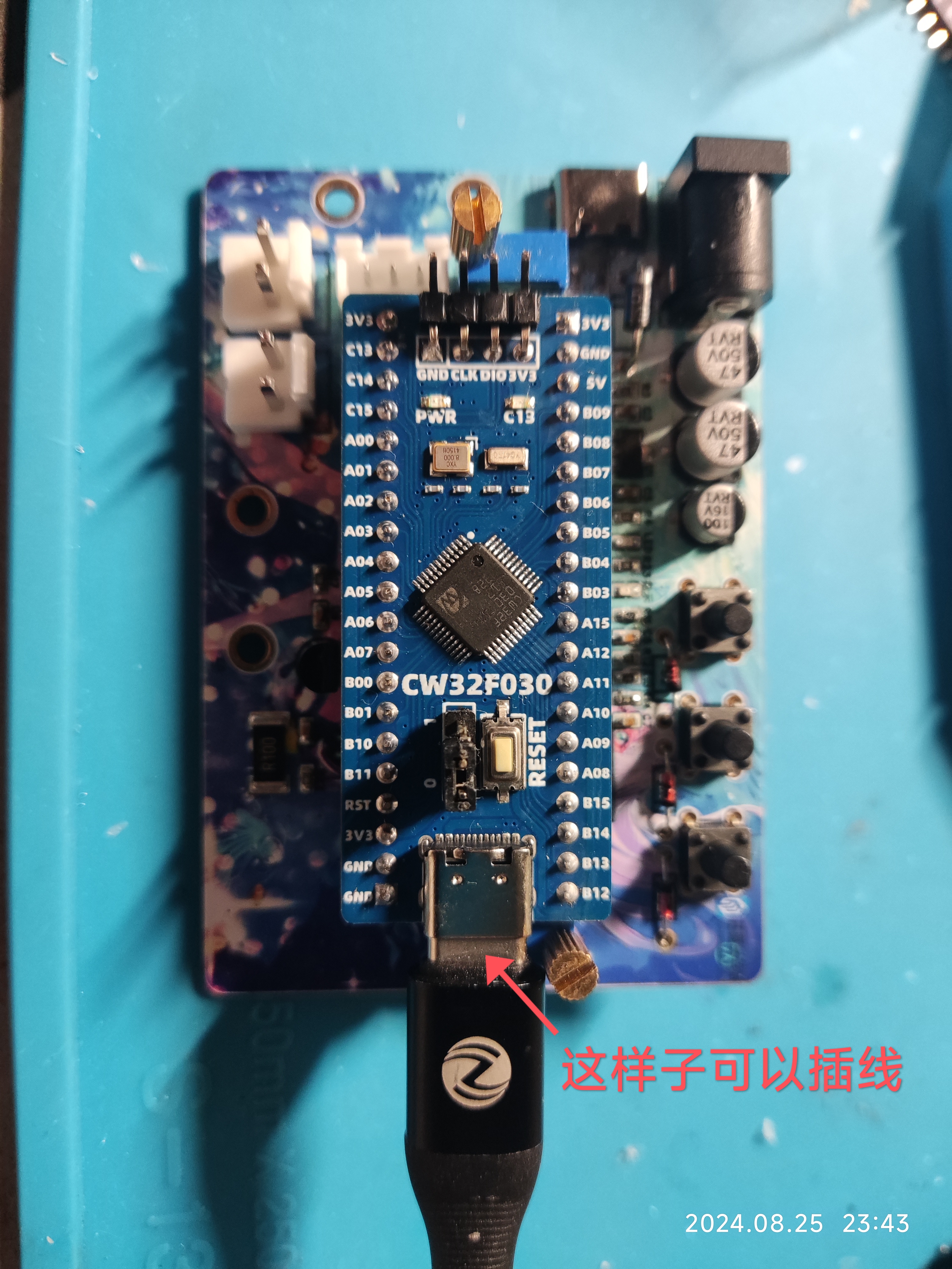

Pay attention to the soldering order and do not heat the LEDs for too long.

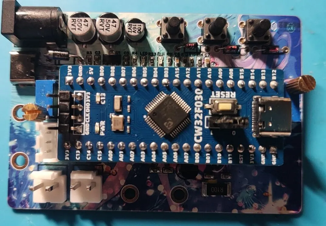

Assembly Process :
Surface mount first, then through-hole components to avoid them not being able to fit on the heating platform.
Note that after soldering the surface mount components, solder the digital tubes first, then solder the development board's headers; otherwise, you will be frustrated. (It looks difficult to solder.)
When soldering potentiometers, be sure to solder the right-side potentiometer according to the silkscreen markings; otherwise, it will block the development board's USB port.

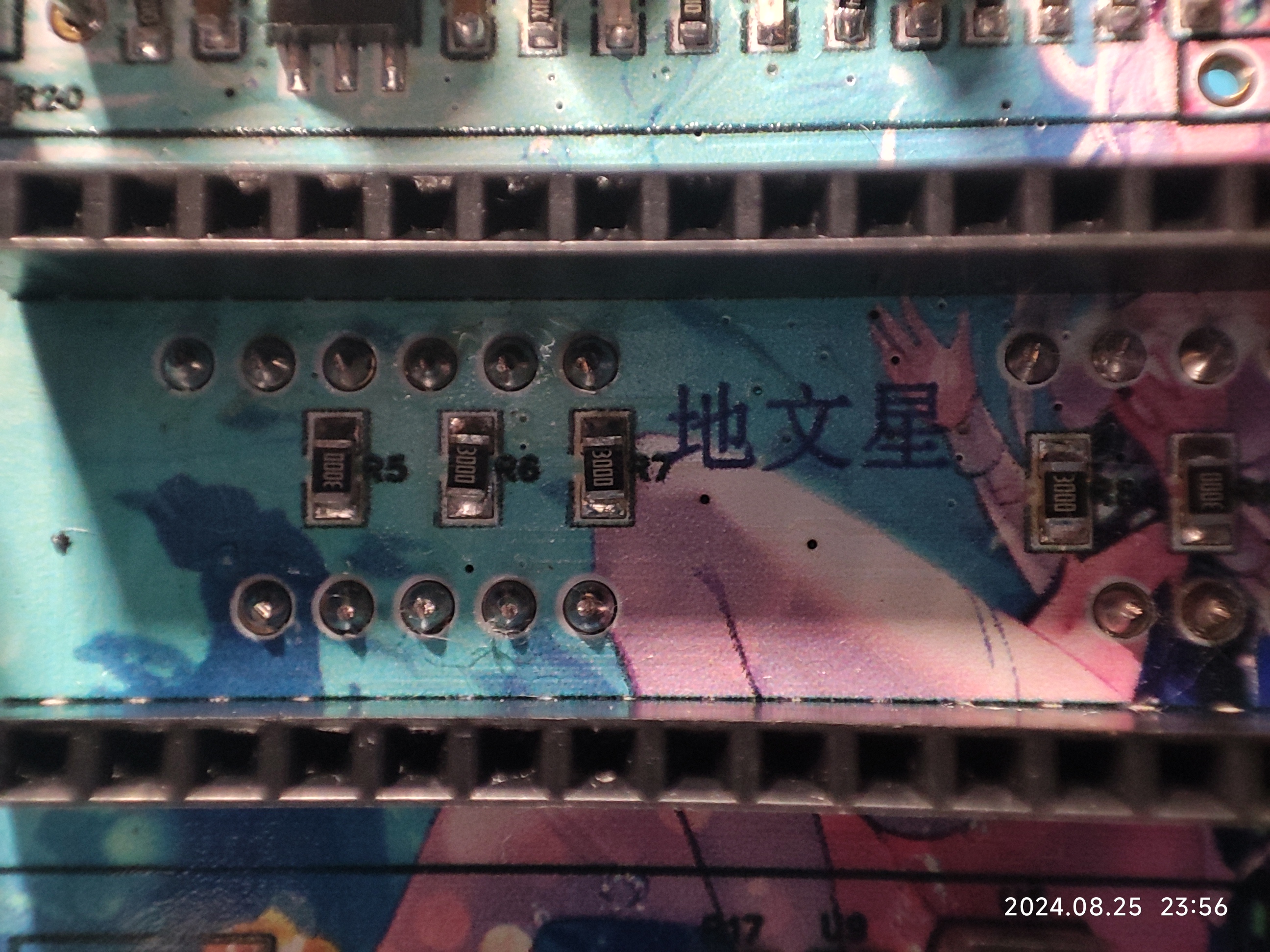

5. Digital Tube Display
This project uses a digital tube as the display unit.
This project uses two 0.28-inch three-digit common-cathode LED displays as the display device. Compared to a display screen, LED displays offer better visibility in complex environments. The brightness of the LED displays can be increased by using smaller current-limiting resistors, depending on the specific needs of the application environment. Furthermore, LED displays have better mechanical properties and are not as easily damaged by external forces as display screens. They are widely used in industrial applications where stability and reliability are crucial. From a development board learning perspective, this makes it easier to learn electronic measurement principles and related development in a targeted manner.
In this project, actual testing showed that the current-limiting resistors (R1~R6) for the LED displays were configured to 300Ω. The corresponding brightness for both red and blue LED displays was good and the brightness was soft and not glaring.
Strictly speaking, the current-limiting resistors should be added to the segments; adding them to the digits would affect the display effect. Our actual design places them in the digits to save a few resistors, but the impact on the display is not significant. Therefore, we add them to the digits for convenience.

The following issues were noted:
The TL431's pinout was reversed, preventing the use of an external reference voltage. [Fixed]
The current sampling resistor lacked copper plating, resulting in insufficient current. [Fixed] The
copper plating method was not selected as fill, but rather the default divergent method, which may burn out under high current. [Fixed]
The Type-C port from the 3D casing appears to be unused; if Type-C power is needed, it's better to directly plug it into the core board.
The panel's slot size lacked sufficient margin, requiring manual enlargement. [Fixed]
The 3D casing's DC power connector slot size lacked sufficient margin. [Fixed]
