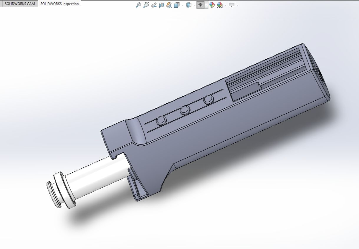

Smart dot tin pen is mainly composed of main control PCBA + lithium battery + 0.91 OLED + N20 reduction motor + 3D printed shell + The 3D printed push rod consists of
a shell and a push rod. I have the relevant 3D printing production files produced by Jiali Chuang 3D Monkey. When installing in the attachment, the motor needs to be fixed through the positioning hole on the shell with an M2 screw to prevent accidental pull-out.
The first time you use it, you need to configure the relevant parameters. The container cross-sectional area is selected by default as 10CC. The motor parameters of the dispensing syringe must be consistent with the parameters set by the software.
Because the motor drive is not very accurate, the extrusion and suction capacity are not accurate enough. The motion posture detection program also has certain problems. Mind not to use
this project. The software and hardware are relatively complex. It is suitable for people with a certain DIY foundation to reproduce
