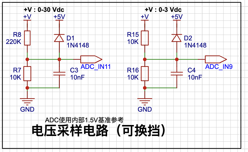

Voltage Measurement Circuit Design:
Voltage Divider Circuit: To measure voltages from 0-30V, the ADC uses an internal 1.5V reference. This project uses a voltage divider circuit to achieve high voltage acquisition. The current configuration acquires voltages from 0-30V, and the voltage divider resistors are designed to be 220K+10K, therefore the voltage divider ratio is 22:1 (ADC_IN11). Therefore, 220K (R8), which is greater than 200K and closest to the specified value, is selected.
Protection Circuit: To prevent damage to the ADC from excessively high input voltage, necessary protection circuits should be added, such as current-limiting resistors and clamping diodes. In this project, 1N4148 (D1, D2) are added as clamping diodes in the sampling circuit.
Current Measurement Circuit Design:
Sampling Resistor: By connecting a small-value sampling resistor in series in the circuit, the current is converted into a voltage signal, which is then acquired by the ADC. The sampling current designed in this project is 3A, and the selected sampling resistor (R0) is 100mΩ.
Amplifier Circuit: Depending on actual needs, an amplifier circuit may also be required to improve measurement accuracy. No operational amplifier is used in this project to build the amplifier circuit, therefore the multiplier is 1.

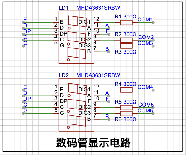

Write code to control the display module and display the processed voltage and current values ​​on the screen in real time. This project uses a common anode digital tube, so the official sample code digital tube display processing file Seg_Dis.c needs to be modified.
// According to the official code, modify the initial display array of the common anode digital tube, and invert other level settings
uint8_t Seg_Table[21] = {0xc0, 0xf9, 0xa4, 0xb0, 0x99, 0x92, 0x82, 0xf8, 0x80, 0x90, 0x40, 0x79, 0x24, 0x30, 0x19, 0x12, 0x02, 0x78, 0x00, 0x10, 0x08};

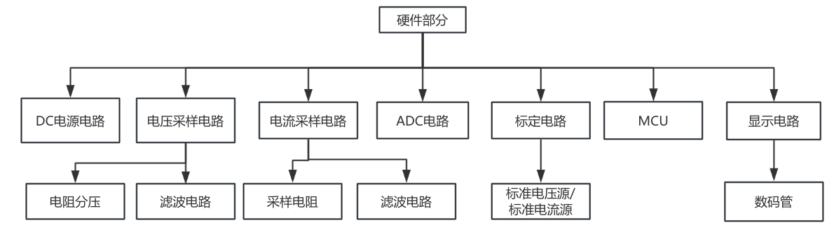

V. Overall Design Block Diagram
Hardware Part
Software Part

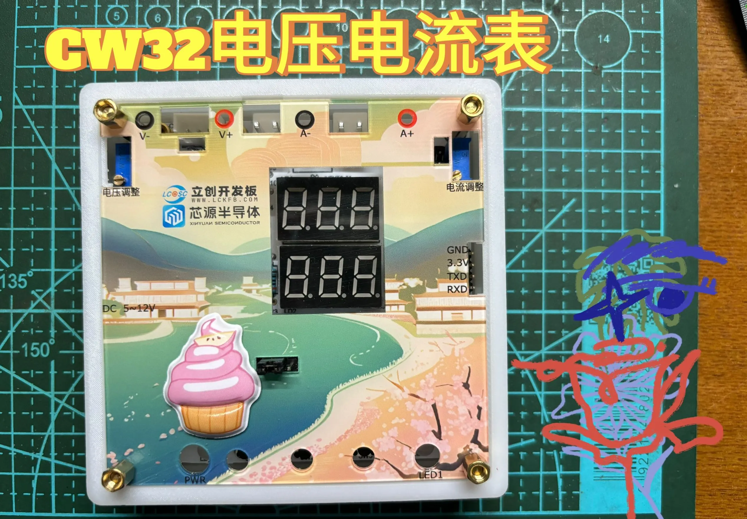

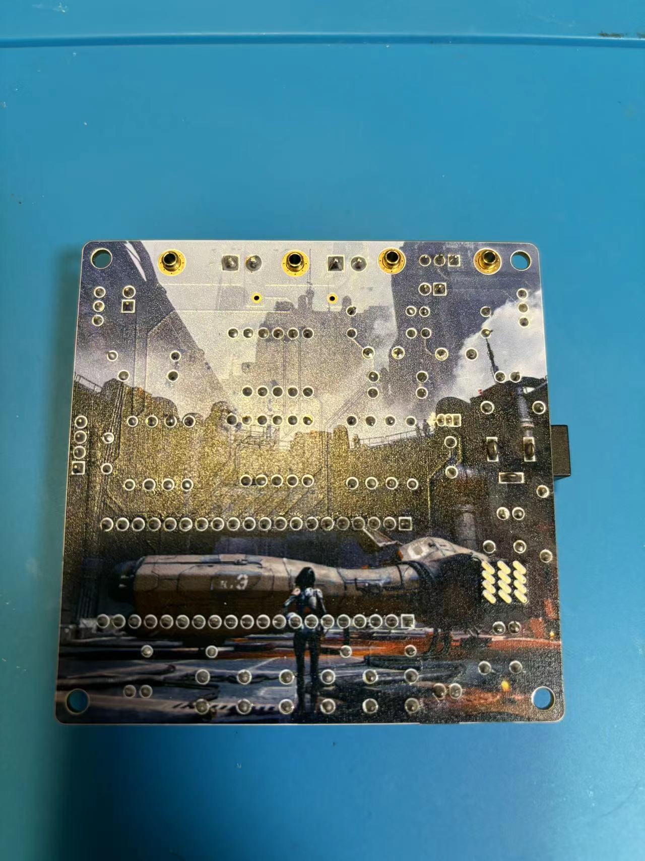

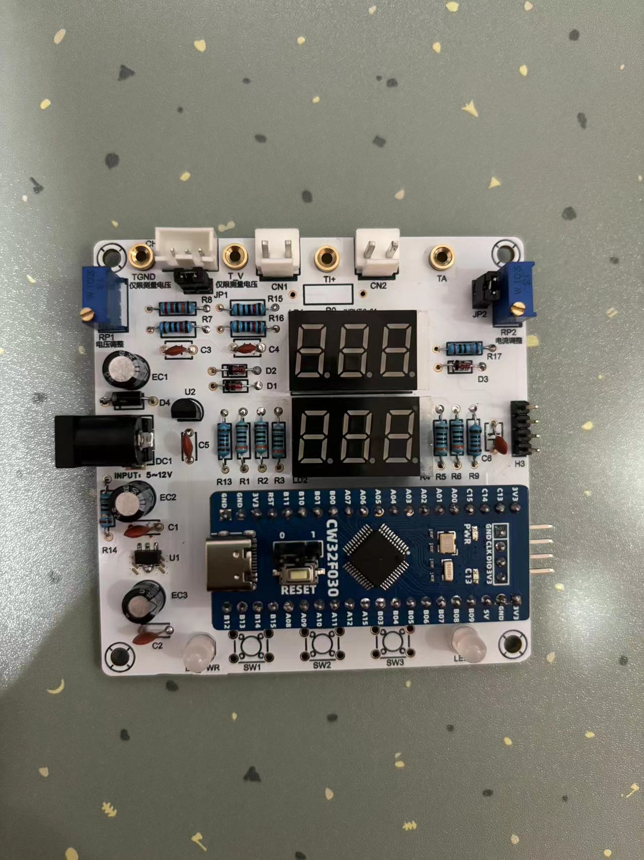

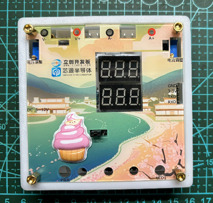

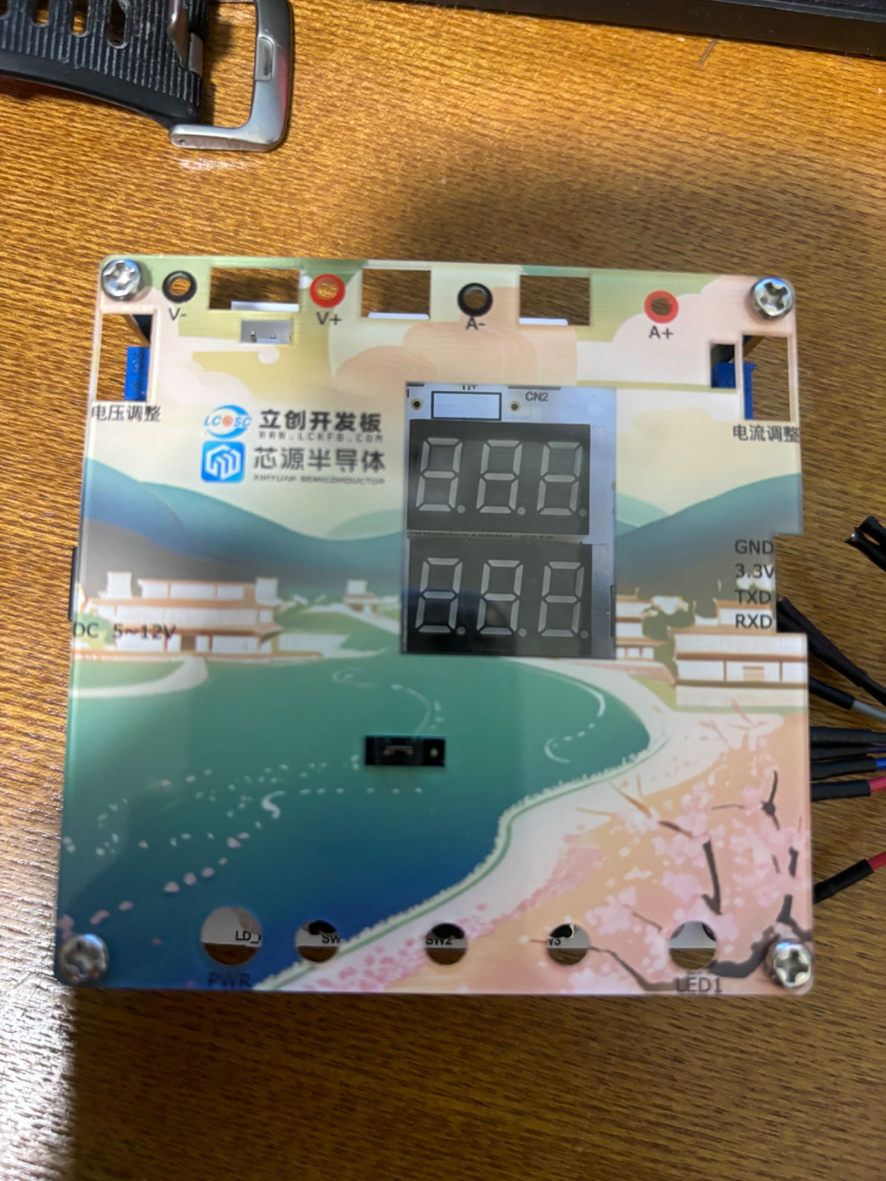

VI. Physical Display
After soldering ,
the color silk screen verification
panel verifies
the 3D shell
(after installing the panel, it was found that the type-c of the development board protruded. The hole was manually opened and a sticker was applied).

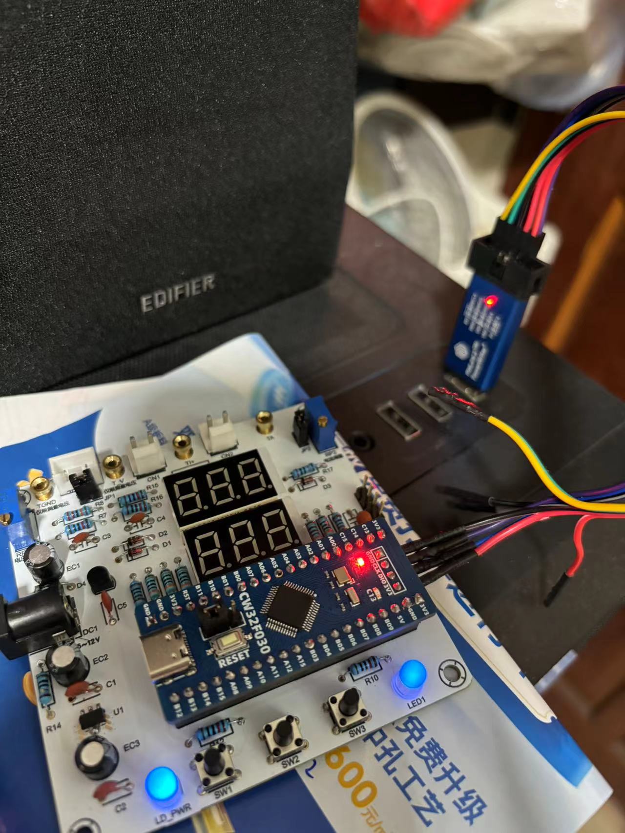

VII. Experimental Process and Verification Diagram
Experiment 1: Lighting up the LED
Experiment 2: Button Detection
Lighting up/turning off the LED by pressing the button

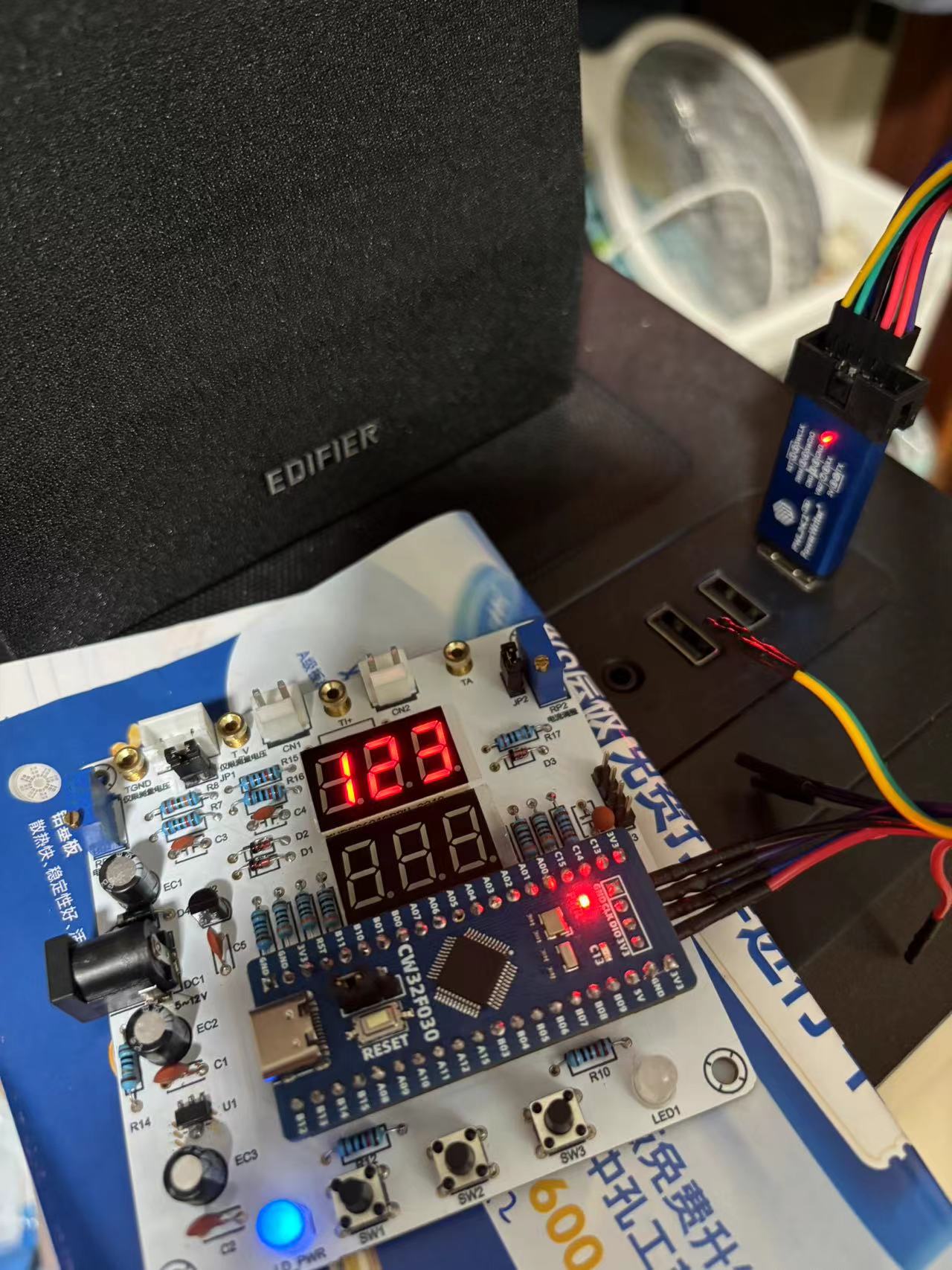

Experiment 3: Digital tube displaying numbers / Experiment 4: Digital tube dynamic display
Experiment 5: ADC sampling display / Experiment 6: Mean filtering
The voltage sampled by the ADC is used to simulate voltage measurement by shorting JP2 and adjusting the 10K multi-turn adjustable resistor.
After mean filtering, the value displayed on the digital tube is more stable with less fluctuation.

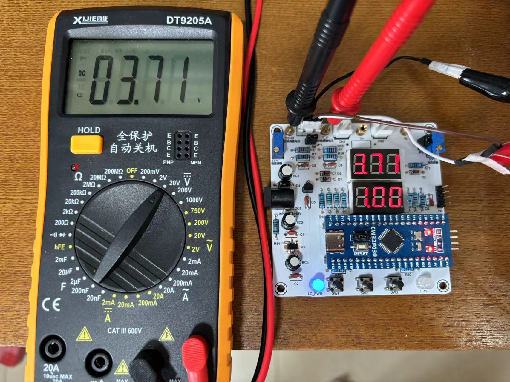

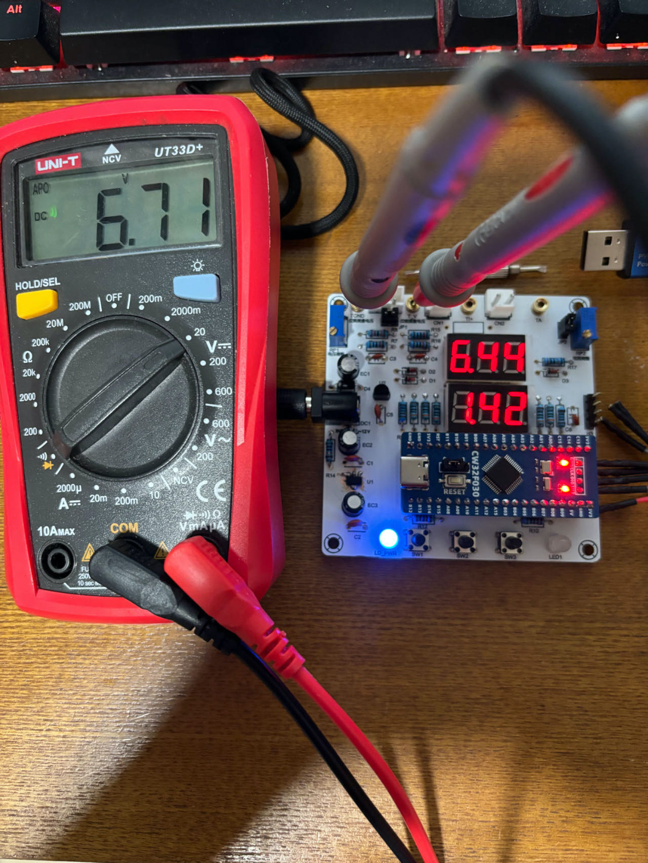

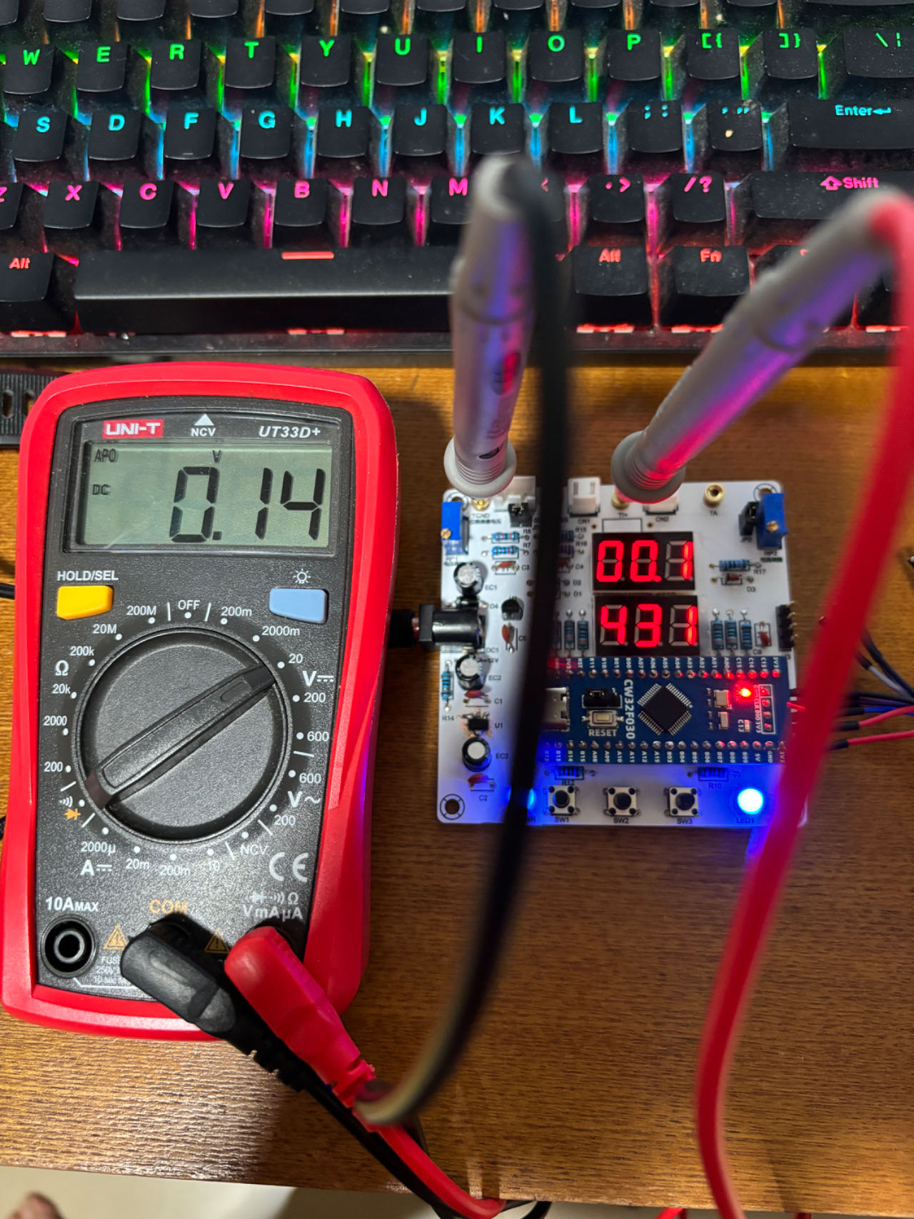

Experiment 8: Simultaneous voltage and current acquisition and display .
Shorting JP2 displays the simulated test voltage and current simultaneously on two digital tubes (it can be seen that the voltage value has a deviation at this time, as it has not yet been calibrated).

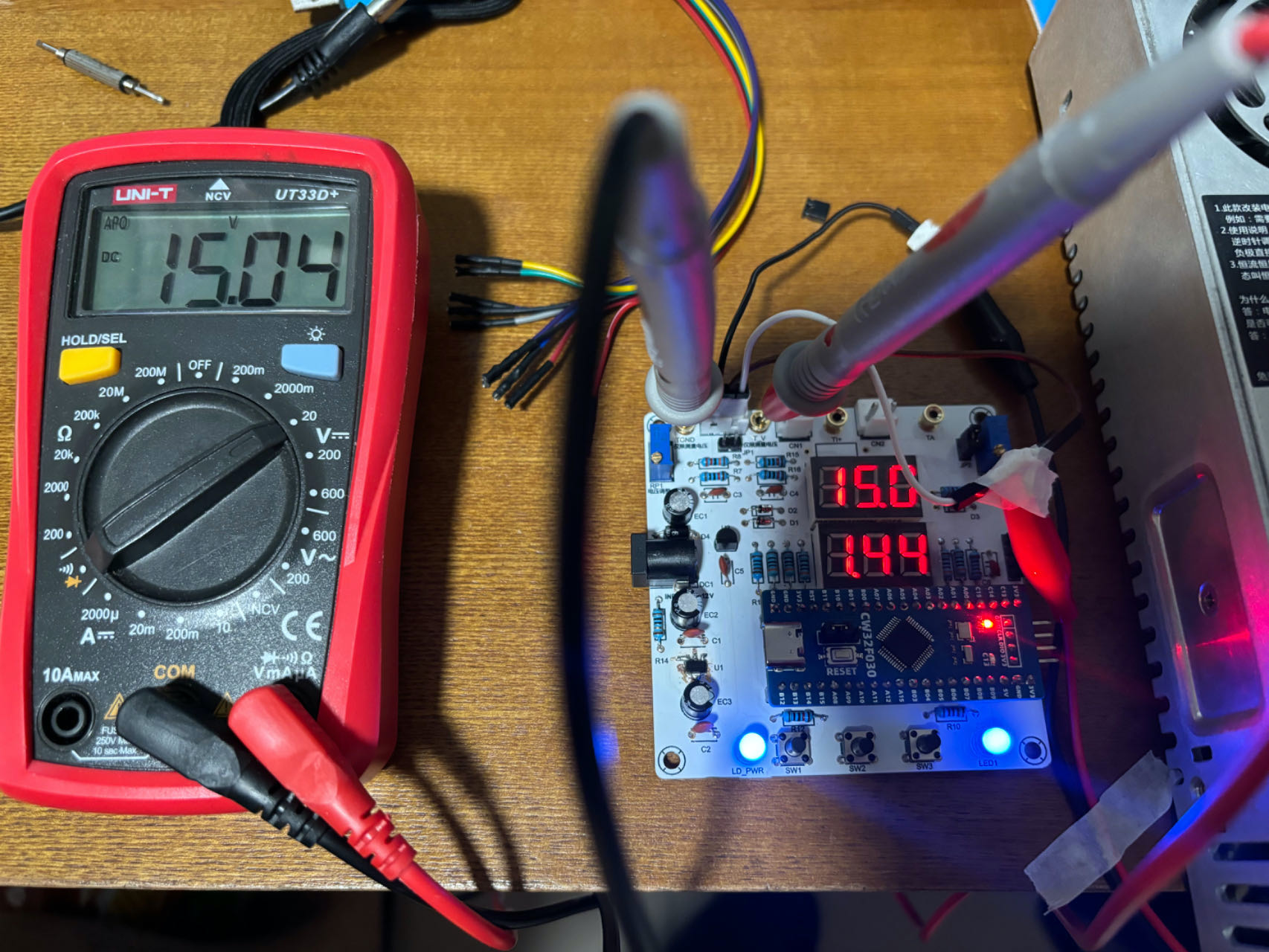

Experiment 9: Digital voltage and current meter with calibration function.
After calibration at 0V (default 0), 5V, and 15V, the deviation is within 0.01-0.02V, which is more accurate than the result of Experiment 8.

Before powering on, be sure to test for cold solder joints, solder bridges, etc. You can use the buzzer function to test each pin one by one.
