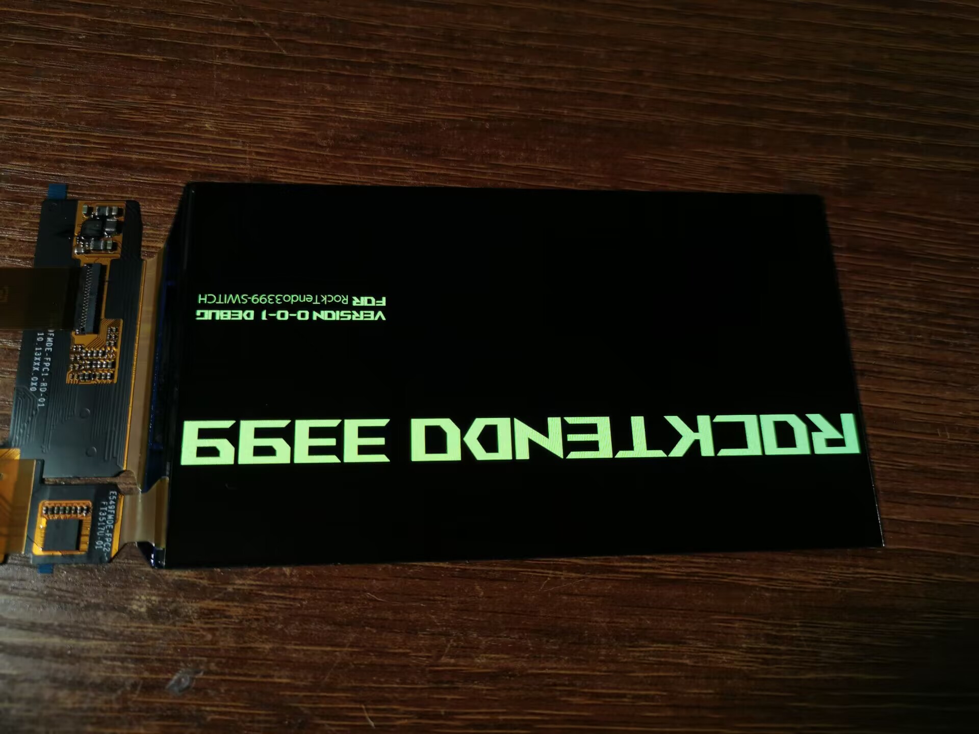

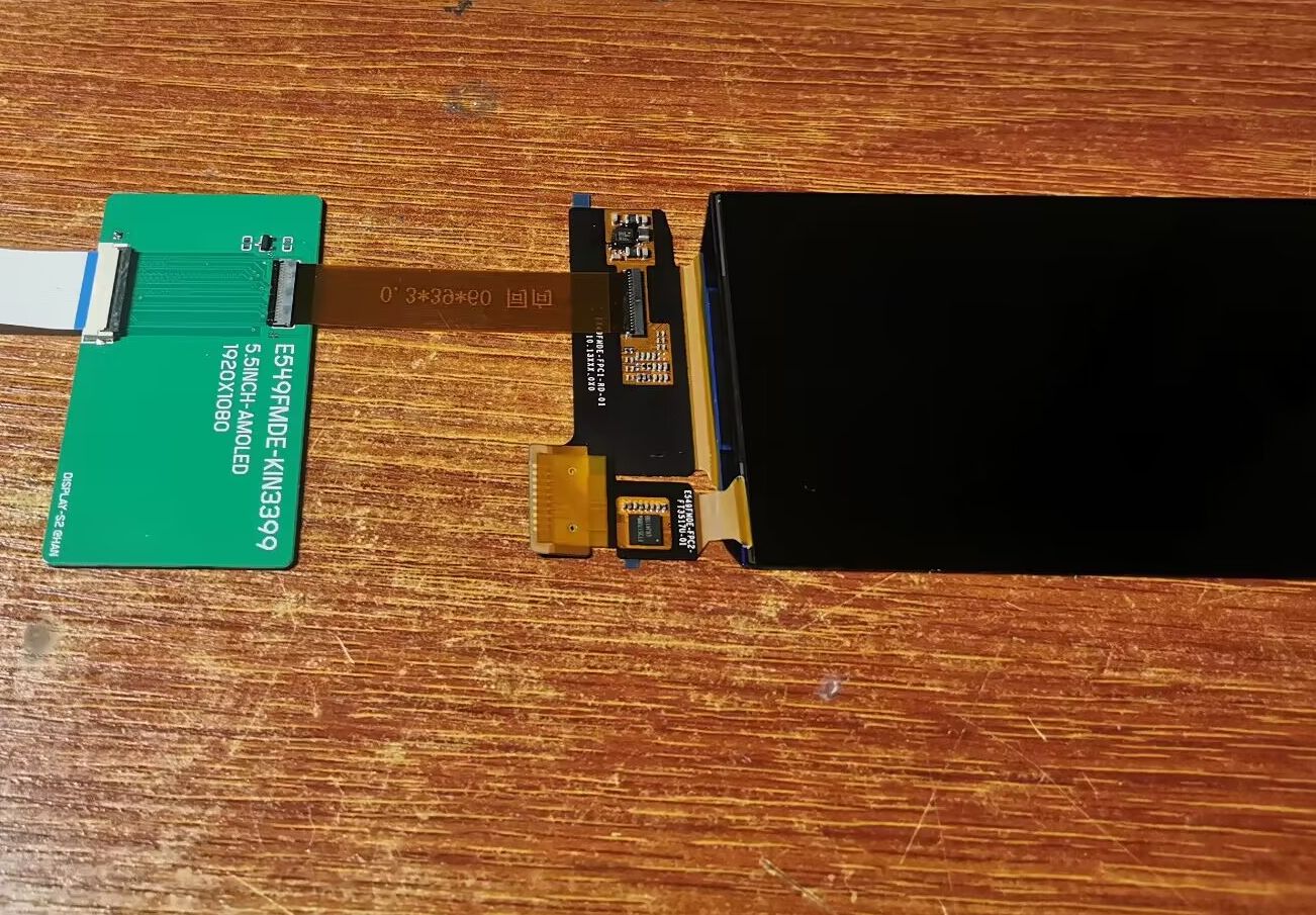

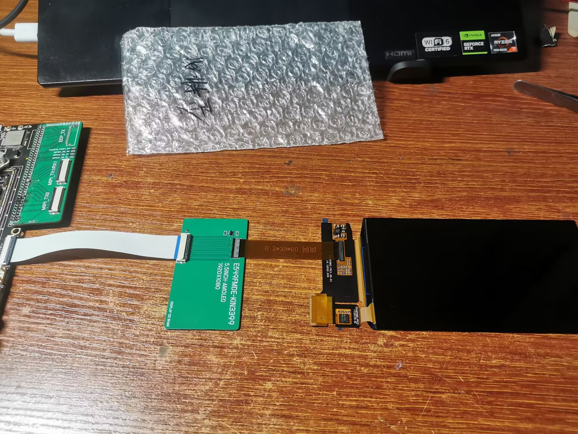

E549FDME-AMOLED driver board
This device is suitable for E549FMDE AMOLED
5.5INCH 1920X1080 ONCELL touchscreen
(QQ 542291275
), using a 0.5mm 30-pin FPC to output MIPI signals, TP power, etc. It can be directly connected to the KING3399 development board or adapted for use with Taishanpai.

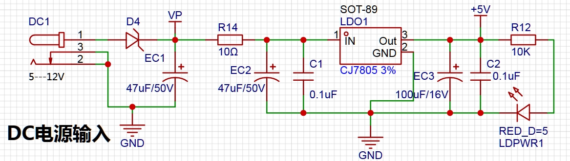

1. Power Supply Circuit
LDO (Low Dropout Linear Regulator) Selection:
This project uses an LDO as the power supply to avoid interference caused by DC-DC ripple. The board's power supply uses the common 7805 as the microcontroller's power supply.

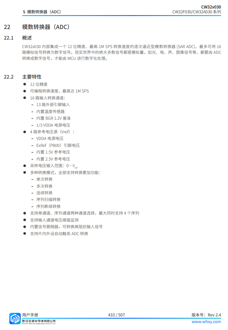

As a DIYer, I naturally leave some margin for error when using the development chip. For ease of assembly, the core board (core board) of LCSC Diwenxing CW32F030C8Tx was chosen as the main controller. The reason for choosing CW32 is that it has a 12-bit high-speed ADC that can reach ±1.0LSB INL 11.3ENOB and multiple Vref reference voltages... (STM32 only supports VDD=Vref, CW32 is excellent in this respect!)

The ADC reference voltage in this project is 1.5V, which can be configured through the program.

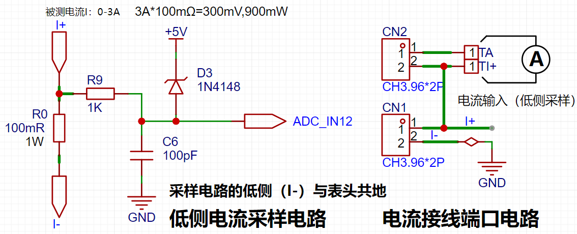

4. Current Sampling Circuit
: This project uses a low-side current sampling circuit for current detection. When learning the common ground between the low-side of the sampling circuit and the development board's meter interface
, please do not solder R0! Do not solder R0! Do not solder R0!!! Connect the jumper, wait for the program to display normally, adjust the adjustable resistor on the right. If the current value changes, then you can solder R0.
The design analysis
for this project involves a sampling current of 3A, and the selected sampling resistor (R0) is 100mΩ.
The selection of the sampling resistor mainly needs to consider the following aspects:
the maximum value of the pre-designed measurement current;
the voltage difference caused by the 3A current sensing resistor in this project; and
the power dissipation of the current sensing resistor, which should generally not exceed 0.5V. A suitable package should be selected based on this parameter. Considering the power dissipation (temperature) issue under high current, a 1W metal wire-wound resistor package was chosen
. The voltage amplification factor across the current sensing resistor is also important. Since no operational amplifier is used to build the amplification circuit in this project, the factor is 1.
The current sensing resistor value can then be calculated using the above parameters
. Since no amplifier circuit is used, a larger sampling resistor is needed to obtain a higher measured voltage for measurement.
Considering that a larger resistor would result in a larger voltage drop and higher power consumption, an unlimited selection of a larger resistor is not feasible.
This project uses a 1W package resistor, corresponding to a power consumption of 1W.
Based on the above data, a 100mΩ current sensing resistor was selected. According to the formula, 3A * 100mΩ = 300mV, 900mW can be calculated.
To cope with different usage environments, especially high current scenarios, the R0 resistor can be replaced with constantan wire or a shunt. The choice of alternative can be made according to the actual usage scenario. For safety and educational purposes, this project will not discuss ranges exceeding 3A in detail, but the principle is the same.

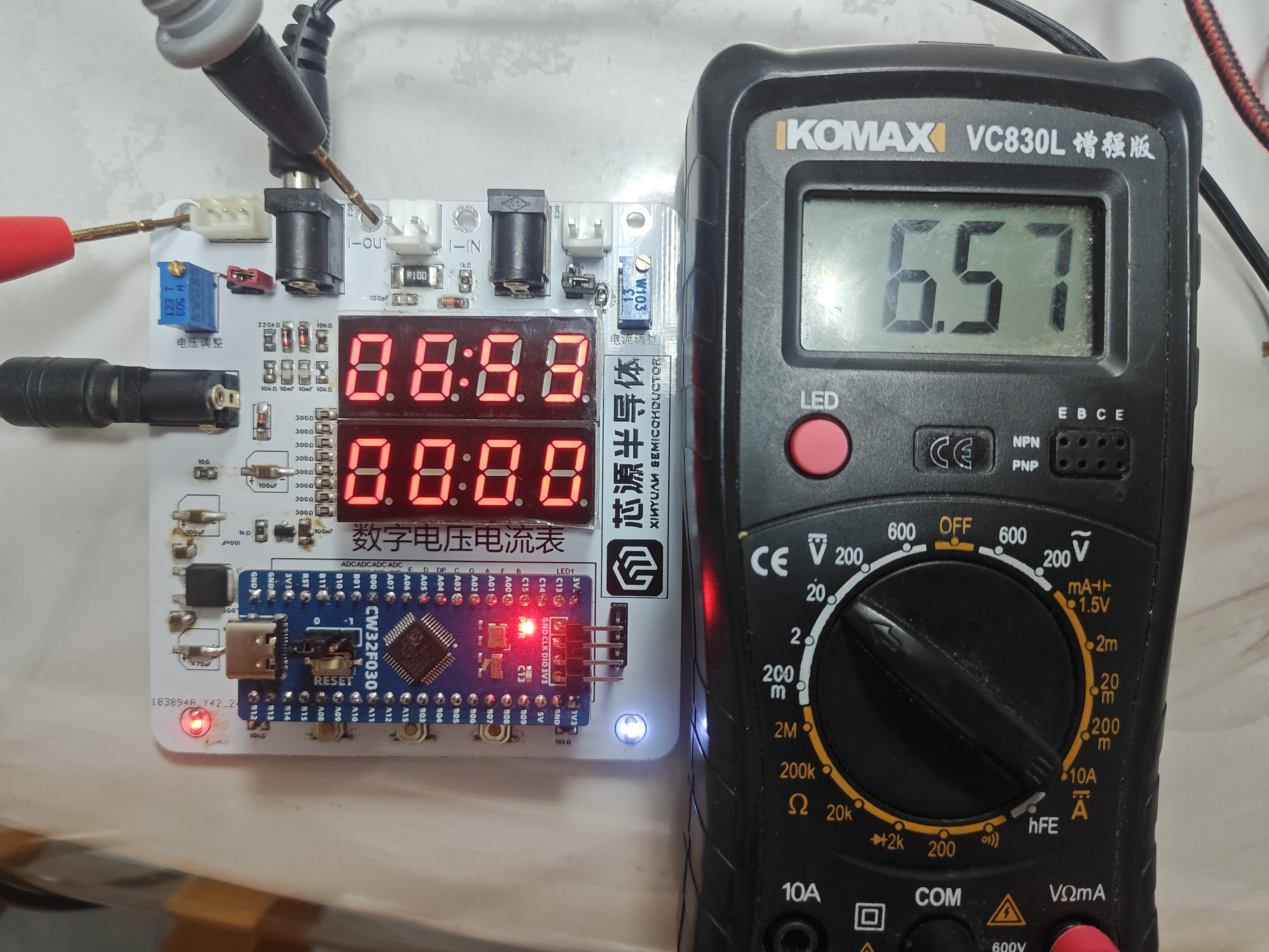

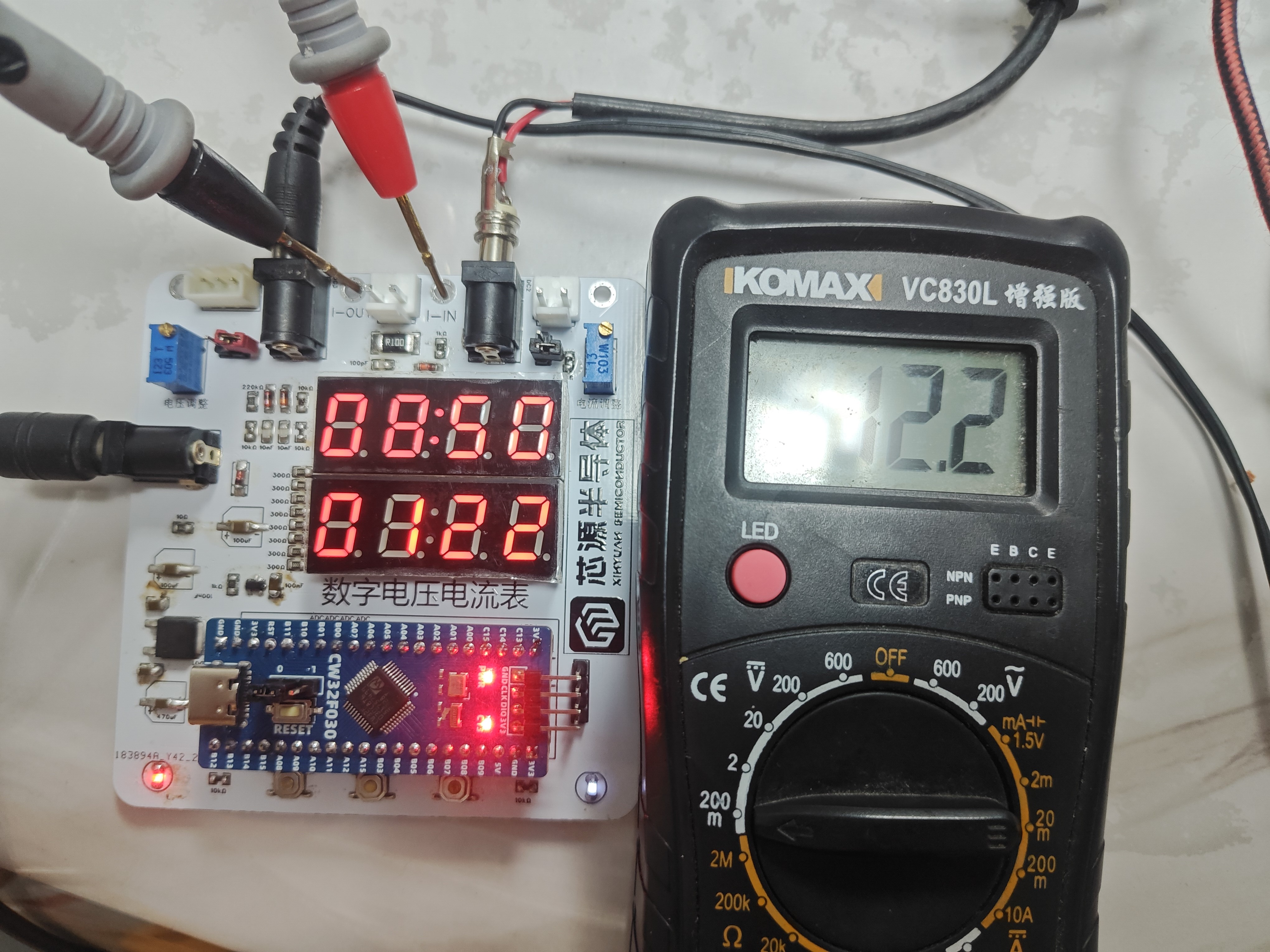

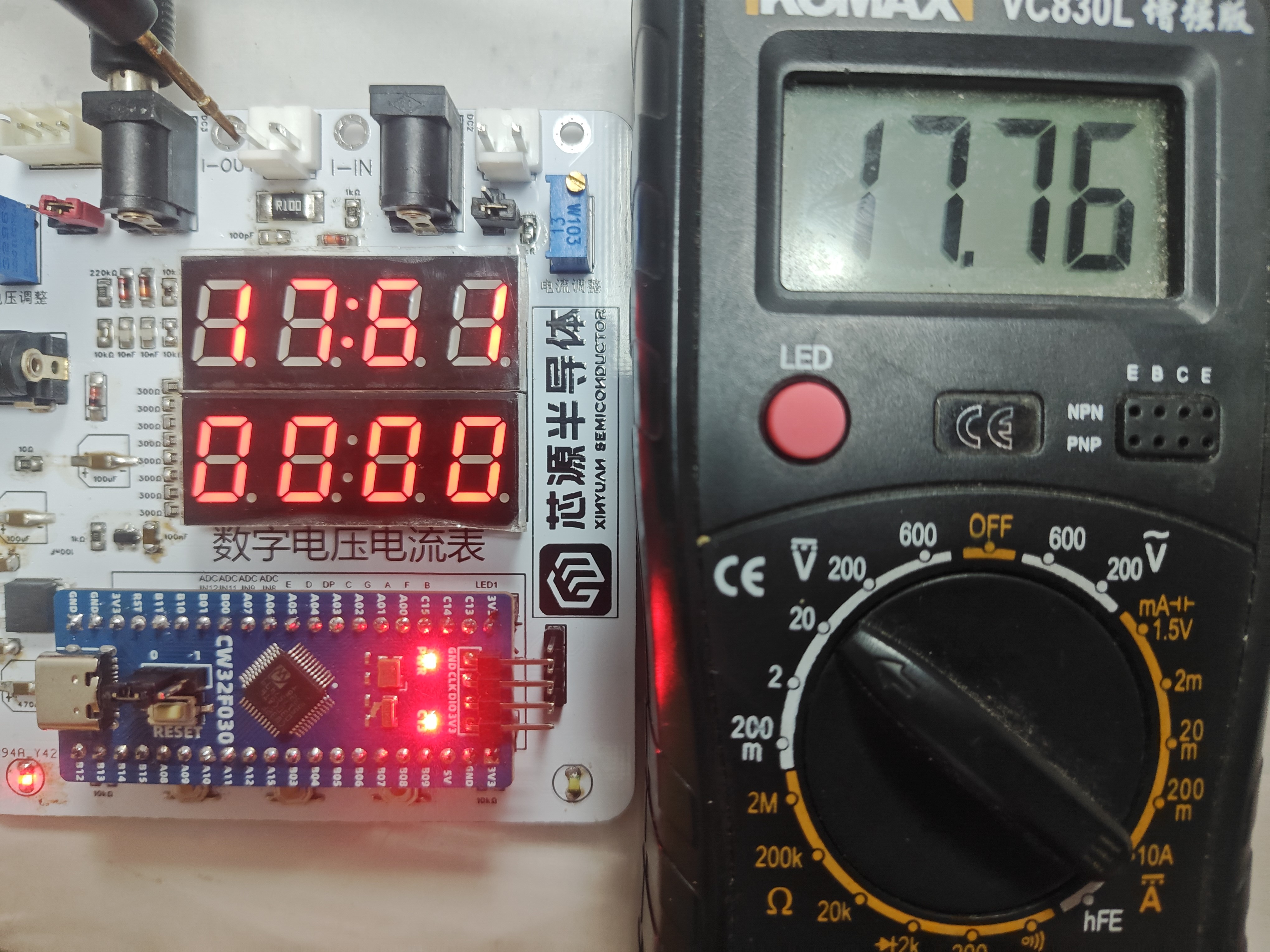

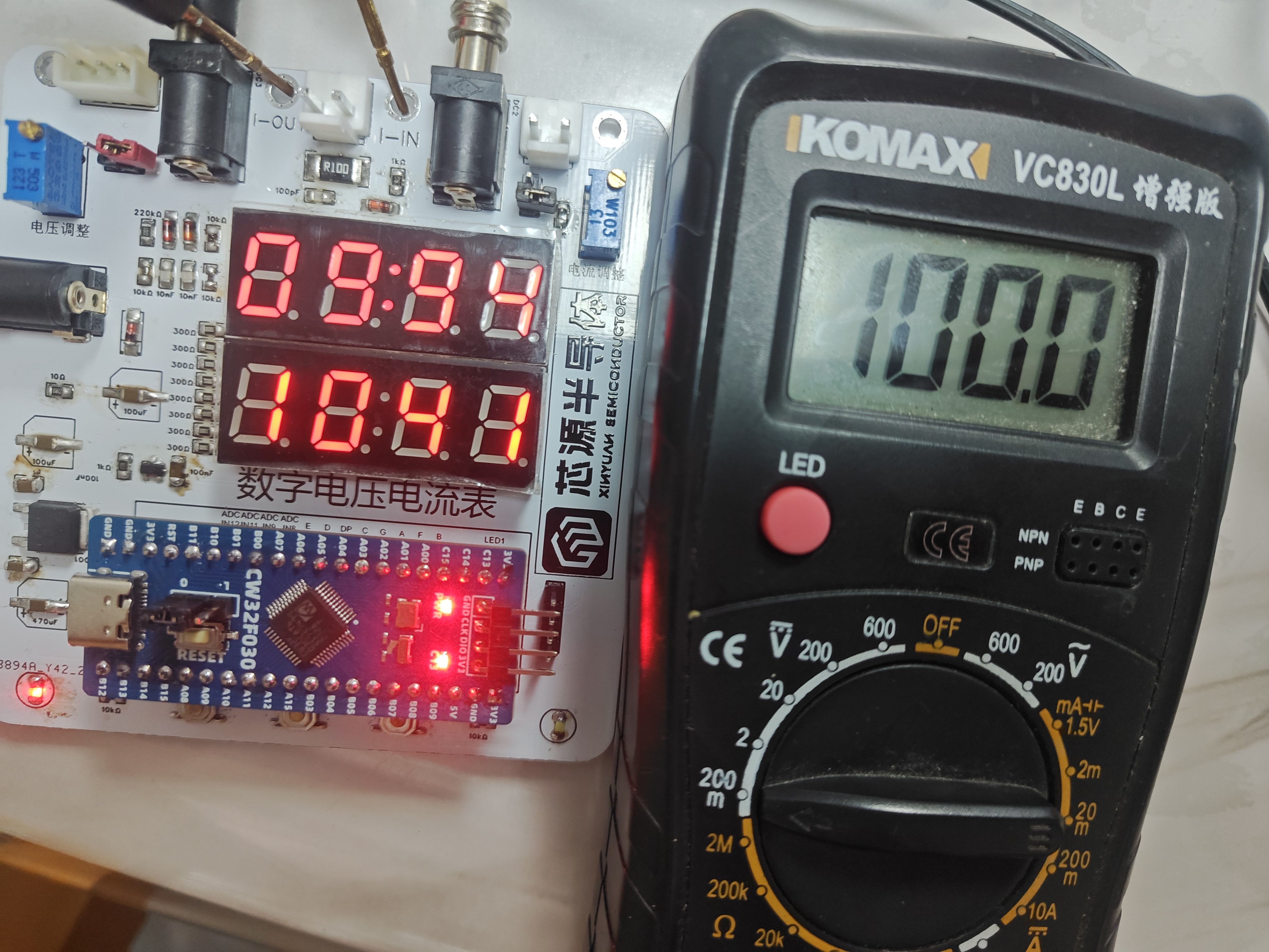

6. Other points to note: Due to the lack of a suitable load, I feel the calibration was not perfect, and there is room for improvement in the program. For example, the original design included two measurement ranges: 0-3V and 0-30V, which should be achievable with proper program adjustments. The TL431 voltage reference was not used in the program. (The following appears to be a list of measurements:
1000mA,
122mA,
17.76V,
6.57V )
