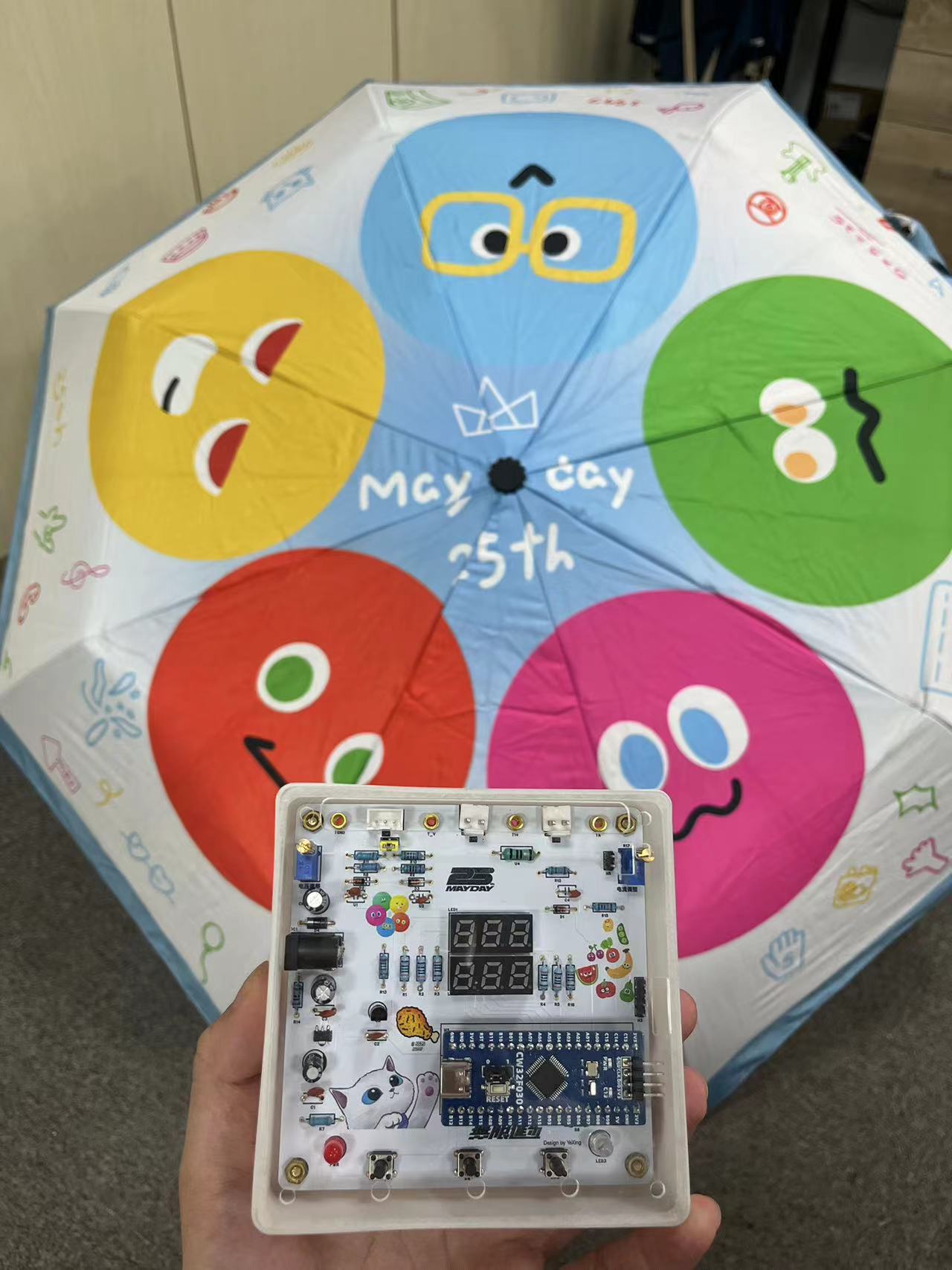

CW32-based smart current and voltage meter
Front:
Back:
Functions are as follows:
Voltage Measurement: Measure the voltage of the target object (maximum 30V) by inserting into the TGND and T_V banana plug interfaces.
Current Measurement: Measure the current of the target object (maximum 3A) by inserting into the TGND and TI+ banana plug interfaces.
Voltage Calibration: Press SW1, the first row displays 5.05, used to calibrate 5V. Press SW1 again, the display shows 5.15, used to calibrate 15V. After calibration, press SW2 to confirm.
Current Calibration: Press SW1 again, the first row displays A.0.5, used to calibrate 0.5A. Press SW1 again, the display shows A.1.5, used to calibrate 1.5A. After calibration, press SW2 to confirm.

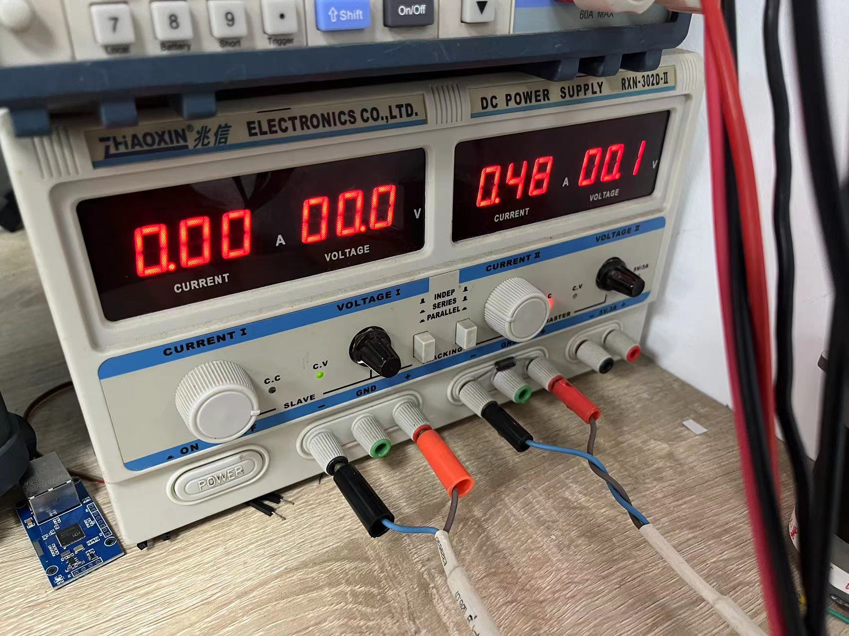

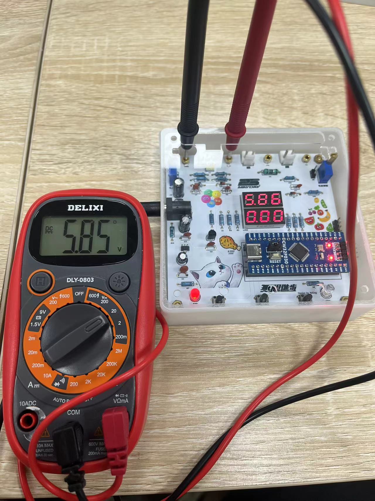

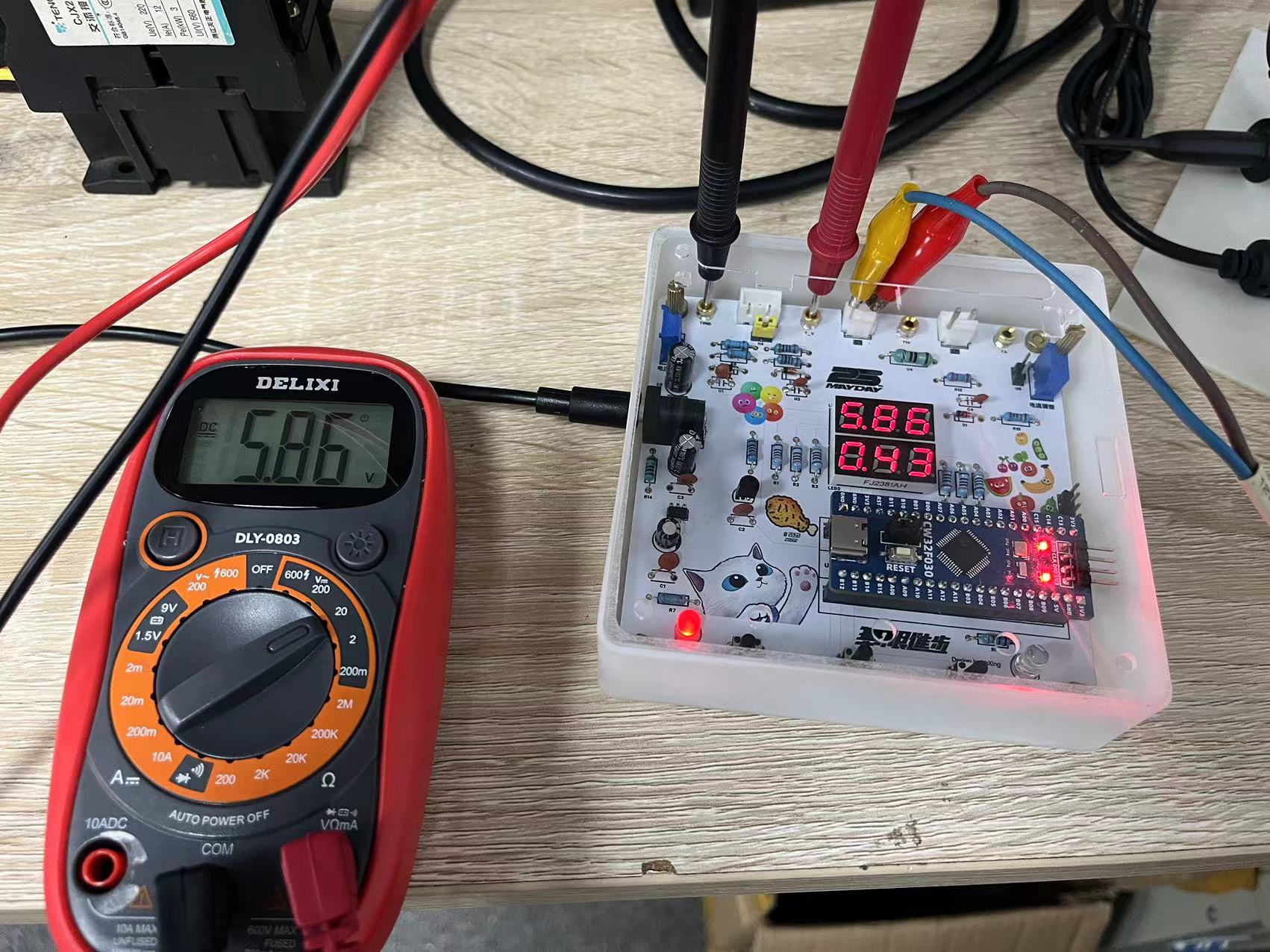

Voltage Measurement: Compare
the current measurement with a multimeter, using an adjustable power input.

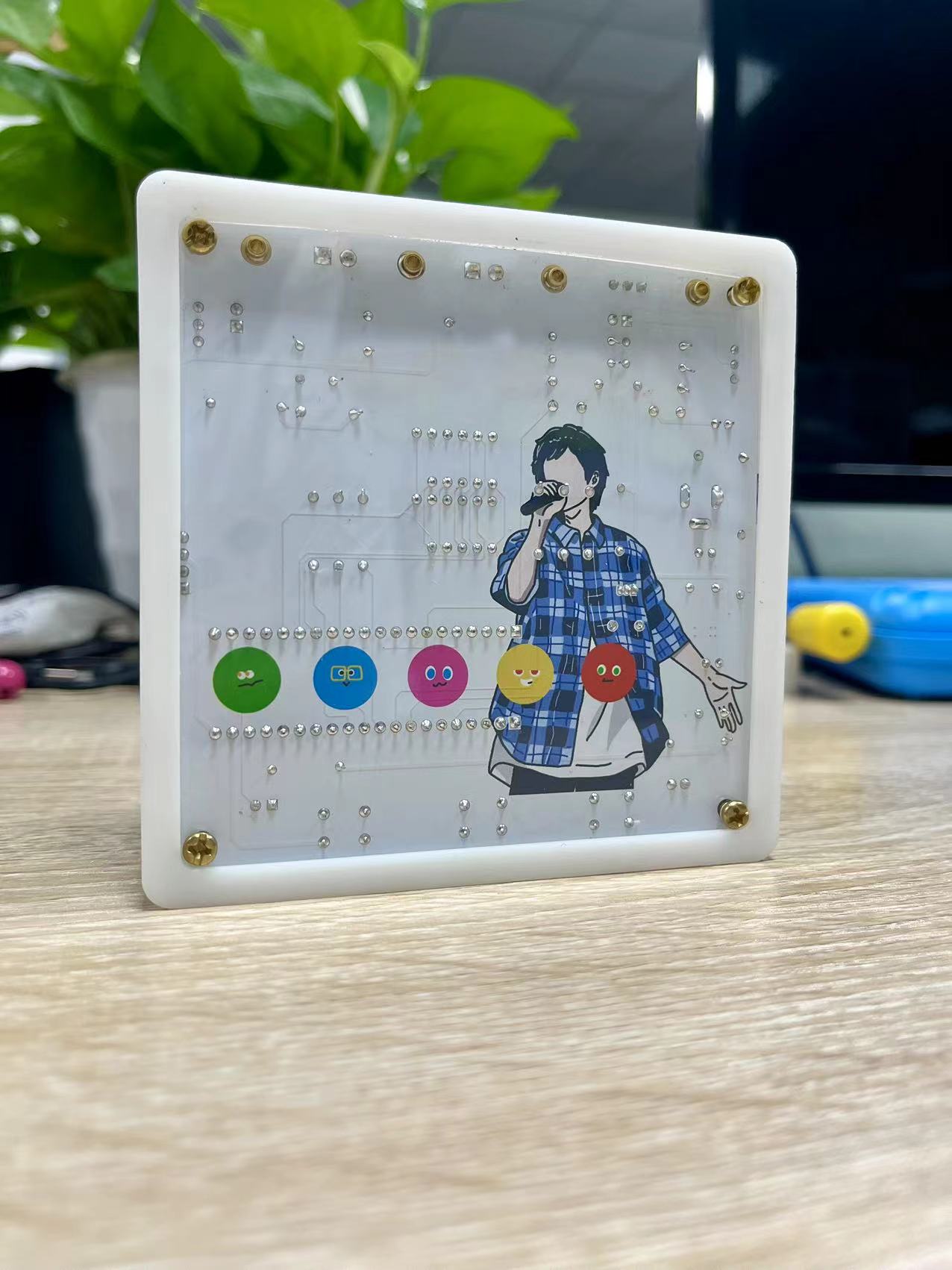

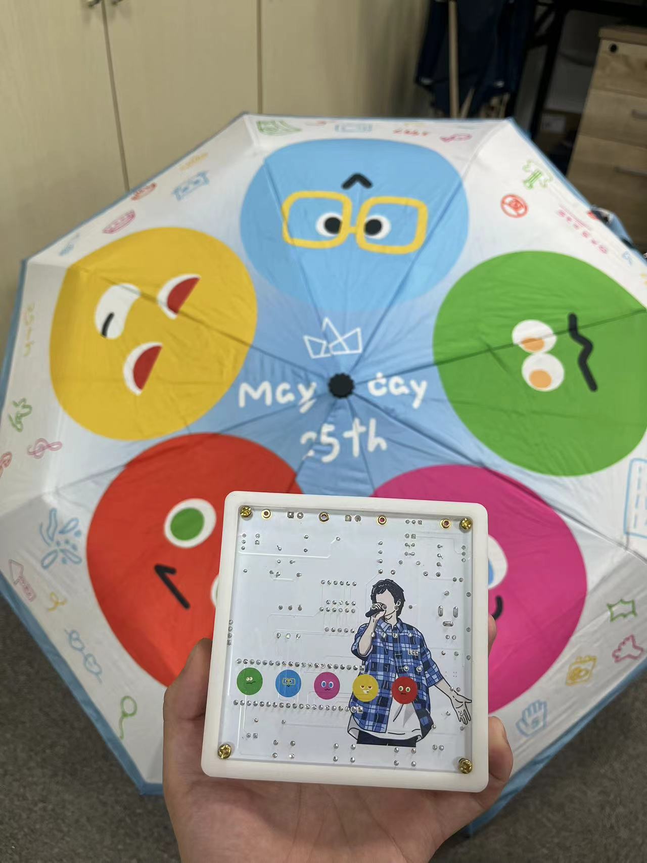

0. Physical Verification Image
1.3D Shell Size Borrowing Notes
      Image 1.0 Shell Demonstration Image

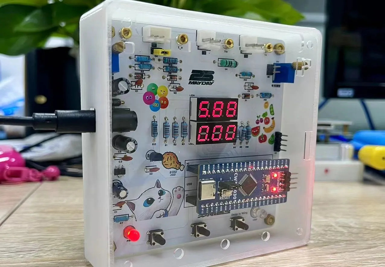

III. Physical Demonstration
3.1 PCB
3.2 Panel and Housing
3.3 Overall Demonstration

2. Voltage Calibration: (The calibration method for 5V and 10V is the same; two values ​​need to be calibrated for accurate measurement.)
Use a DC power supply as the input and connect the jumper cap at JP1.
Connect the black probe of the multimeter to TGDND and the red probe to T_V.
Switch the mode to mode 1 using button 1.
Adjust RP1 until the multimeter displays 5.00V, then press button 2 to calibrate.
After calibration, press button 3 to return to mode 0.

   Current calibration uses a voltage simulation method. The voltage displayed on the multimeter = R0 (0.1Ω) * actual current. Therefore, the voltage displayed on the multimeter * 10 can be considered the actual current value. (Do not solder R0 during calibration.)
Use a DC power supply as the input and connect the jumper cap at JP2.
Connect the black probe of the multimeter to TGDND and the red probe to TI+.
Switch to mode 3 using button 1.
Adjust RP2 until the multimeter displays 0.05V, then press button 2 to calibrate.
After calibration, return to mode 0 using button 3.

CW32 Voltage and Current Meter
The CW32 voltage and current meter I made in the LCSC training camp was basically based on the official case study. The only changes were replacing the resistors, capacitors, and other components with surface-mount 0603 packages and making some modifications to the wiring layout.
1. Project Function Introduction:
A voltage and current meter based on the CW32F030C8T6 chip
. 2. Project Attributes:
LCSC training camp project, for learning and familiarizing oneself with the CW32 chip from domestic Chipsource Semiconductor.
3. Open Source License
: GPL 3.0
4. Hardware Part:
The expansion board's appearance is shown in the image, using LCSC's color silkscreen printing.
The 3D shell is shown below; the top cover is open and has M2 screw holes, with recessed areas for the three buttons for easy operation. Because the shell itself is not very tall, there is no space reserved for the front panel.
One issue is the LED indicator lights. The placement of the two LED indicator lights wasn't considered much at the time of installation, and it was only after plugging in the CW32 that it was discovered that the CW32 board directly blocks these two LEDs, making them invisible from directly above, which is a bit awkward.
5. Software
: There's not much to say about the software; I didn't make any changes and directly used the official code. However, I encountered an error when using the official code directly. I'm not sure if it's a Keil version issue, but it couldn't recognize the WEAK decorator in cw32f030_systick.c, so I had to remove it.
Ultimately, I only tested the voltage measurement function because I didn't have suitable wires for the current connection port. I used DuPont wires to connect the voltage measurement port and tested its functionality as shown in the video.
Function demonstration.mp4

Because a 12V charger is used as the power source, it is not possible to calibrate 15V
0.5A
1A.
