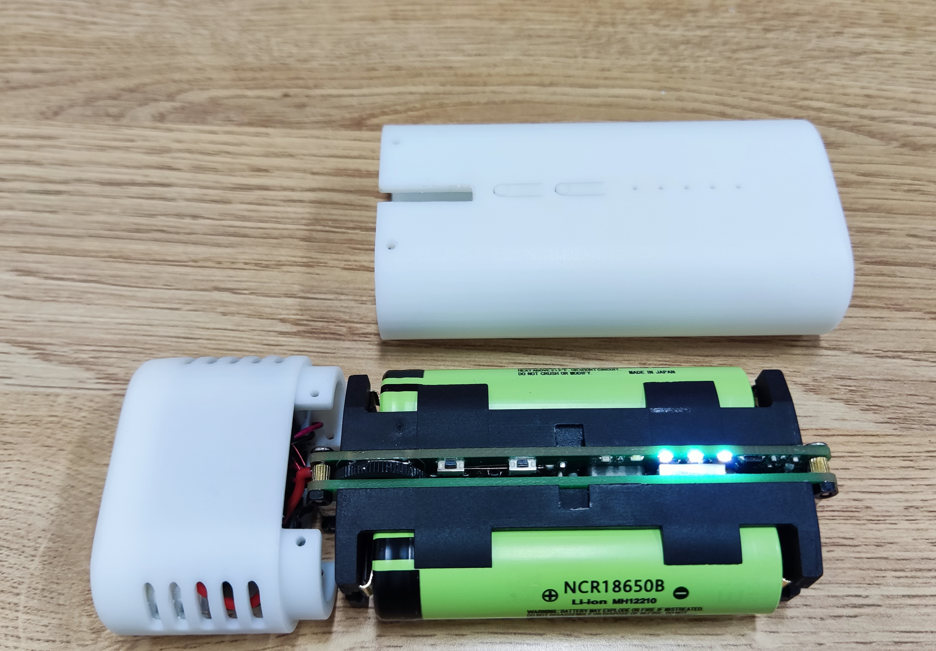

The LED flashlight + mobile power function design of this project is realized by pure hardware. SW6106 is responsible for charging the battery and providing fast charging input and output functions for the TYPE-C port. The high-power LED constant current drive power is obtained by another output interface of SW6106 through CH224K to deceive the 12V1.5A 18W output, and then the LM358 op amp samples the voltage through the shunt resistor and compares it with the reference voltage to control the NMOS switch to realize the hardware adjustable constant current function.
Since high-power LEDs generate a lot of heat when working, ordinary passive cooling can no longer meet the needs, so this project uses active air cooling to collect the heat sink temperature in real time through the NTC thermistor. The hysteresis comparator built by the LM358 op amp controls the fan power switch to control the LED heat sink temperature.

Device information1
. The final product is mainly composed of: Shell + PCBA + two 18650 batteries + LED light board + focusing lens + heat sink + 2006 fan + dot laser head + M2 copper column and flat head screw
2. The length, width and height of the finished shell: 120*49*25mm, respectively composed of shell 1 and head cover 1, fixed by 4 M2*5 flat head screws, produced by Jiali Chuang 3D printing
3. PCBA: double-layer board 1.6 board thickness consists of two independent PCBAs connected together by 4 M2*4 double-pass copper columns and 8 M2*3 flat head screws (pay attention to the direction)
4. The 18650 lithium battery uses a normal 4.2V voltage by default. If you need to use a high-voltage lithium battery, you need to change the SW6106 related configuration resistor. The higher the capacity, the longer the battery life
5. The LED light board is composed of lamp beads and heat dissipation substrate. The width of the lamp board is <19mm, the height of the lamp wick is <1mm, and the lamp beads must use a flat head package, otherwise the focusing lens cannot be installed. As long as the size parameters are suitable, any lamp beads can be used.
6. Due to the structural design of the head cover 1, the focusing lens can only use a 12*6mm diameter borderless lens. Try to use glass material.
7. Due to the structural design, the heat sink can only use a 22*22*20mm heat sink. The LED light board can be fixed to the heat sink through thermal conductive silicone and thermal conductive double-sided tape. There are direction requirements when installing.
8. 2006 cooling fan length, width and height: 20*20*6.2mm. The size can be small but not large. 12V power supply. When installing, the cooling fan wire should be installed first. It should be led out through the shell bayonet.
9. Laser head size: diameter 12mm height <20mm output: 3V~4.2V maximum constant current 160mA power supply. The color is arbitrary. It does not have to use a laser head. It can also drive other low-power LEDs.
