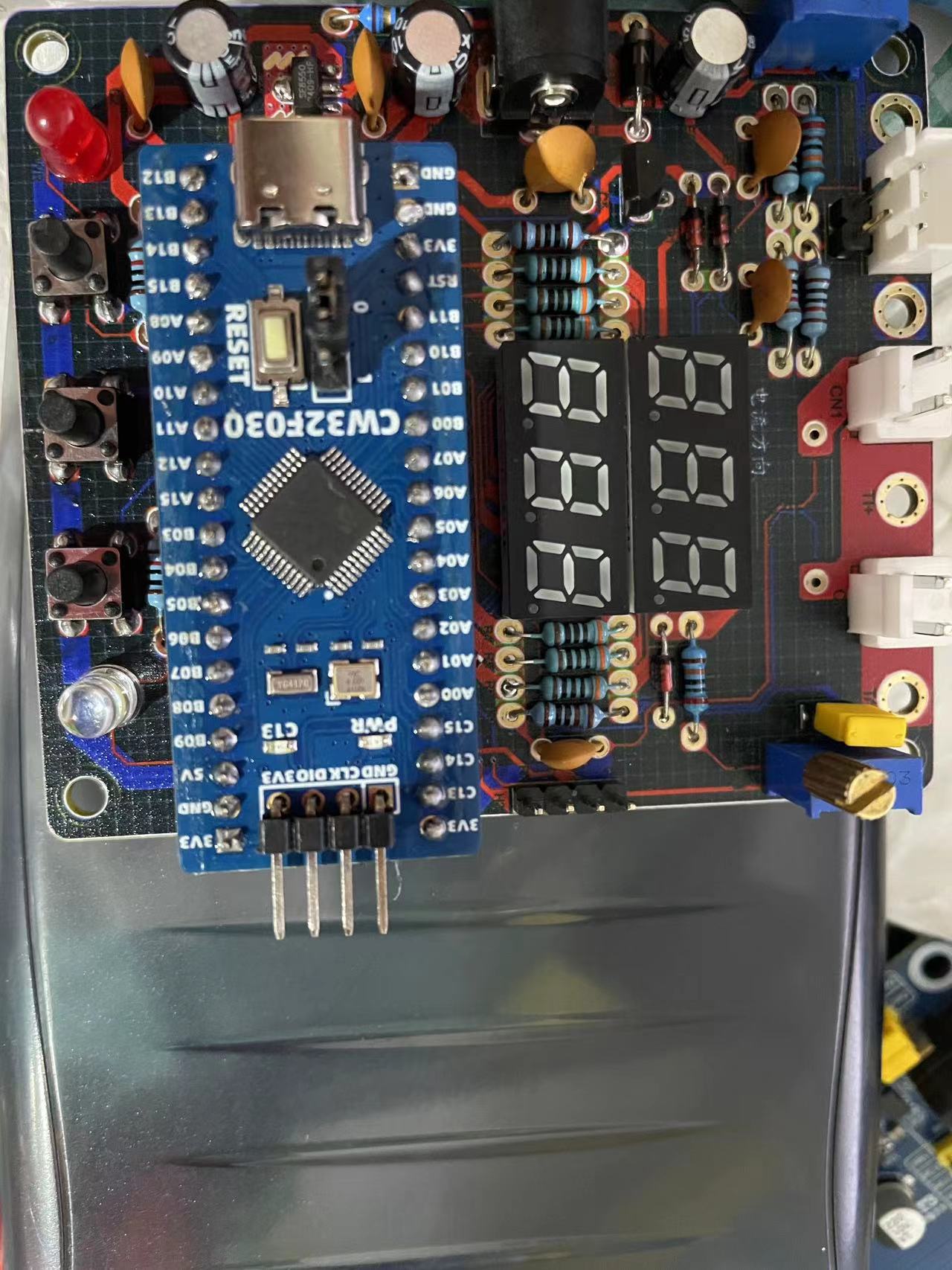

3. Voltage Sampling Circuit:
The voltage divider resistors in this project are designed to be 220K+10K, therefore the voltage division ratio is 22:1 (ADC_IN11).
The voltage divider resistor selection
is designed to measure the maximum voltage. For safety reasons, this project uses 30V (the actual maximum display value can be 99.9V or 100V).
The ADC reference voltage is 1.5V in this project, and this reference voltage can be configured through the program.

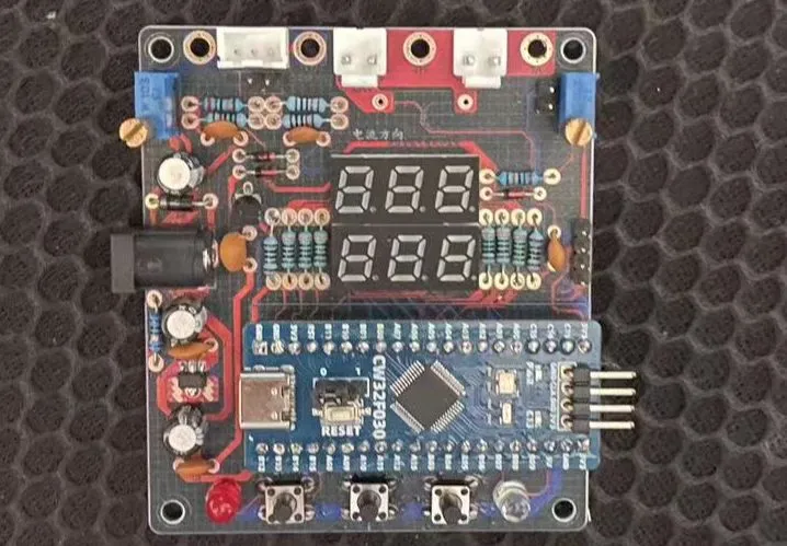

5. Digital Tube Display:
This project utilizes digital tubes as the display unit.
Two 0.28-inch three-digit common-cathode digital tubes are used as display devices. Compared to displays, digital tubes offer better visibility in complex environments. Depending on the specific needs of the application, smaller current-limiting resistors can be used to achieve higher brightness. Furthermore, digital tubes possess better mechanical properties and are less susceptible to damage from external forces compared to displays. They are commonly used in industrial applications requiring stability and reliability. From a development board learning perspective, this facilitates targeted learning of electronic measurement principles and related development.
In this project, actual testing showed that the current-limiting resistors (R1~R6) for the digital tubes were configured to 300Ω, resulting in good visibility for both red and blue digital tubes, with a soft and non-glaring brightness.

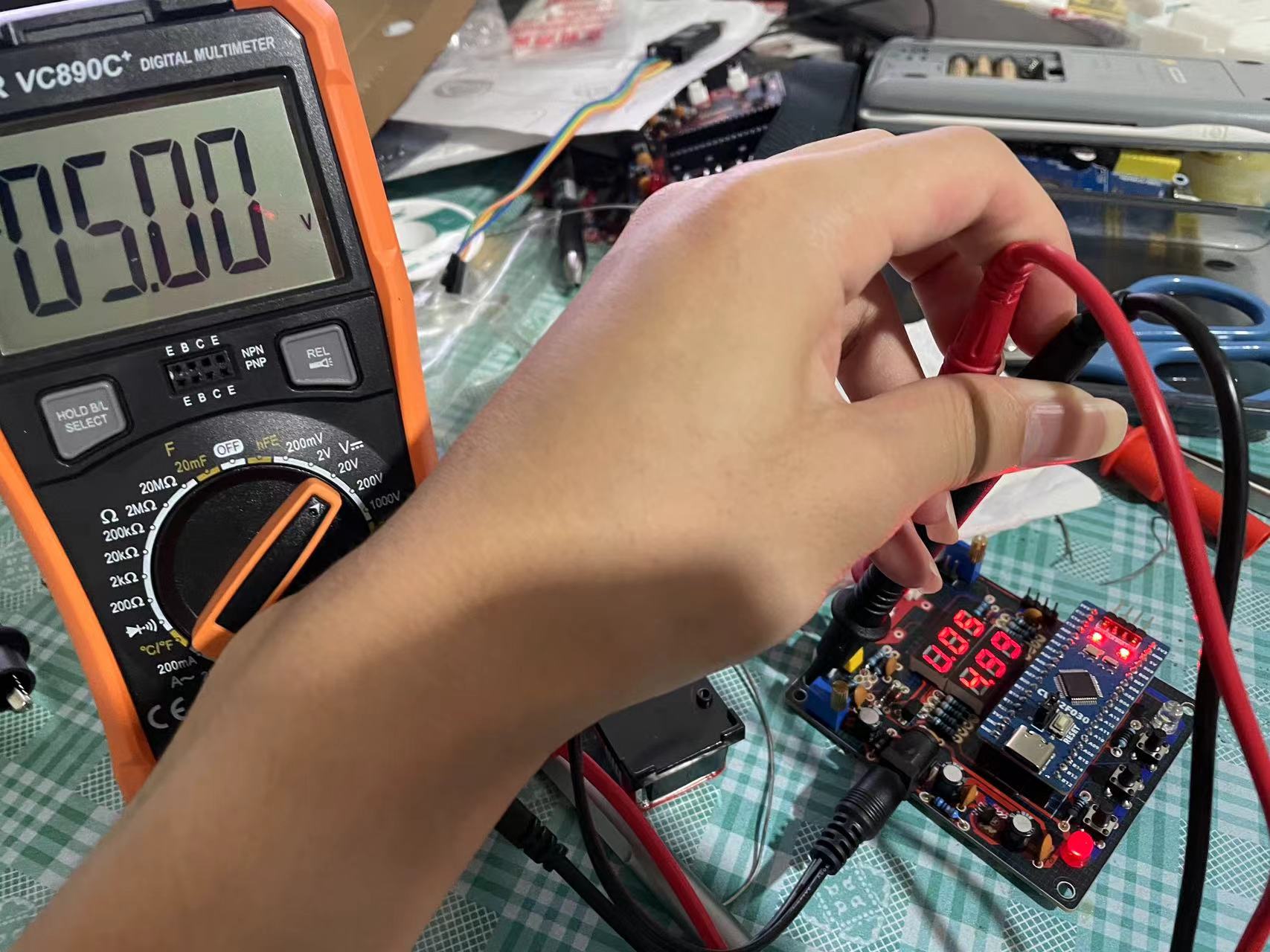

****************************************************************************** Physical Verification **********************************************************************************
PCB Physical Current and Voltage Calibration (only a partial calibration process)
For daily use,

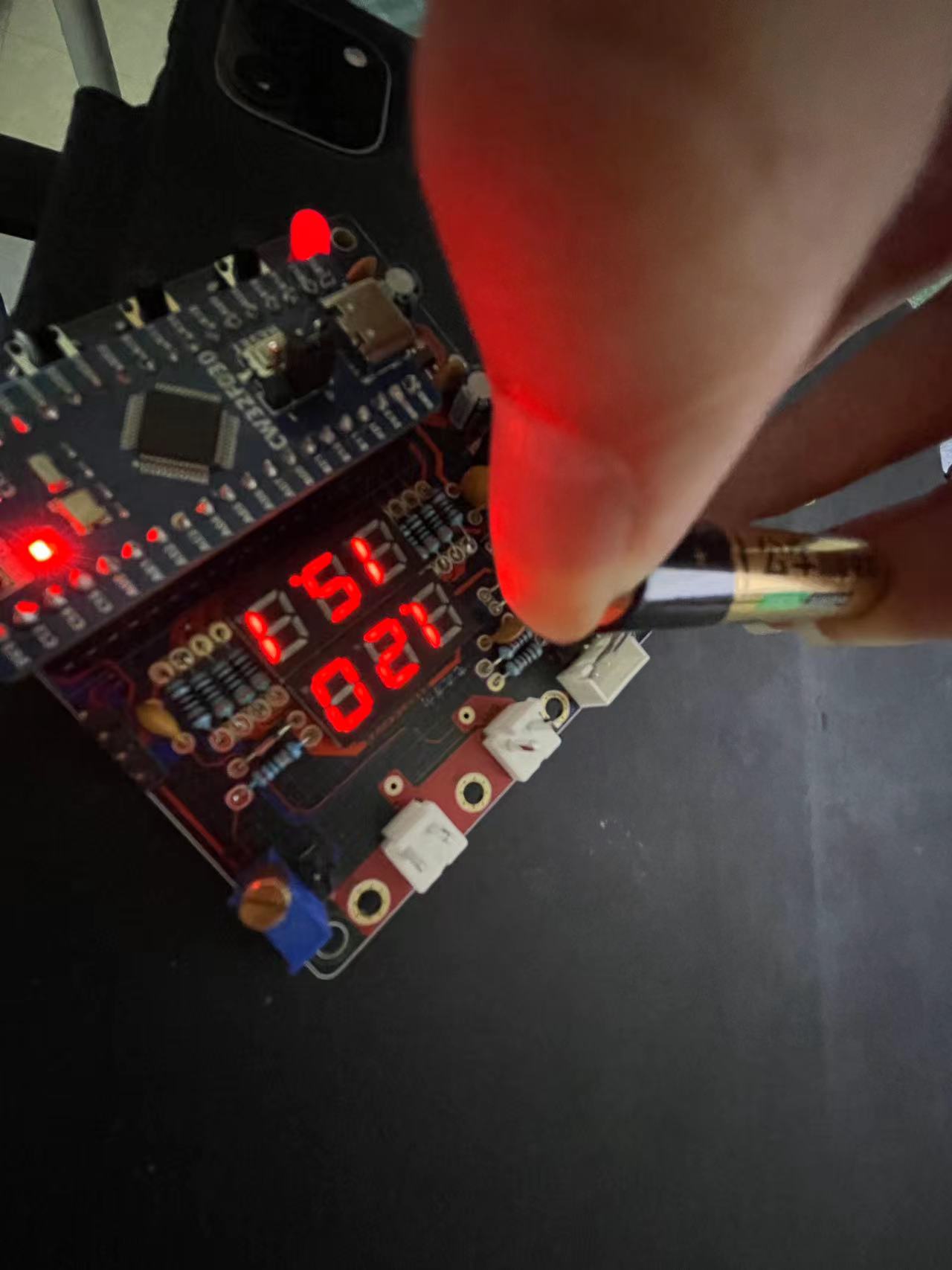

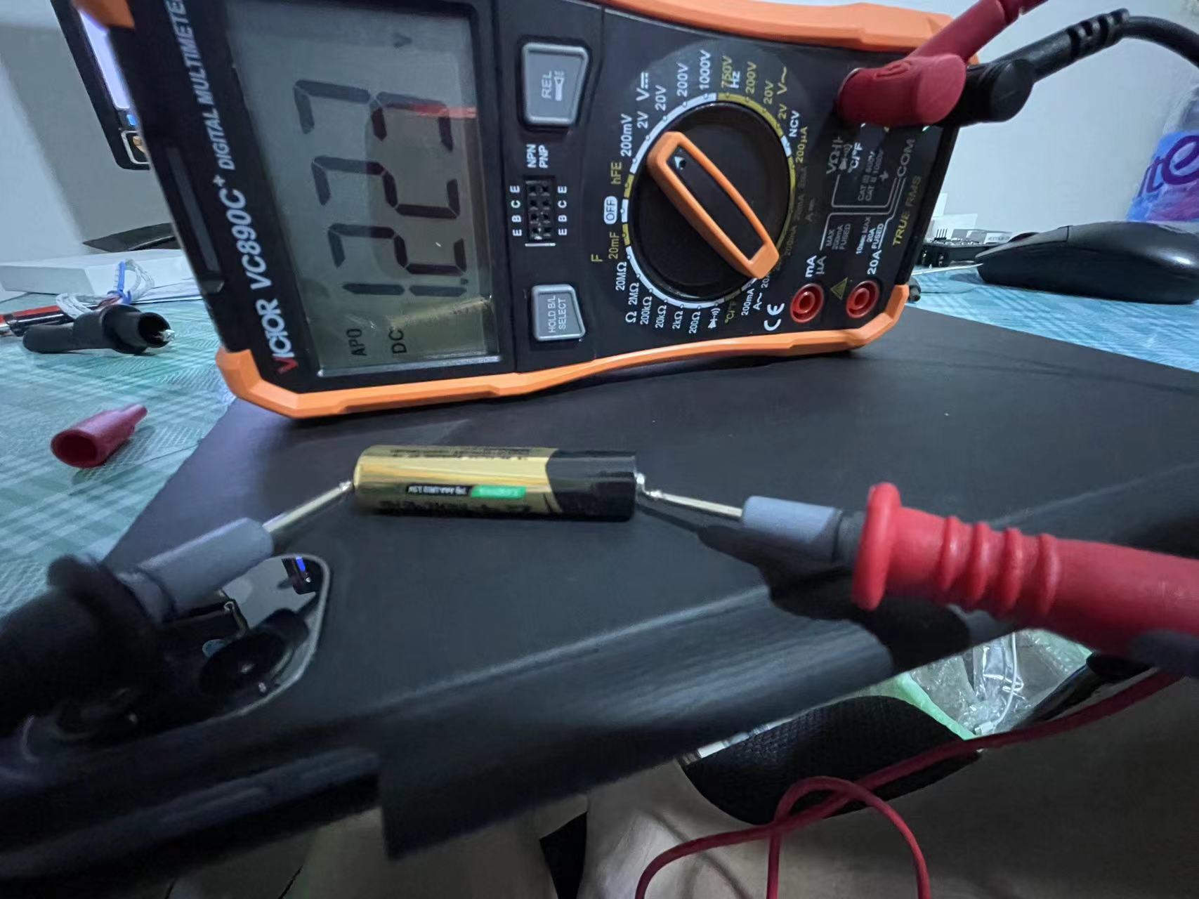

the image shows a multimeter voltage screenshot of a nearly depleted 1.5V battery.
This image shows the voltage and current meter screenshot of the project using a nearly depleted 1.5V battery.
This can demonstrate the accuracy and feasibility of this project.
