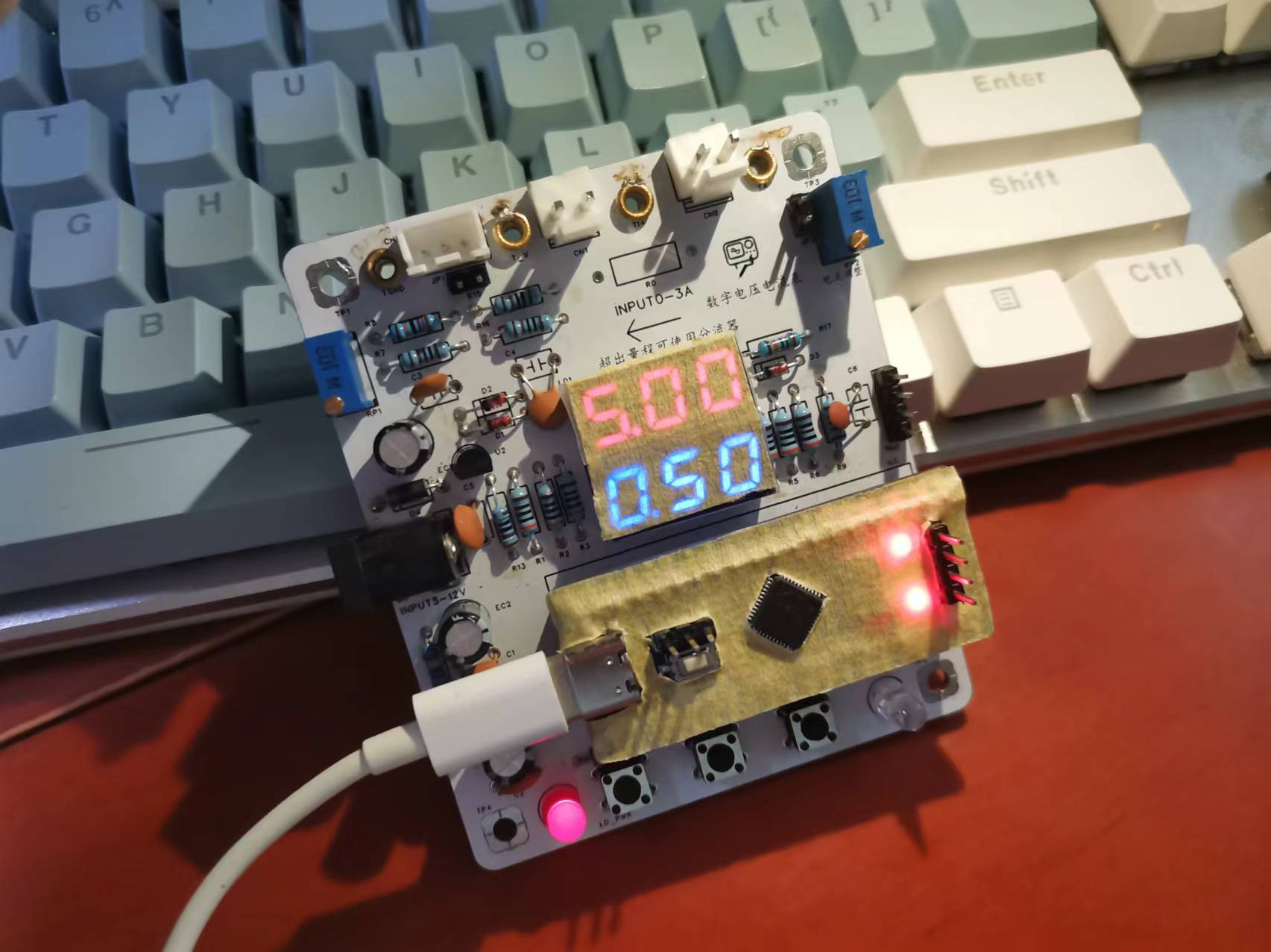

Digital voltage and current meter based on CW32F030C8T6 development board
The digital voltmeter and ammeter based on the LCSC CW32F030C8T6 is finally finished!
Unlike ordinary multimeters, it has a calibration function. When the measurement is inaccurate, you can calibrate it. Press the user button 1 to enter the 5V calibration mode, which displays S.05.
At this time, plug in a voltmeter and turn the long-handled potentiometer to make the voltmeter display 5V. The blue text below shows the voltage that is not calibrated in the meter. If you have time, you can also calculate the error [winking emoji].
Then press the user button 2 to enter the 15V calibration mode, which displays S5.15. Turn the potentiometer to 15V and press the user button 2 again to complete the calibration. Similarly, you can also calibrate the current. Press the back button 1, which is user 3, to return to mode 0 and enter the measurement mode. This is its highlight.
Bilibili video link. I will post the Oshwhub open source and code in the comments section tomorrow.
This link is not the original version. This version adds two switches and Type-C power supply.
Below is the official documentation. If you don't want to read it, just close it.
