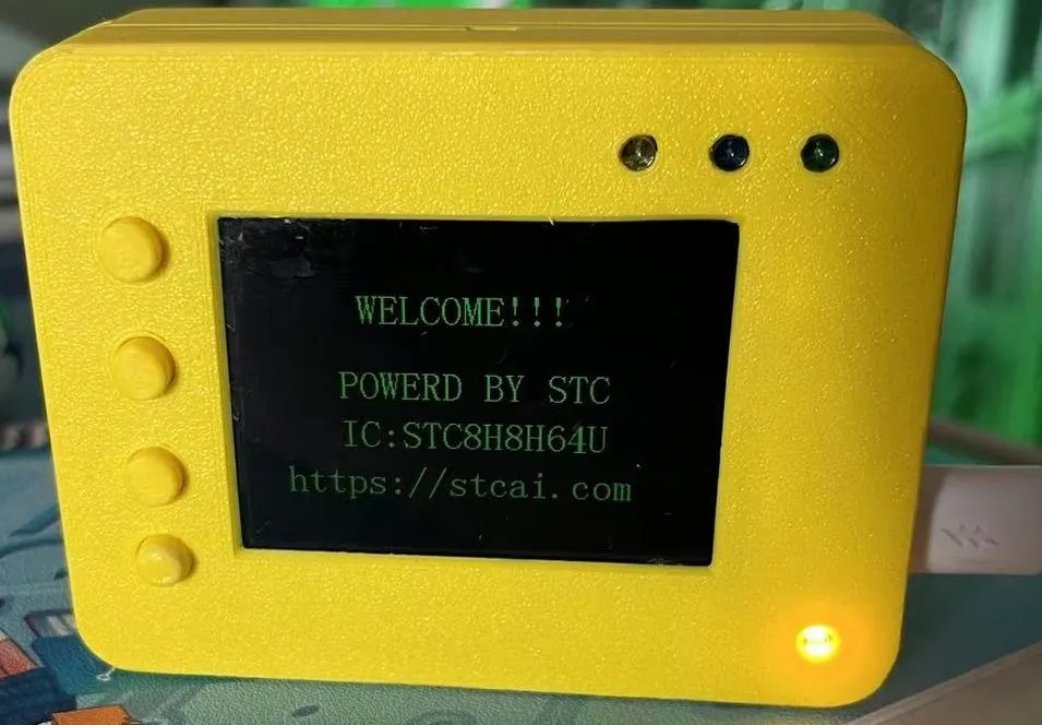

Temperature and humidity monitoring
Peripherals used
: GPIO: for screen driver, LEDs, buttons, etc.;
UART: uses two serial ports to interact with the Bluetooth module and voice module respectively;
SPI: used to communicate with external flash memory and store fonts, etc.;
main function
buttons are used to set temperature and humidity alarm values, which
are then displayed on the LCD;
Bluetooth connects to a mobile phone, allowing users to check temperature and humidity from the comfort of their bed;
the voice module is used to alert users when temperature and humidity reach alarm values
. Additionally, this project uses battery power, and
semi-finished products such as battery charging and discharging circuits are shown.
