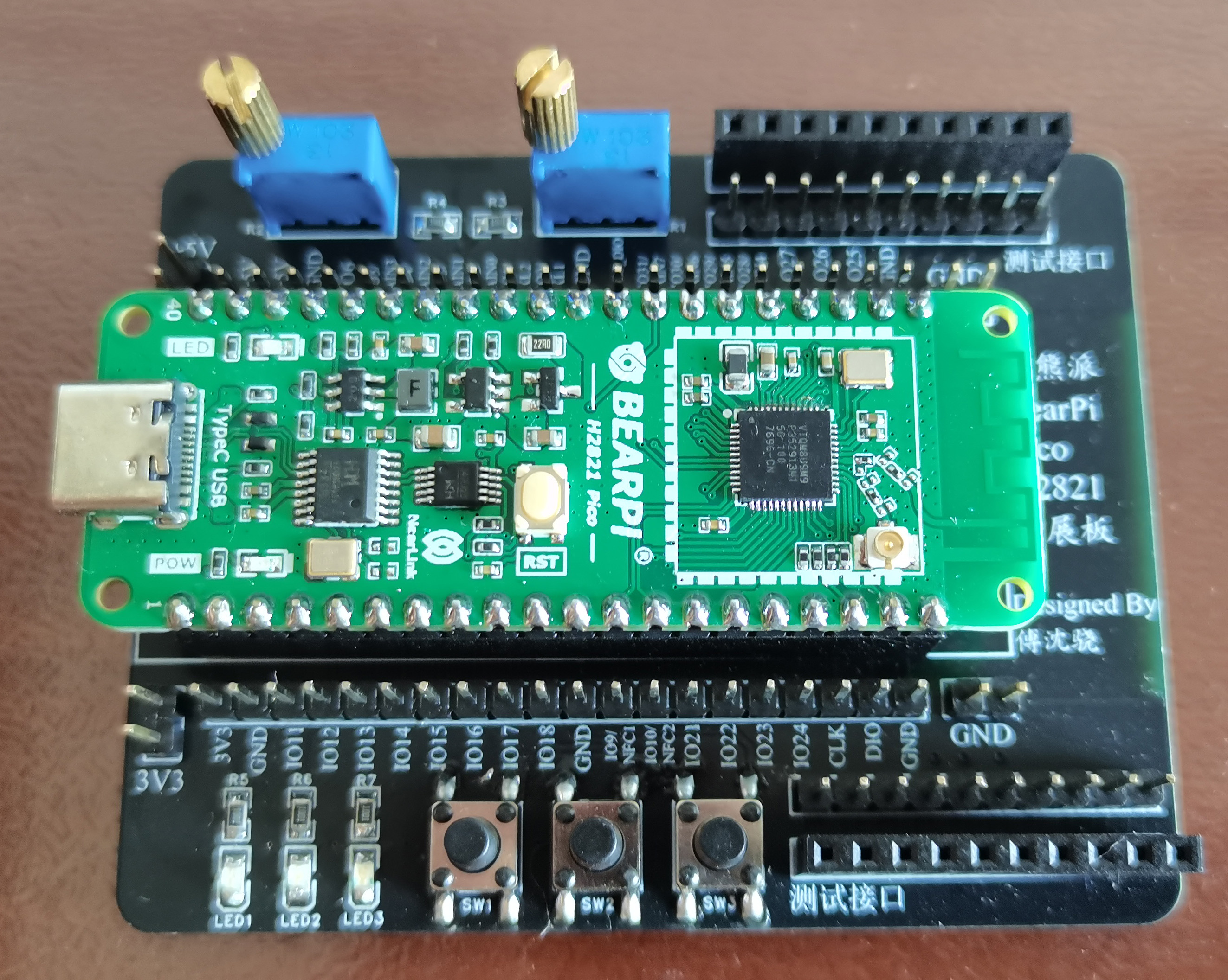

Thanks to EEWorld for giving me this opportunity to review the BearPi-Pico H2821. Therefore, I designed an expansion board to implement some of its functions.
The BearPi-Pico H2821 is a core board based on a highly integrated 2.4GHz SoC BLE&SLE as the main control chip. It features flexible digital interfaces, with I/O ports reusable for any function. It integrates a high-performance 32-bit microprocessor (MCU), a hardware security engine, and rich peripheral interfaces, including SPI, UART, I2C, PWM, GPIO, USB 2.0, NFC Tag, PDM, I2S/PCM, QDEC, and a KEYSCAN keyboard scanning circuit. It supports 8-channel 13-bit resolution ADCs, and the ADC supports audio AMIC connection. It has built-in SRAM and encapsulated Flash memory, and supports running programs on the Flash.
This expansion board, while bringing out the core board pins, adds three LEDs, three buttons, two potentiometers, and a pin header/female header expansion interface, which can expand the implementation of BearPi-Pico's GPIO, PWM, and ADC experiments.
