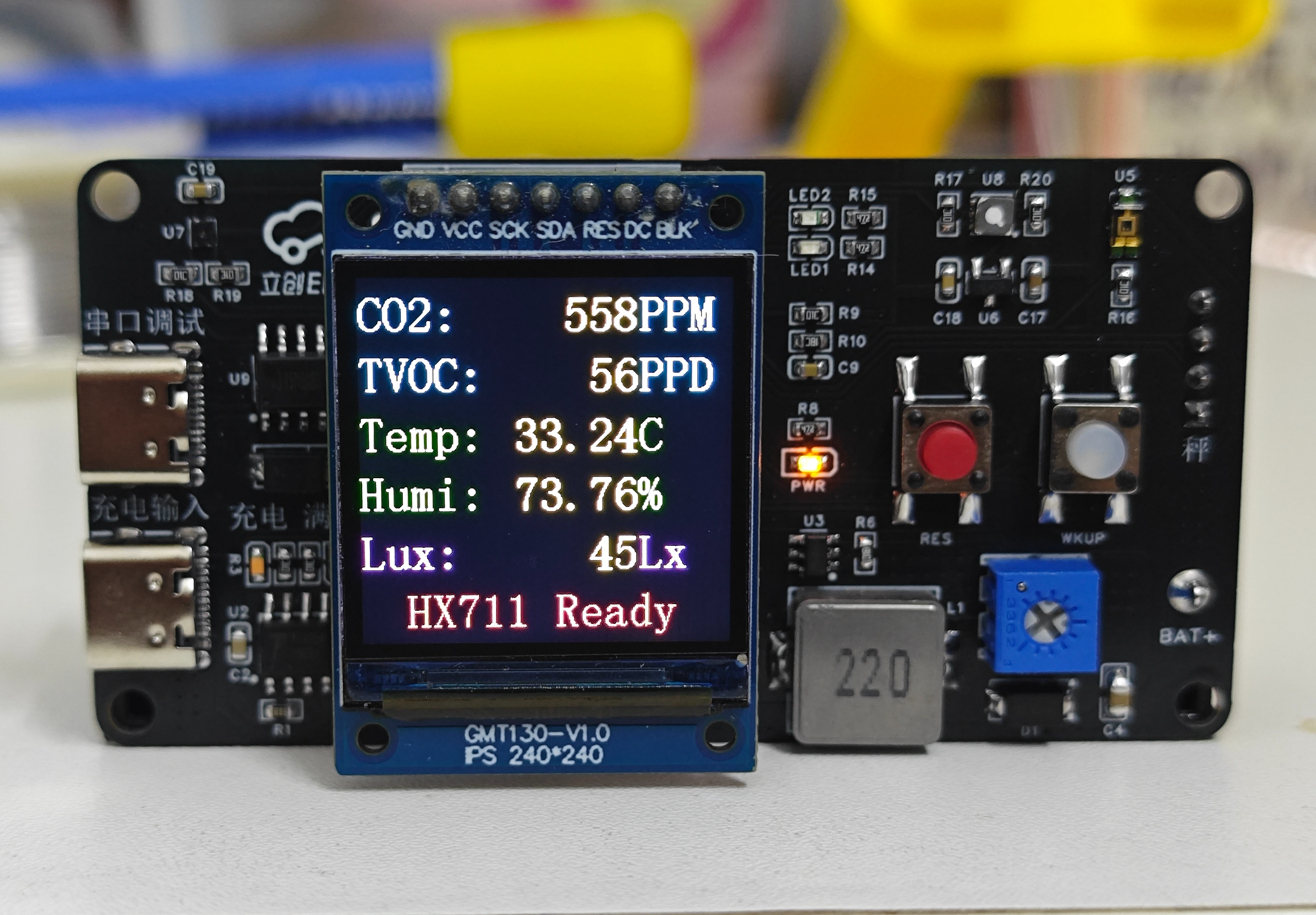

Physical product image

1. Temperature and humidity detection SHT40
2. Air quality detection SGP30, CO2 concentration, TVOC
3. Light intensity detection TEMT6000, illuminance range: 1-1000 lux
4. Electronic scale HX711, 5KG range (can use scales with other ranges)
5. Clock display, the icon changes according to the set time and temperature, the time can be modified via serial port, no code modification required
6. Battery powered with charging protection to prevent overcharging and over-discharging, and automatically controls the charging current. A charging prompt will appear when the battery is low.
Sensor detection interface: (SGP30 initialization requires some time; HX711 will continuously display "Ready" if not connected, but will not display if the interface is switched.)
Time display: Displays the time and changes images according to day/night (sun and moon, code-defined). Displays three states based on temperature: hot, cool, and cold (customizable temperature).
Battery power detection: If using battery power, a prompt will appear to charge when the battery is low.
The RTC time can be changed via serial port without modifying the code. The serial data packet format is shown in the image: @2000.01.02.03.04.05.06 (with carriage return and line feed). Incorrect time format or time setting will be indicated.

: 1. The main controller is selected as STM32G070CBT6. Originally, STM32G030C8T6 was used, but due to insufficient Flash and SDRAM for FreeRTOS and storing LCD images, it was replaced with STM32G070CBT6.
2. Power Input Section: Features charging protection to prevent overcharging and over-discharging of the battery, and automatically controls the charging current for better battery protection. Type-C female connector.
Maximum charging current: 1000mA;
Charging cut-off voltage: 4.2V;
Battery over-discharge protection voltage: 2.4V;
Maximum output current: 2A (recommended for use within 1A);
Output voltage: 4~12V (can be modified to higher output).
When the Type-C is connected to the power input terminal, the blue light illuminates and the red light flashes rapidly, indicating that power is connected. During battery charging, the red light remains on. The blue light illuminates when fully charged.
When a power source is connected to the charging input terminal, current is obtained from the power input terminal. If no power source is connected, current is obtained from the battery. The output automatically shuts off when the battery voltage drops below 2.4V.

3. The software
code has been uploaded as an attachment, with extensive and detailed comments, a basic program for beginners using FreeRTOS.
The main program is primarily located in the app_freertos.c file.
The LCD, SHT40, SGP30, and HX711 drivers are in the BSP
light intensity and battery detection ADC-related sections in the adc.c file.
Serial port data packet processing for time modification is handled in the stm32gxx_it.c file
. Task 1: Relatively low priority, temperature and humidity detection and display.
Task 2: Relatively low priority, CO2 and TVOC concentration detection and display (SGP30 requires initialization for a period after power-on).
Task 3: Relatively low priority, light intensity and battery level
detection and display (light intensity conversion is detailed in the documentation). Task 4: Relatively low priority, weighing measurement and display.
The weighing module requires calibration; see the documentation > HX711 for details.
Task 5: Relatively medium priority, displaying time and updating the display time every second; the display icon changes according to time and temperature.
Task 6: Relatively high priority, detecting button presses (external interrupt).
Task 7: Relatively high priority, but requires notification to execute; if low battery is detected, prompt for charging.
