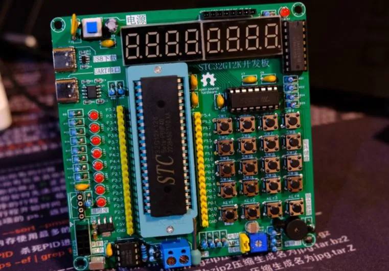

I. Project Overview
    This project uses the STC32G12K128 Beta-IDIP40 chip as the main controller. Compared to the classic 89C51/89C52, this chip offers more code space and richer on-chip peripheral resources. The board size is 10x10cm, and it extensively uses through-hole component packages, paying homage to the classics with a strong postmodern cyberpunk archaeology feel. With abundant onboard peripherals and every pin on the chip utilized, it is particularly suitable for beginners to learn about 51 core hardware and practice soldering techniques. The average cost per board is under 35 RMB (price referenced from the July 2024 market, calculated by averaging the total cost of 5 development boards and then adding a 150% premium), making it an excellent choice for beginners and training.
II. Resource Introduction
Main Control Chip: STC32G12K128 Beta-IDIP40
Power Supply Overview: Except for the WiFi interface which uses 3.3V power, all other devices use 5V power from USB output. Download
and Debugging: One USB-to-serial port (P3.6/P3.7) for debugging, one USB download interface
. Onboard Peripherals:
8-digit LED
passive buzzer,
universal screen interface (compatible with IIC bus and SPI bus screens)
, CAN communication interface,
infrared receiver,
1-channel ADC acquisition (optional light intensity or potentiometer),
temperature and humidity acquisition (compatible with DS18B20 and DHT11),
4-digit LED display (74HC595 driver)
, 4-digit LED display & 4*4 matrix keypad (TM1650 driver).
4 independent buttons (KEY1 can be used for downloading simultaneously)
WiFi communication interface (ESP01S)
III. Usage Instructions: Ready to use
immediately after opening the package. Do not insert into 51 microcontrollers, as the pins are incompatible. Please refer to the datasheet.
