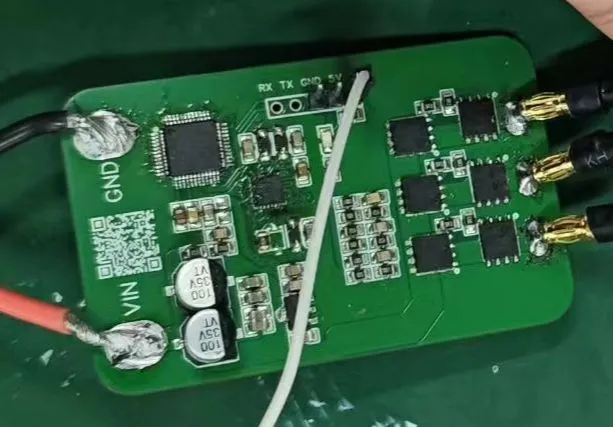

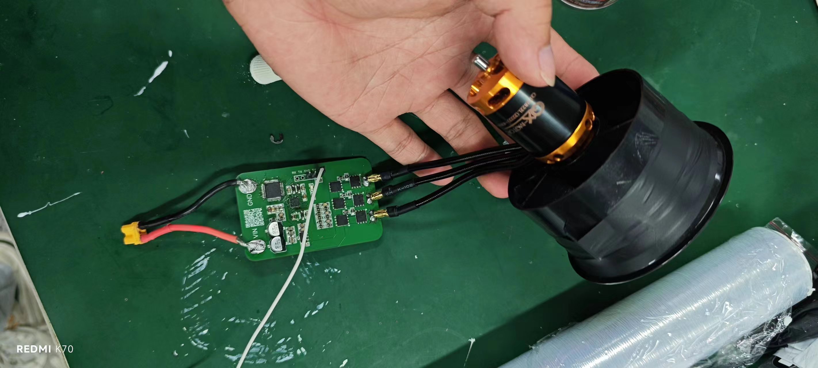

STC32G ESC
The brushless ESC supports signals from 50-300Hz, with a high-level time of 1-2ms. The motor stops rotating during the 1ms high-level time and reaches full speed during the 2ms high-level time. The brushless motor speed is adjusted by changing the high-level time.
Only 3s batteries are supported; please use according to specifications.
It supports low-voltage detection, shutting off the motor when the voltage drops below the threshold to prevent over
-discharge and battery damage. It also supports stall detection, stopping the motor after a short time and then restarting
upon power-up with three beeps.
It supports braking the motor; in case of stall or motor stoppage, the motor can be stopped quickly.
To control reverse rotation, swap the wiring of any two phases of the A, B, and C motors.

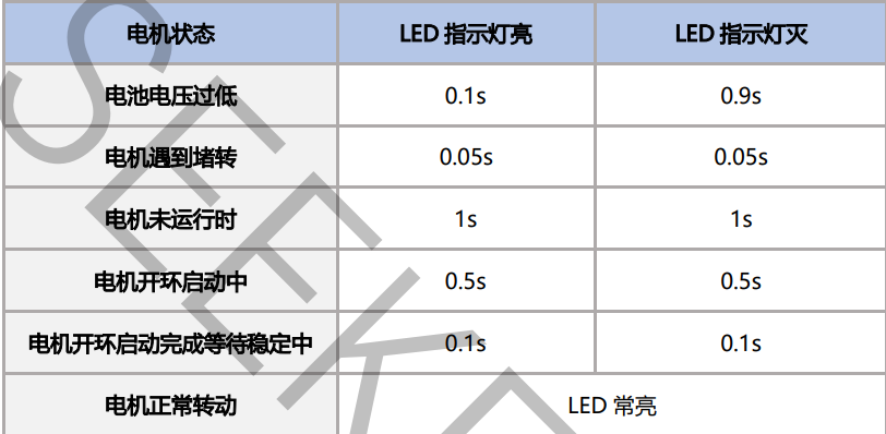

The LEDs on the control board indicate different operating states; during normal operation, the LEDs remain constant.
This uses the Zhuifei open-source code; an instruction manual is attached. For first-time use, the pre-compiled program must be downloaded.
