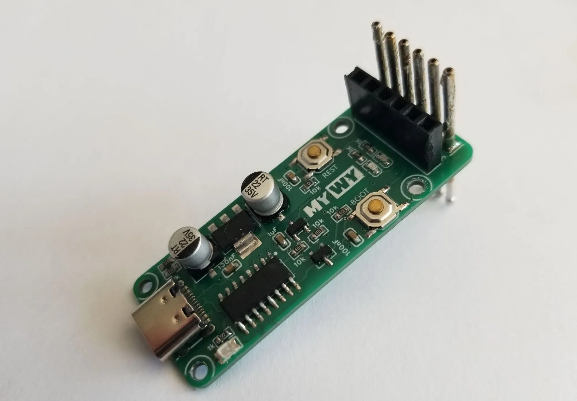

ESP Universal Downloader - Probe (Verified)
This is a serial port programmer based on the CH340C chip, compatible with Espressif ESP and Hexagon AIR series chips.
The circuit design references the ESP Air Burner circuit by Xiaole.Tao on this platform
based on the CH340C, simple peripheral circuitry;
automatic downloading circuitry for easy manual operation;
TX and RX indicator lights for clear download status;
2.54mm header pins for general-purpose use;
P100-D2 probes; designed with a programming clip for easy onboard programming.
The design has been verified; 3D printing files are attached.
A section of the clip's shaft was simply cut from a water-based pen refill.
