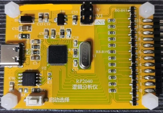

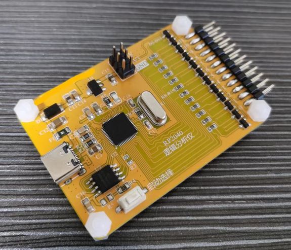

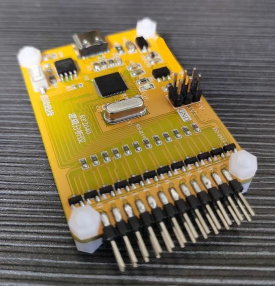

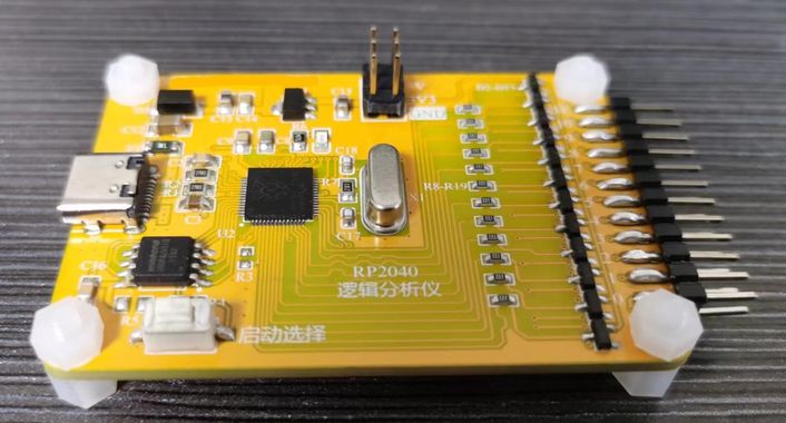

RP2040 Logic Analyzer
This project is
a 24-channel logic analyzer based on the RP2040 solution, with a host computer. Download link:
https://github.com/gusmanb/logicanalyzer/releases
. This project
modifies the original project's Pico development board to create a separate RP2040 core board. Due to the limited availability of chips for the dedicated protection circuit in the interface circuit, a dual-diode protection circuit was used instead.
Usage:
Press and hold the button on the PCB while connecting it to the computer via USB. A USB drive letter starting with "RP" will appear on the computer; release the button. Drag the firmware (.uf2) downloaded from the source address to the USB drive. The USB drive letter will disappear. Unplug and replug the USB cable; the LED on the PCB will light up, indicating successful firmware download.
Connect the logic analyzer and the signal under test (DUT), and use the host computer to acquire the signal.
Testing:
The PCB has been verified, including download functionality and external power supply functionality. The diode protection circuit has not been tested.
Note:
Resistor R3 is not connected at this time.
