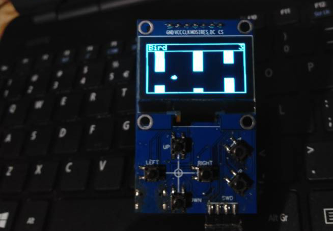

Current progress:
2020.02.03 -- V2.0 Wrote a Flappy bird game
2020.01.31 -- V2.0 Wrote a snake game
2020.01.18 -- V2.0 version welding completed
Many modifications have been made based on the V1.0 version, so I won’t list them one by one here. The following problems have been discovered so far:
  1. There is something wrong with the location of the SD card slot positioning hole.
  2. There is still noise when playing audio
  3. The schematic diagram is wrong, one end of R7 should be connected to VIN and the other end to GND.
The actual picture of the welded product is as follows:picture.pngpicture.png
Many problems were found in this version of 2019.12.29 and need to be redesigned. The tentative modification plan is as follows:
  1. Replace the filter capacitor near the speaker to the front crystal oscillator
  2. Find buttons that feel better in your hand
  3. Add SD card detection
  4. Add a fixed through hole at the bottom of the SD card slot
  5. Replace the amplifier with a smaller power one (tentatively LN4890)
  6. Change to an LDO with a larger output current (tentatively TPS73633DBVR)
  7. Looking for speakers <=1W
  8. Reset button to select another
  9. Change to a 1.3-inch OLED (bare screen, circuit drawn on the board)
  10. Add a button to create a handheld button layout
  11. Remove the 32768 crystal oscillator
  12. Remove one audio input
  13. Find a way to solve the problem of speaker noise
  14. Fixed left button routing error
Before photos:TIM screenshot 20191229204644.pngTIM screenshot 20191229204706.pngTIM screenshot 20191229204723.png
