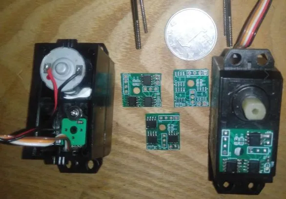

Converting a five-wire servo to a serial port servo

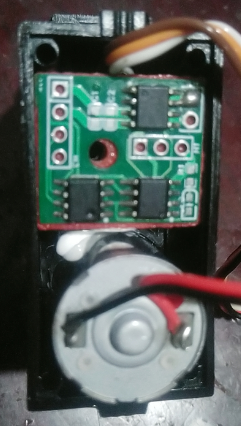

The purpose of this design
is to create a servo control board that communicates via 485 serial communication. Many servos are available on the market; they are large, powerful, and quite inexpensive. I bought mine for 1.8 yuan each. (See the picture below.)
Removing a good servo control board or buying a new one seems wasteful, as the cost is higher than the servo itself. Therefore, I decided to make my own. Using a model aircraft remote control is one method, but I don't like it because my ultimate goal is to use these servos to make toys like robotic arms. I prefer to control them directly via computer, as I can program and change the movements at any time.
Thus, the design aims to create a simple (easy for beginners) and low-cost (no more than 5 yuan, excluding labor costs; in fact, mine, including the servos, cost less than 5 yuan) servo control board that communicates via 485 serial port. (I looked into it, and it seems to be called a bus servo.)
The main components of
a servo include a motor (two wires) and a potentiometer (three wires), hence the five wires. Because the internal space of the servo motor is small and cannot accommodate too many large components, surface-mount components are used in this design, and some protection circuits are omitted as much as possible.
The main components are as follows:

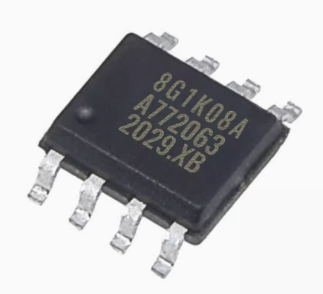

1. One STC8G1K08A-36I-SOP8 microcontroller (main control chip)

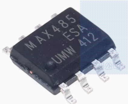

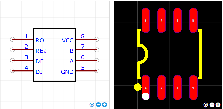

2. One MAX485-SOP8 (for communication)

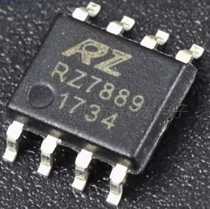

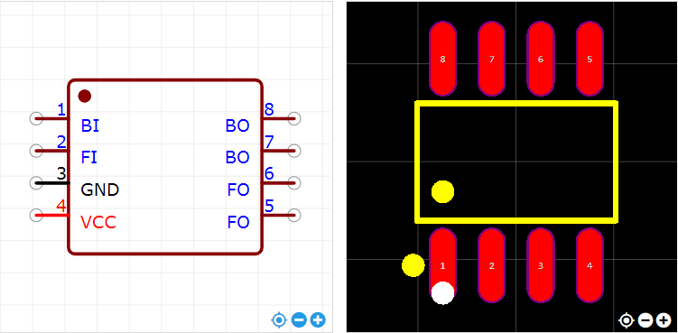

3. One RZ7889-SOP8 (motor driver)
Other non-essential components:
4. One 1kΩ 0603 resistor (current limiting resistor for LED; resistance value is not required to be 1kΩ, 5.1kΩ or 10kΩ are also acceptable, the LED will still light up)
5. One 0603 LED (for indicating communication status)
6. One 100nF 0603 capacitor (two capacitors are mainly used for filtering to reduce voltage fluctuations and interference to the microcontroller)
7. One 10uf 0603 capacitor
Overall design concept: The microcontroller compares the magnitude of the given signal and the potentiometer feedback signal, and controls the motor rotation through the RZ7889, thereby changing the potentiometer signal until the potentiometer signal and the given signal are equal.
Main component pin diagrams
: 1. STC8G1K08A-36I-SOP8 pin diagram;
2. MAX485-SOP8 pin diagram;
3. RZ7889-SOP8 pin diagram.

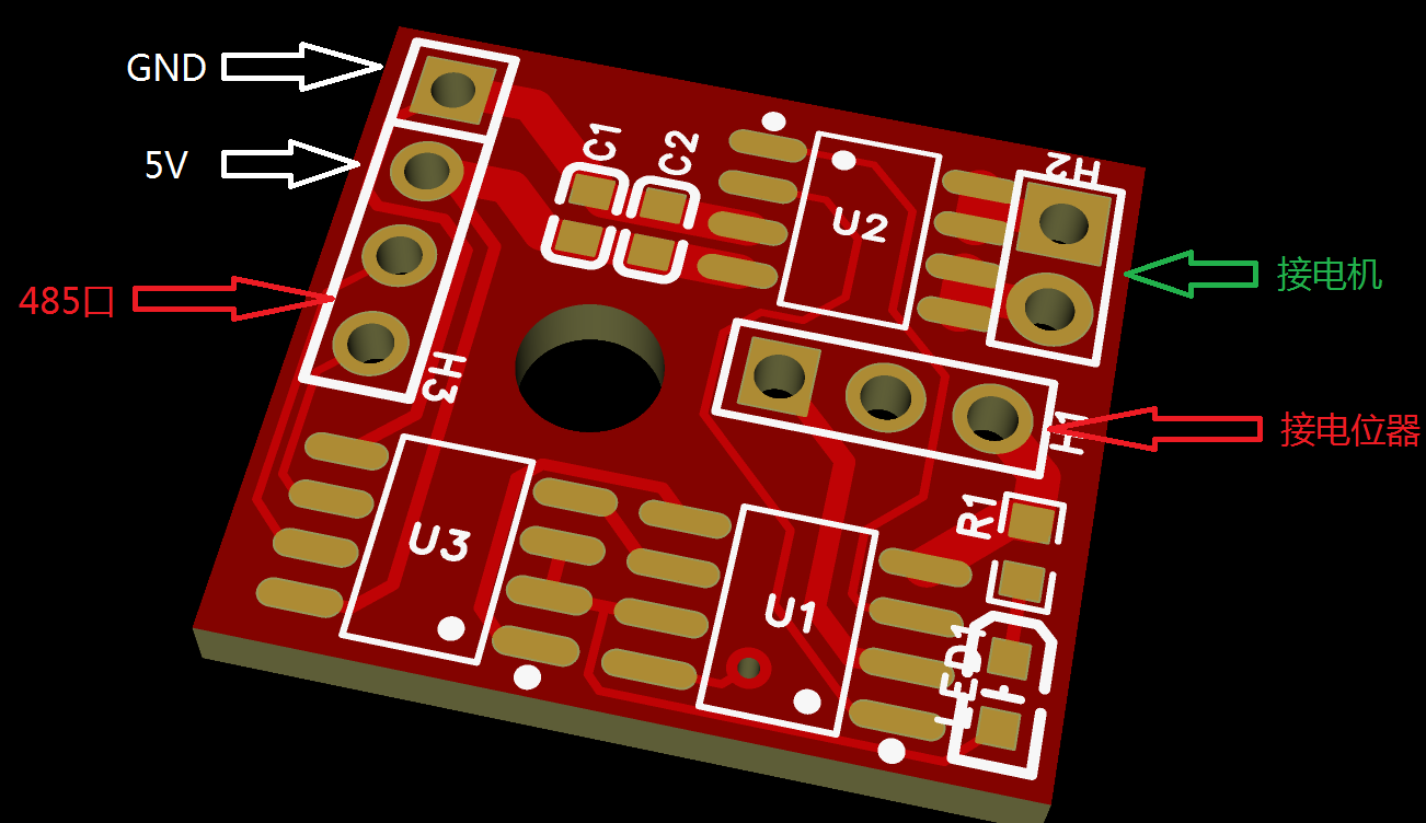

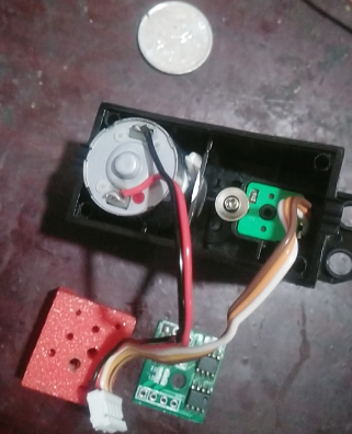

PCB description:
The three sockets on the PCB do not need to be purchased; they are for direct soldering. I haven't explicitly labeled the connections for the 485 port, motor, and potentiometer because I'm also unsure about these connections and they are easily reversed. When soldering the first PCB (if you have many servos to modify), after soldering the three main chips, generally solder the 485 port first, then use the computer to communicate with the board to check if communication is normal. If communication fails, swap the order of the two wires on the 485 port (switch on the 485 port, not on the PCB; you can then solder all your boards according to this order). After successful communication, solder the potentiometer, manually move the servo arm, and check if the feedback data on the computer is normal. If it is normal, then solder the motor. Note that the motor wiring sequence may be reversed, so be careful. Power off frequently during testing. Avoid applying excessive steering input. If normal, the servo will stop at the correct position; otherwise, it will reach its limit and get stuck. Therefore, power off immediately and adjust the motor wiring sequence. After confirming the wiring sequence for the control board, solder the control board according to the sequence tested earlier. Additionally
, it's best to download the firmware before soldering the microcontroller. Otherwise, downloading it after soldering can be difficult, especially for beginners. Note: The firmware is in the attachment, as is the source code.

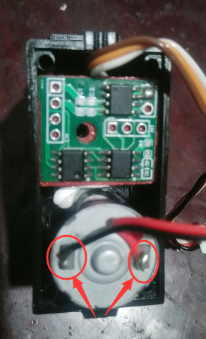

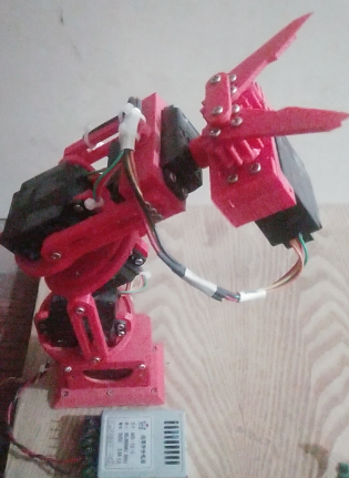

## Physical Demonstration The servo I bought has a potentiometer fixed with a screw with a large flat washer
To avoid short circuits when the circuit board contacts the screw, I 3D printed a spacer. You can use other insulating materials instead. My insulating pad is installed as shown in the picture below. Then tighten a screw to fix it. My soldering is terrible, so please bear with it. I didn't want to spend money on SMT. After all, low cost is always my design theme.

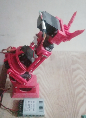

The ultimate goal of making this servo is to complete the following thing, which I think I'll call a robotic arm. Of course, this is just a basic one and can't compare to finished robotic arms. It's just for fun, to master some knowledge. Normal robotic arm grippers are not like this. They cost 13 yuan online, but I couldn't afford it, so I designed one myself. What does it look like? Actually, it's designed based on calipers.

When soldering for the first time, since it's unknown whether the servo's rotation direction and the potentiometer feedback signal direction are consistent, it's best to have a quick-connect switch on the servo power supply during the experiment. If the direction is indeed incorrect, simply swap the two wires on the motor.
## About the demonstration video (Let my mechanical hand do a couple of taps; I haven't actually developed any decent host computer software yet. I only sent four commands using STC's serial port assistant, just to prove that the servo program works.)
Note that this article is not a tutorial on how to build a robotic arm. My demonstration uses a robotic arm to show you what my servo motor can do, and to prove that the servo motor program and circuitry are effective and usable. My robotic arm is not yet perfect; its movements are still very uncoordinated, and most importantly, it's top-heavy. Various dimensions also need modification, so I do not recommend imitating it. ## The source code and firmware are in the attachments. Feel free to leave comments and discuss any questions; let's have some fun together! When making the PCB
, be sure to follow your servo motor's dimensions and modify it accordingly. My circuit is simple, with only a few wires; just make sure the power wires are thick. Don't rush to place an order; I've never been able to use someone else's files directly, and it was all a waste. I bought 10 servos, made 6, and kept the other 4 for other DIY projects. ## Reflections After Project Completion It seems the servos are working properly now, but it has a drawback: all the servos can't move simultaneously, and the servo speed is too fast (the robotic arm moves too fast, it's scary, especially the large arm). We need to add a ramp acceleration/deceleration algorithm to its program. I feel it's necessary to make a teach pendant to guide its operation in the future. My next steps are: 1. Make a teach pendant; 2. Modify the protocol to allow all servos to move simultaneously; 3. Add a ramp algorithm to control the movement speed. Of course, these are problems to be solved in the next project .
