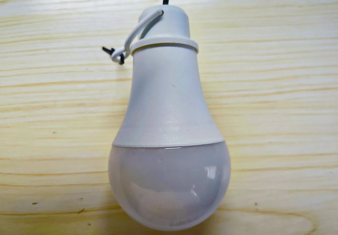

1.1 Project Overview
This project uses 12 yellow and 12 white LEDs, along with a BL-M5-WIFI wireless module. Product development is possible without requiring WIFI firmware development, APP development, or cloud server development.
1.2 Project Functionality
After the PCB is fabricated, soldered, and debugged, connect the power supply. Download Magic Home Pro on your phone, connect to the chip's WiFi (LEDnet***), and you can control the bulbs from your phone.

The casing is provided by the school. You need to find a USB cable to solder the 5V and GND pads on the power board. After powering on, you need to download the APP (Magic Home Pro download address) to control the brightness and color temperature.
