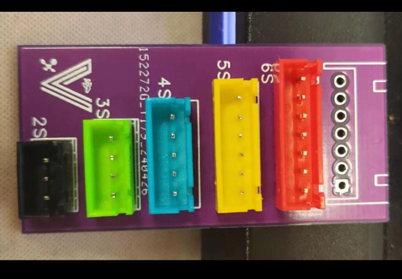

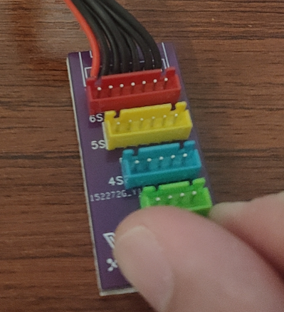

6S Charger Balance Board
The design is simple: just make a prototype and solder on the XH2.5 connector.
Balance boards bought on Taobao usually have plug-in connectors, and it's not easy to remove the connector and resolder the leads if you want to remove the balance cable connector through the hole. Therefore, I redesigned the
back. After soldering and cutting the leads, it's best to cover it with 3M foam tape to prevent electric shock or short circuits during use.
