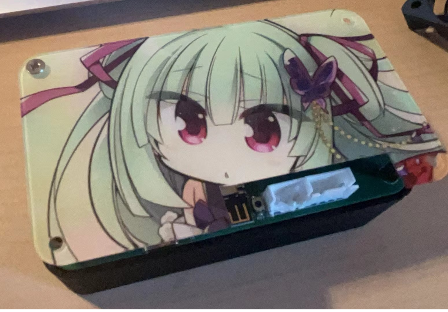

ESP-NOW fan control based on ESP8266 chip
Product Introduction: This product aims to control a fan using communication protocols such as Wi-Fi and ESP-NOW.
Issues encountered include:
1. Insufficient current, resulting in insufficient fan speed.
2. The panel is slightly larger than the PCB, requiring PCB size modification.
3. The 3D casing needs modification.
4. The AHT20 sensor is difficult to solder; replacing it with a temperature and humidity sensor is considered.
These issues will be addressed gradually.
Note:
The fan interface is incompatible; please contact the seller to have the correct female connector provided
. Hardware Specifications:
Uses ESP-12F as the main control chip
, CH340C as the programming chip
, and EC190707 as the one-button power-on/off chip.
Purchase Link: https://item.taobao The product (.com/item.htm?id=728943790630)

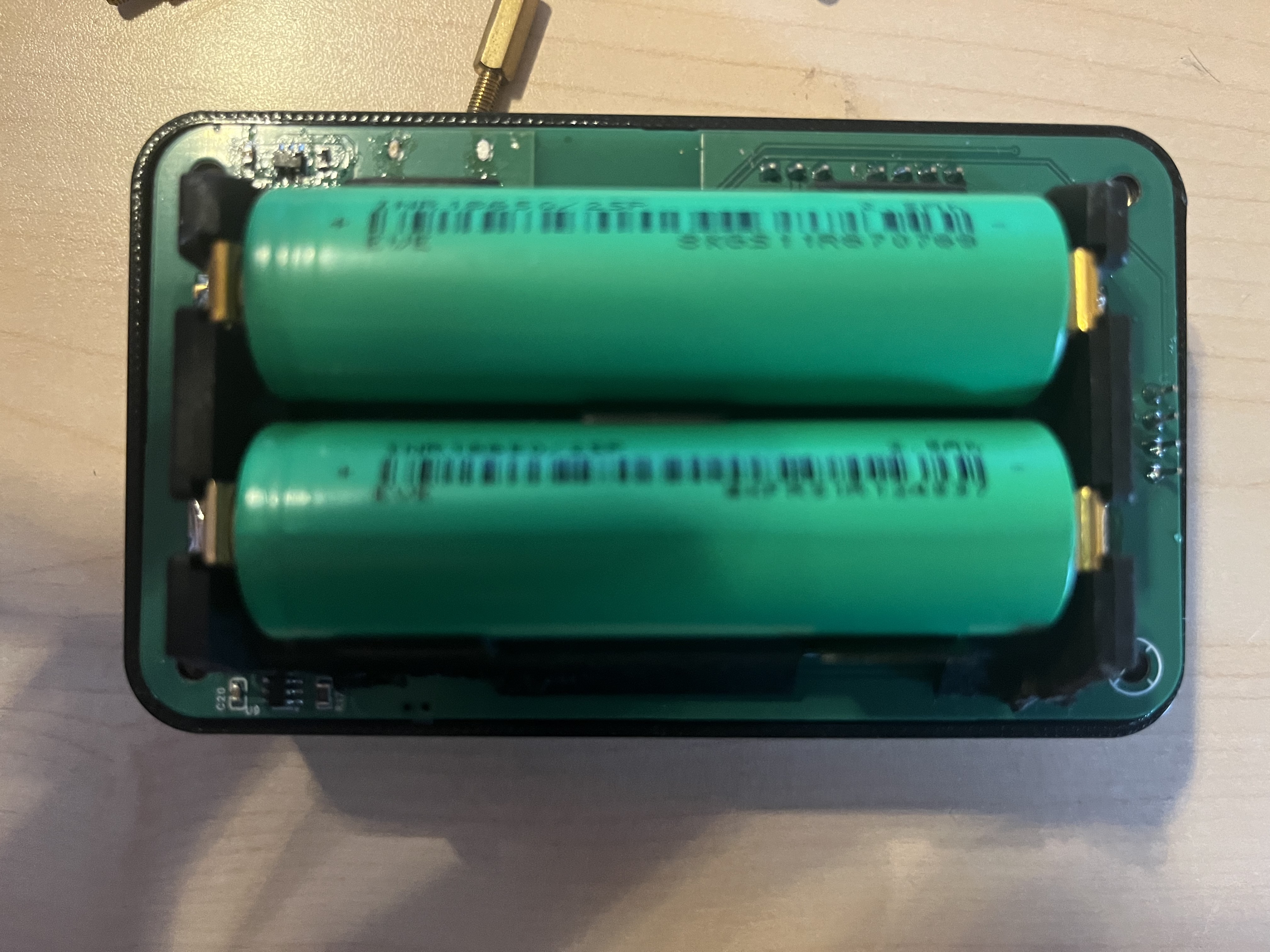

uses the DW07D lithium battery protection chip
, the RT9013-33GB 5V to 3.3V step-down chip
, the MT3608 5V to 12V step-up chip,
and the TP5400 for lithium battery charging
, an AHT temperature and humidity sensor, and an OLED screen.
It utilizes environmentally friendly Type-C and 18650 lithium batteries, while also providing an external interface for polymer lithium batteries.
An 18650 socket is used for lithium battery power connection, allowing for battery replacement.
