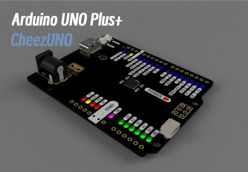

28OEAr
Cheez Arduino Uno
Aesthetics
are everything!
Arduino UNO Plus
video link -> Click me~
Github -> Click me~

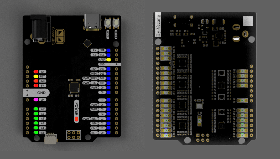

Hardware
interfaces: Type-C, DC
controller: ATMEGA328PB-MU
TTL-serial port: ch343
Buttons: 3x4x2.5 SMD oval white-headed push-button switches Op-
amp: RS6334
LEDs: Reverse-mount 1206
LEDs Power supply:
12V-5V: TLV62130
5V-3.3V: RT9013-3.3

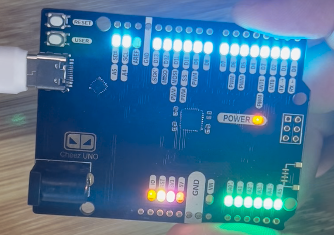

The entire board uses 0402 package resistors and capacitors. It is recommended to use solder paste and a soldering station for easier operation. After
the software
board is soldered, it cannot be used directly. You need to program the Atmel microcontroller with the Arduino bootloader before you can use the serial port for programming.
For detailed steps, please refer to the following: After burning
the Bootloader
, you will have a beautifully designed Arduino development board!
