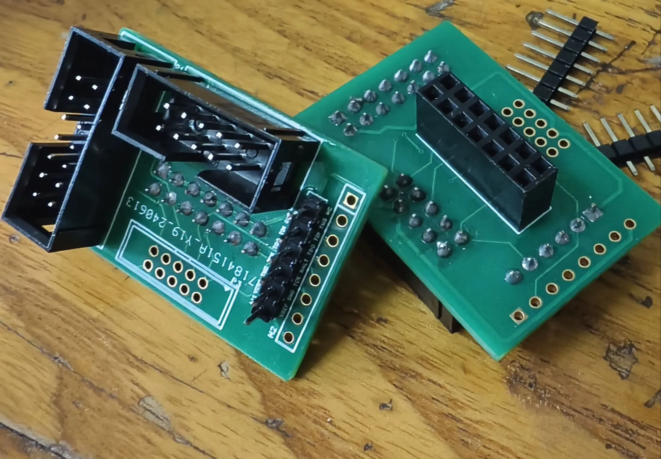

Xilinx-JTAG-Debugger-Converter
Xilinx devices use a JTAG interface for downloading, but the interfaces of various FPGA development boards are not compatible. Various interfaces are commonly available, such as 6-pin JTAG, 14-pin JTAG, and 10-pin JTAG.
This adapter board implements a 6-pin JTAG (compatible with Milink), an 8-pin JTAG (compatible with mining boards), a 14-pin JTAG (compatible with Digilent and official evaluation boards, as well as most development boards), and a 10-pin
JTAG interface used by some low-cost DIY programmers and some development boards from Xiaomeige. Essentially, the board does not contain any active components. I also tried using an Altera USB-Blaster 10-pin JTAG jumper for downloading, which still worked normally (not guaranteed for every board, and no guarantee for Xilinx). All the development boards and programmers I have can recognize the devices and download normally. This includes ISE, Vivado, Zynq 7000 series, and Spartan 6 series; other devices have not been tested. The programmer is a simple FT232 programmer.
See the attached screenshots. In my setup, only one of ISE and Vivado can recognize the device; one driver cannot run both software programs simultaneously. I've also attached the drivers for both downloaders here.
![Vivado Recognition] ![ISE Recognition]
