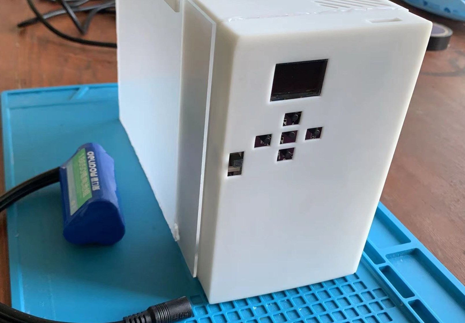

  Summer is here again, and if you want to enjoy an ice-cold cola anytime while you're out, a portable mini-fridge can make all the difference.
System Design
: Main Controller: STM32 Microcontroller. The
         STM32 microcontroller serves as the main controller, responsible for the logic control and data processing of the entire system.
IoT Module: Wi-Fi.
         The ESP8266 Wi-Fi module enables remote communication, allowing users to control the mini-fridge remotely via their mobile phones.
Temperature Sensor: DS18B20
         . The DS18B20 is a digital temperature sensor that communicates via a dedicated bus and can accurately measure ambient temperature.
PWM Control of the Cooler
         : The STM32's PWM output controls the MOSFET, thereby controlling the operating state of the cooler (such as a Peltier chip). By adjusting the PWM duty cycle, the cooling capacity of the cooler can be precisely controlled.
Hardware
Power Supply: 18650 Lithium Battery
          . The 18650 lithium battery provides portable power for the mini-fridge control system.
The remaining components
          use hot melt adhesive, acrylic sheets, 2.54*2p and 3p terminals, a 1.5cm high 6*6 high button, a
          4*4*10cm heatsink and a 4*4*4 cooling fin for the 5V cooling chip, two 4*4cm 5V small fans for cooling the step-down chip, and a 1.5*2.5*3cm heatsink for cooling the chip.
The actual steps are shown in
the internal picture; proper heat dissipation is crucial.
      2. This is the power-on screen.
      3. When powered on, a Wi-Fi icon appears in the upper right corner, indicating a network connection. The target temperature can be set via buttons or a mobile phone. The phone also displays the current refrigerator temperature. When the refrigerator temperature is higher than the target temperature, the STM32 controls the PWM output to control the PMOS transistor, enabling the cooling chip to work. When the temperature is lower than the target temperature, the cooling chip stops working.
     4. When the Wi-Fi icon in the upper right corner shows a "/", it means no device is connected to the Alibaba Cloud platform, and the target temperature cannot be controlled via the mobile app. In this case, the target temperature can only be set via a button. Similarly, the STM32 controls the PMOS transistor to operate the cooling chip by controlling the PWM output.
