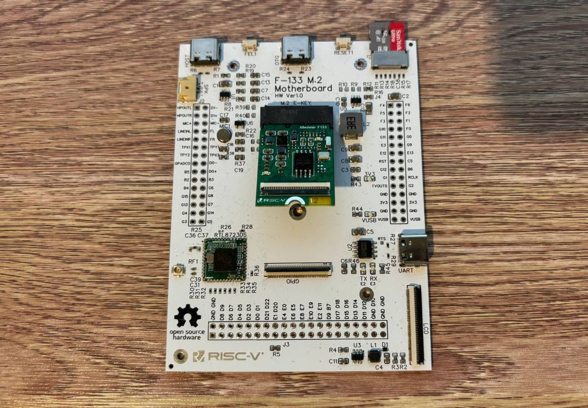

Allwinner F133-A (D1s) base plate M2.2230
The accompanying core board has been released and is also included in my project as
a two-layer board. It's almost entirely exposed, and the schematic should be consistent with the MANGO development board. However, additional verification may be required
for the accompanying microphone, speaker amplifier, video interface, one UART, and two USB ports (with jumpers, optional).
Firmware compilation is necessary. Refer to the Allwinner forum for details.
The bottom shows the I/O cable, and the top interface is an M.2 2230 connector.
